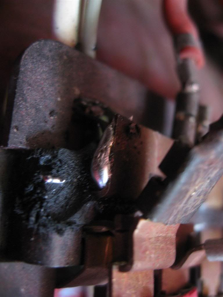

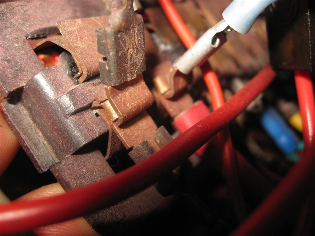

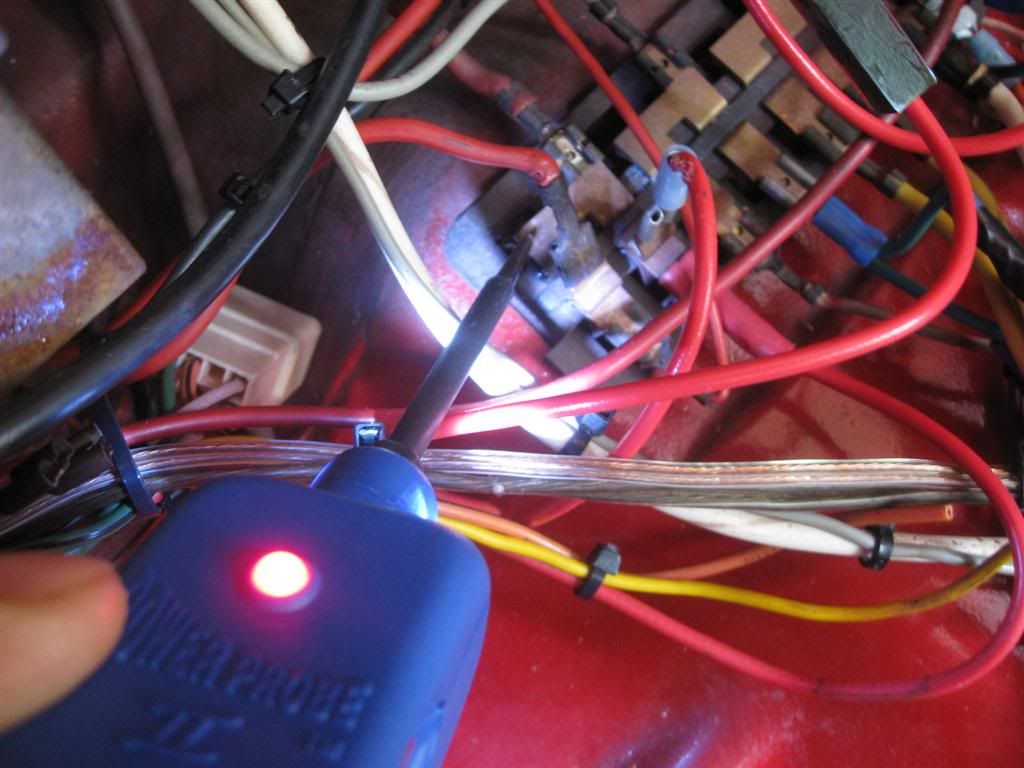

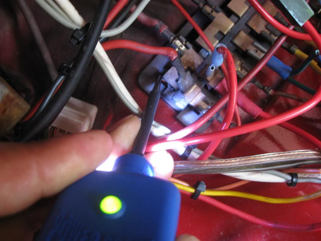

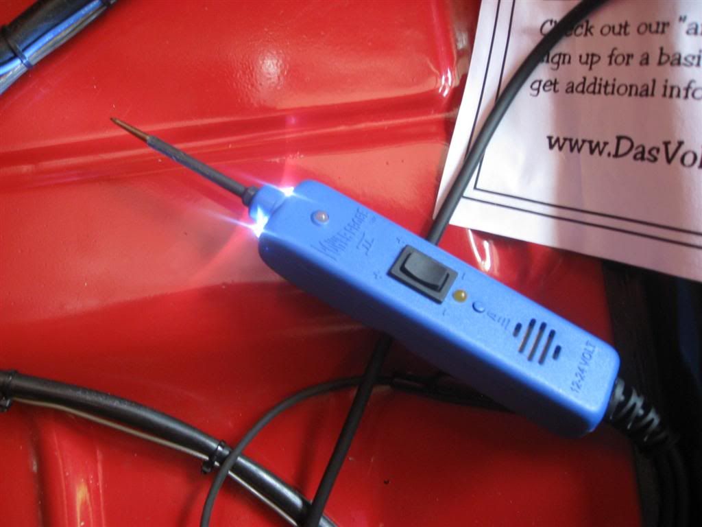

So on the way home from Litchfeild I lost all power on Rt 112, and had to pull over. Luckly for me I has BusBQ nearby with some scrap wire and solderless connectors. I ran a hot wire from my alt to the + side of the coil, and drove it home. Today I located the issue. I used my new power probe to help locate the issue. The power probe connects to a pos and neg source, and allows 2 main functions. 1- if you touch anything it will let you know if that item is hot or neg. 2 - you can turn the probe into hot or neg with a flip of a switch. nice item
on the fuse block, some tabs are touching each other sharing power.
this one is hot on one side ( red light)
neg on the other ( green light)
turns out the somehow became separated from each other. Never seen that before. Slapped on a little solder, until i find a replacement 65 fuse block. tada!
from l.field
from l.field
