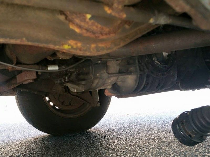

And the hits keep on coming. Around the corner from the show the axle comes out. Luckily one bolt remained and I got it to the show. Jon [Hazetguy] got ahold of more bolts and it's good to go now.
Of course all of the going under the bus has destroyed my back for the weekend. Hopefully resting at my mom's will help for the bound brook show on the way home tomorrow.

wow! could you tell something was wrong or did it just let go out of nowhere?

Markus wrote:wow! could you tell something was wrong or did it just let go out of nowhere?
This is one of the things I am OCD about, I check those bolts every couple of months and will torque them to spec before I take any long trip.
And I am going upstate in a couple of weeks so I am puchasing a spare coil. ;)
No clue. Just a thud and it wouldn't move. After this trip I'm definitely throwing it up on ramps and taking a look around this weekend

Rob, this is always a hot topic over in the bay window threads.
http://www.thesamba.com/vw/forum/viewto ... ight=axles
Mine have come loose a few times, never fallen out like yours has though.
