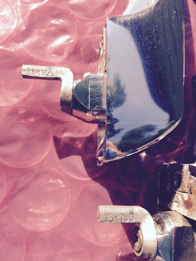

After a busy few months finally made some time for the VW's. I removed the door handles from the bus to send them out to get keyed to match the other doors. Wish I thought to do this when I was redoing the door panels as I had to remove the moisture barrier and my homemade panels to get access but better late than not.
Much to my surprise the handles were screwed on with 5mm hex nut. I went through my arsenal of hex keys and wasn't finding a match, either too big or too small. Never bought metric ones. Finally found one that had the ball on the end and it was just right!! Hoping to get then out in the mail tomorrow and back soon.

Had shipped out the door handles last week to be re keyed to match the slider and rear cargo door. Got them back today and the re-install is set for this weekend. Glad it only took me 3 years!!

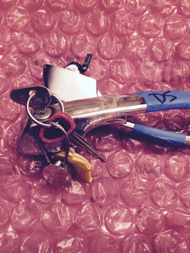

Yes, I used Justin for the re-key. I had gotten the code off the slider door which I had keys made but the front handles didn't match so I sent him the handles and a key and he reset the biscuits to match so all the doors are on one key. It was all done in under a week. His direct email is vwkey@yahoo.com and he is out in PA.
I am going to clean out and lube the locks before I reinstall. You can see 40 years of gunk inside the mechanism, Not taking anything apart!! I read on the Samba to use brake cleaner to get the buildup out and then re-lube. Will let you know how it works.

Got the handles cleaned up and polished. Used a baking soda and vinegar solution with a toothbrush to get a lot of the surface gunk off. Saw this used on a DIY show to clean old metal. Then sprayed with brake cleaner and hit it with compressed air. Used my polishing cloth from the can and then cotton tee shirt. Cleaned up nice and shiny!!
After I got them cleaned up I found the key codes. Both are different from each other and from the slider. Now are all keyed the same. Makes securing the bus much easier. Curious why so many different locks. What happened with the PO's? :?

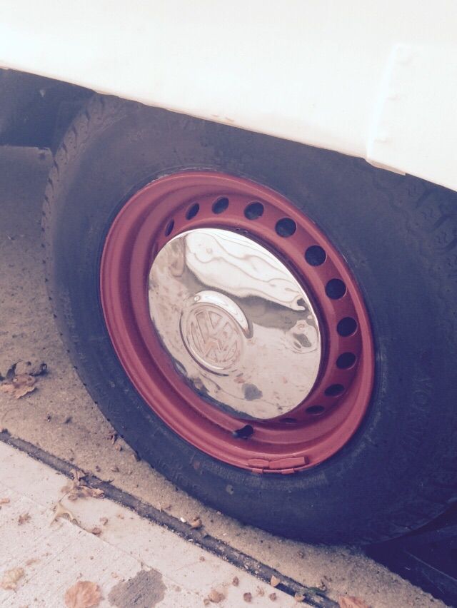

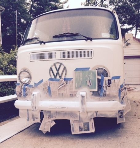

Now that the bus is pushing 45, I thought is was time for a makeover. When I work under the engine I am always grabbing on the bumper to scoot out and it winds up looking line a CSI finger print dusting. I gave it a good sanding and a coat of primer and gloss enamel. I had used a different paint last time and it did not hold up.
Much cleaner. this only has one coat as my usual trip to Home Depot had me crazy. Out of stock on white gloss so will put another coat on tonight.
Rims were looking very sad as well. Needed some TLC. Gave them a good sanding and primed as well. I used small paper plates to make a fan to protect the tires and a ribbon of blue tape.

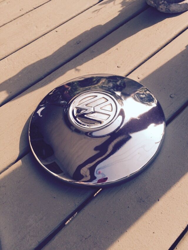

Gave the hub caps my baking soda and vinegar scrub and these are before I added any polish. Cleaned up nice

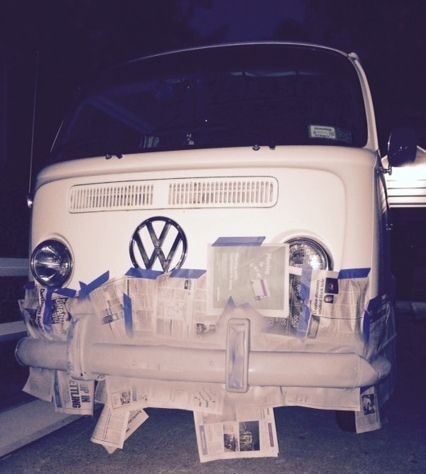

Just squeezed in getting the bumper primed last night before I ran out of daylight.
Put a first coat on under the lights and looks pretty good this morning. Second coat on after work!
