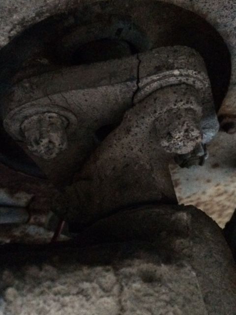

When I was out at the Duck we talked about the steering issues on Bays and Mike recommended checking the steering coupler. I took a photo of the one on my bus and it is cracked in two places that I can see. My steering isn't bad but probably best to replace the item for safety. Unfortunately it is out of stock on WW. I am going to check out the castle nuts to see how easy they are to get off.
Will post pic later.

Ive done mine once and now it is really badly cracked scary.. the aftermarket ones are really soft rubber and dont seem to hold up, this time i bought an oem vw one off ebay it is much stiffer.. i actually had an aftermarket one on my shelf in stock but wont use it.. if you want it you can have it audrey, however i would spend the extra few bucks for a genuine vw one.. Its a tight area but can be replaced without removing the steering column. probably the hardest part is getting the rusty cotter pins out if its original or really old. if you have trouble and need a hand let me know

DO NOT buy the Euromax one, and if it shows up - send it back.
You want one that is marked VW, if it isnt VW you can tell the Euromax because it is more rounded than the "good" style.
Is this the seller on ebay? this is the only vendor I see.BusBq Bill wrote:Ive done mine once and now it is really badly cracked scary.. the aftermarket ones are really soft rubber and dont seem to hold up, this time i bought an oem vw one off ebay it is much stiffer.. i actually had an aftermarket one on my shelf in stock but wont use it.. if you want it you can have it audrey, however i would spend the extra few bucks for a genuine vw one.. Its a tight area but can be replaced without removing the steering column. probably the hardest part is getting the rusty cotter pins out if its original or really old. if you have trouble and need a hand let me know
http://www.ebay.com/itm/VW-BUS-STEERING ... 10&vxp=mtr

thats not who i got it from but it says genuine vw ..
the person i got it from doesn't seem to have any listed right now.
Stay away from euromax or any of the other ones which are made in the same factory

correction here is the one i bought
http://www.ebay.com/itm/VW-Bay-Window-B ... mp&vxp=mtr
Thanks Bill. Just ordered it up. Will keep you posted
This is the one in the bus now.
- Posts: 1412
That thing is golden. Mine had chunks missing! Lol
