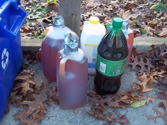

Spent some time on the bus the past two days. Yesterday I started draining out the nasty old gas. It really stinks! Got about 3 gallons out and still more to go.
No it's not ice tea but is the same color!

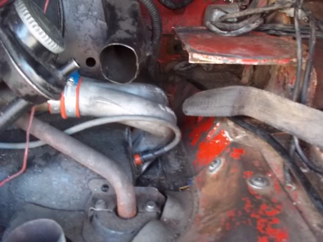

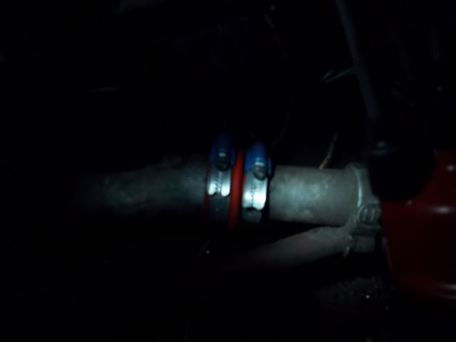

Today we tackled the boots and manifold gaskets. Had to be creative in getting the manifold off but that was the easy part after we found out that the old gaskets were paper that had turned to tar. Used a long list of things to get them clean and after 2 hours they were done. New metal gaskets and RED boots later, things were looking better.
Bill thought the prob to keep,the engine running was a carb issue. I started the engine after the new boots were on but no difference. Bill brought over a carb that he knew was good and once was put on the engine, it turned right over and ran non-stop until i turned it off. Bill is going to work on the one that was in there to see if he can get it cleaned up and running smooth. I am working to get all the excess crap out of the engine compartment and give it a degreasing and shop vac clean. Really thankful for all Bill's knowledge and expertise plus the great weather!

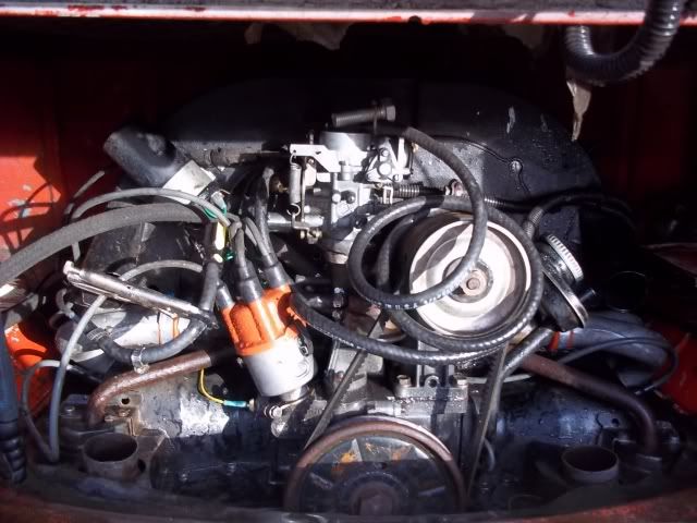

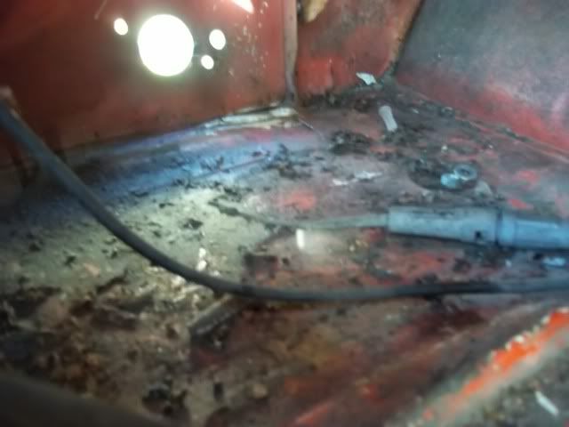

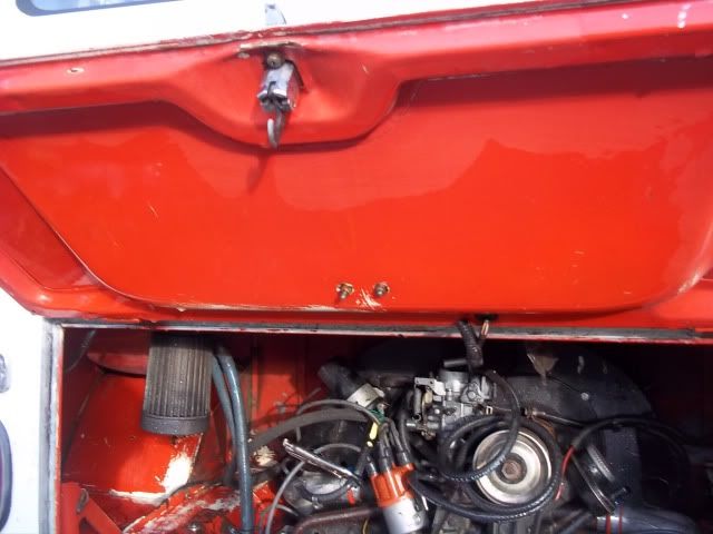

DId a little housecleaning today. There is lots of dirt in the engine compartment. Looks like it has been on some muddy trails in the past.

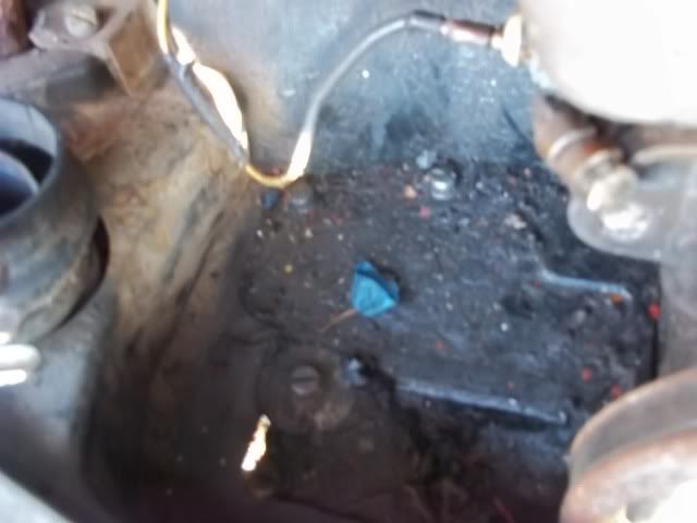

Rear compartment driver side holds lots of extraneous stuff. Think I need to drill a new weeping hole further back since the one there does not do the job.

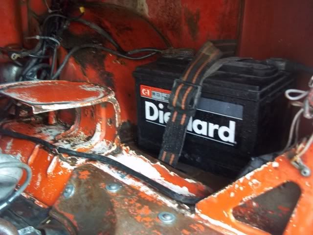

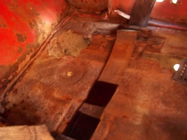

Rear compartment passenger side. The battery tray floor is shaky in spots. The gray area next to the wheel well is rusted through and the battery was not secured down.
Got a good amount of the grease build up removed, and i redid the connection to the oil temp. got rid of all that tape and lengthy wire.
Clear shot of the original dirty red paint and after.
Removed or cable tied alot of the extra wiring to clean things up. the hose around the generator is the bypass we've used when running the bus since the tank is nasty and the vice is holding the line from the tank. These are all temp.
