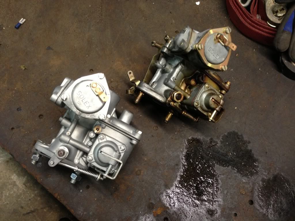

I noticed the bowl in the carb was dry one night bc the squirter wasn't squirting, so I took the top off to clean the input valve. That got me to the show...almost.... but the issue is ongoing. Sounds like the carb accel pump needs some loving. This is a 28-1 bosol on it now, and given my time constraints with the family and house/ garage construction, Im just going to order a rebuilt, rebushed german solex and call it a day.

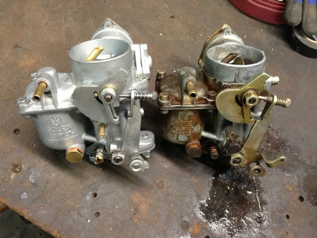

I just rec'd this last night from them. Id rather run real OG stuff on my cars, so I bought one redone and rebushed outright. It was too late to start the motor last night, after the install, so I will tinker tonight
Re: 63 rag
Finally got the carb on and running right. It was having issue when first installed and the builder and I talked a few times discussing the situation. After exhausting all options, I simply yanked the tank and disconnected the fuel before the pump. I blast of air at 100psi quickly remedied the situation and shot out whatever debris that was restricting the flow of fuel to the back of the car. Made it work no problems today, and looking fwd to some miles on it now that the weather is not sweltering.

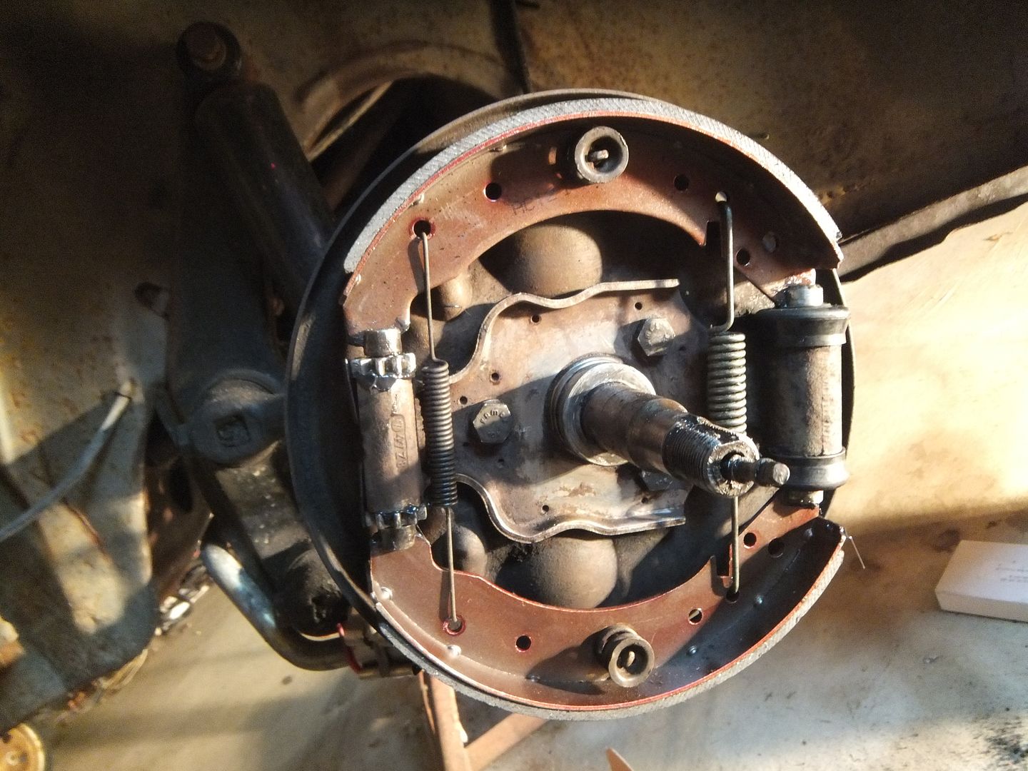

Towards the end of summer, she had a soft brake pedal. Was a single slave anyway so I wanted to upgrade considering it was a driver. A few months ago, I yanked the master and upgraded to the 68+ style. Used a 67 only reservoir and tried my first time bench bleeding. Car wasn stands in the garage while I worked on the 100 other projects I had/ have going. Turns out the ' new ' one was defective and pissed fluid everywhere. Swapped to a new new one, and was ready to rock. Just need the time to do it. Yesterday.... I got the nod. Was in the garage at 530 am - 430 pm. Finally bleed the brakes on the new master.

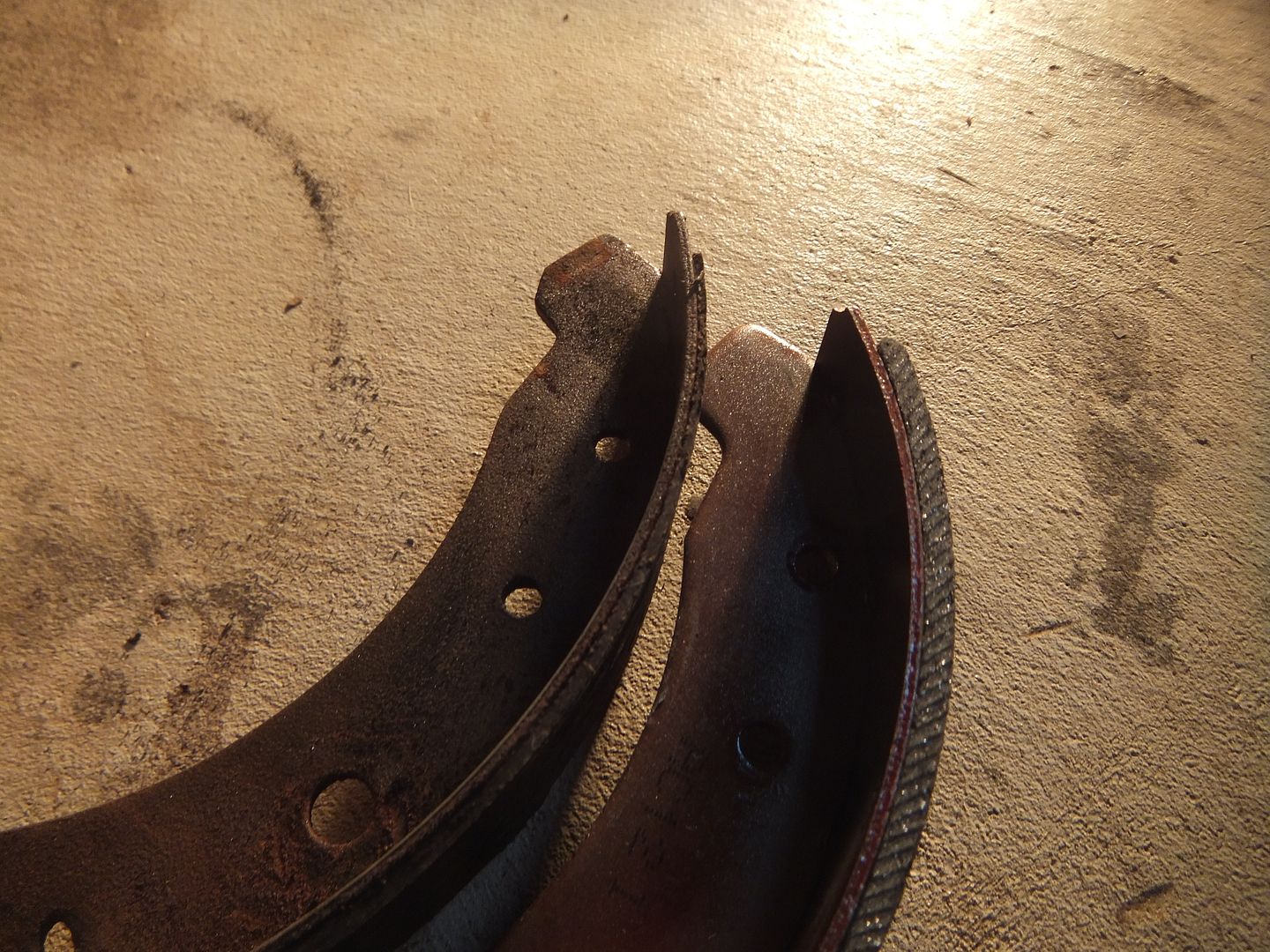

Front was pulling to one side so I check my front pads. Wasn't pretty.
old vs new
After it was all cleaned up

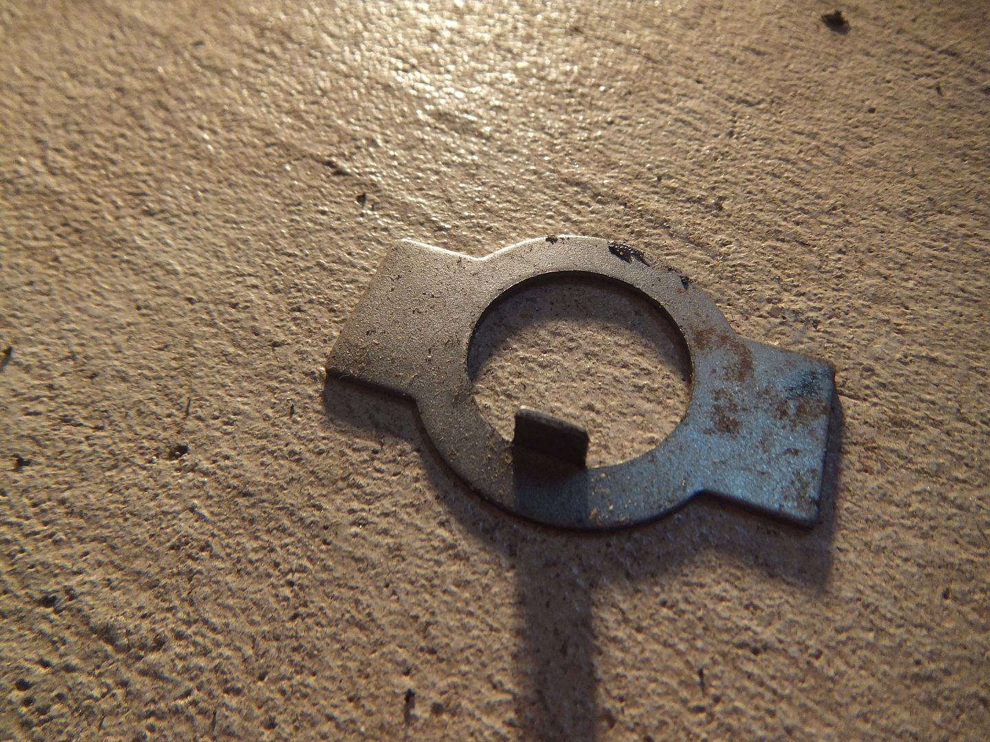

NOS lock washer.
Back on all fours
Drove her into work this am.... Its good to have her back in rotation.

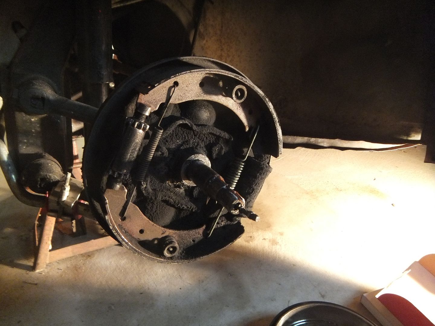

Last post on this car Dec 14. Yikes. Shes been good to me since, but gave me a soft pedal at the beginning of this summer. Wasnt sure if it was a bad master or something else, but havent gotten a chance to check it out. Last night I yanked the rear rims to adjust the brakes and check it out. Res had fluid and still only had a pedal if I pumped a few times.
Adjusted the rear brakes, but they werent really out of adjustment. Bled the RR side, and surprisingly, it had some air in the line. Did the same to the LR, no air. Pumped the brakes and had a nice pedal again. Thank god, but I wasnt in the mood to do a master in this.
I'll do the same for the front tonite, dump the oil, and give it an overall once over. Looking fwd to getting back behind the wheel on this one.

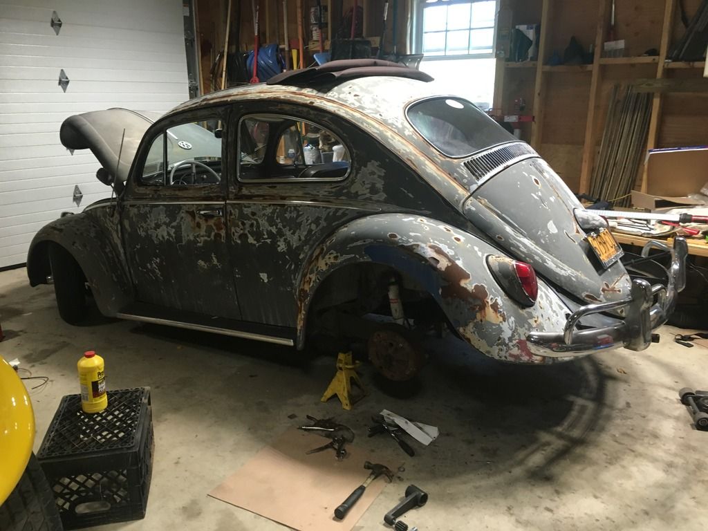

The poor old girl has been laid up since August..... She went to the side of the garage and sat all winter.
Dug into the this air in the line issue the past few nights. Noticed more floor pan near the pedal was wet so led me to believe the master went bad. Swapped that out, and proceeded to bleed the brakes via the power bleeder. For some reason... same issue.... was not getting a firm ' pedal'. Bleed all four again and pumped it up again. Then I noticed a puddle in the rear, and the brake fluid all over. Turns out that one of the rear hardline was rubbing on the shock, but only when the car was on the ground. With it in the air, ( wheels hanging) there was sooooo much room, I never noticed. Crap! Swapped the brake line, rebled..... she is at work today. Still not the pedal I like, but my air compressor is on the fritz with my new one in assembly mode.
Making a list of a few other things it needs, like muffler and a clutch.
