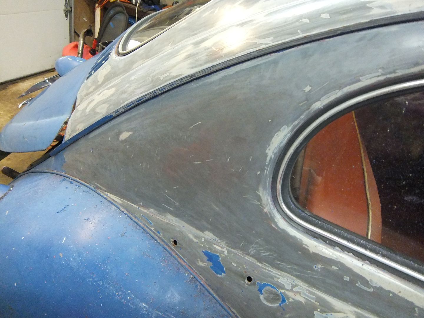

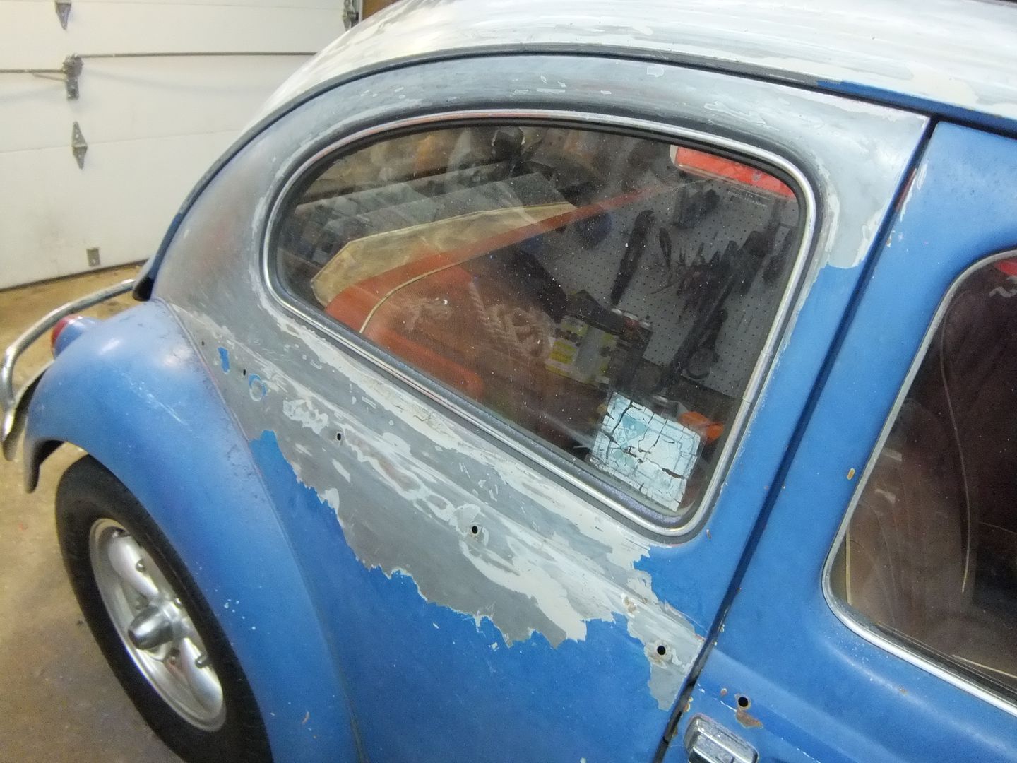

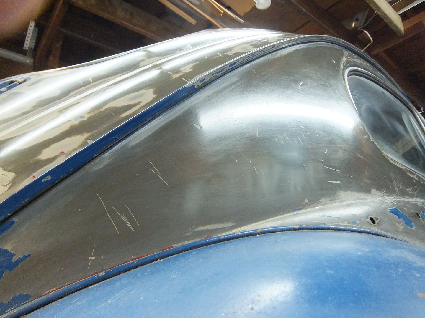

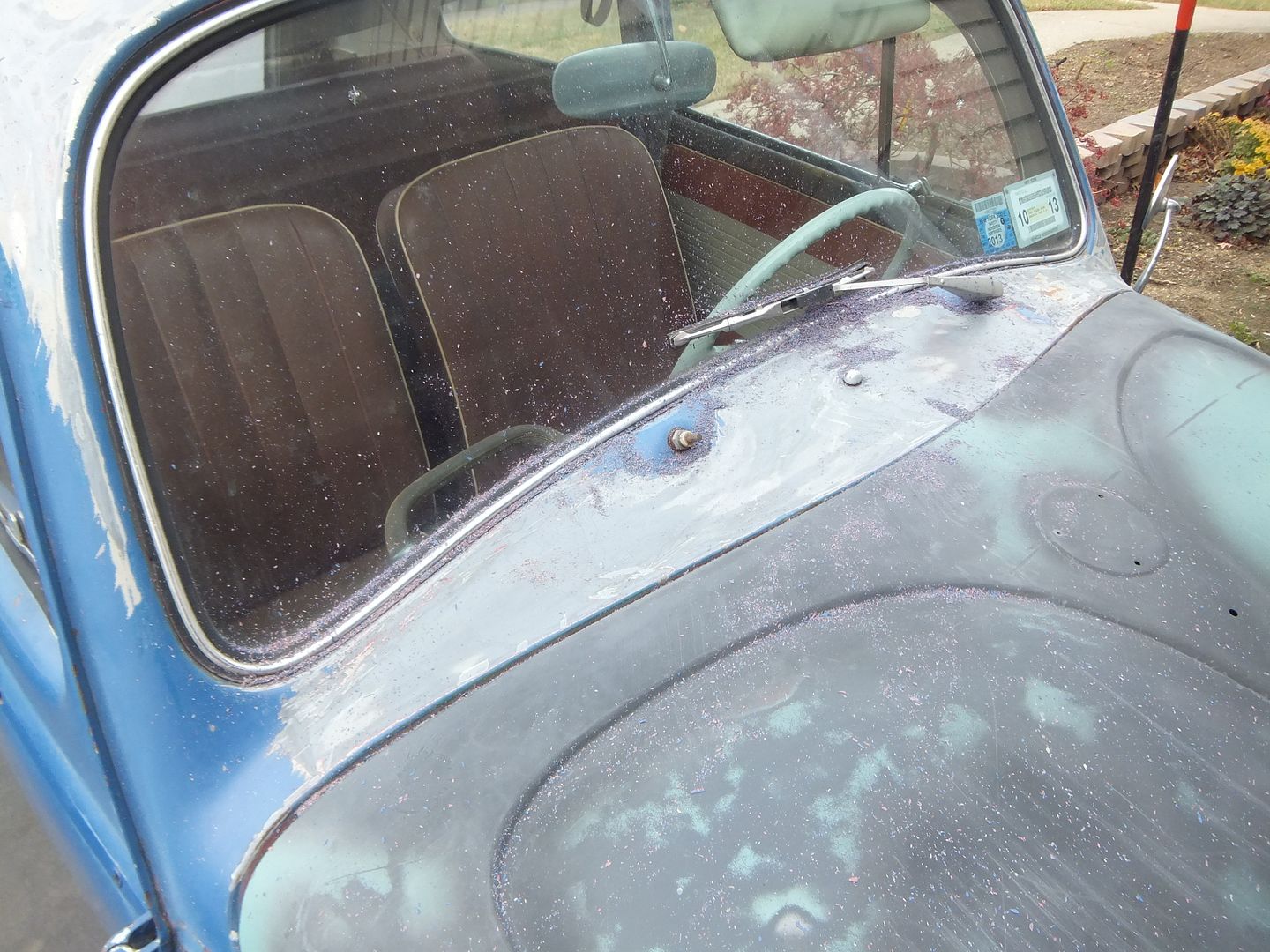

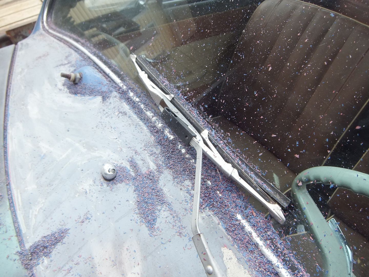

Dumped the oil last night and need to correct the oil filler, as the one that's on there is cut up.

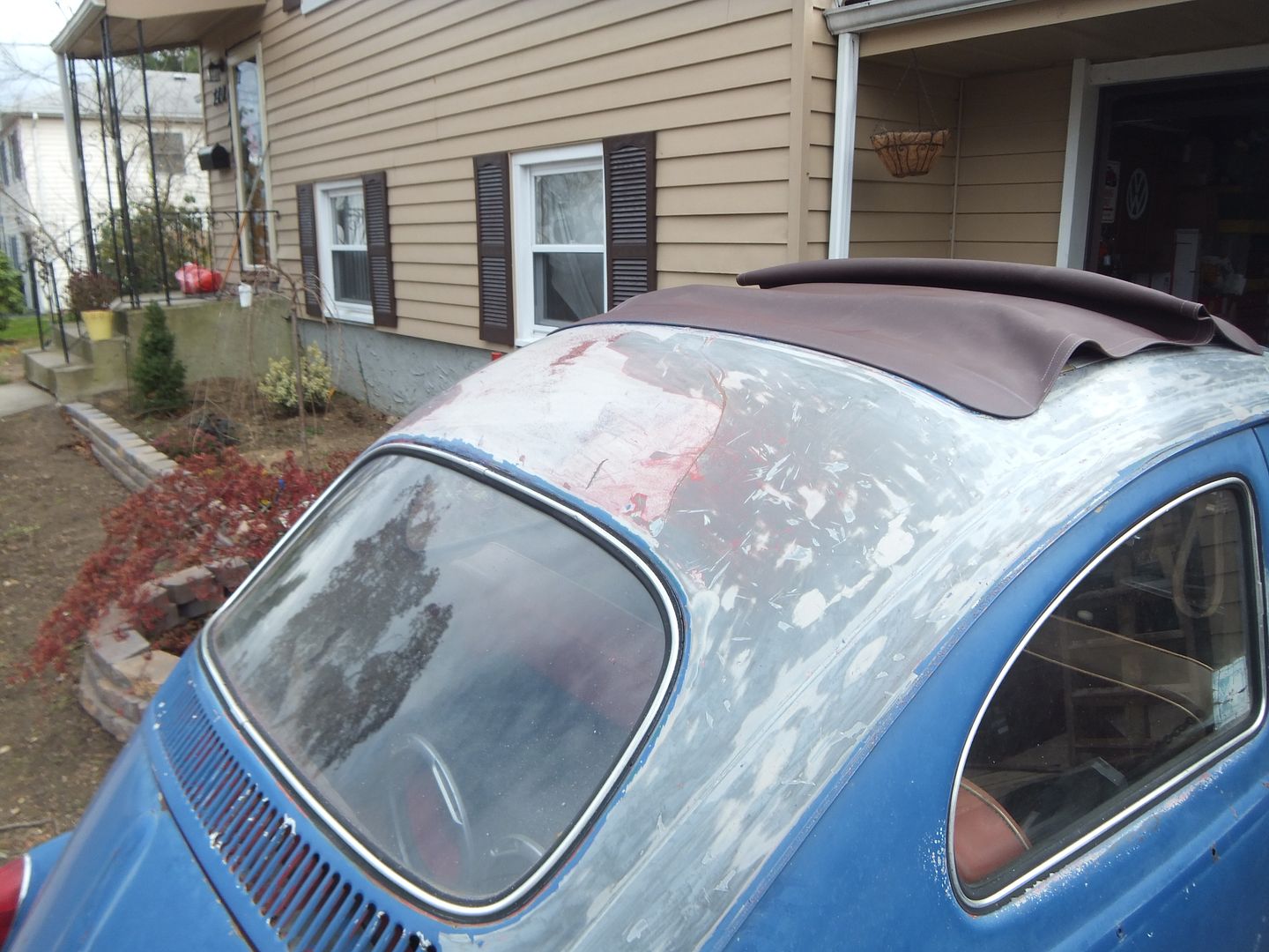

Meanwhile, the stripping of the 3 layers of paint is painful. Its a shame the PO sanded down the OG paint, some places are down to metal. Im using a razor blade on the roof...... I need to get the pace. pressure and angle correct to not gouge the metal. Def not easy, but its getting there.......
front cowl
rear roof
sample finished product, scrapped, 2500 wet, 3500 wet, 5000 wet, polished by hand, waxed by hand. Im going to get some power tools to make this process faster and outcome better.
front cowl
rear roof

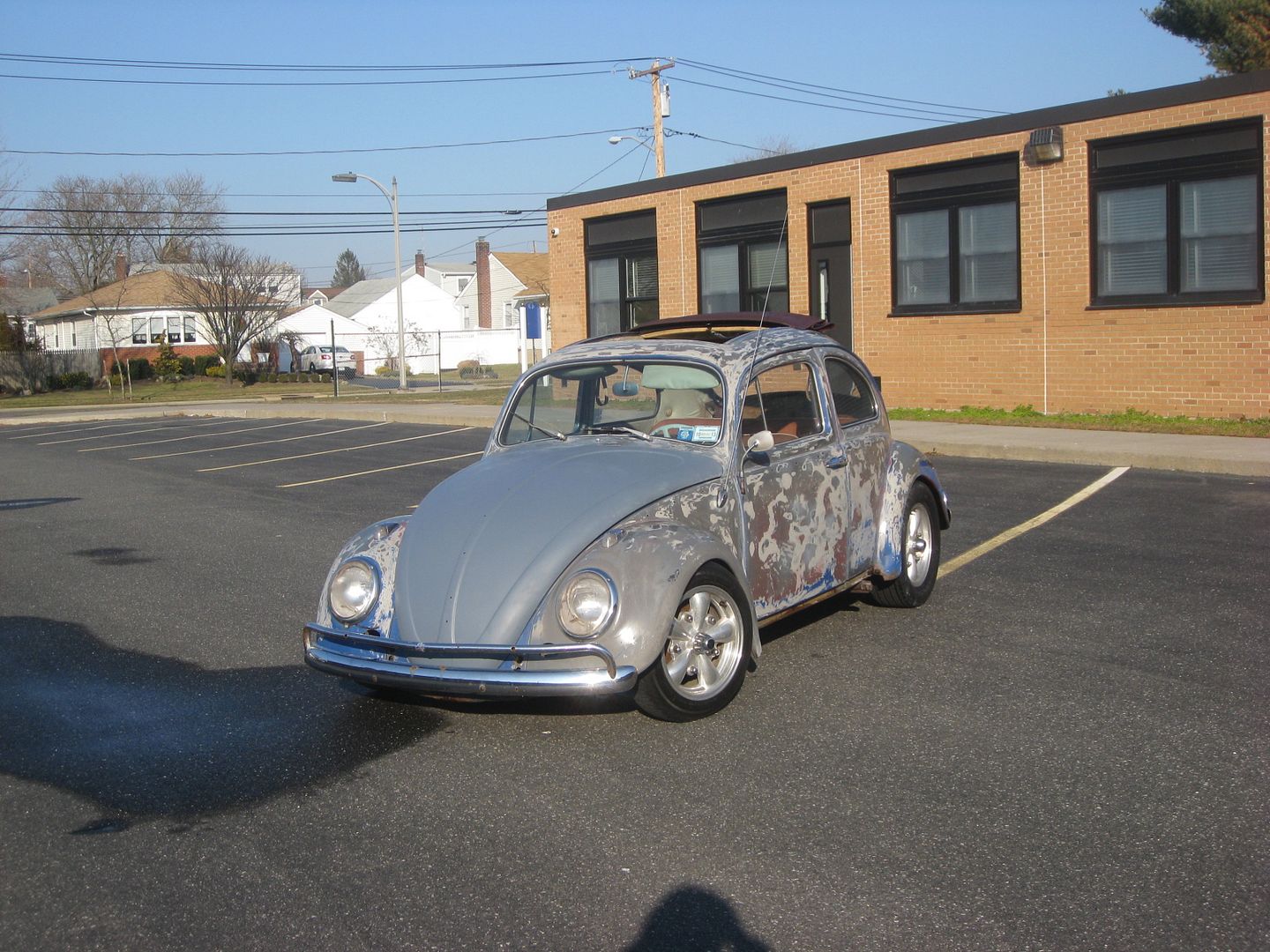

Been putting some limes on the bug.... especially last week when it was in the 60s. Shes doing good and I addressed the high idle..... no return spring on carb! scary.
She did well at the parade!

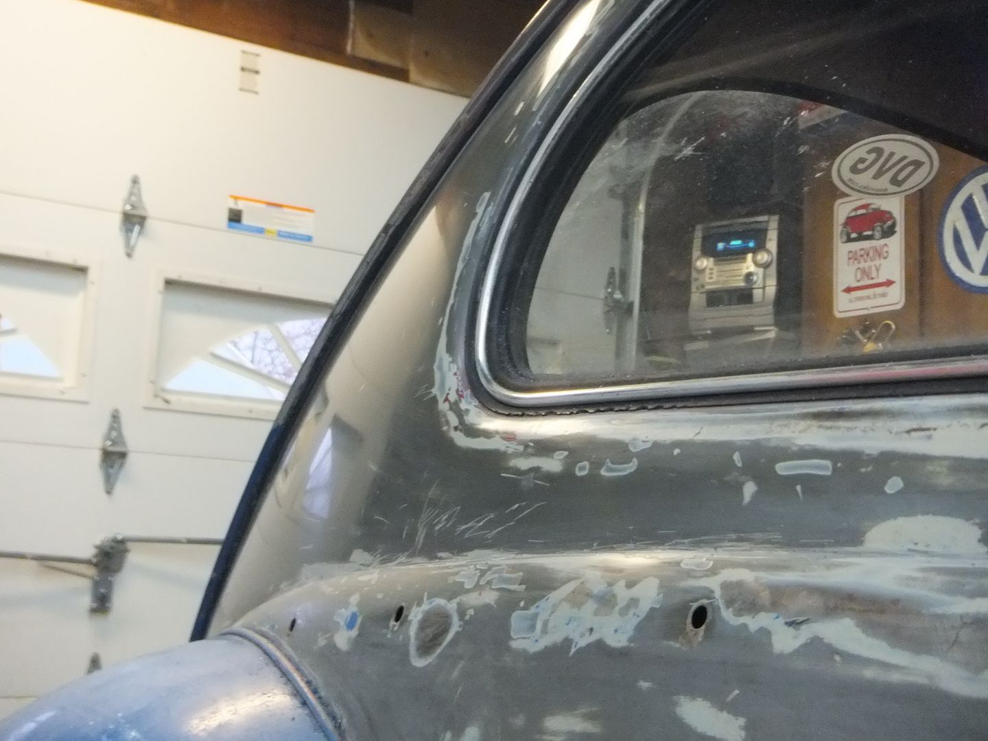

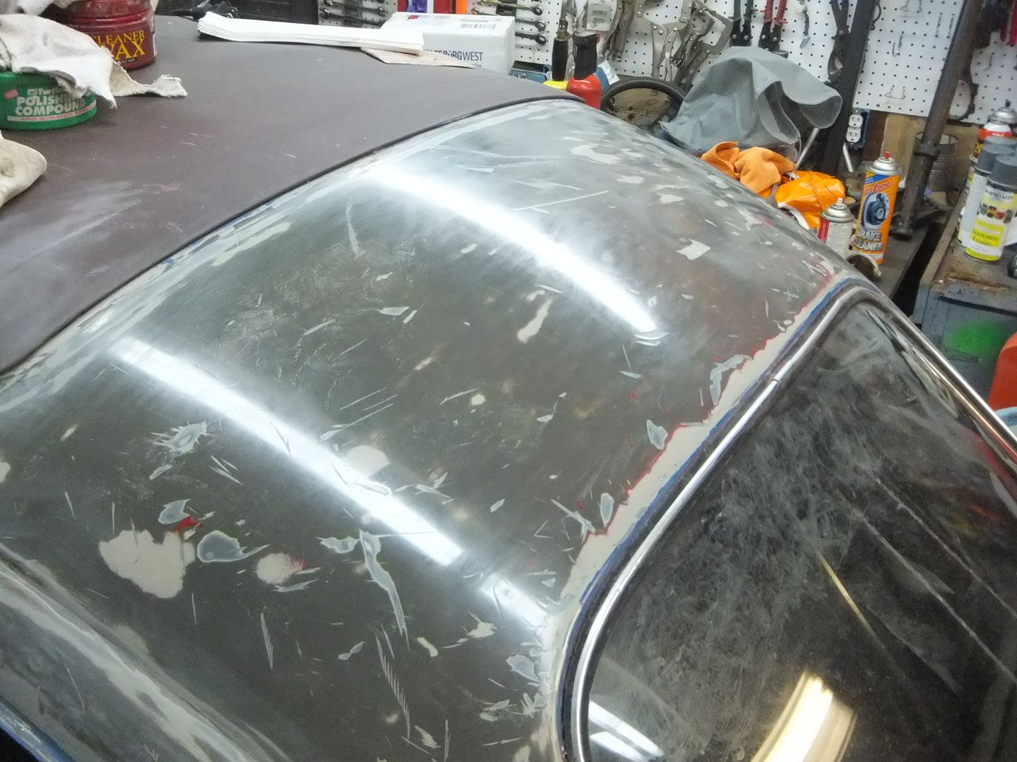

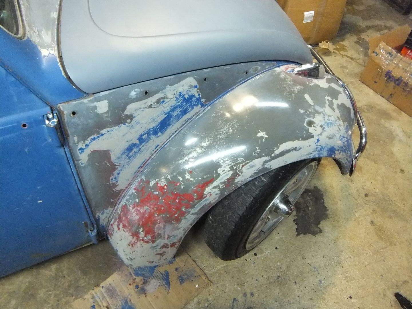

Today I was home with Liam bc the sitters kid has the croup. Good times! While he napped, still moving fwd with paint removal.
front pass fender..... this one is tough
rear c pillar and quarter, scraped
after wetsand, rubbing compound, polishing compound and wax.

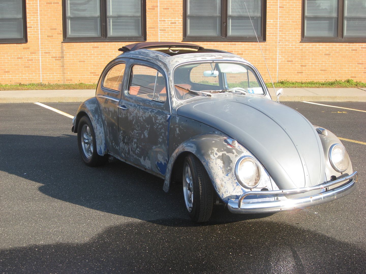

The 63 is coming along. I'm not super thrilled with whats under the 'paint' but I'll make due until time comes available for respray. I have been driving the crap outta it thought. Its been running super awesome...until this morning. I went to take her to work and she had a real rough start. As we went to get coffee, she was couching, sputtering, and carrying on like no other..... hmmm..... might not like the cold ( was 28 this am).
But her back in the driveway.... will tinker with it tonight before the meeting. Maybe she will behave better.

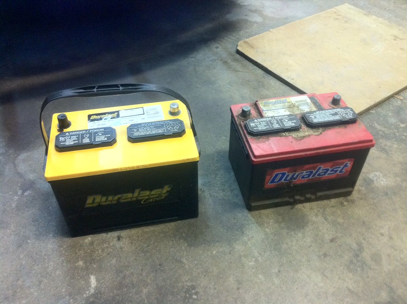

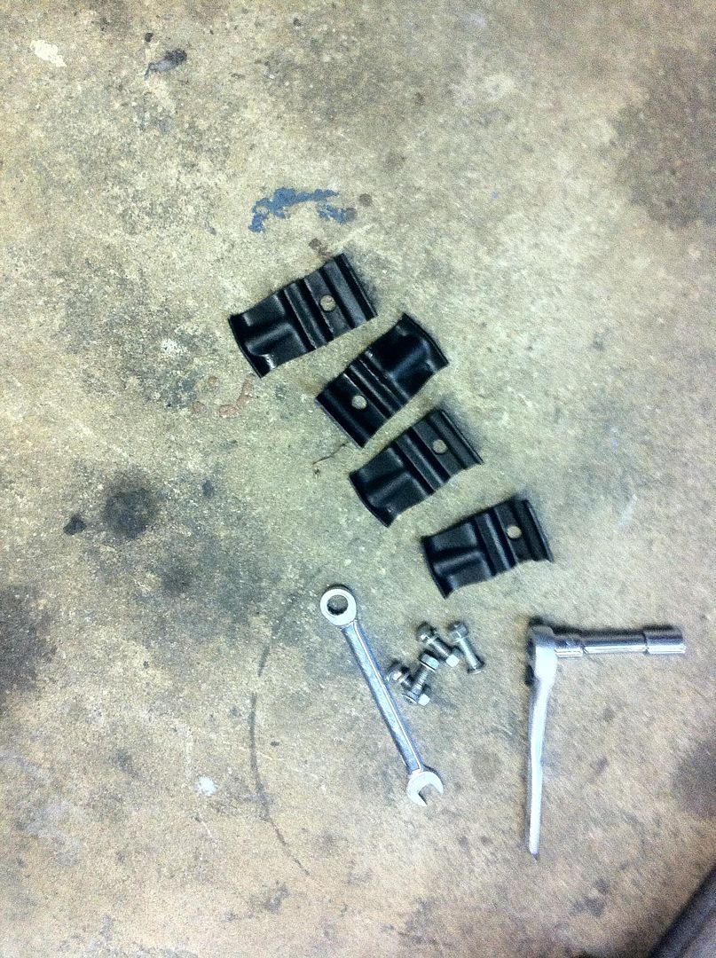

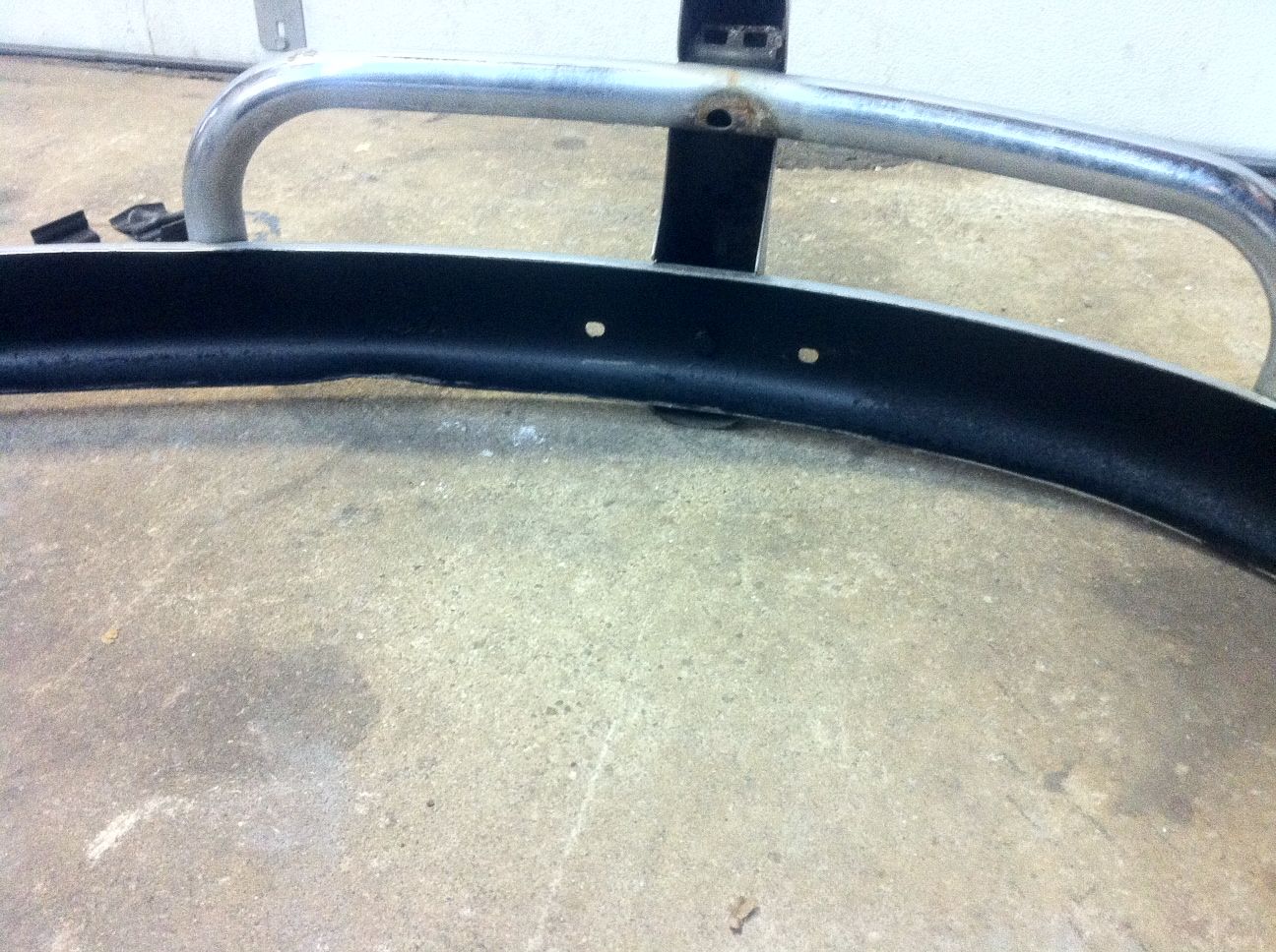

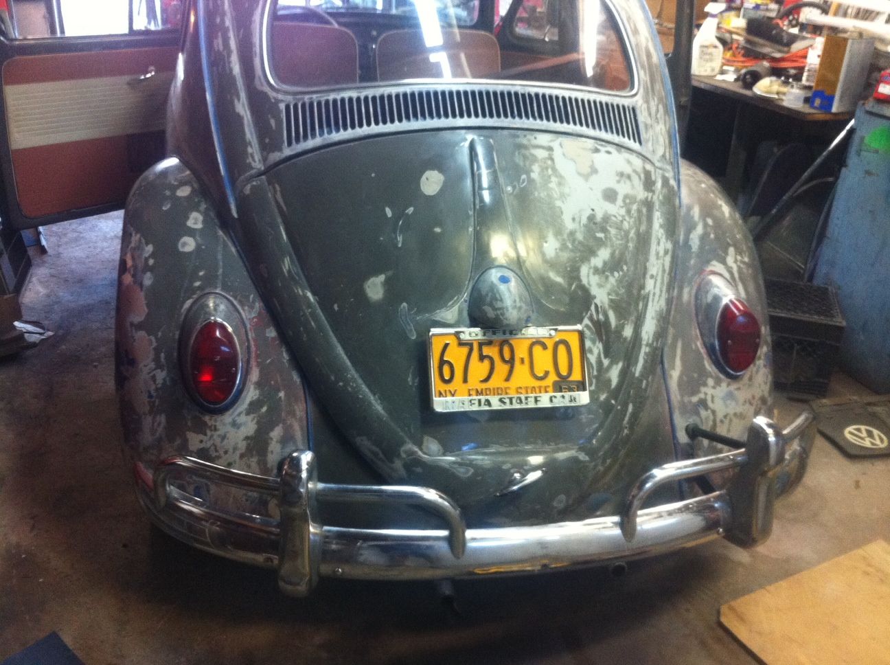

I have been busy installing a new patio door on the house so havnt had too much time for the bug.
The bug is still running good tho. She still hates the cold, and I'll have to play with that as time permits. Gave her some love this past weekend.
got the rear bumper spacers off TS, painted flat black with EW rust encapsulator
painted the inside of the bumper black
battery has been iffy lately, and had to resort to the emergency jump pack for help a few times more than i liked. Got a new battery with 3 year replacement.
finished product with 'new' bumperette, vintage NYS plates, plate frame bling

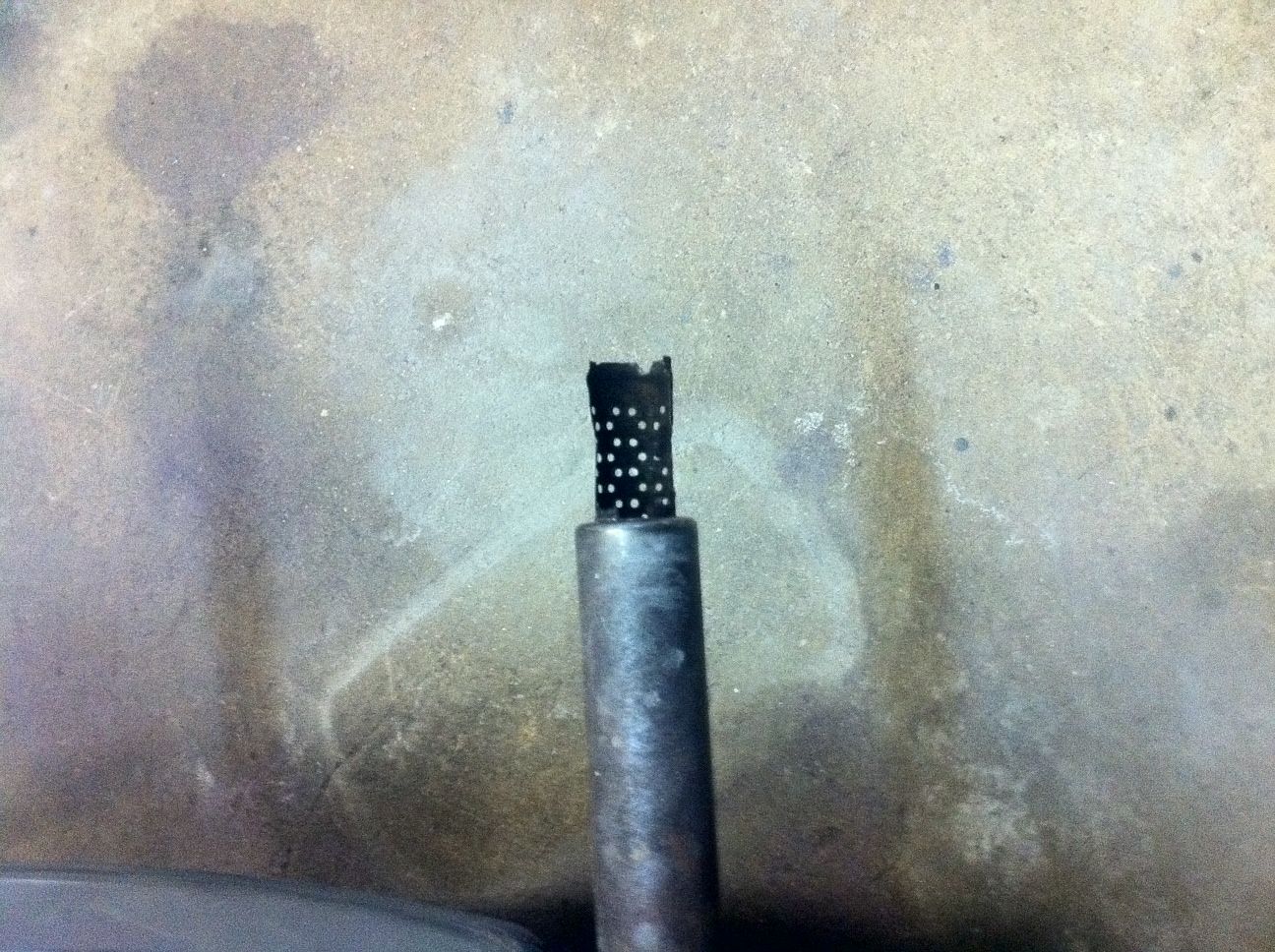

this damn exhaust tip inner just wont jump! F'in thing is rattling around like crazy. Be warned all you tailgaters!
