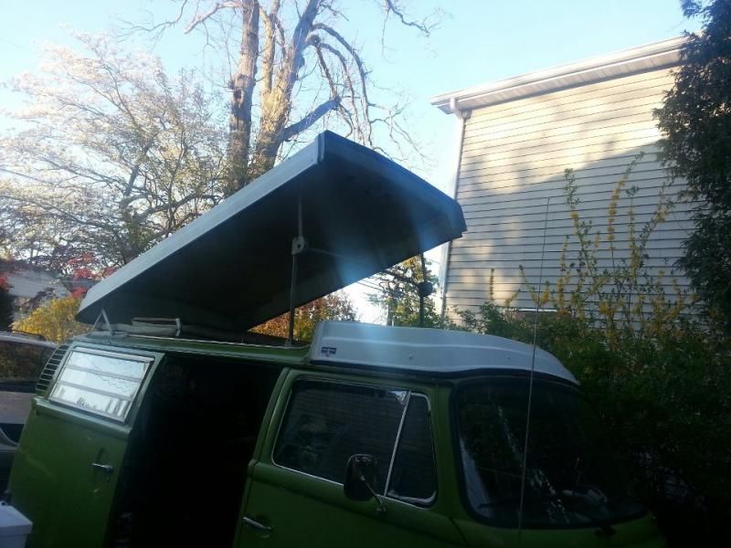

Rob, take detailed pics of where/how the canvas attaches at the top and bottom.
I'd like to replace my canvas soon. I'd like the OG yellow style...

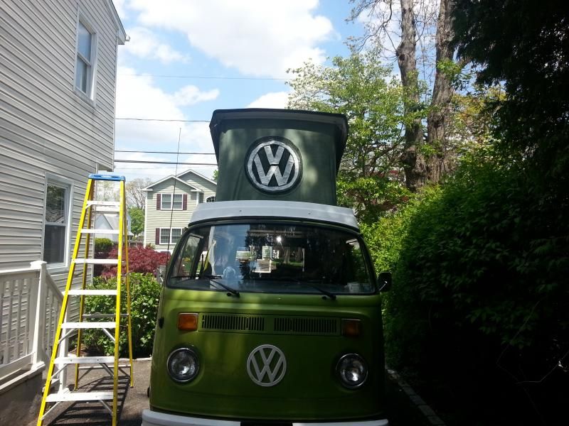

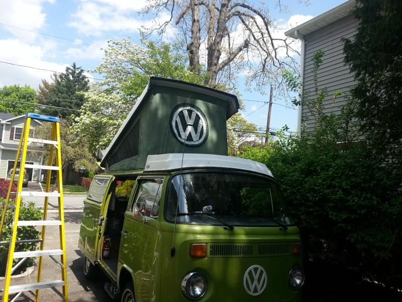

Can't afford a new tent right now, so why now "reimagine" the old one?
Re: Rob's 1977 Fatty Camper
I like the logo tent ! Wonder why VW didn't think of that ?
Because VW didn't build it...
