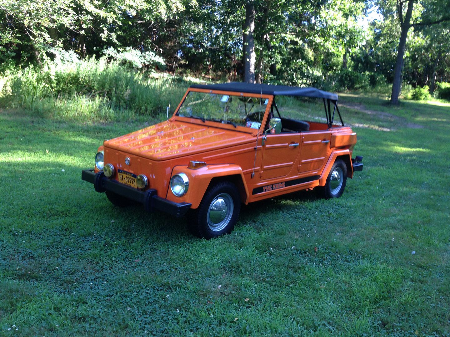

Latest project some of you saw at St pats parade.
Finally got it on the road and have been working out the kinks. So nice having one the wife likes!
Still sorting through some electric kinks, but all in all, She's good to go.

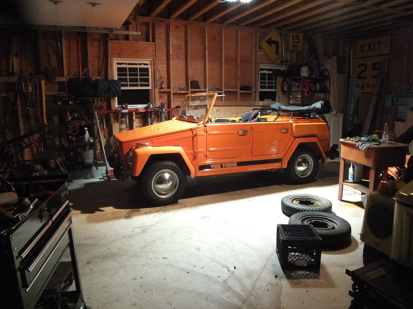

Havent done anything to this poor thing... she needs some loving!

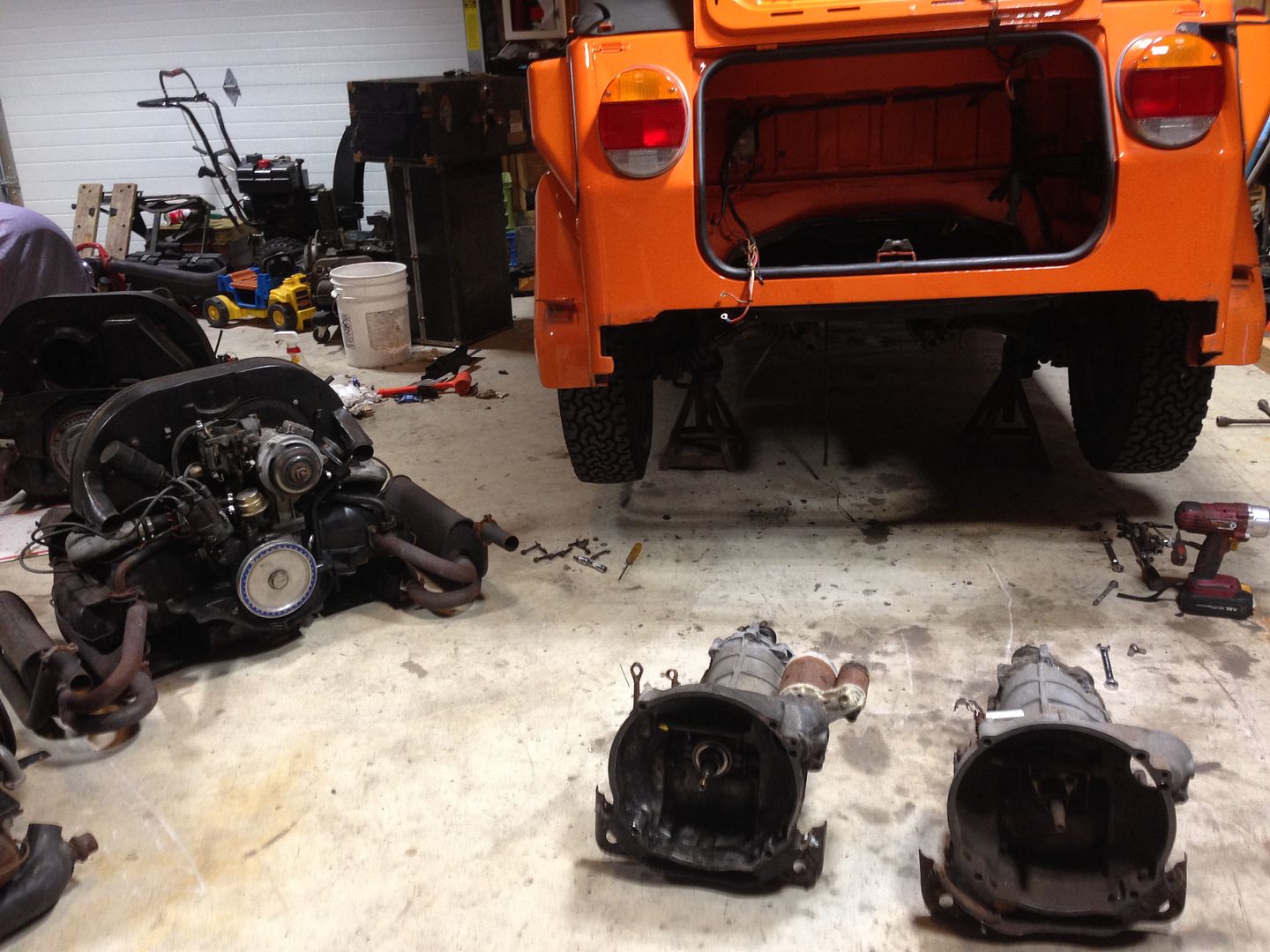

I want to put its motor back into the baja, so that has to come out. While Im in there, the tranny that is in there grinds and pops out of reverse, so I'll replace with the White Camo one. I want to clean up the engine bay too, so its on the list; full douching and maybe replace the seal as I think it has a tear.
Longer term plan is to put in something stock looking, ( maybe even a thing only AM case). I want it super reliable, but complete, quiet, and fit the look of the car.
Im toying with the idea of a 74*88 slip in with 90.5 heads ( have all those parts ready to build), but I just fell into a rebuilt 1600, so that will be going in for now.
Moved over all the stock tin to the long black, and had to swap out the full flow filter to a stock 26mm.

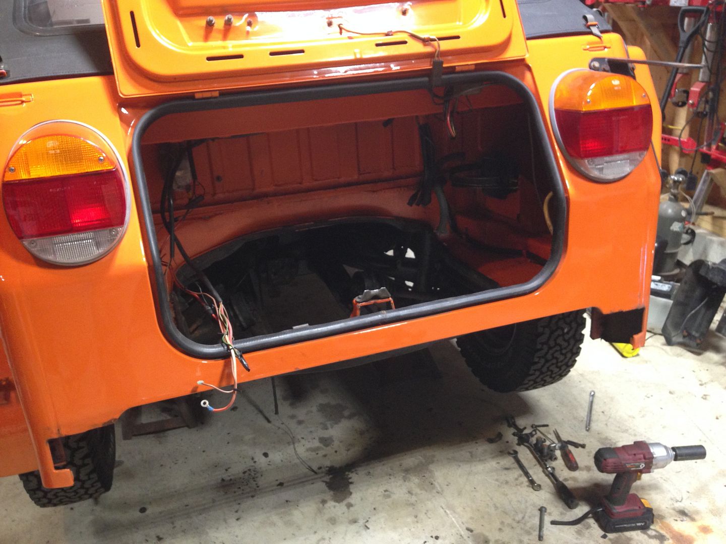

Also yanked the rear bumper and tire carrier. They are powdered but not perfect finish. So I will refinish them also to match the paint's condition.

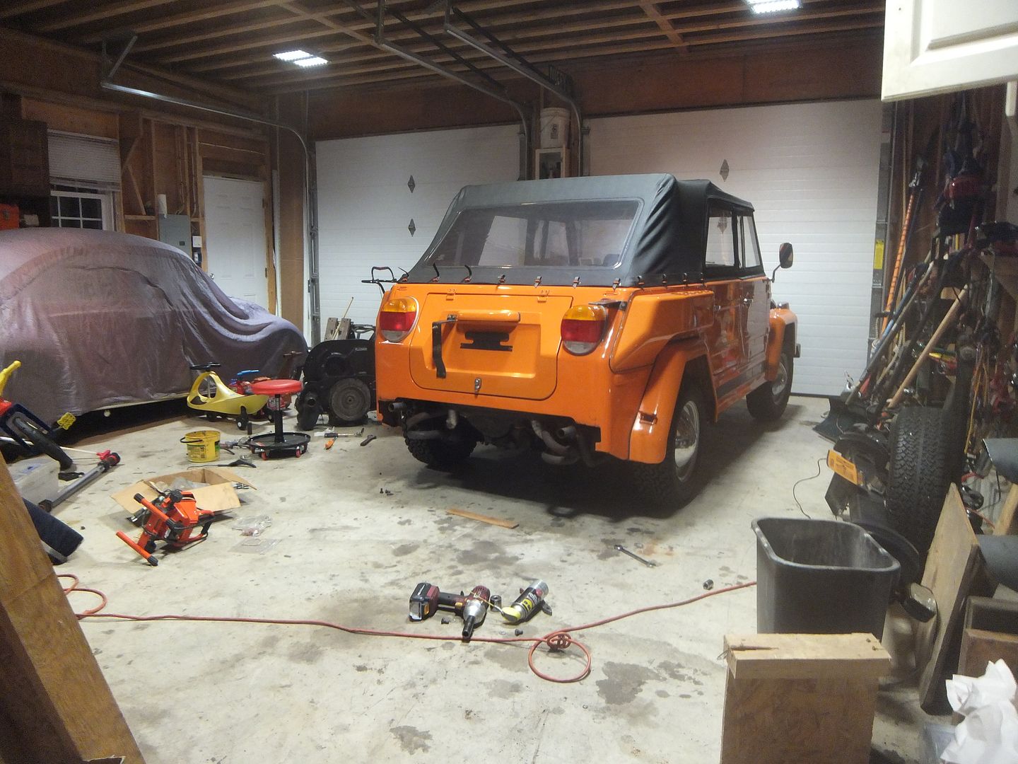

Re: 74 thing

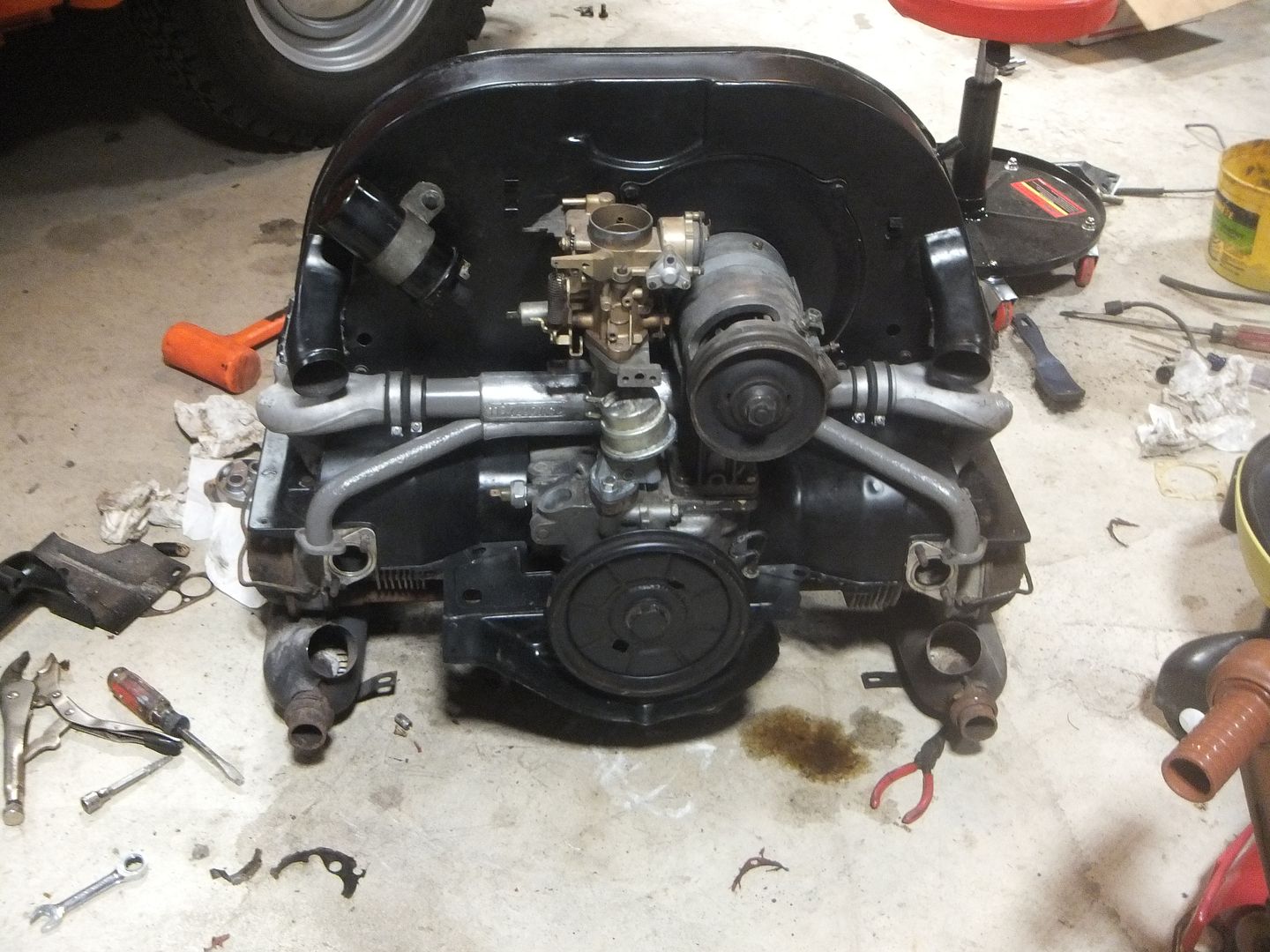

Made some progress the other night, but had to cut it short as the smallest beast isnt falling a sleep as great as he once did.....
need to tidy up the engine bay as the motor that was in there had a minor oil leak.
Old trans out, and trans thats going in needed a good douching and replacement clutch return spring.

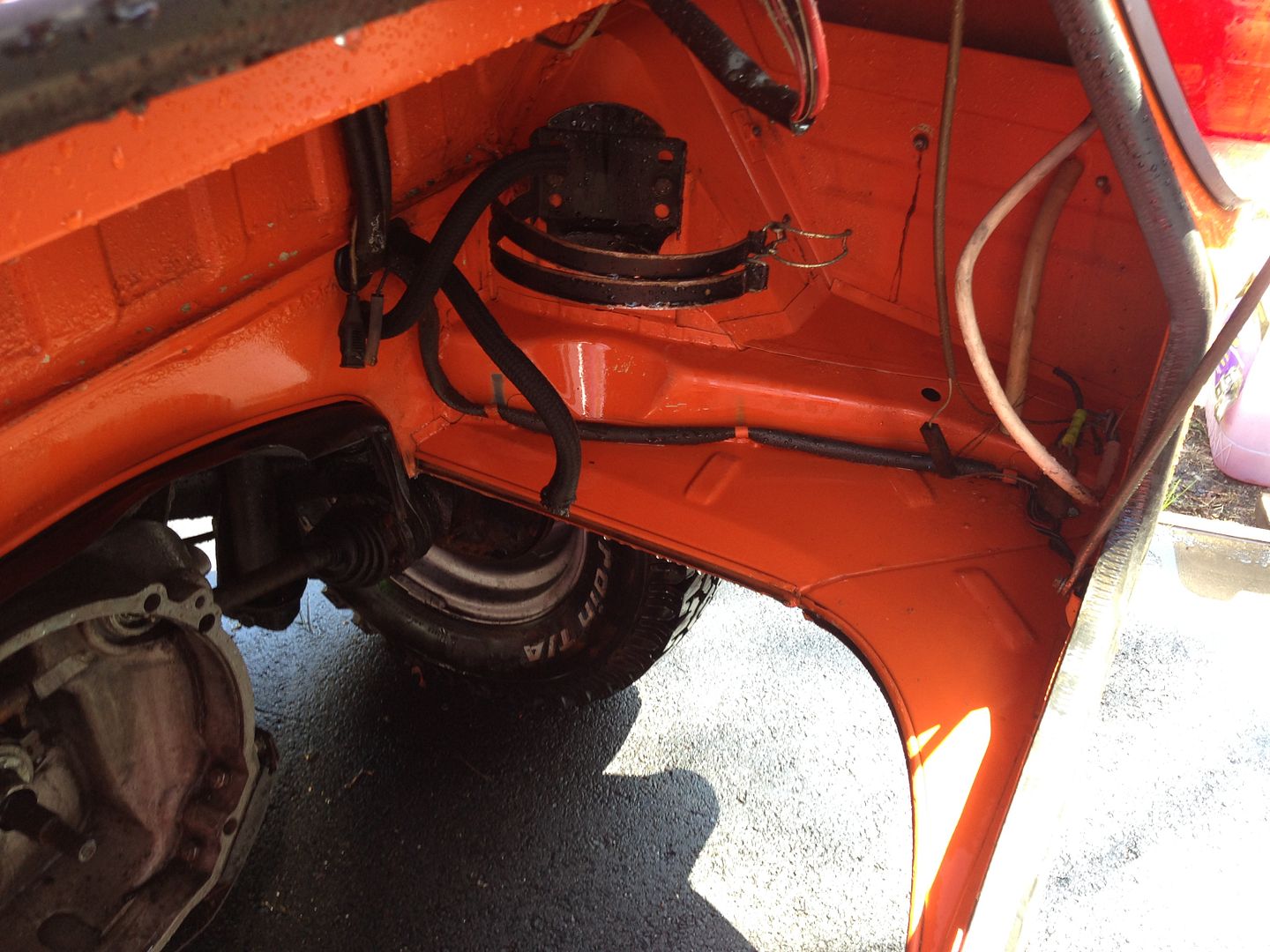

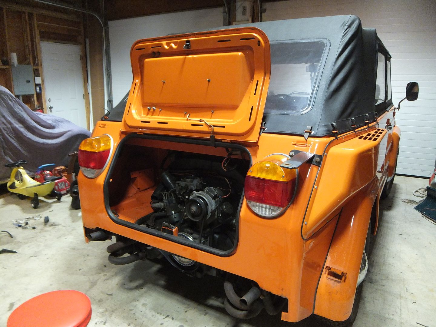

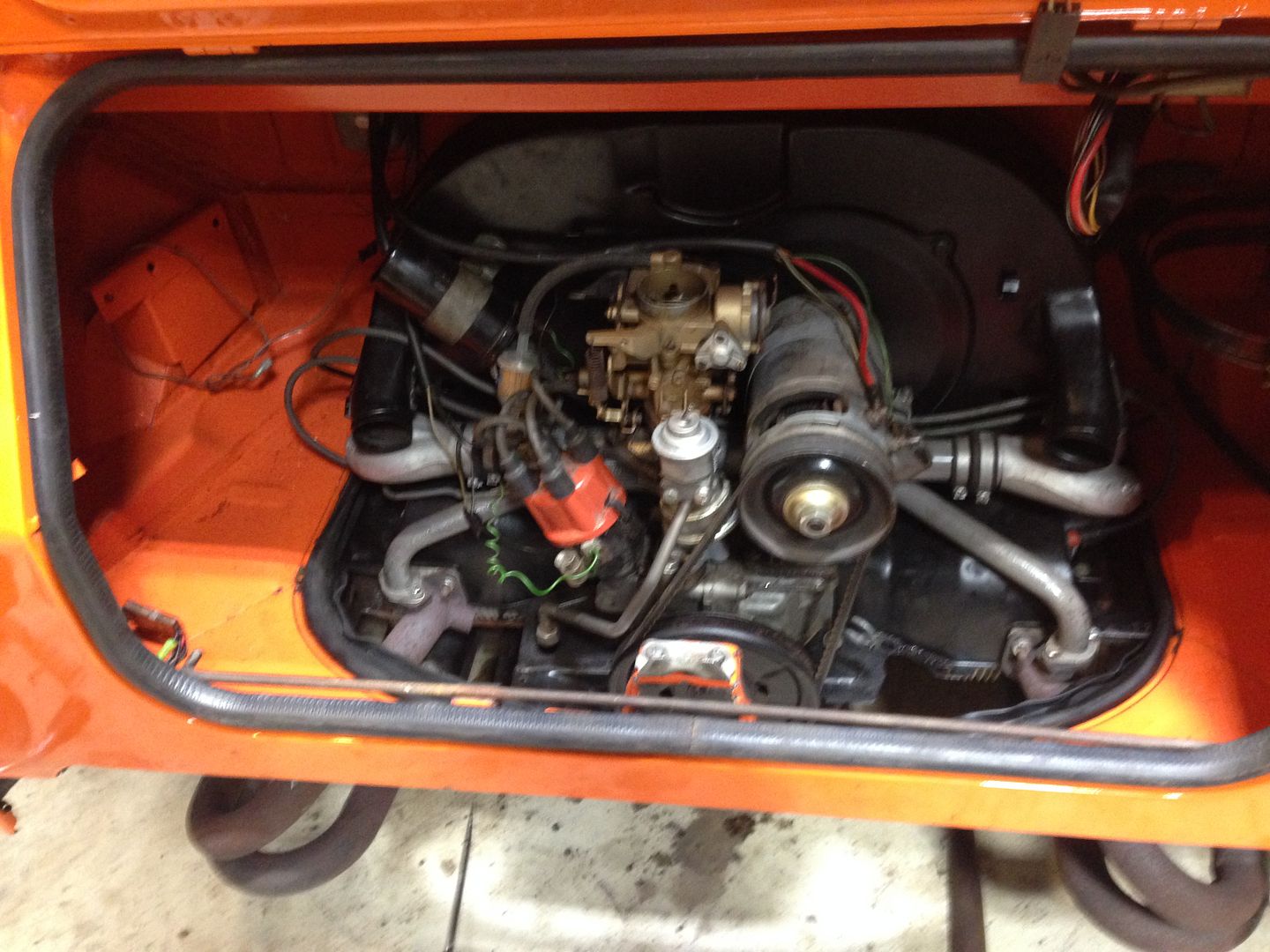

Sunday I cleaned out the engine bay and yanked the old engine bay seal.
Installed the new seal this week and dropped in the motor and trans.
Had some issues with the 009 and 34 carb that was on there, so been playing with alternatives I have. Hoping I can get it going tonight. Test drive to work tommorow. Then newsday on Sat. Fingers are crossed!
Re: 74 thing
Put in a 019 and swapped carbs. Drove to work today... not to shabby. I think it will make it to Newsday tomorrow, and then next week I'll keep fine tuning the motor.

So far so good. I have a freshly rebuilt carb that is giving some issues, so Im planning on sending that back to the re-builder. In the meantime, its doing ok as is. Still painting some tin, and reinstalling some little parts that it should have. New plugs are on deck, along with a compression test to see how she is feeling.

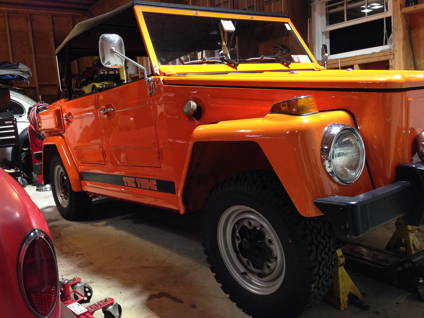

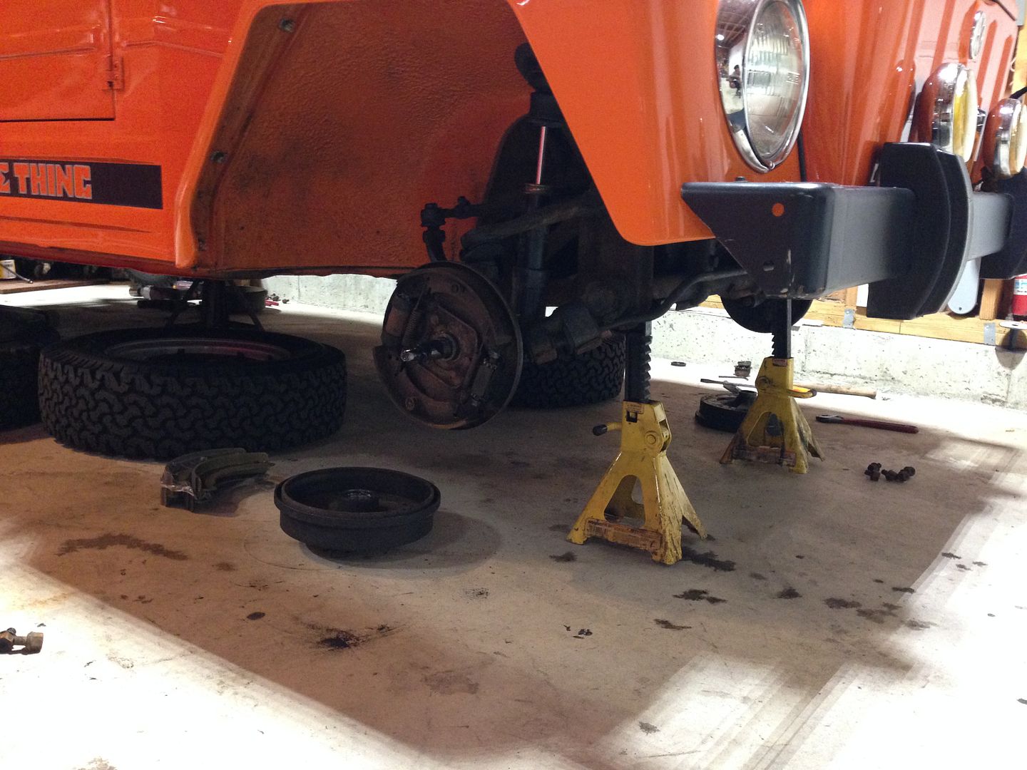

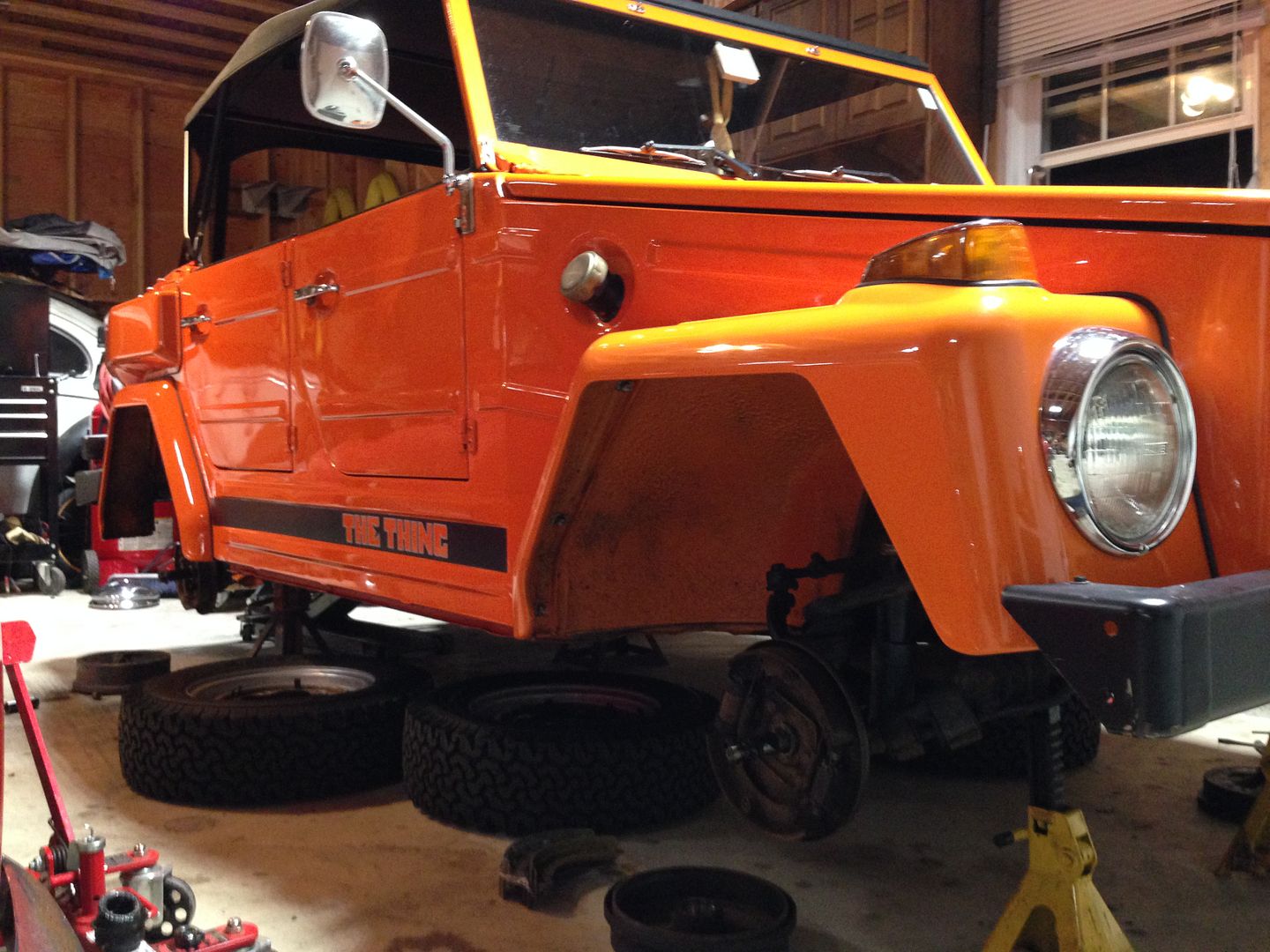

The thing has been good to me this summer. So much better with the provided shade of the bikini top. Brakes have been a little subpar so I I ordered some shoes and wanted to freshen it all up.
Tossed her up in the air and yanked the caps.
Yanked the shoes.
Pulled the drums and dropped them off to get turned.
Been using Rockauto.com for all my maintenance lately, great prices, selection and delivery. These are centrix shoes, who even offer front thing only shoes. You can use the rears in the front, but the rears , of course, have the slot for the spreader bar. I was surprised to see the fronts were really made for the front.

Day #2 of having her back on all four. Drove it to work again today. Brakes are starting to bite better. I'll tighten up the shoes this weekend and see what happens. I notice the Ebrake sits higher then it was so I thats making me think that the rears def need some attn.
