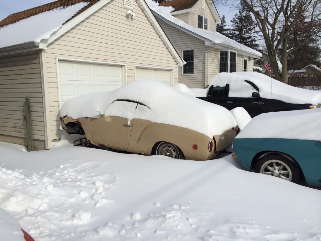

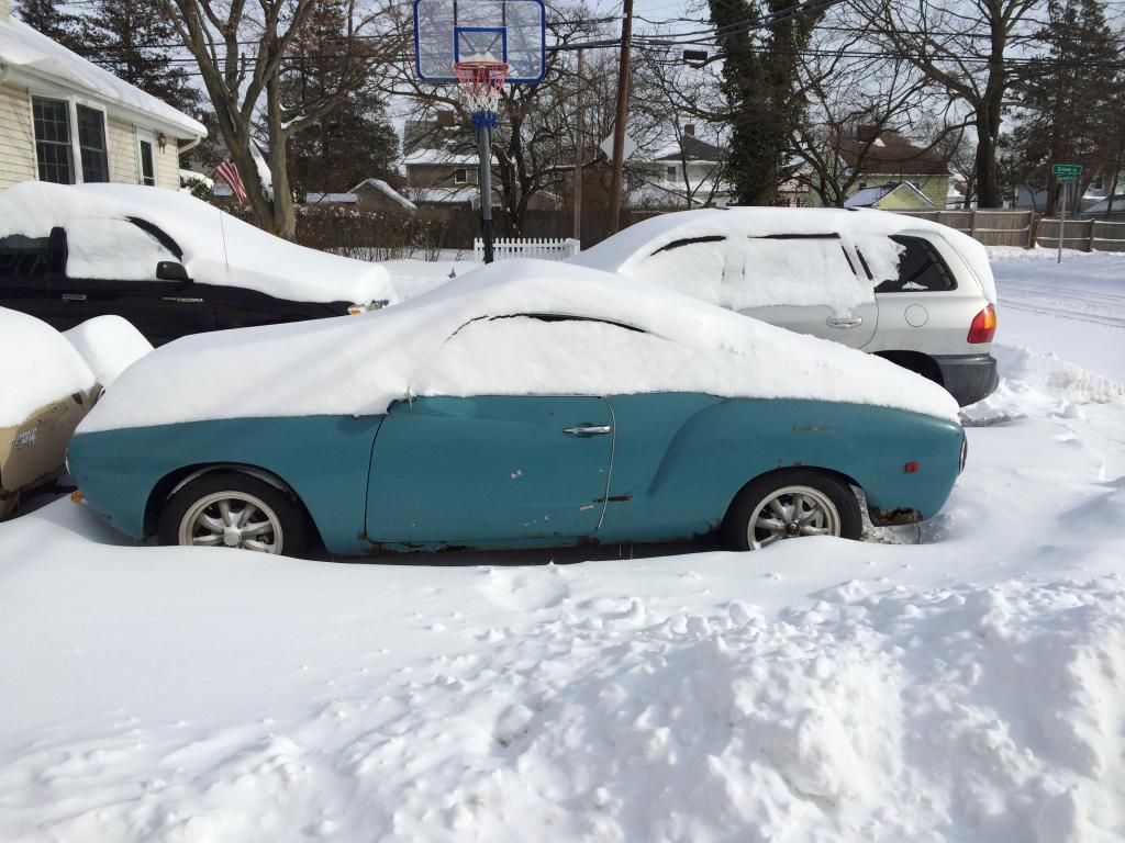

Over the weekend while up at my parents i picked up another 68 Ghia to use for parts to build the blue 68 but in looking the car over, other then the front driver fender which was hit with a snow plow the car seems to be in better overall condition so i may use that as the car and take the parts i need from the blue car.
here is a shot of it getting towed back to my parents
http://farm9.staticflickr.com/8566/1613 ... 0c44_b.jpg
https://farm8.staticflickr.com/7507/161 ... 1e56_m.jpg
https://farm8.staticflickr.com/7543/159 ... 3791_m.jpg

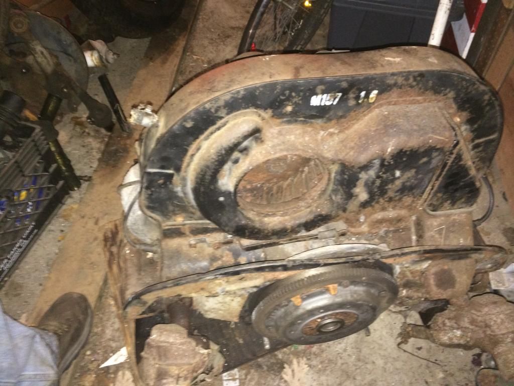

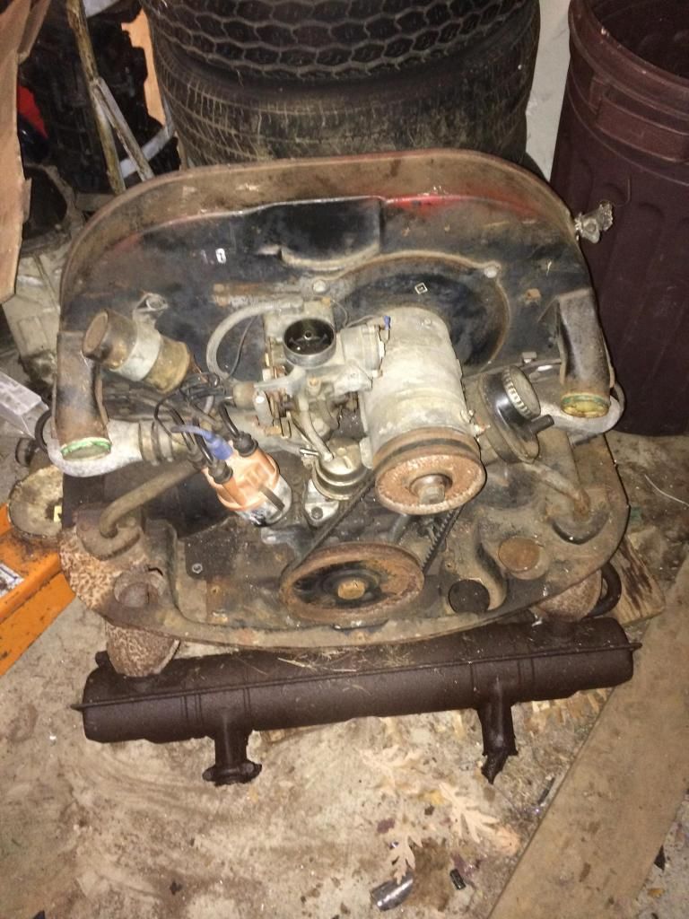

I posted this before but no one answered!
I removed the engine from the Blue Ghia and want to remove the shroud to be sure there are no nests built in there. I plan on removing all the tins decreasing and cleaning all the fins .
Is there anything else i should do while it is out a stripped of its tins?

Re: 68 Ghia
Brown wrote:I posted this before but no one answered!
Thanks
sorry!
Not sure how nutty you want to go. If thins thing is a beater roll it as is!
If not.....
- check the hoover bit
- foam around the oil cooler
- oil cooler seals ( top and bottoms)
- intake to head gaskets
- rubber intake boots ( def do.. these crack and you get no idle)
- check the end play ( either the right way at the flywheel , or at least push pull pulley)
- flaps all working
- thermostat?

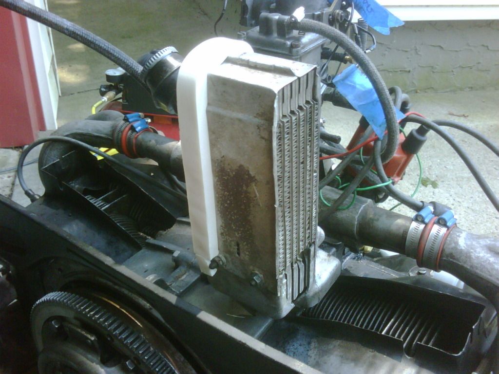

Thanks, those are all very doable. What us the foam around the oil cooler though?
Re: 68 Ghia
when i replaced my oil cooler there was a thin layer of foam that lined the inside of the housing. the foam wrapped around the sides that were solid and not where the vents were exposed.

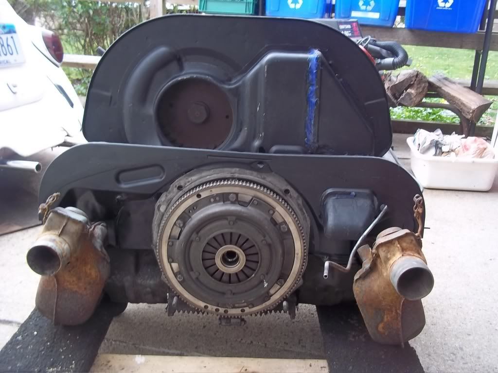

This samba thread has info on sealing up the cooler plus the position of the foam on the cooler a couple of posts down. My bus engine had a blue hard caulk to seal it which I removed when I replaced the cooler.
http://www.thesamba.com/vw/forum/viewto ... oil+cooler
This is the foam set up I used.

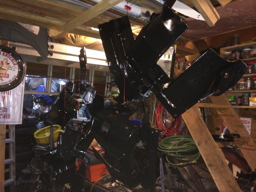

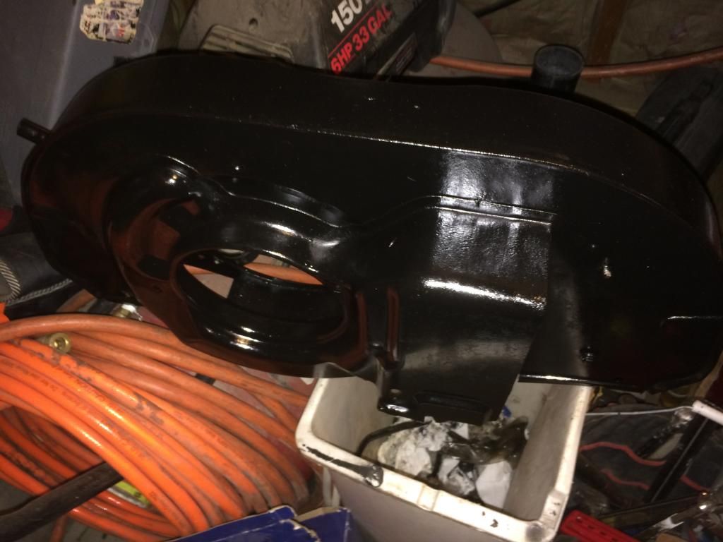

Some Pictures

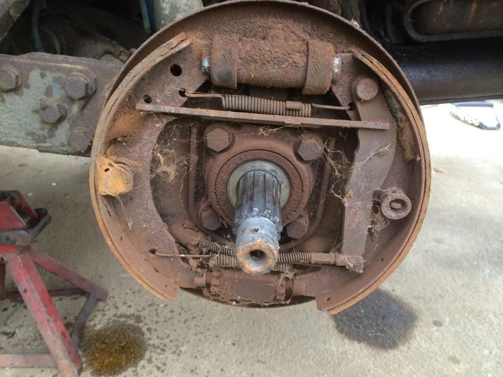

Brakes before and after swapping from orange Ghia

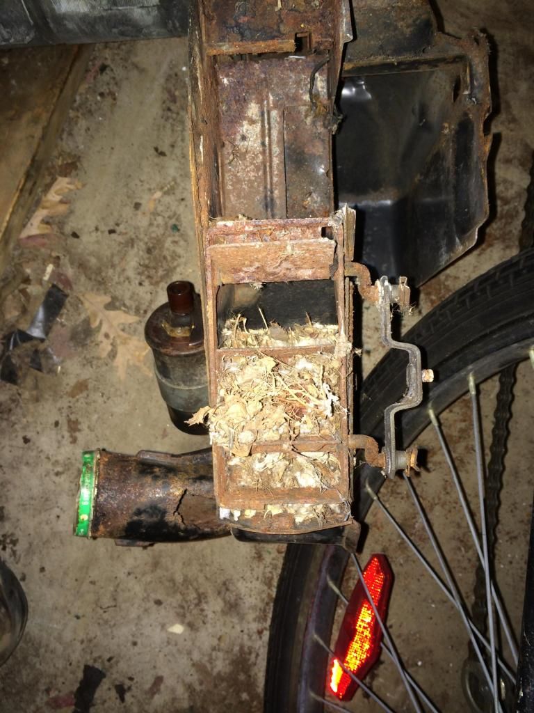

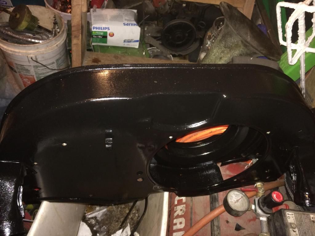

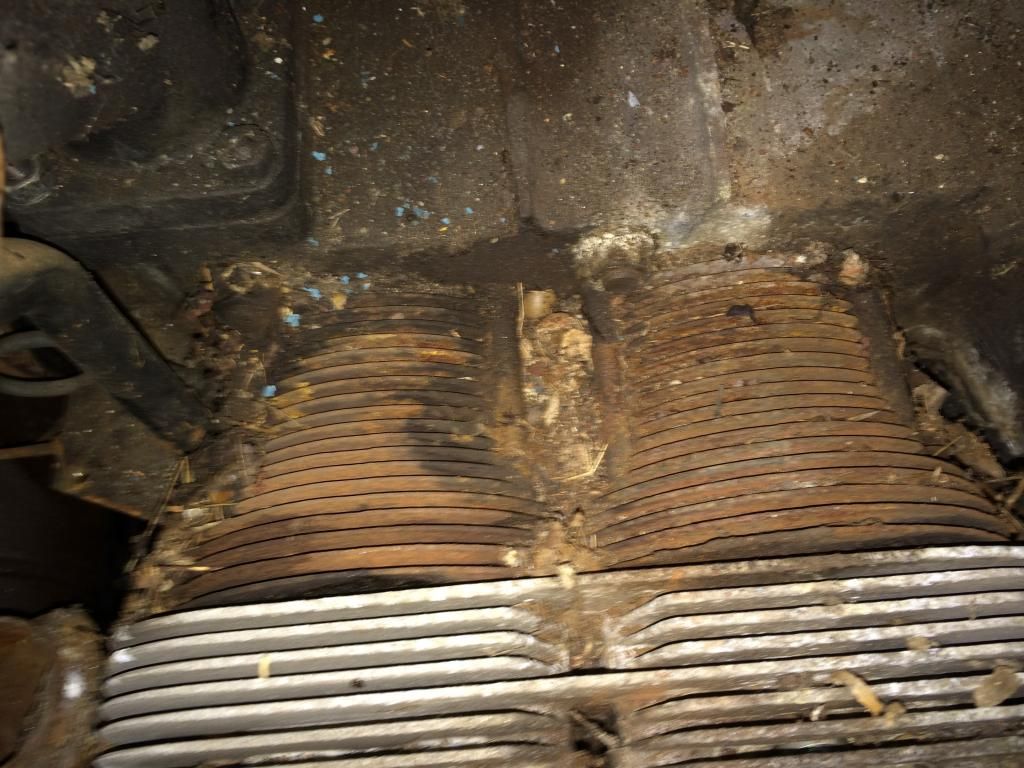

This is why i pulled the engine, to see if there were any nests in the fan shroad!
Also to clean around the cylinders for better air flow
Painted Tin's - Won't run better but will look purdy!!
Waiting for its power plant
Donor car!!
Donor car!!

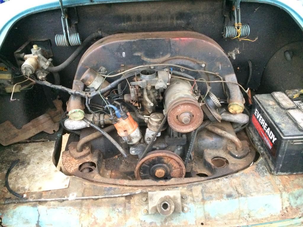

I've been working away at the Ghia swapped the steering column from one to the other and it looking at the wiring i discovered an interesting thing that i thought maybe some of our historians might be able to explain.
Both Ghia's I have are reported to be 1968 but the wiring is set up per the 1970 wiring diagram on TheSamba. I checked the chassis number for the Blue Ghia and that comes back as being built Dec 70, so i am thinking problem solved. But then i check the ID plate on the inside of the trunk and that shows it being built in 1968. The body looks like the earlier version so I am very confused. Any ideas on why everything seems all over the place?

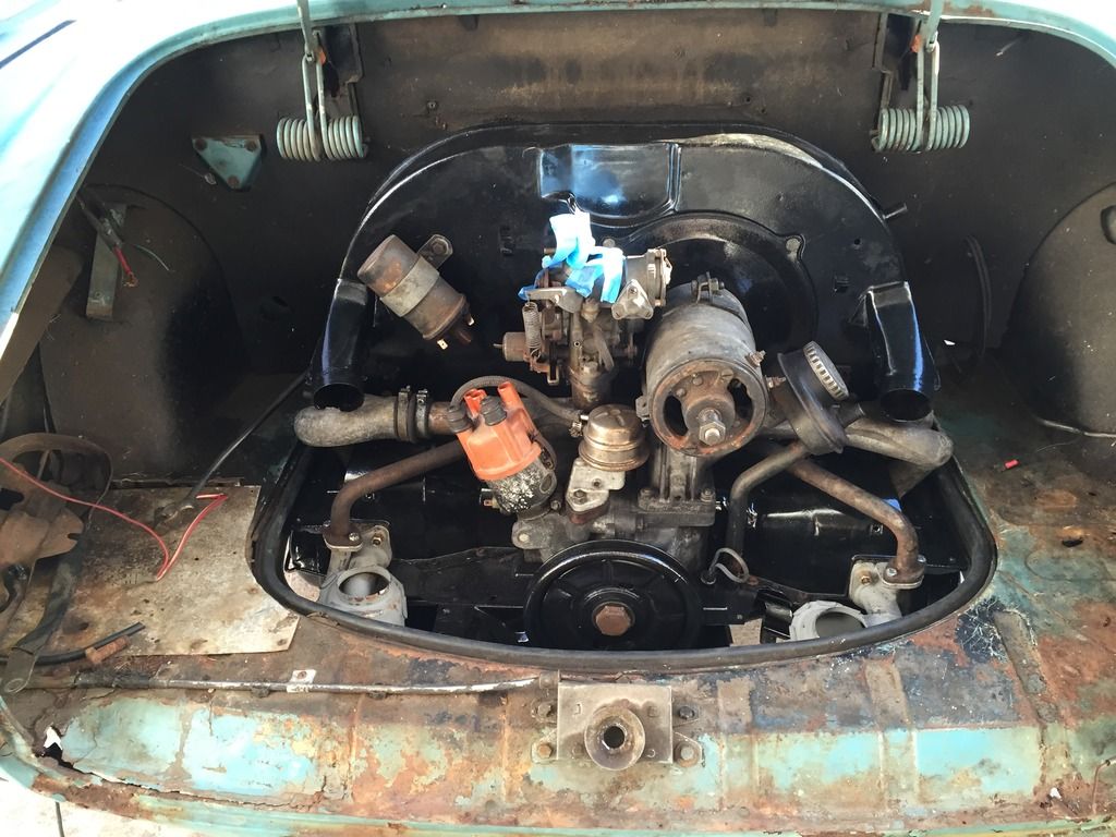

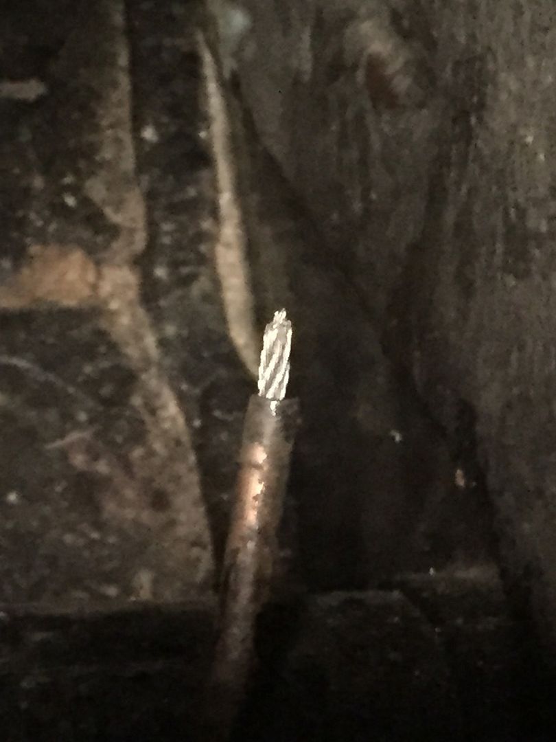

So i have been working onthe ghia whenever i get the chances and after pulling hte motor and cleaning it up i put it bck in over the weekend.
After putting it back in and fixing the wiring i got it to run by pouring gas intot he carb but it would not run off the tank. After playing around with the filters and soft hoses it turned out the metal line through the chassis was clogged in two places, front and back. Using copper wire and steel wire and the cable that supports the garage door and some carburator cleaner i was able to free up both clogs and roto route the pipe. The engine starts right up and runs.

Here is my roto router setup. Garage door cable installed in cordless drill
End of cable poking out of the gas line by the tank. I was happy
to see this pop through!!

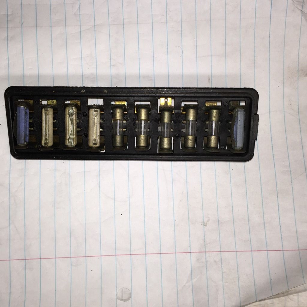

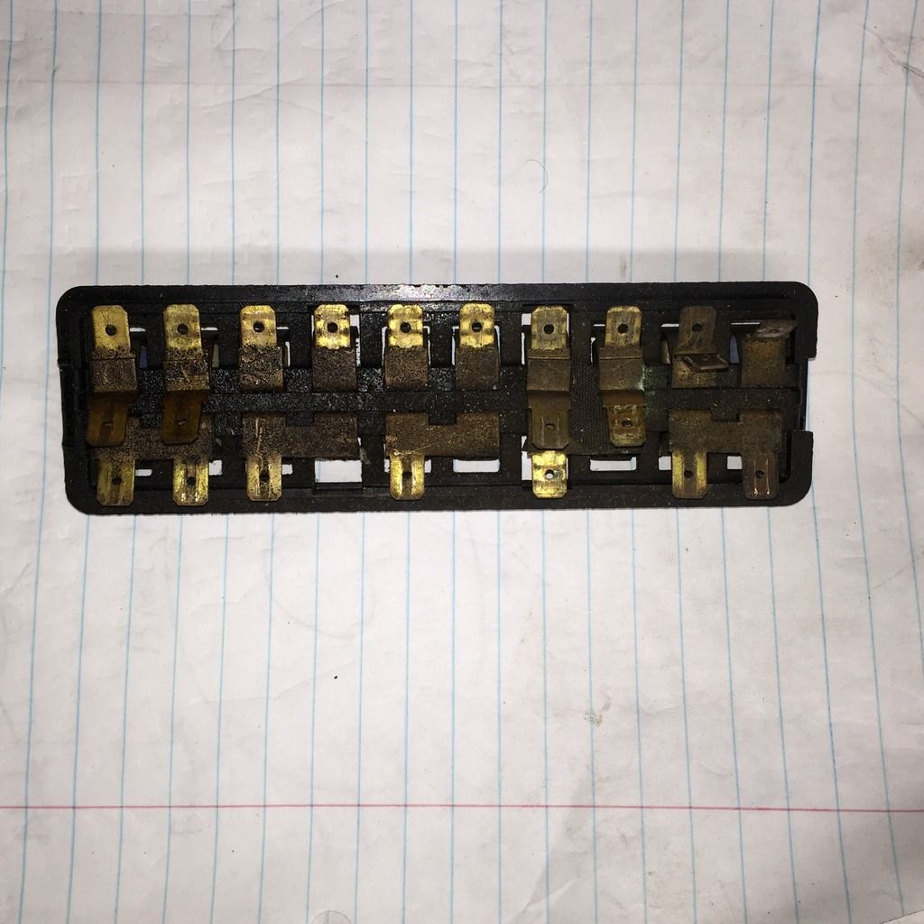

Electrically I have the following issues.
No emergency flashers or turn signals
Starter switch does not work in accessory position.
No headlights
No horn
No generator light when the car firt turned on.
Thougt the best was to start to trouble shoot the electrical isues was to pull out the fuse holder and give that a good cleaning. Marked all the wires, took abunch of pictures and yanked it out.
Hear it is right out of the car.
No headlights
No horn
