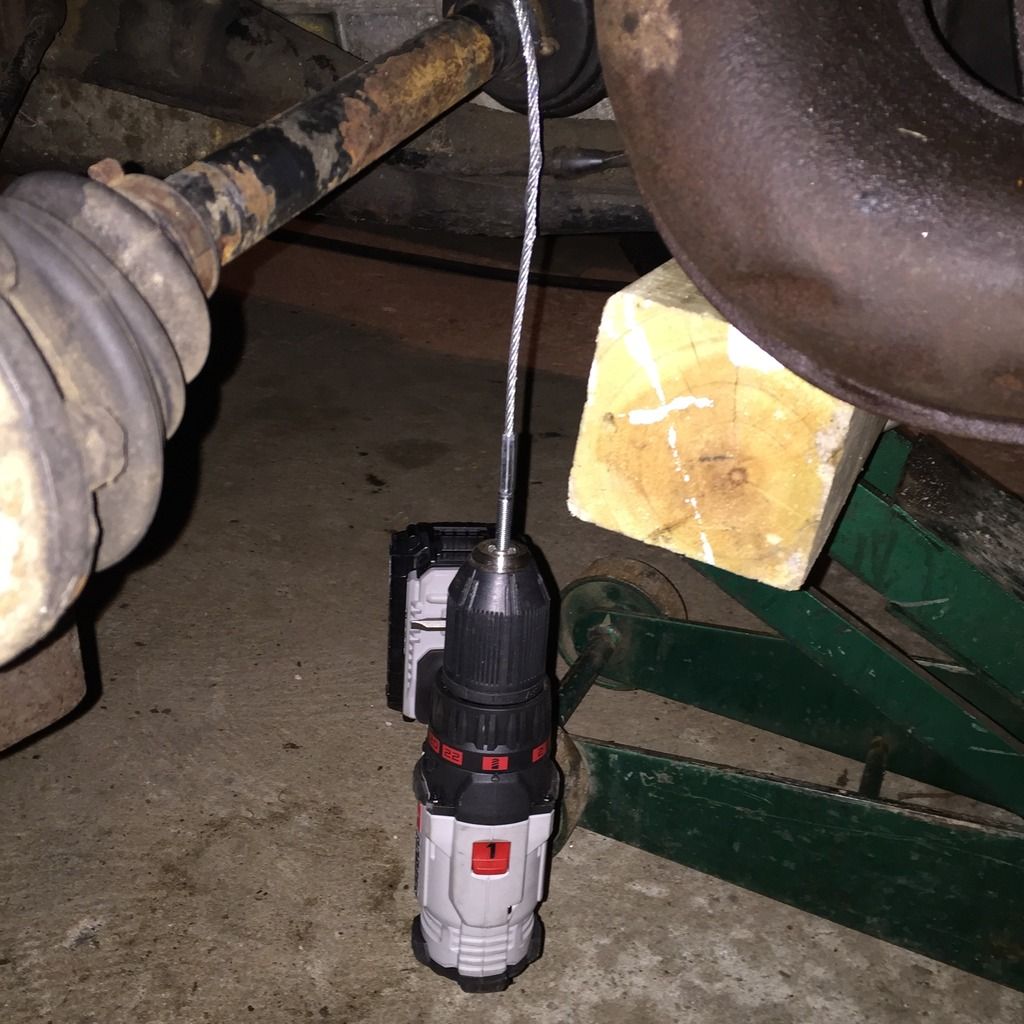

How is the cable secured to the drill for future reference? Nifty idea!
Re: 68 Ghia
Looks like a clutch cable with the tranny end in the chuck.
Re: 68 Ghia
The of the cable has a threaded rod attached, very similar to the clutch cable, although it is a garage door cable. The drill holds it just like a doll bit!

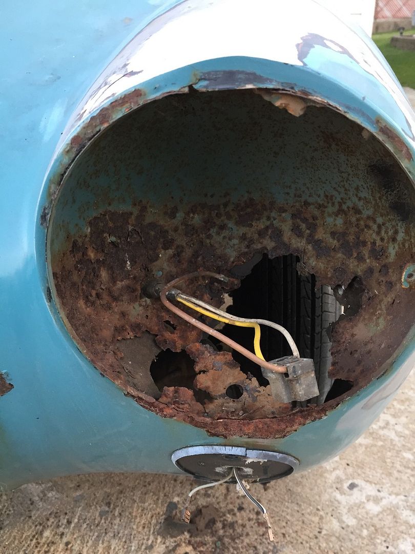

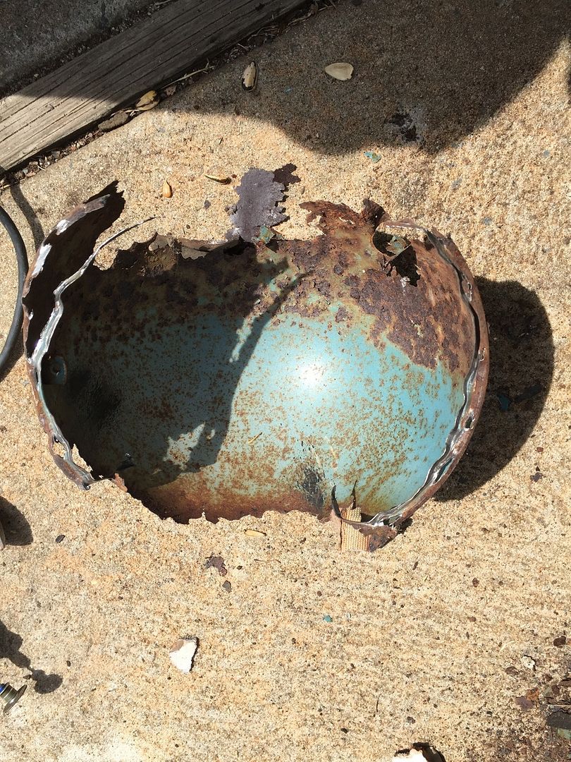

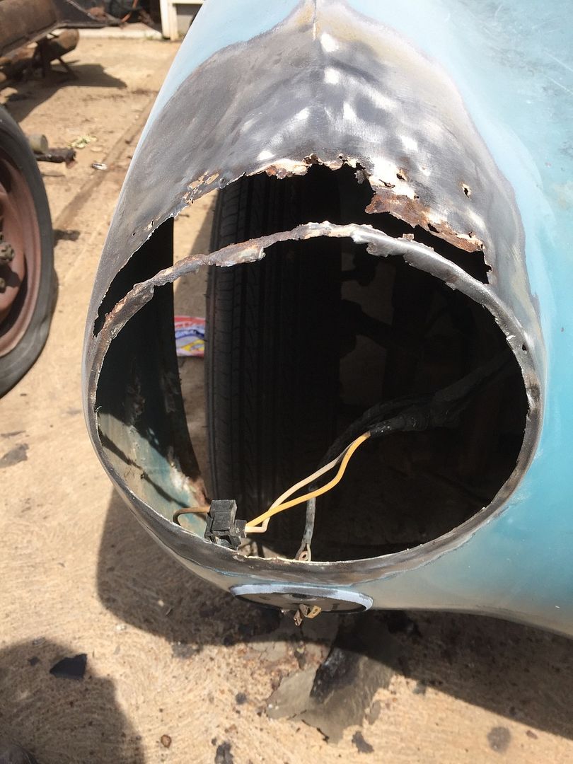

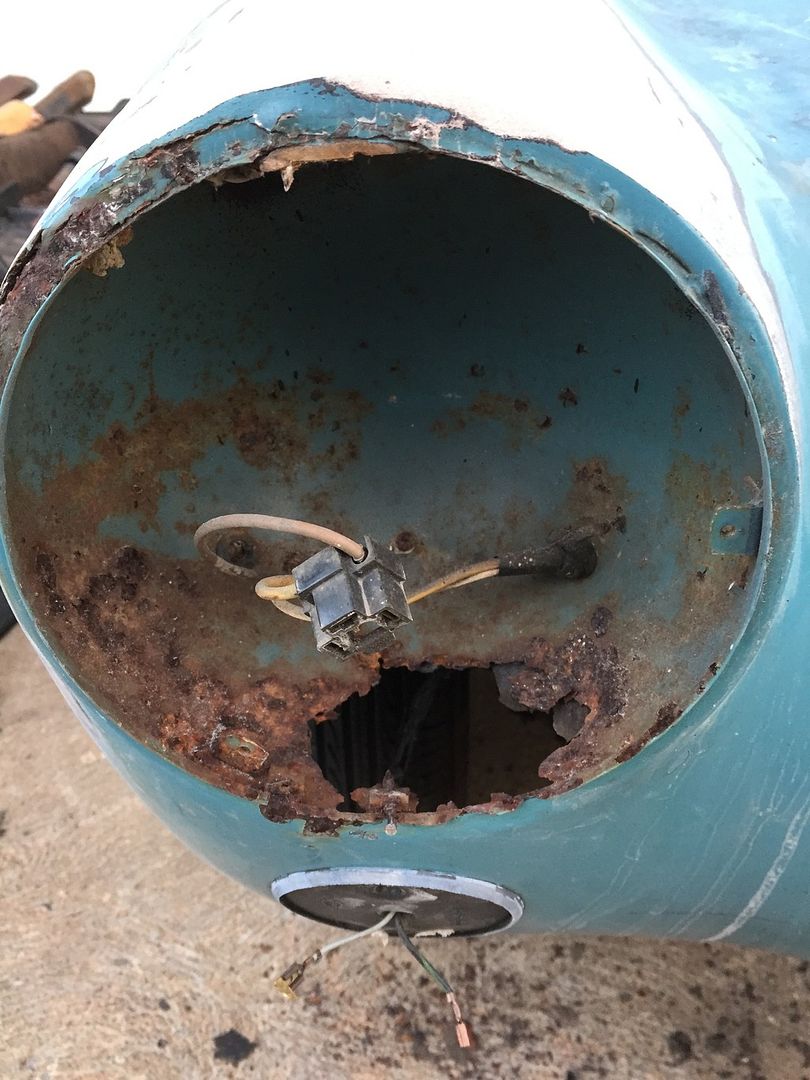

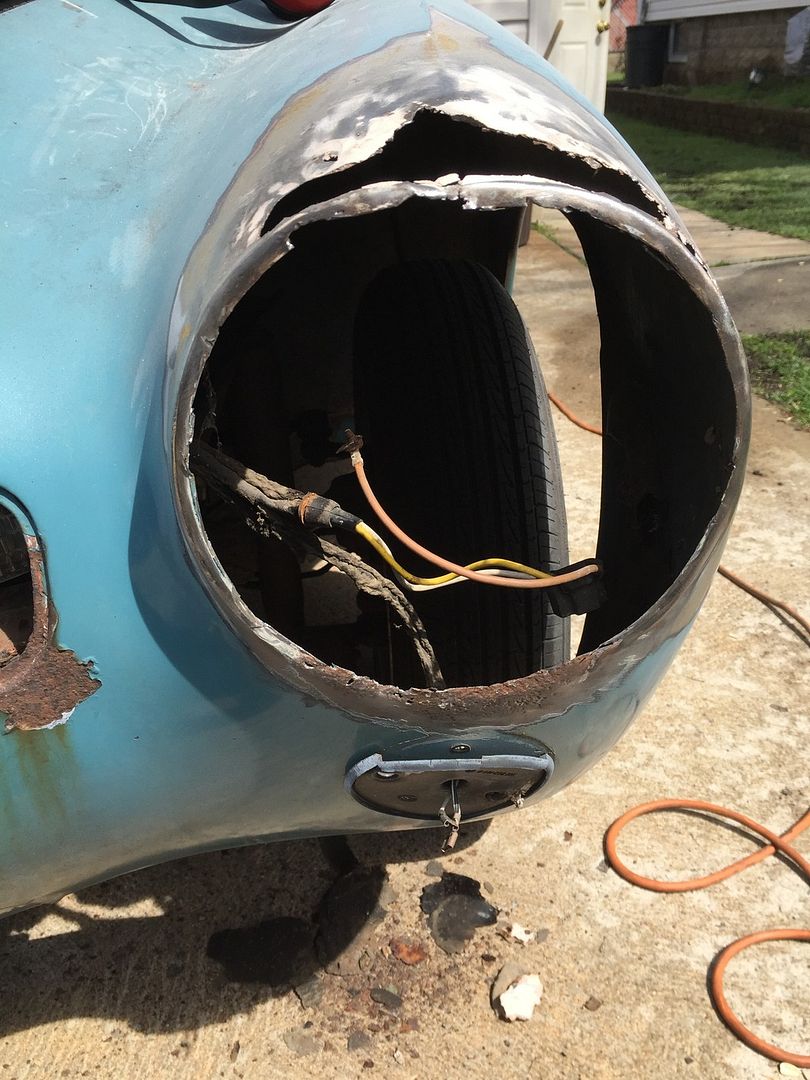

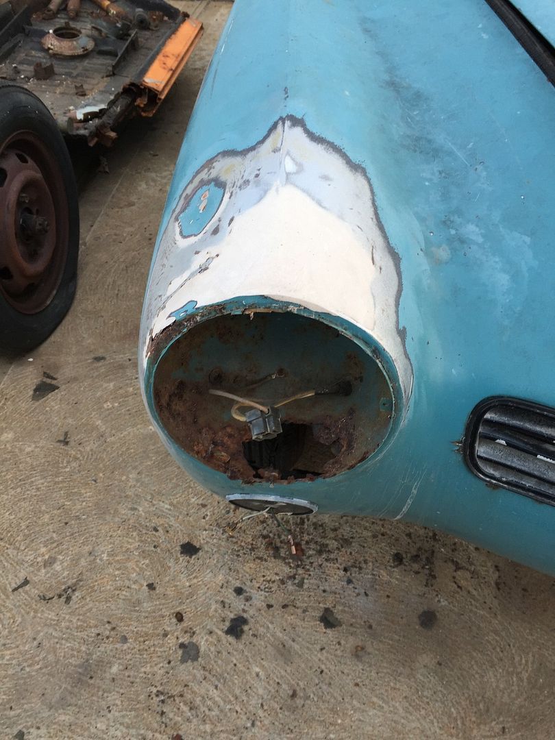

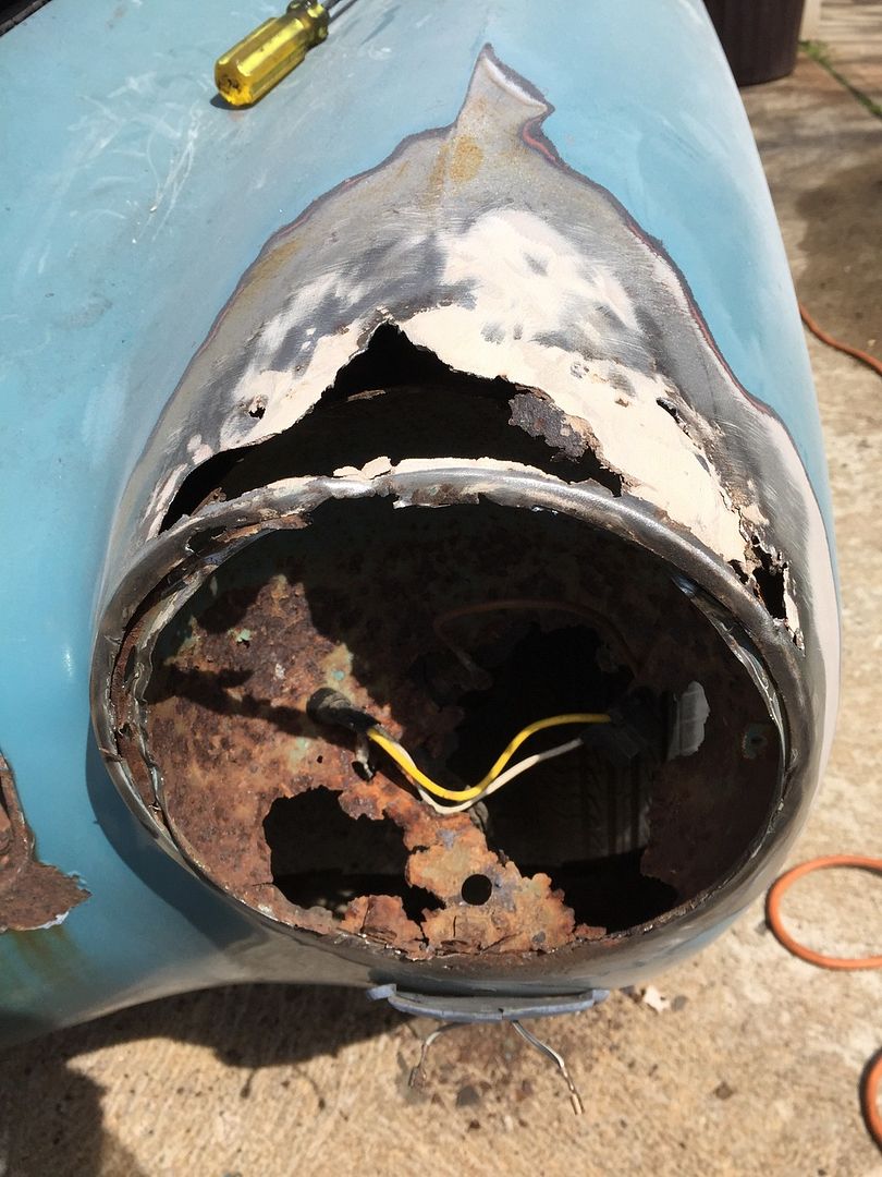

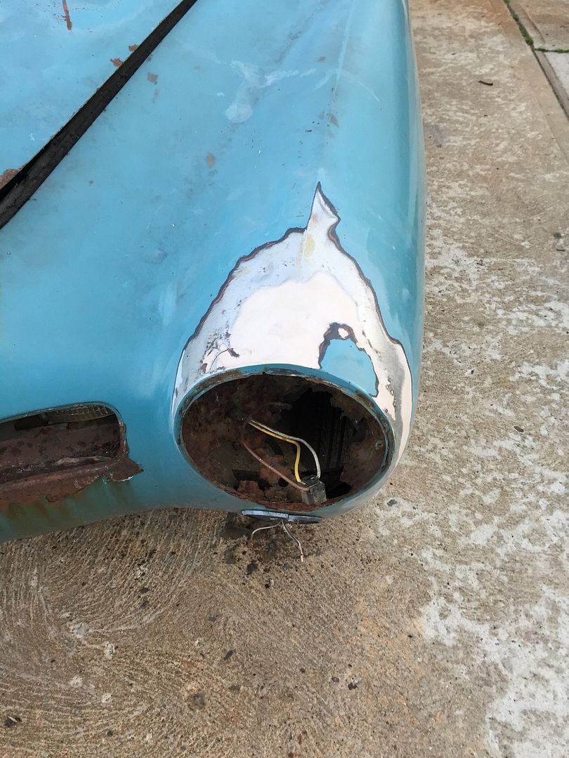

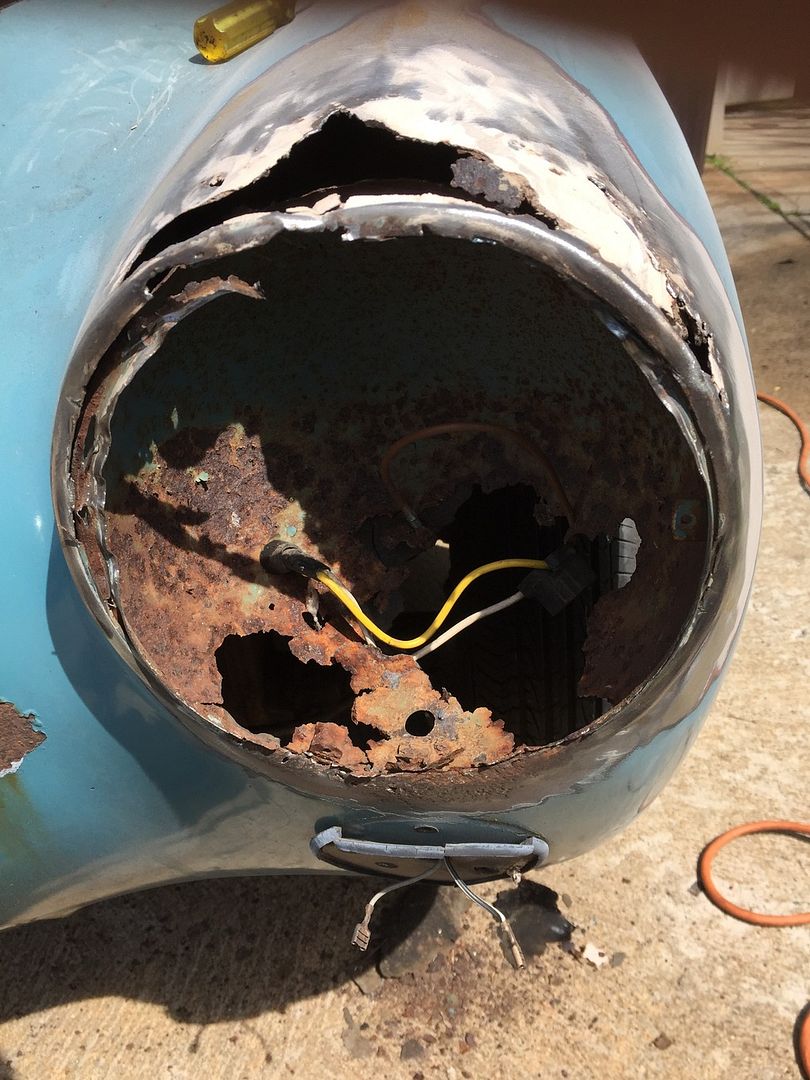

When I decided to replace the headlights i discovered the buckets were a rusted mess and there was nothing left to screw them back into. After panicking for a day and doing some reading i decided to remove the old buckets and weld in some from the parts i had and then i will need to patch the top of the fender over the lights that rusts out. The car was filled with bondo so i did not realize how bad it was under the paintt.
Hear are some pics
Hear are some pics
Re: 68 Ghia
Any before pics? Very scary as you never really know what lies beneath existing paint.

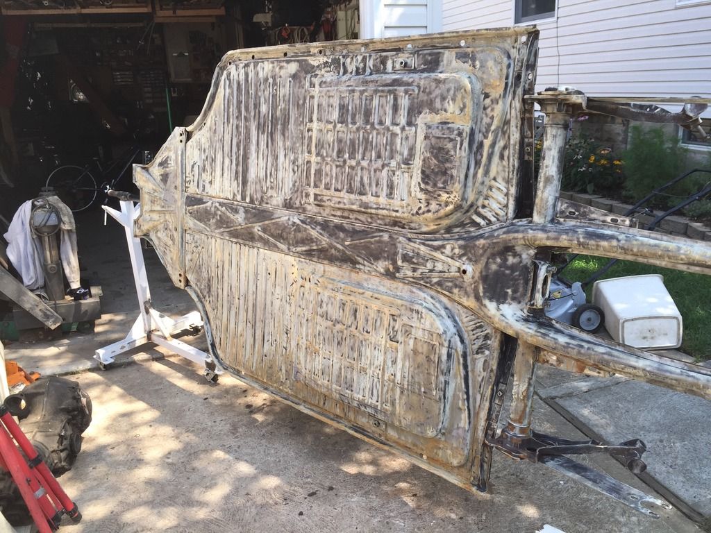

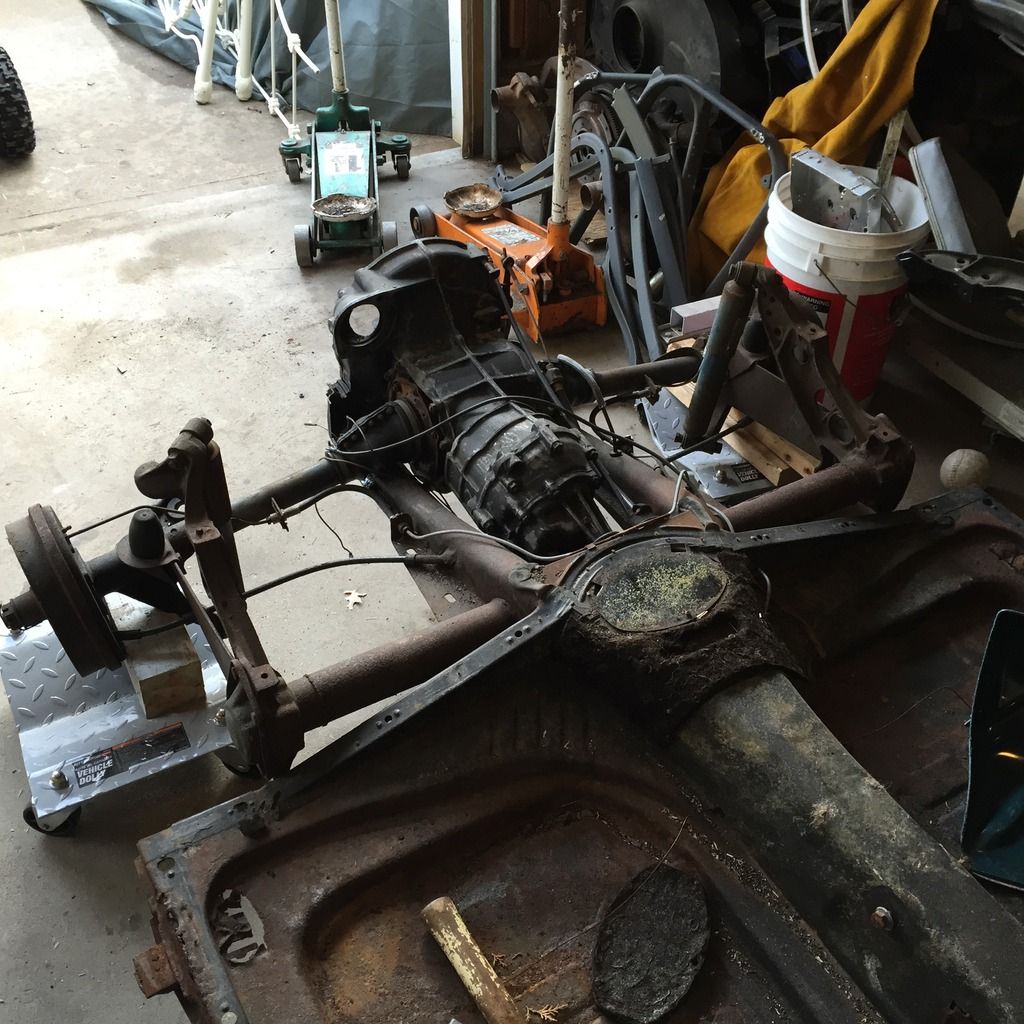

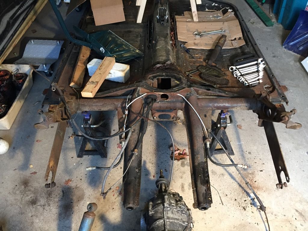

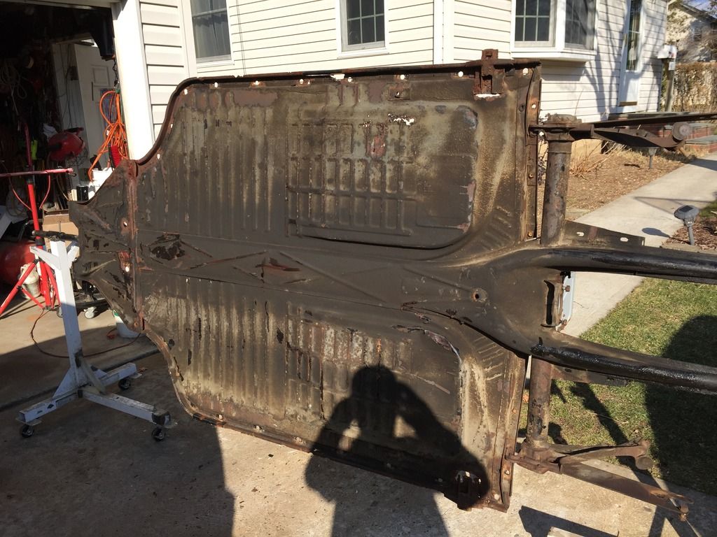

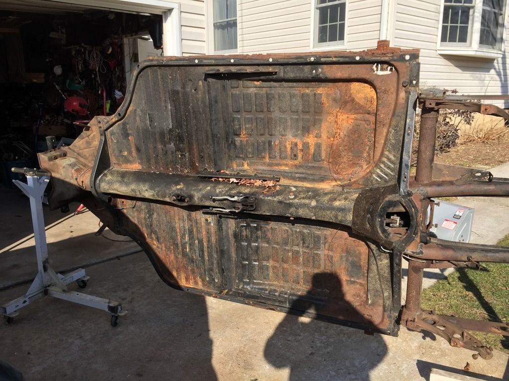

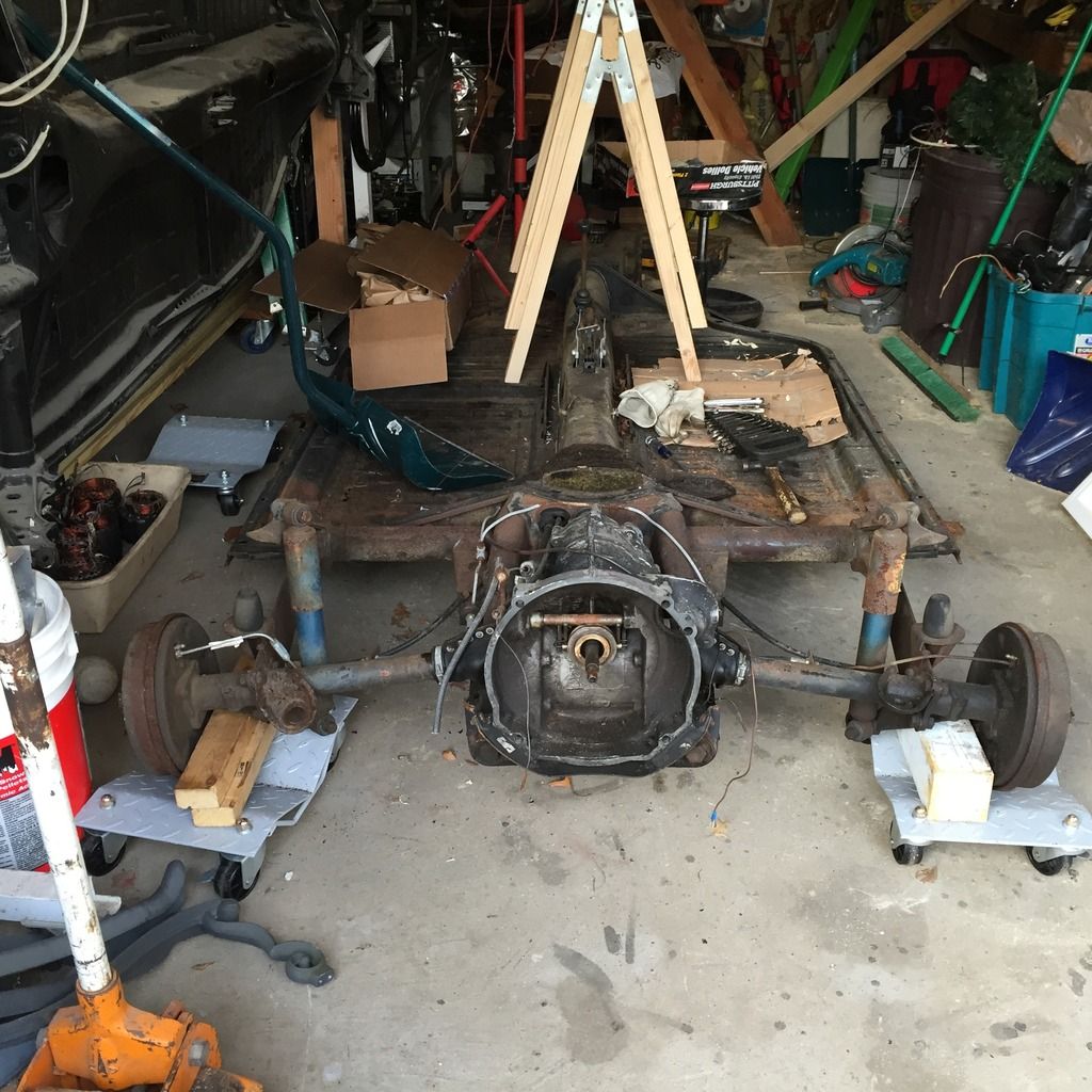

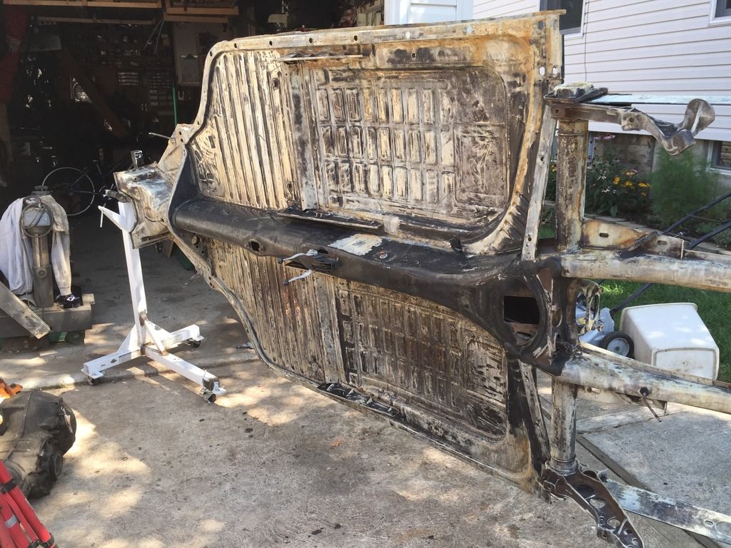

With some free time I've gotten back to the Blue Ghia, which has gone through some changes. some time back I acquired another 68 Ghia with much better floor pans and was an original 4 speed so I removed the body from both to swap them over. I could not find a buyer for the old chassis so that got cut up and hauled away.
Now I'm working on the current chassis to get the rust and some other issues cleared up before i put he body back on it. I have good brake cylinders and calipers front and rear from one of the other cars but I decided to replace all the metal lines and rubber hoses. I'm also replacing the axle boots. The plan is to fix the rust then POR 15 the Chassis and slap the body back on it. THen fix the headlight buckets, check the wiring and get it on the road
Here are some pictures of the progress so far.
new Parts
swing axle
Chassis before
stripping chassis
Getting ready to pleasure wash
new Parts
swing axle
Chassis before
stripping chassis

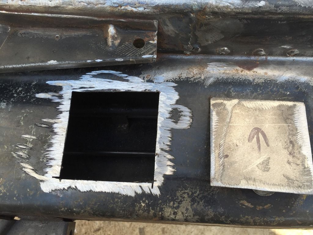

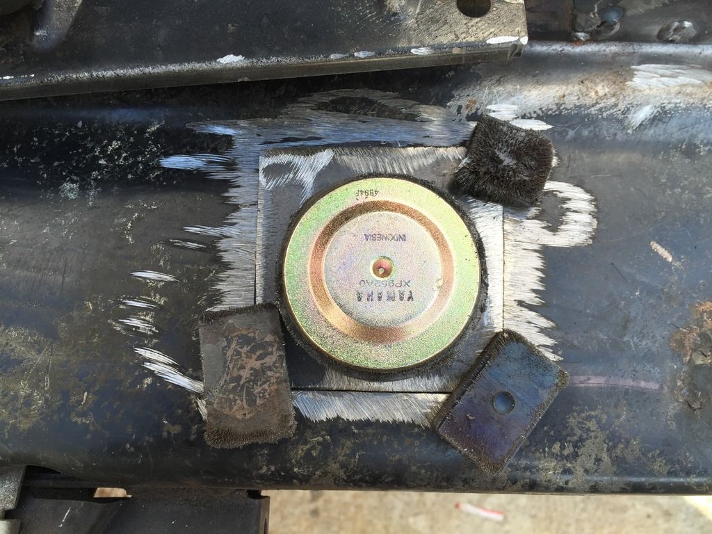

While i have not been around i have been finding some time to work on the Ghia. I finally completed rust repair on the pan and painted it with POR15. Here are a couple of shots of some of the repair and it ready for paint. I painted it this past weekend but have not had a chance to take any pictures but I will. Next i'm putting everything back on the pan to get a rolling chassis, Brakes, Brake lines, ball joints, front end, axle boots bearings etc then dropping the body on it.
