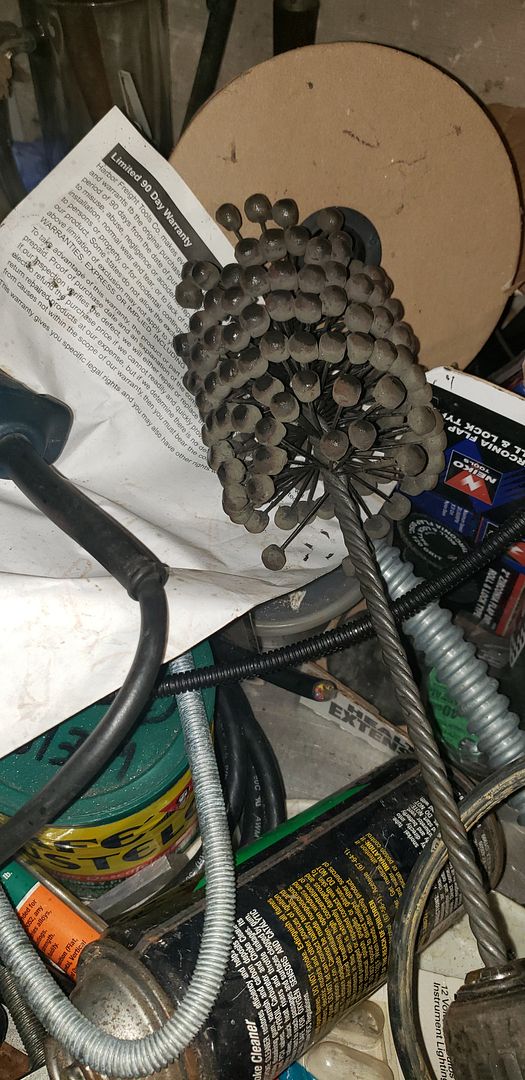

got some dualport heads and pistons today Image a quick clean with the Monkey balls all should be good Image
Monkey Balls Image
