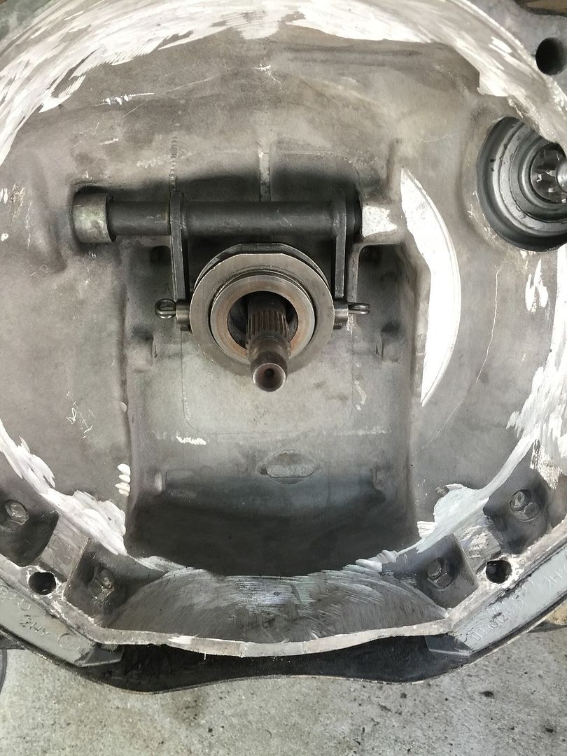

The other night I pulled out the cutch cable that I thought was going to be broken. Turns out to be in almost perfect condition. Did a lot of research and I think it's my throw out bearing / operating shaft
Tomorrow I'll pull the engine and investigate

Did you check the arm on the clutch fork? Is it just flopping around, or still hard to move fwd? Should be super hard to move fwd with the engine in.
You def heard a ' snap' right? What does the engine sound like when it was running? You heard any ' shit' floating around in the bell housing?
When installing the motor did you replace the throw out fork? Throwout bearing? What clips did you use on it.
Im guessing the TO bearing came loose. If so, you sometimes hear some pretty bad noises when you push the clutch pedal in. Sorry bud.....

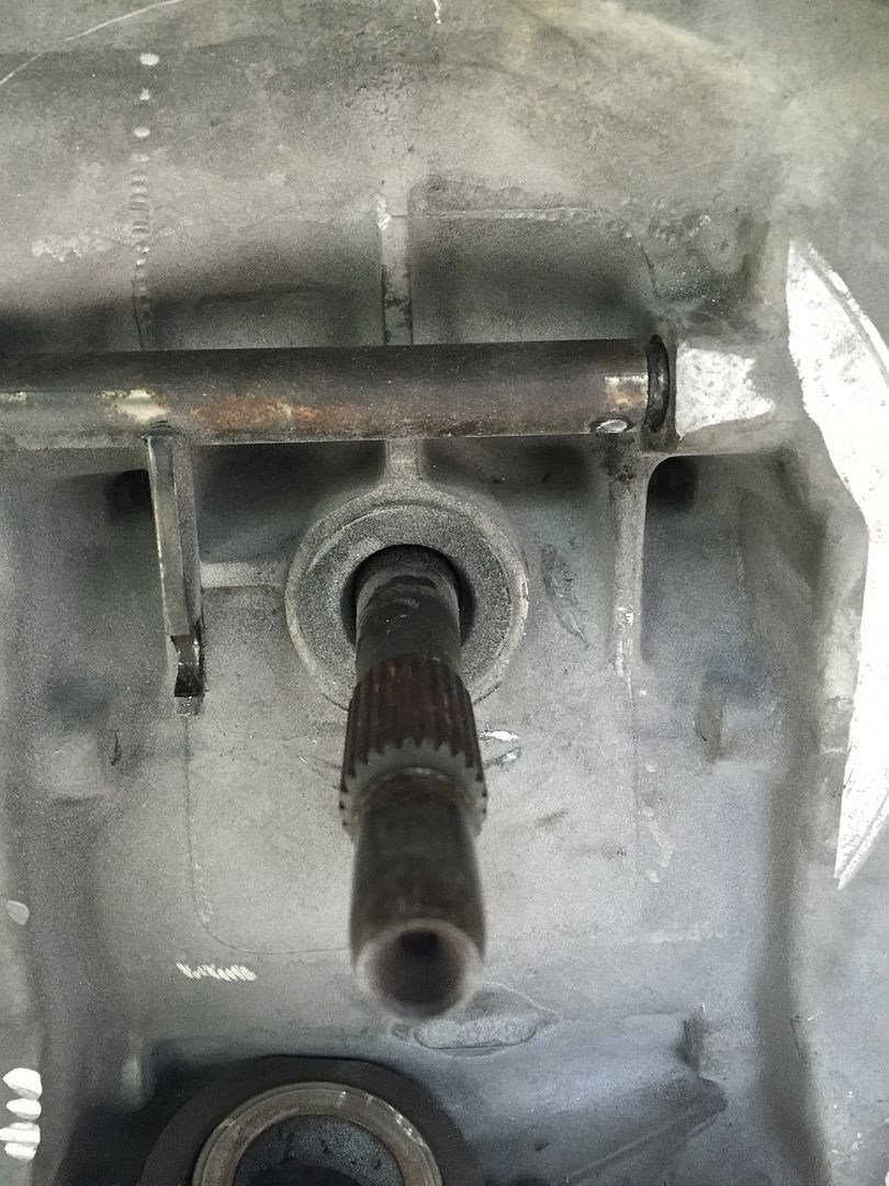

Took the engine out on Sunday and found the fork broken. Already got the fork out and have a new fork to put in. Will install it Thursday morning when I get off of work.

Re: 66 deluxe bus 13 window
Impressive.....! Never seen one snap like that.
Nice save. and glad you were close to home.
Usually they just bend.
agreed.... seen many a bent ones. And thats usually from a failed clip. Could have been just a perfect storm event here, where the clip let go, and the bearing was wedged in the perfect spot.... SNAP!Glenn wrote:Usually they just bend.

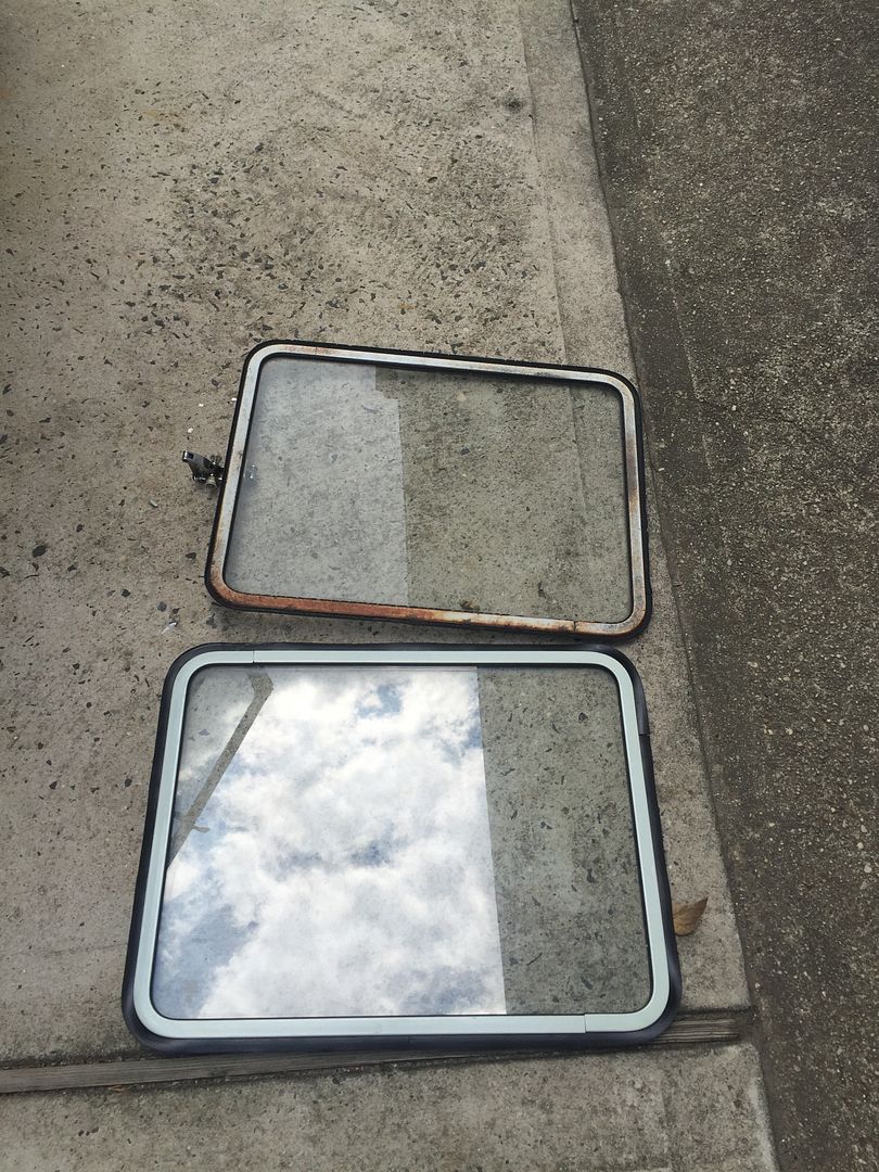

Been working on a couple small project lately
Changed mirrors
Added a tempory wood long interior panel to cut down the nosie
In middle of redoing the 6 pop out window
Dropped off a tranny in south jersey to be rebuilted (not the one currently in my bus)
Changed mirrors
