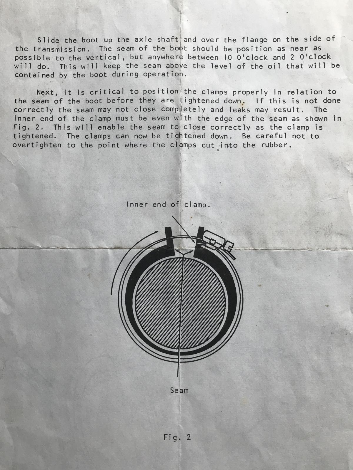

Earlier this year when the bug was at Gerhards Automotive in Huntington for the timing gear issue, Hans mentioned I had a small tear in my axle boot.
I’m wanting to address this before I take the car to Florida in the spring.
Foremost, what’s involved on a car like mine?
Second, if I need axles where is the best place to get rebuilt axles?
I’m not really wanting new aftermarket garbage.
Is there a “Glenn Ring” of the axle world?

Not much to rebuilt.... the Axel is nothing like a IRS with wearable CV"s. Its solid metal thats strong as hell... hence why the baja and drag racers love SA. If you are doing a split boot, not a huge job, just need to play w those little screws and clock the sean correctly ( check the samba). Dont put the seam up top as most would assume. For a seemless boot, I think you need to pull of the entire brake assy and its more involved.
ObnoxiousBlue wrote:If you are doing a split boot, not a huge job, just need to play w those little screws and clock the sean correctly ( check the samba). Dont put the seam up top as most would assume.

The instructions above seem to say the seam should be between 10 and 2, vertical, and horizontal- all while three images show starkly different things. One image is straight back, one is pointing to the nut at 2 o’clock, and one illustration shows straight up.
Which is it? Lol

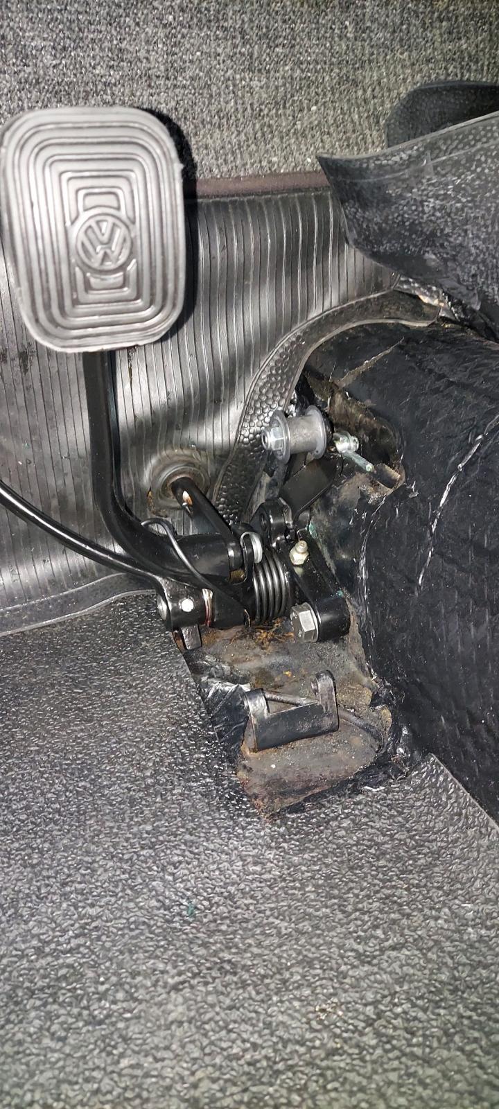

Posts: 1412
Hey folks. Checking in here for some ideas. I removed my old clutch cable and bowden tube, as well as my old accelerator cable today and replaced them with new. Then, I hooked the cables onto the cluster, and got everything installed into the tunnel. I got the clutch hooked on and it has about a half inch of dead play before grabbing, got the brake pedal secured with the spring and the push rod with the tab.
I’m having an issue with my accelerator cable which seems to be about 3/8-1/2” too long. I confirmed it is the correct P/N from WW for my year car though I of course understand that this is my first “red flag” curious if anyone has something I might be missing here. The metal lug-end of the accelerator cable comes too far through the barrel nut on the carb linkage even when the accelerator pedal is in the idle position.
Both cables are too long.
You can add some washer and M8 nuts to take up the slack on the clutch cable.
Clutch cables come in 2281mm, 2270mm and 2260mm.
Accelerator cables come in 2627mm, 2650mm and 2608mm
Posts: 1412
The clutch cable went on with no problem and is comfortably within adjustment. It has about 1/4” of play before I start to get pressure on the pedal.The accelerator cable is the wonky one. It seems that the “pivot point” on the cluster is a bit more rearward on the rebuilt cluster (has the Classic Bugs bearing pivot arm now) which in turn pushes the whole cable out the back of the car about 3/8”-1/2”. I bought a shorter cable (for a ‘52-‘57) and will try that, otherwise will go with the “dune buggy” style cut to length.
