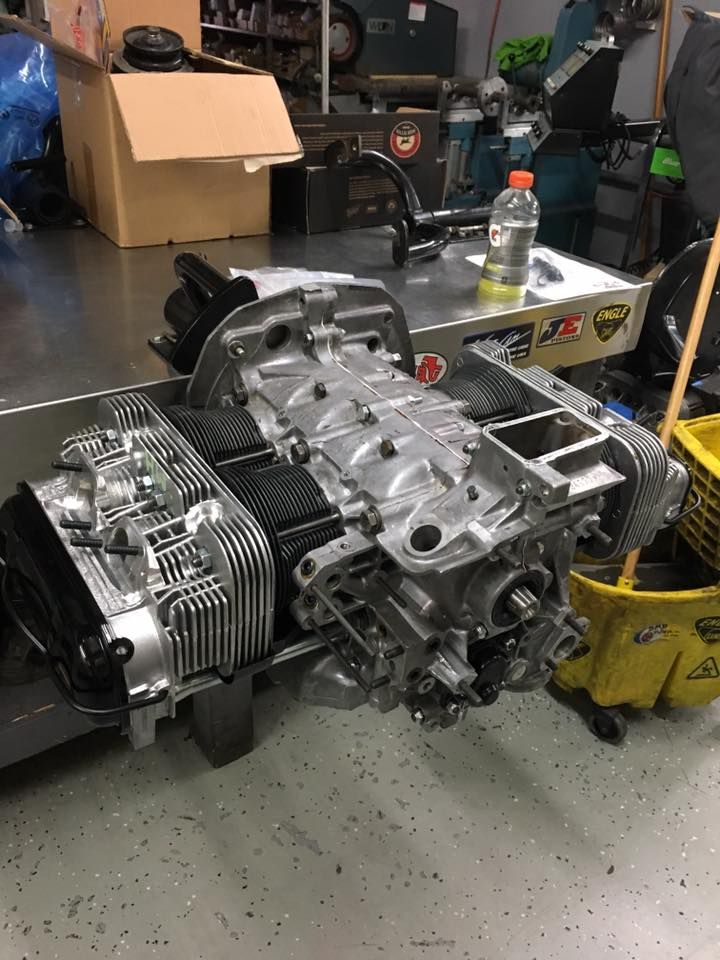

New engine is done, and shipping out tomorrow.
The powder coating should be finished by this week.
I still need to order the new FI harness for the top of the engine, but that won't stop everything else that is happening and shouldn't take long to get here... It is literally plug and play so even if we need to use the old one short term it is ok.
The engine went over budget by about $400, but I did add onto the build list.
The powder coating came in under by about $900 of what I had actually expected it to be based on previous items.

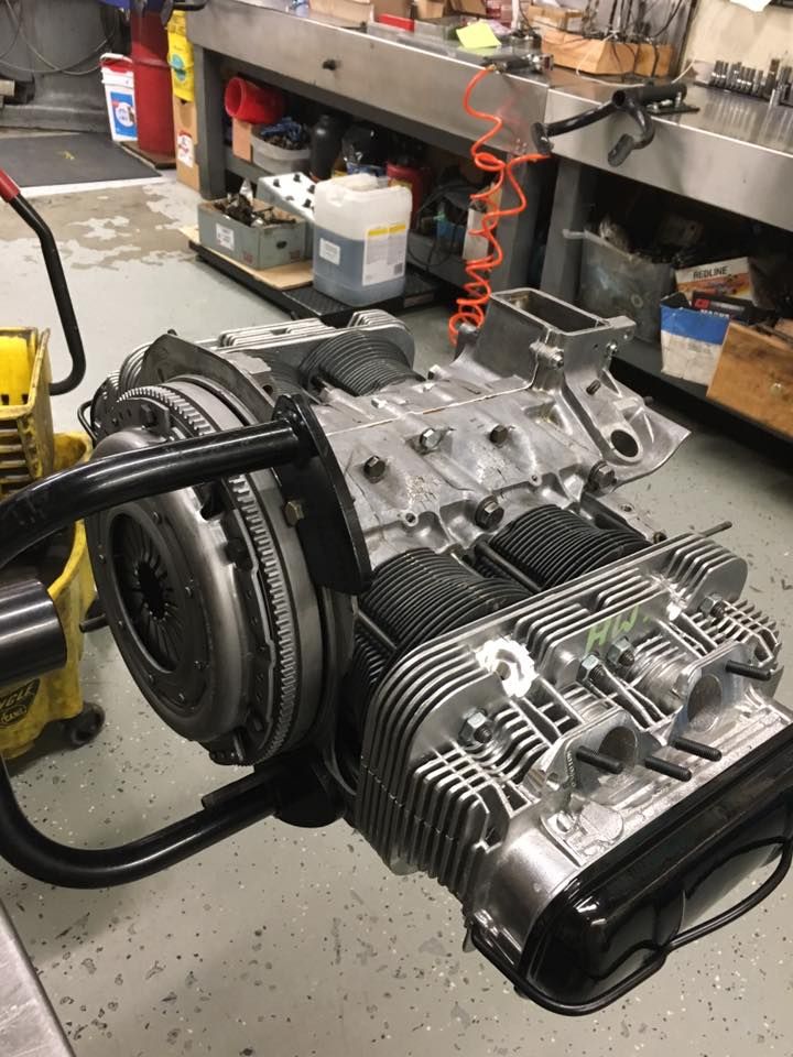

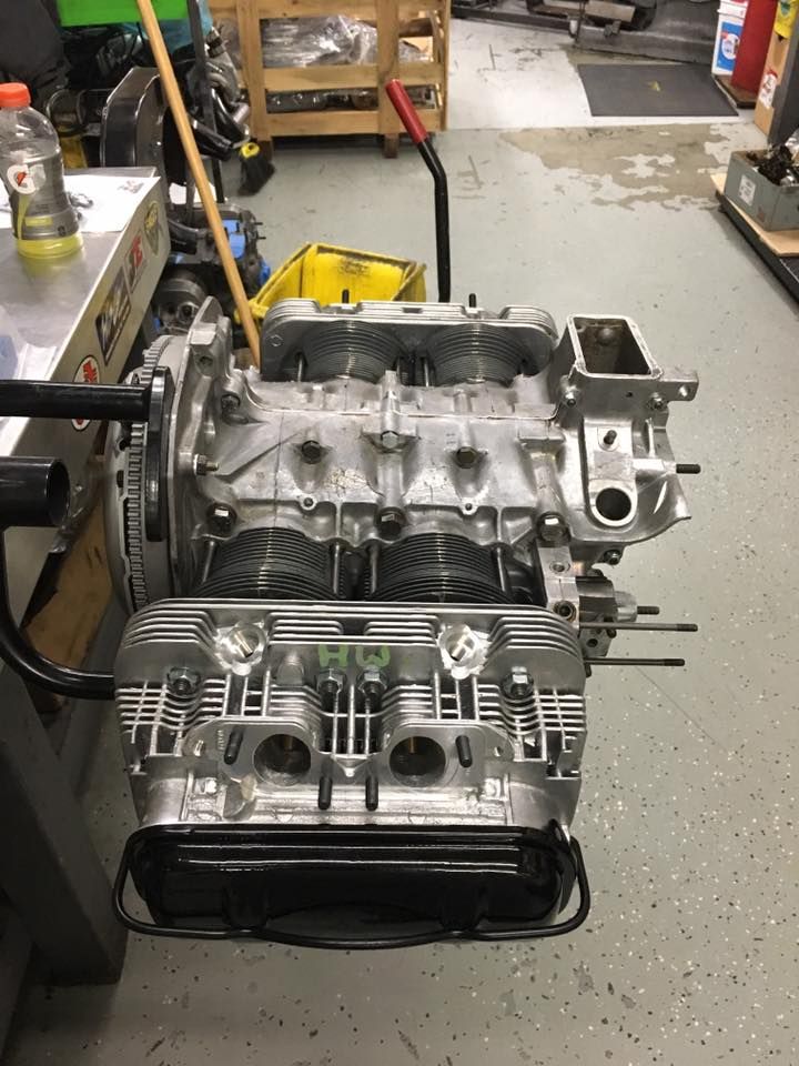

Posts: 1412
Rumor has it... There is a new engine in Massapequa...
Who's HW?
I need sunglasses to look at it 8-) so bright and shiny!!
Hope it open up a whole new set of adventures.
nice!
what kind of heads?
Those are a special PREZ edition heads.Glenn can tell you more about them.

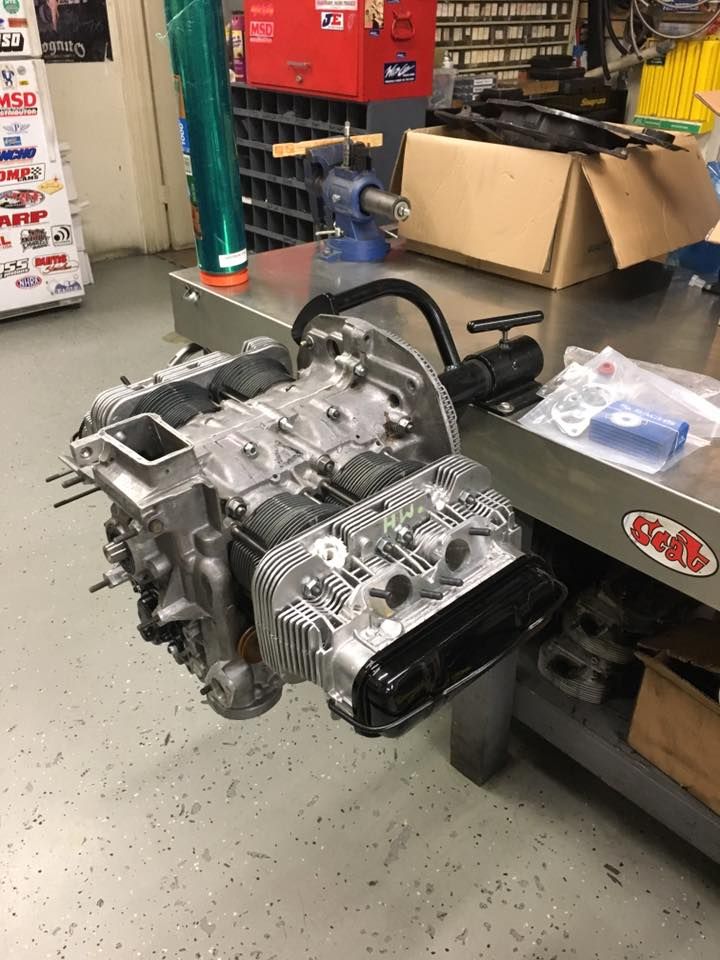

Posts: 1412
Spoke to Wayne today and he didn't realize that my screws were there. So, hopefully now that he knows they can start putting my engine back together.
Had a little SNAFU with the fuel line I wanted, turns out it's not carried locally anymore since Advanced bought out Roadside and CarQuest.
That said, dropped off some steeled at powdercoat. Tires are 4 years old and have some light cracking in the sidewalls.
Jesse wants the old rims and tires as rollers so I swapped with him.
Once the bus is back with me:
Body - at the very least fixing a bubble near the rear bumper mount.
Can fix the door jamb later
Reinstall all bumpers
Install new mirrors
Install the new camper windows
Tires
Install new ham radio
Maybe list:
New curtains
New drivers rear window
New stereo deck/front speakers
Both engine stands are being occupied. If he needs a 3rd, I can bring mine over.
Posts: 1412
Still, but for the hardware (admittedly needed) the engine has been there for three weeks...
I don't want my bus sitting there all spring, it still needs other stuff done beyond just the engine - and the longer it sits the more needs attention.
I want the bus back before Memorial Day, and would prefer back sooner so I have time to accomplish other projects - beyond what Tony is doing.
It hasn't been touched and I don't want a phone call a week before Memorial Day saying that the project is sidelined because they need parts that I could be ordering now.
