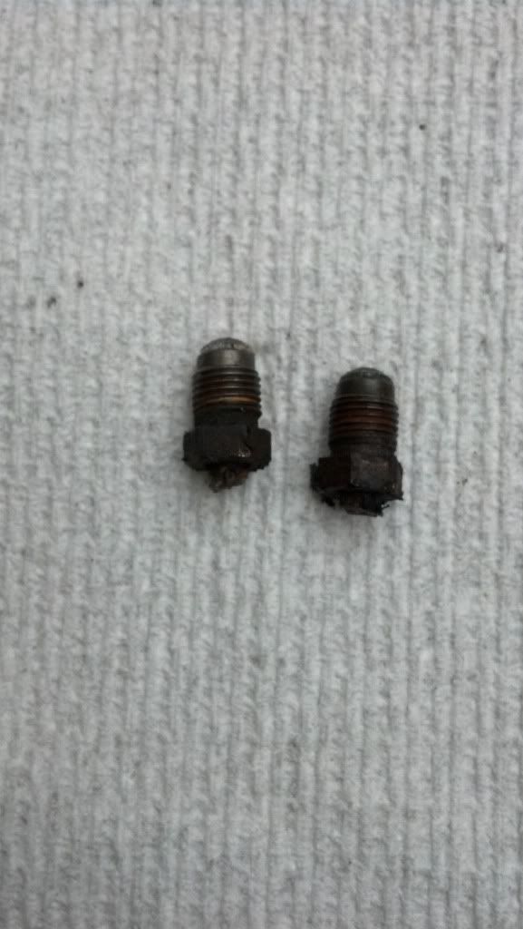

Got it jacked up and gave everything a blast of PB to loosen up the brake lines. the rear was only replaced last fall when I thought that was causing the leak. I was able to crack the line that goes to the front DS but the front PS is not so lucky. I took the wires off the switches but I think I am going to replace the switches. I had bought some at a show about 4 years ago but I can't find them in my parts stash. I am thinking to replace both of the front lines while I doing the switches and this way all will be new. The soft lines were done back in '09 by GA so they are good.

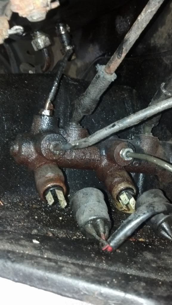

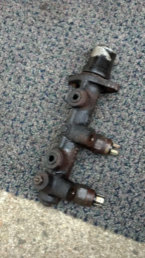

Giving the wonder my all this weekend and it paid off. Got the old master cylinder off and cranked on the new brake switches to the new MC. Getting those VW muscles back to work!! :lol: The old one looks like the original and the switches were on solid. Glad I didn't have to try and get those off.

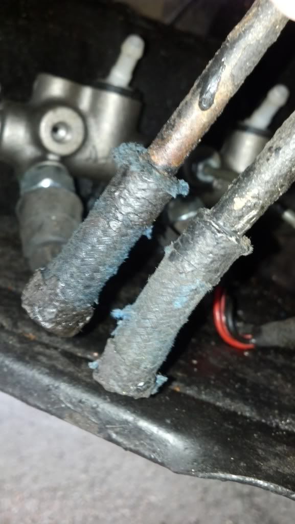

I had cut the lines the other day and the fittings going into the soft lines were pretty (g)narly!

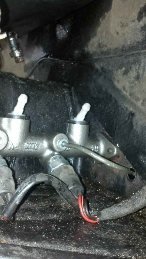

Got the new MC installed and the line to the rear brakes is already in place. The front lines are order and hope to get those beginning of the week to get them installed.

Was it MC leaking of was it just bad ?
Tom wrote:Was it MC leaking of was it just bad ?
It's been leaking. I thought the hard rear line had rusted out but after that got replaced the floor was still pooling fluid. When I took the MC out yesterday the boot was torn and cracked. Thought that was adding to the problem but then reading on the Samba that rubber boot is only a dust cover.
After I got the MC started on the threads but before it was snug I got the rear line attached to give me some wiggle room. That was a bonus.
When i removed the MC, the lines from the reservoir to the plastic nipples were just snugged on. ;) Should there be any hose clamp to secure? Also is this special tubing since I see blue under the coating and I read something about blue brake line. Is this a local auto parts item?
I had to stop reading the threads on the Samaba about MC because lots of people were complaining about them leaking. Good vibes for me I hope!!
the hose is special.
