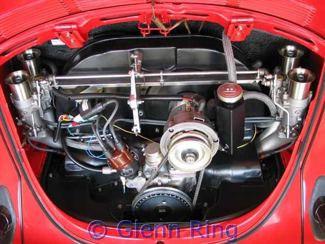

2180cc engine
parts arrive
Berg 1-5/8" merged header
Berg 1.5qt sump
Berg pulley
Genuine VW vented valve covers
Berg linkage
48 IDAs
cylinders, pistons and rods
Seasoned AS41 case
Weismann SLR treated lifters
Forged 8 dowel German flywheel
Case clearanced for 82mm stroker
5.4" H-beam rods
Bottom end with helical gears.
92mm Thick Wall cylinders and forged pistons.
Steve Tims Stage 2 heads 42x37.5 with dual springs
It's a longblock
Engine tin mockup
Canton Mecca oil filter
Berg welded fan
Fuel line pass through mod
Type 181 fan shroud
Stock flaps
Ready to go in.
Type 181 lower tins that close off the gap left by J tubes.
It's in

Re: 74 Beetle
What are the valve covers from ?
Posts: 3193
Re: 74 Beetle
They're OE VW valve covers with vents added. You can see the VW stamped in the metal.
Most aftermarket valve covers leak and i've never had a problem with OE valve covers and bails. Genuine OE bails are made from spring steel and aftermarket are not and leak.
Re: 74 Beetle
Duh . I'm asking the hard question . What model VW had vents ? Is there a part # for vented covers ? Or did you have these made custom ?
Posts: 3193
Re: 74 Beetle
Sorry... the vents were added.
Re: 74 Beetle
I love all the sneaky stuff ! That tranny mount is the shiznit !
Posts: 3193
Re: 74 Beetle
It's required because the Berg 5 speed is 2" longer.
The do make a 4 speed version.
