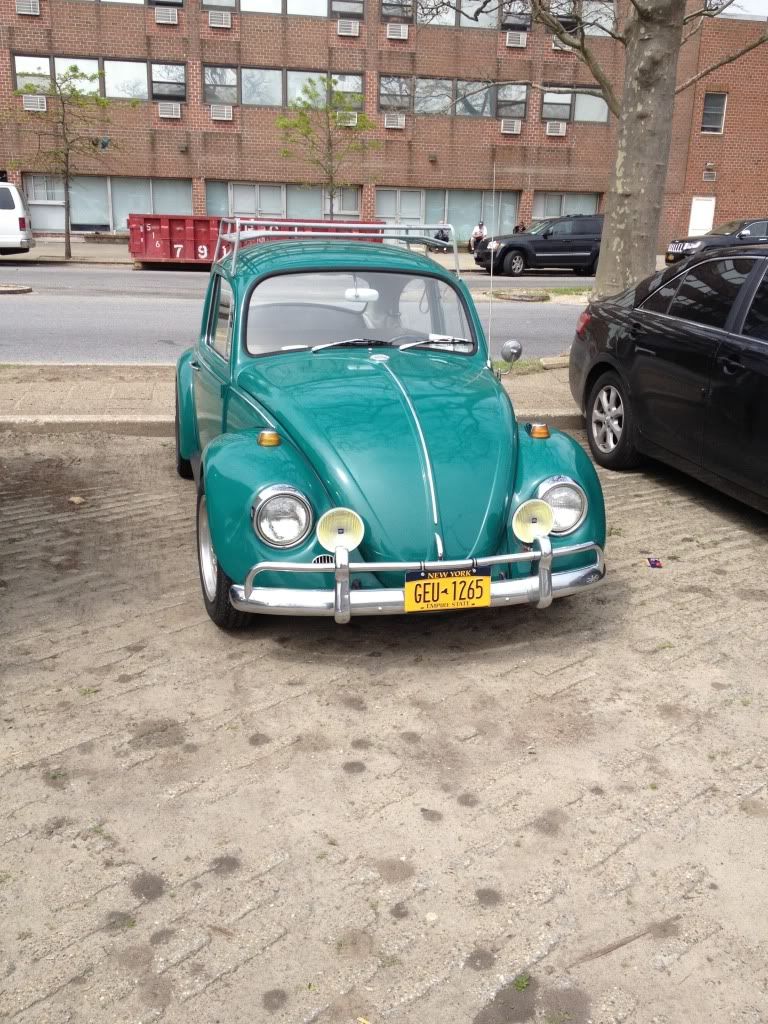

So I'll start my thread with a simple job. I picked up a set of driver quality 1967 only rear bumper overiders at Englishtown and after some prodding at the last meeting I decided it was time to install them.
Before with the 66/early 67-down overiders
After with the 67 1/2 only rear overiders
The iPhone photos don't do them justice. They look nicer in person. But for what I paid for them, Even though they're not as nice as the other set I have. I'm not complaining at all.

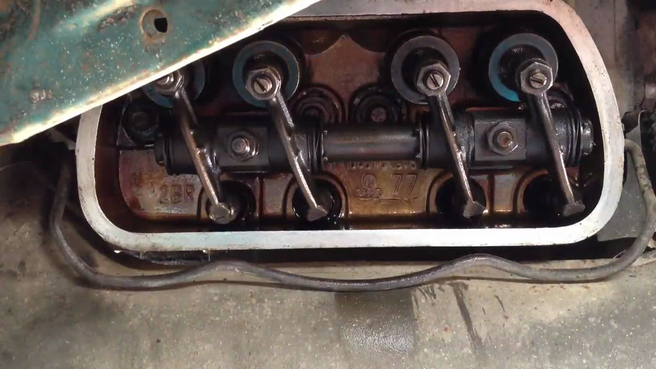

Postby VwJay » Tue Apr 30, 2013 6:11 pm
Followed by a task of increased difficulty, adjusting the valves.
http://i1096.photobucket.com/albums/g32 ... 131CB4.mp4
Since I was by myself, I recorded video of the rockers while rocking the crank and noting what rockers remained stationary. That allowed me to verify what cylinder was ready to be adjusted. Then continuing in sucessive 180 deg counterclockwise rotations moving me down the line to the next cylinder.

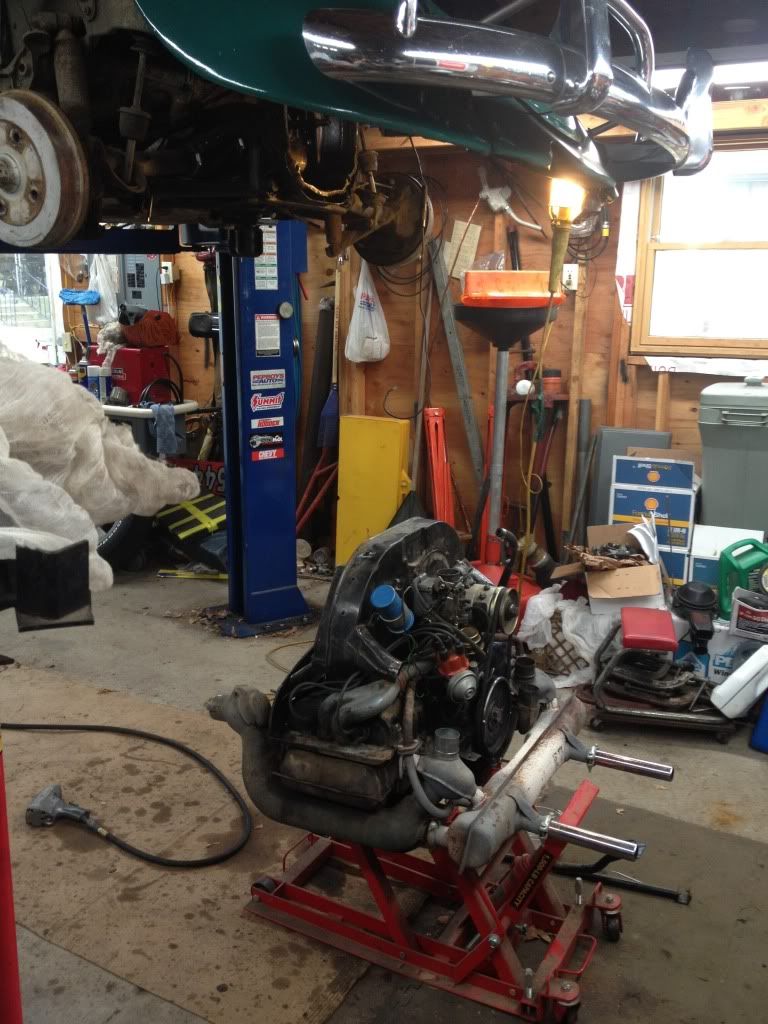

Postby VwJay » Mon May 13, 2013 9:30 pm
Heard a clunk when I started the car and then.......no clutch. So I guess it's time to pull the engine. Got it out for the first time in less than an hour. I was impressed. Putting it back in was not as simple but I still impressed myself.
Turned out both the throw out bearing retainer clips broke. And to top it all off, I had an early throw out bearing with a 71 and up pressure plate. Oh well, new clutch pressure plate and throw out bearing. Back under its own power and the angry turtle continues to scooter along.

Postby VwJay » Tue May 14, 2013 6:27 am
I replaced some of the engine compartment seal. Addressed some of the engine tin issues and did a general inspection. Still have to replace the main engine compartment seal and install the thermostat and cooling flaps but my thermostat connecting rod hasn't come yet. So, I'll just pull the engine again to do that and for more practice.

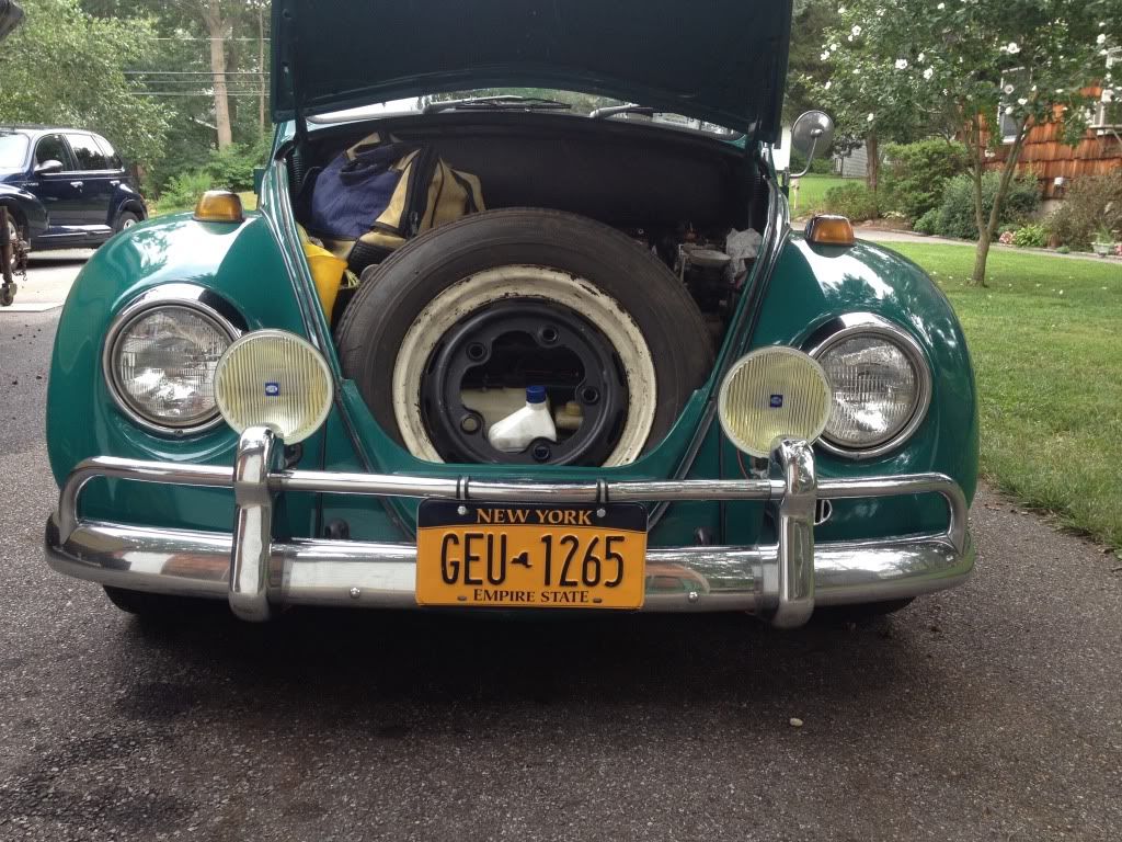

Postby VwJay » Thu May 23, 2013 10:18 am

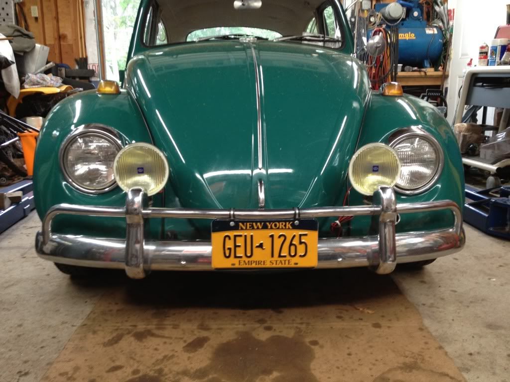

So I picked up a set of used Hella 500 amber tint fog lamps with wiring harness for $5 off Craigslist. The kicker, I got a free Sapphire XIX am/fm radio out of the deal...and it works! So I made some simple brackets out of 1/2" EMT and mounted them to the front bumper guard. Came out decent and I love reversible mods. I want to swap them with more "vintage" looking lamps in the future. But these lay the foundation. I do like them. They have that racey european look but i dont know if they look right in this car. Despite the pictures they don't block the headlights.Image

Re: 1967 Beetle

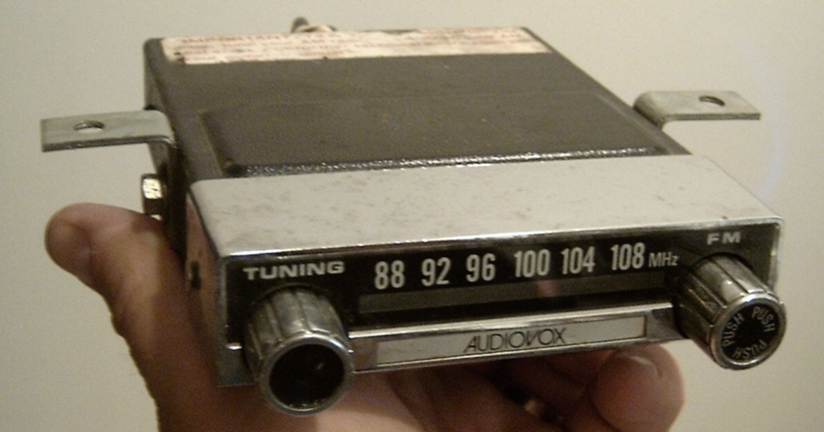

Postby Glenn » Thu May 23, 2013 10:41 am
Sapphire XIX is AM/FM for a 74.
Sell it for $125 and buy a period radio for your 67.

Postby VwJay » Thu May 23, 2013 11:13 am
Glenn, I was thinking I that. I have a Sapphire IX AM only now. But I have toyed with the idea of hiding a modern radio somewhere but I stuck it in the car just for kicks.
Raj, I have seen some cool ones at swap meets. But very rarely are they in pairs. Only by themselves. An I know that's a period look, but I like two.

Postby Tom » Fri May 24, 2013 6:45 am
Wow, I haven't seen an FM converter since I had one !

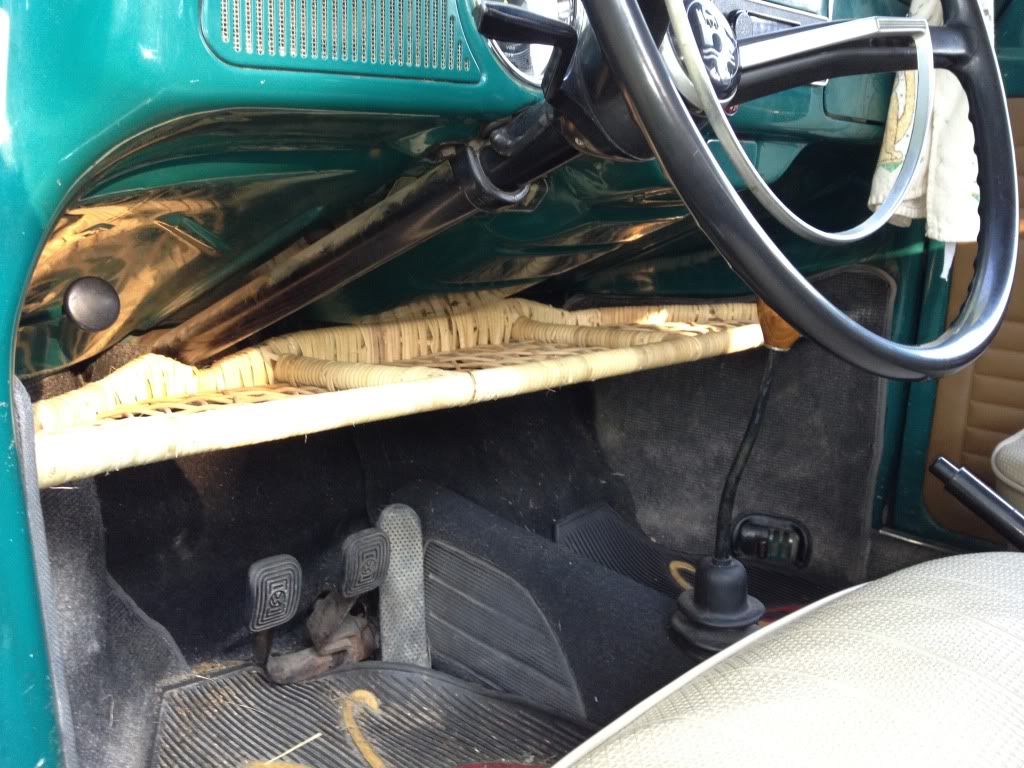

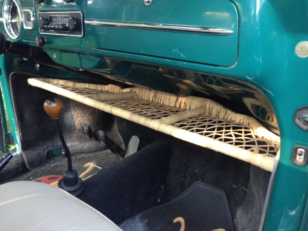

So I picked up this bamboo/rattan parcel tray off TS as I wanted to try one out. I really like the Bambus reproduction tray WW sells but I wasn't prepared to shell out $150 for something I may not like. It's a unknown make and cheaper design, with sheet metal screws and L brackets that screw into the firewall/kick panels. Whereas some of the older dealer accessory and aftermaket trays had integrated brackets and pressure fit set screws. Fortunately for me it fit snuggly enough that it doesn't even need the brackets to keep it in place. I like it so far. However I'm toying with the idea of using some stain or linseed oil to just darken it a little bit. We'll see
The other side

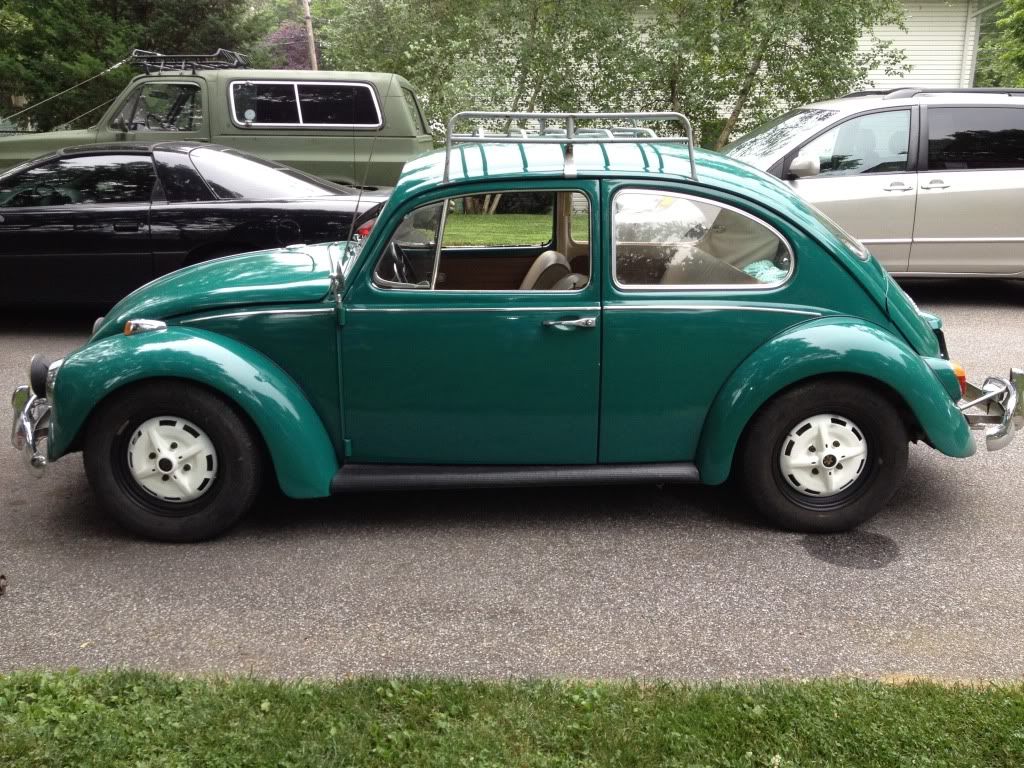

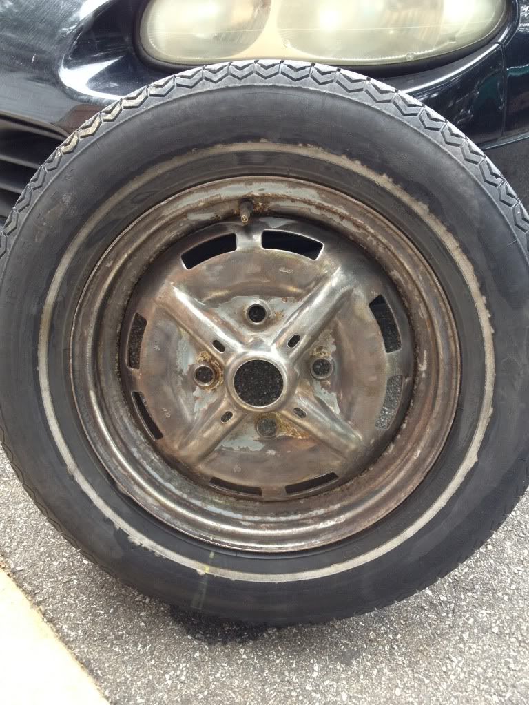

Postby VwJay » Fri Jun 28, 2013 6:24 pm

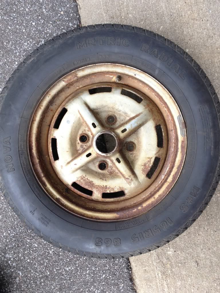

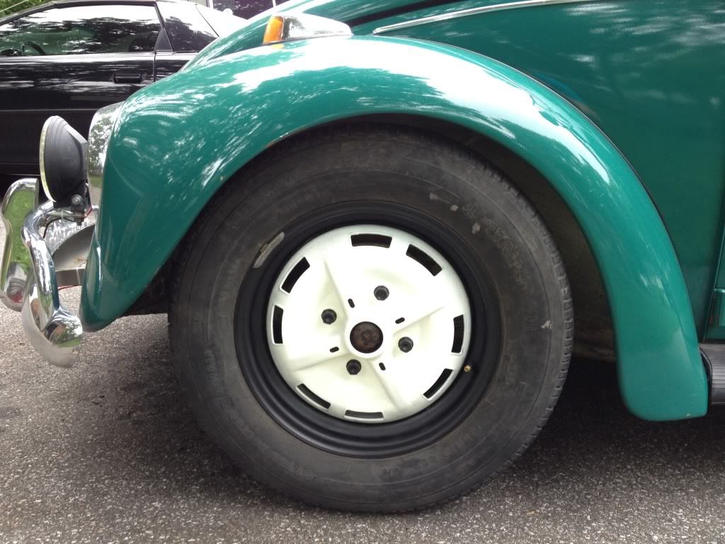

So I've been running some Super Beetle/sport rims for a week now and those who saw the car at Stop and Shop on Saturday saw that they were less than pretty. They were a set of 11/79 rims I picked up for spares when I bought my car and towed it home from Massachusetts. I threw them on to see if stock spec wheels and tires would work on my lowered car. Luck has it they work rather well. But they looked like death. So I set about this afternoon to give them a spray bomb makeover and here's the results.
They started off looking like this, most even worse.
Then after a quick cleaning with a 4 1/2" grinder with a wire wheel they looked like this.
Then finally after a quick coat of Wally World flat black and flat white paint they looked like this. I was originally thinking of simply painting them silver. But I wanted to see what I thought of the car with a more period correct painted wheel. Then I decided to flip the colors like the mid to late 50's scheme. I like them. They are far from show quality finish. But I simply wanted to clean them up and play with colors.
Not bad for an afternoon.
