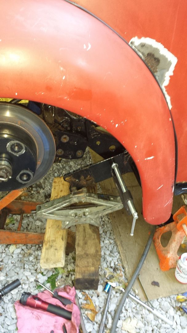

got the passenger side done today total brain fart on how todo it. i tried lowering the rear control arm instead of jacking it up. tried to get 2 flats down on the torsion bar but all it did was lift the whole car till it rolled off the jack stands. Image so i went for 1 flat and that was schetchy as well. but it went from 9 1/2 inches to 11 in the rear which makes it even with the front. stopped by the local locksmith and got 2 keys made he had the blanks in stock

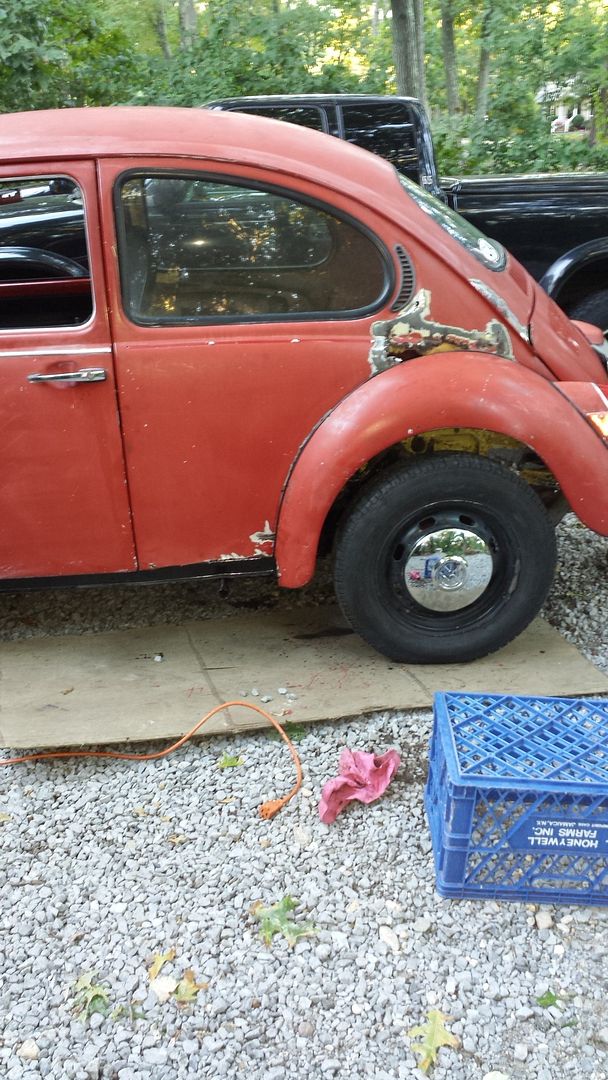

Postby elrockk » Sun Sep 25, 2016 7:28 pm
got the drivers side done today 1 notch down Image before Image after . raising it up softend the suspension alot used to feel every bump in the road now not so much

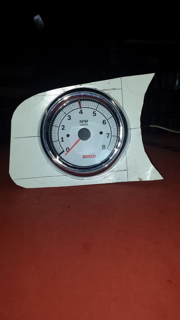

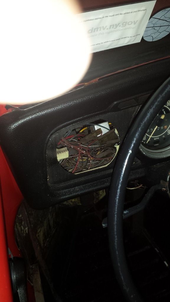

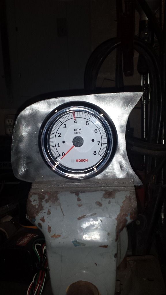

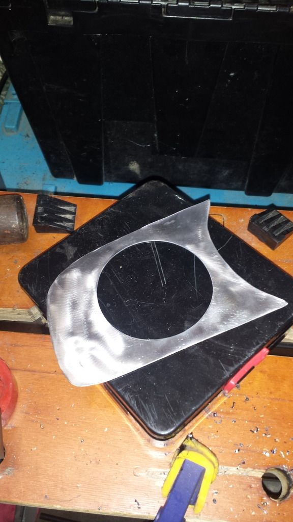

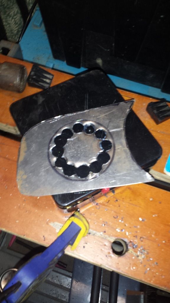

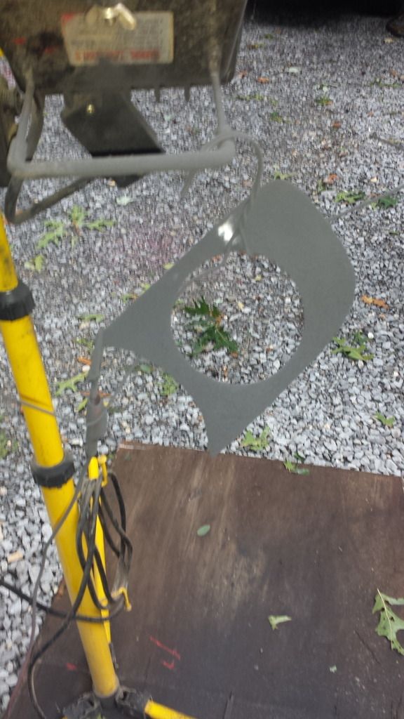

put the tach in today Image going into the speakers spot. made a template out of cardboard Image then copied it to some 20 gauge sheet metal Image and cleaned up the hole Image

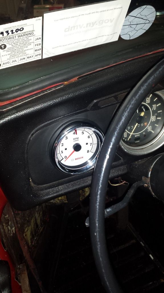

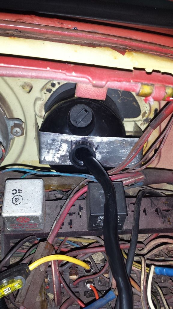

got it all fitted Image then powder coated flat black Image cut out the croos piece while it was baking Image got it all in place and made a simple C clamp to hold it in placeImage Image and will wire it up tomorrow

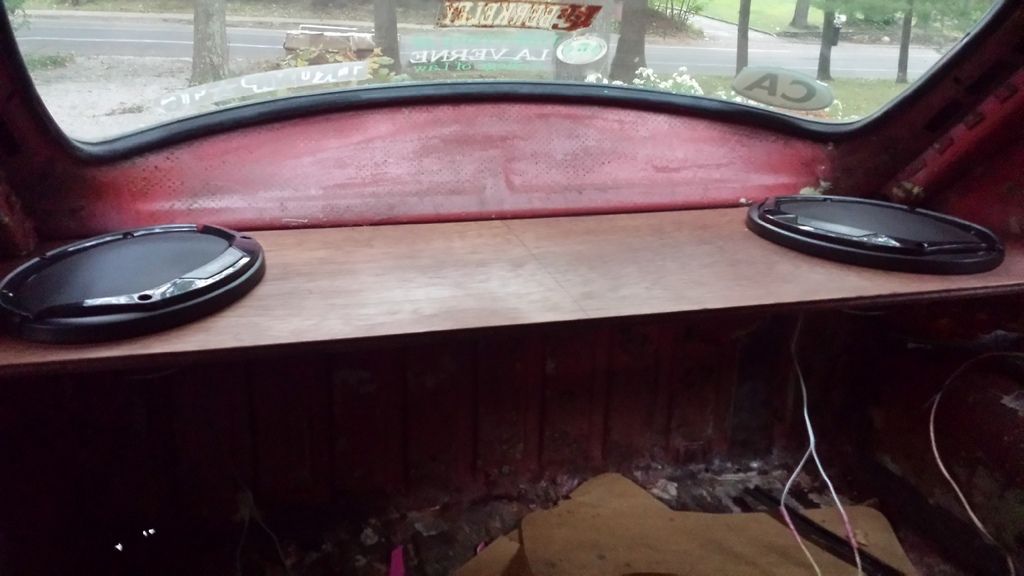

Postby elrockk » Tue Oct 11, 2016 1:35 pm
finally got around to making a shelf for the rear speakers Image and got it installed and wired up Image

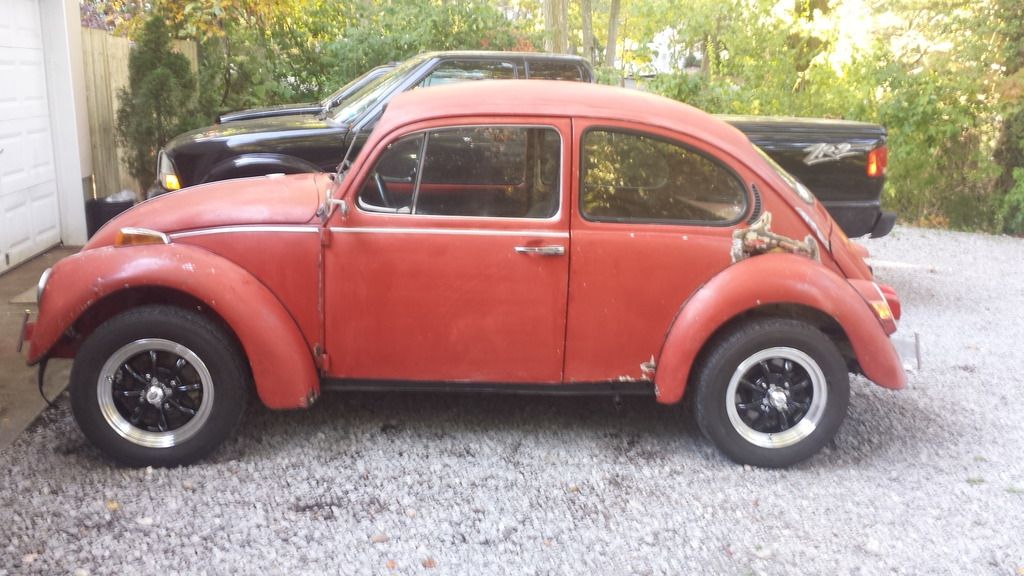

Postby elrockk » Wed Oct 19, 2016 4:28 pm
new wheels came in today Image on somedecent used 195/65r15s. seems to ride a bit softer
