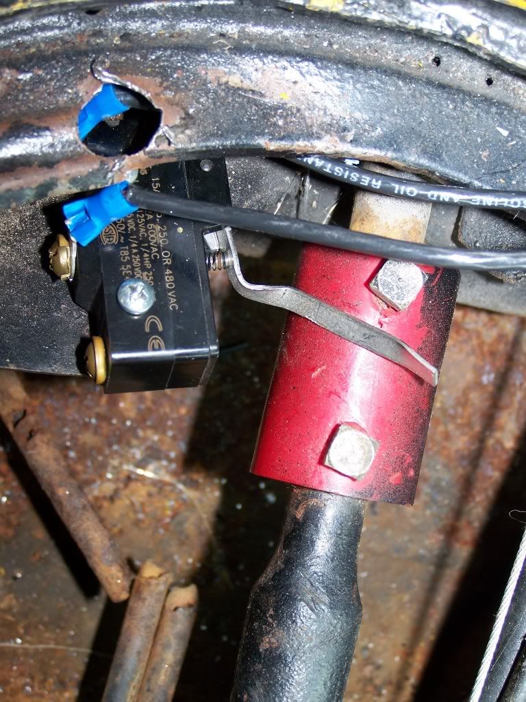

Horn button is wired & mounted, driver side seat tracks with 3" rise have been replaced with flat ones. Passenger side going in this weekend hopefully. Tonight I field engineered a switch that should work for reverse lights. Re-doing the crappy crimp & rerouting the wires tomorrow. Also going to try a red LED 1157 in the socket wired up as an alternator light. The one that's in there now backfeeds the ignition when the key is turned off.

Adjusted the shifter again,Still haven't changed out the passenger side seat rails, installed the passenger side mirror and repaired with that FLAPS repair-a-mirror stuff. Not perfect, but it's something. Reverse light switch is still working, still haven't gotten it inspected. I brought it to my regular guy and he said he REALLY didn't want to inspect it. At least he was up front about it and didn't nit pick it.

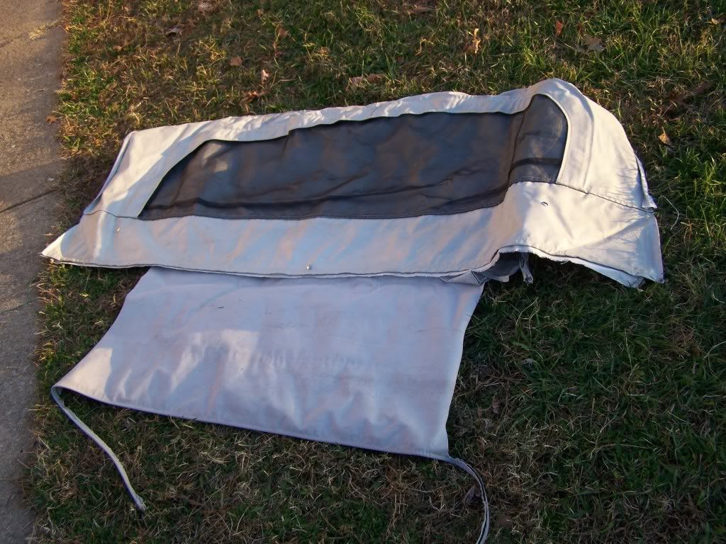

I was about 2 blocks from home testing out that top I'd been playing with when I noticed that it had come out of the channel and the wind was picking it up over the windshield. A snap, a pin, a tighter pinch in the channel, something will be needed to hold it tighter. The second time around the block I ended up stuffing it behind my back until I got home.

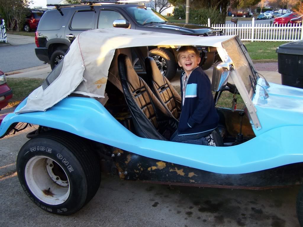

The top laying on the grass

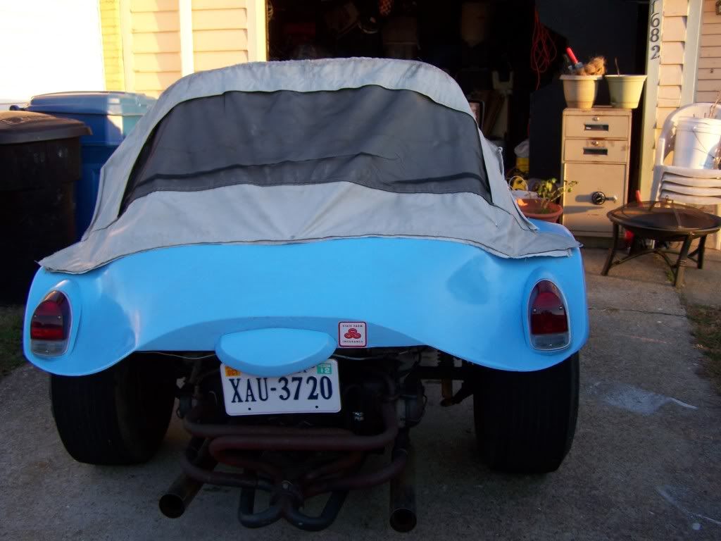

back view

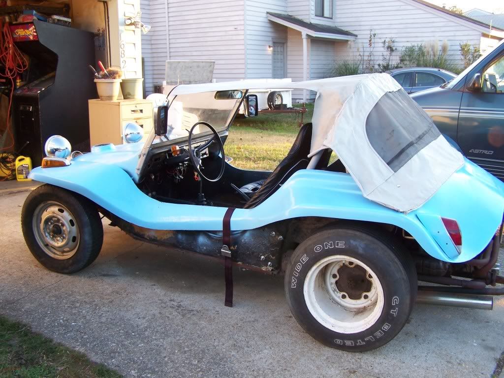

driver side

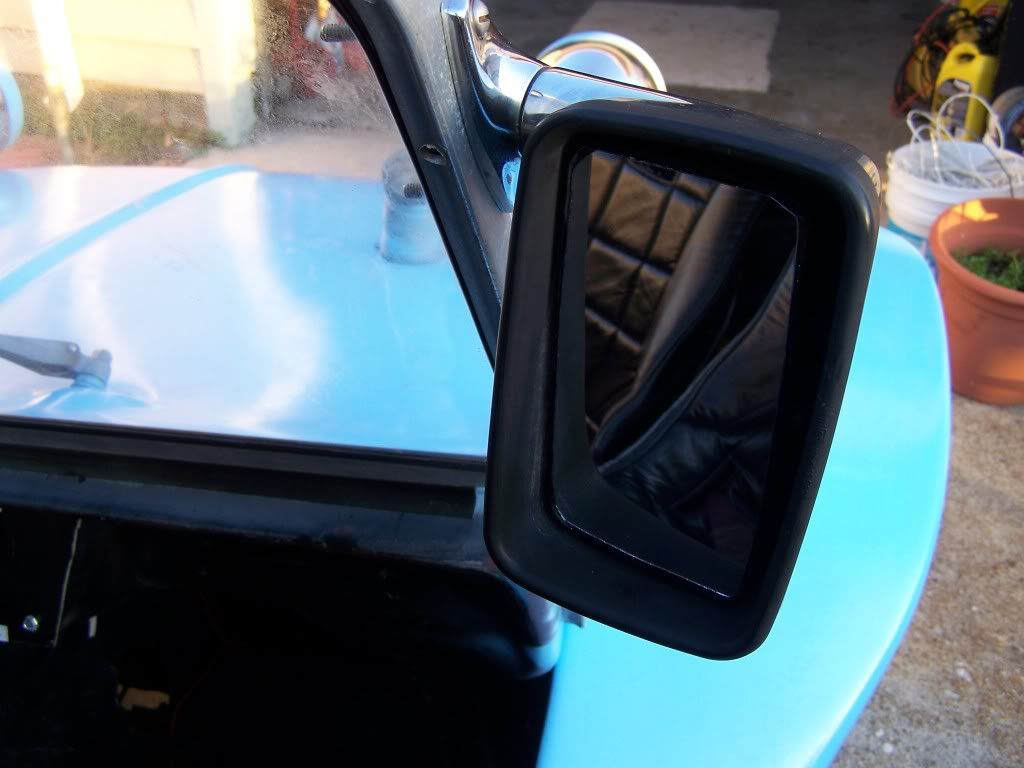

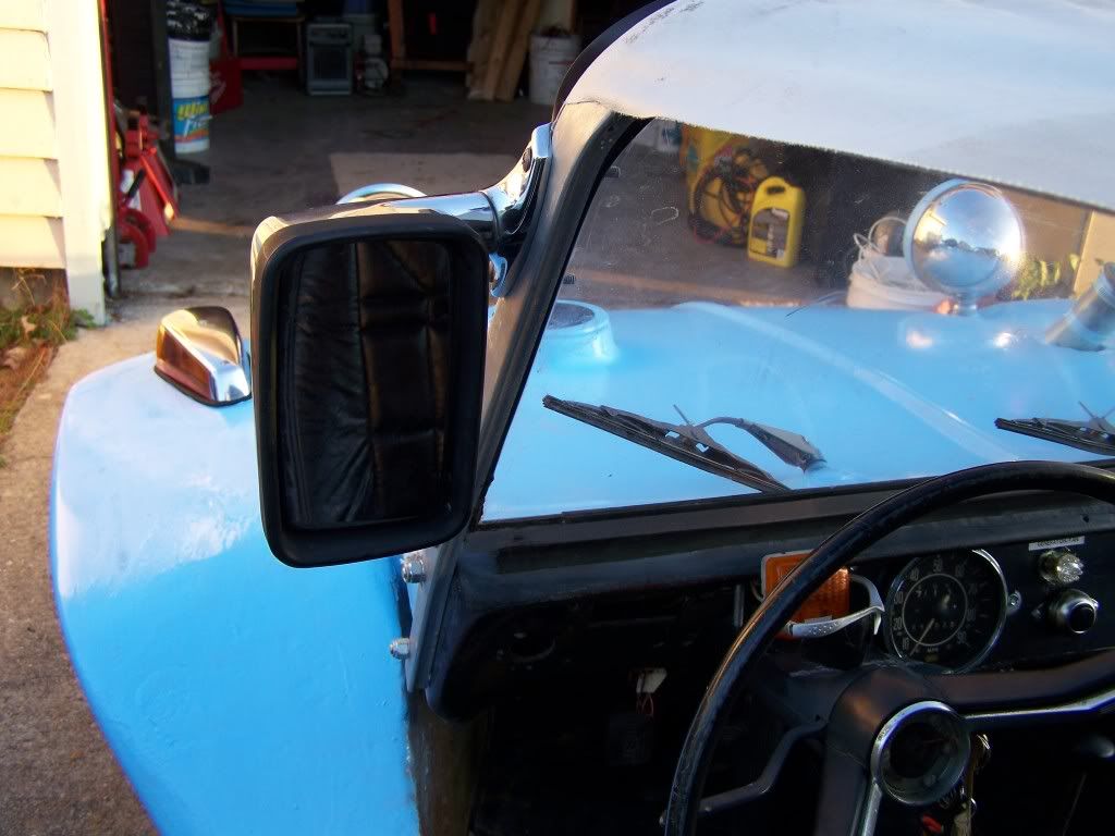

Driver side mirror from an '87 Jaguar. They're power, but won't be connected.
Passenger side I repaired with that 'fix a mirror' stuff. It looks better in the pics than it does in use.

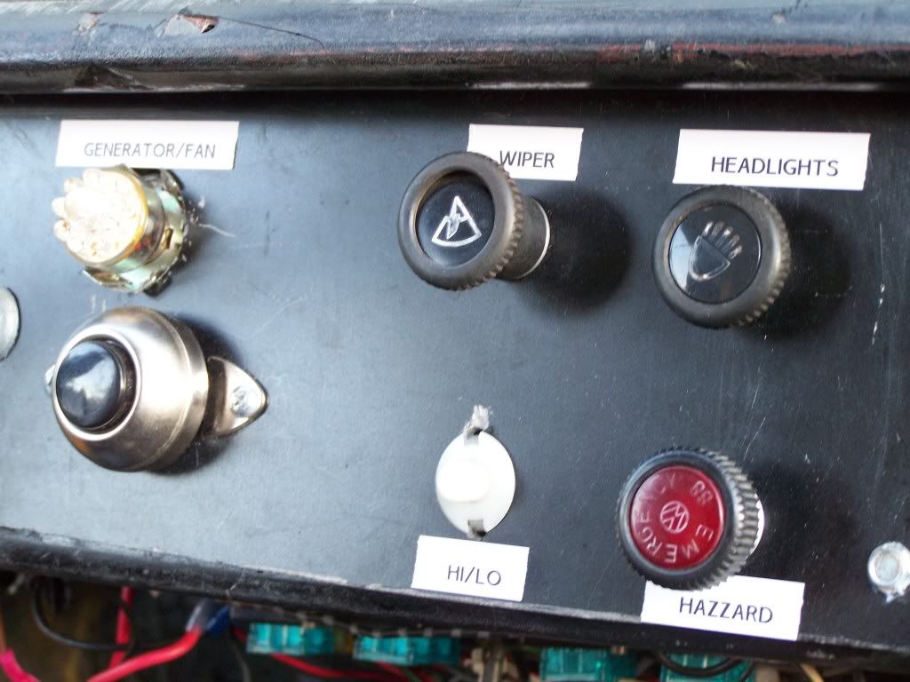

The dash. I labeled it in case whomever inspects it can't figure it out.
Not my proudest moment in wiring history, but it works.

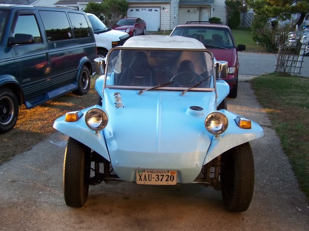

Frontal

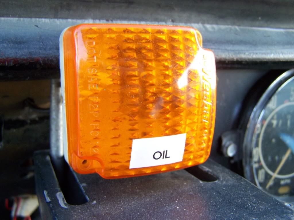

Oil light above column

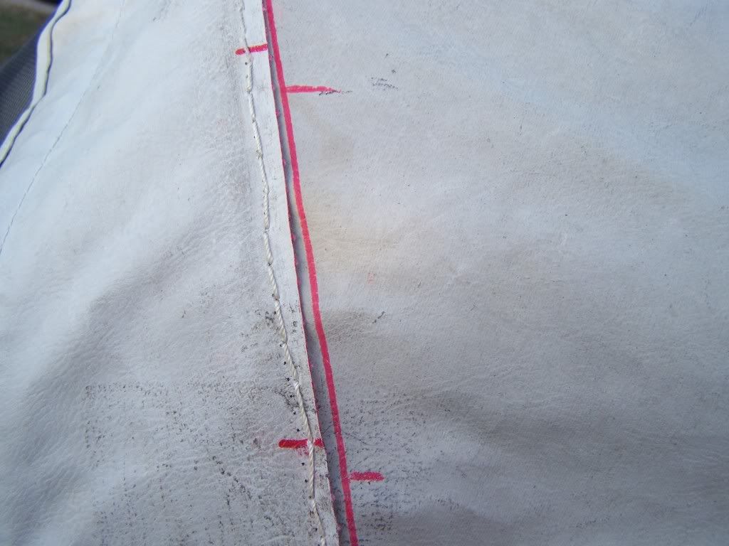

Hand sewn seam on the top (Sorry, no pic for the carnage thread. It was 2:00 am, and that was the last thing on my mind.

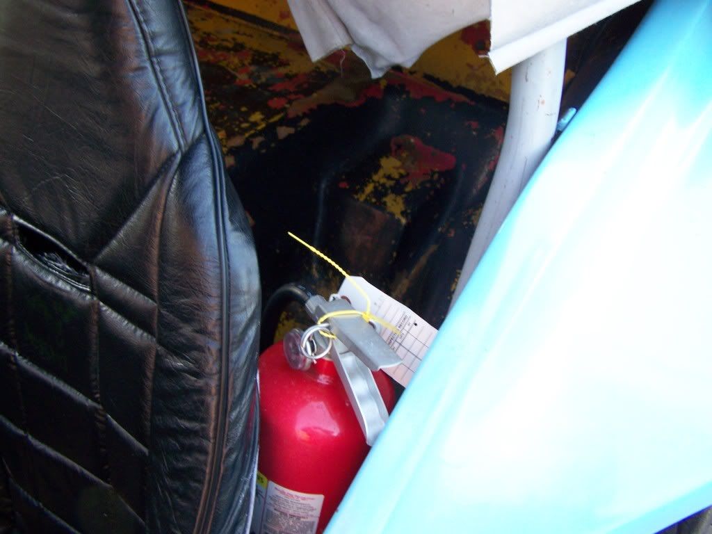

And last but DEFINITELY NOT least, a good sized extinguisher I picked up for free. We lost an orange bay window bus on one of the bridge tunnels here this past week. I don't want that to happen to anyone else, let alone me.

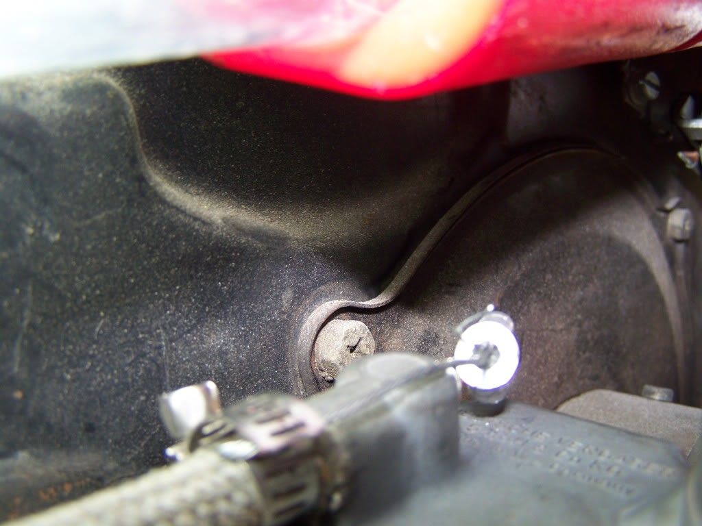

Thanks! I forgot to mention I put a piece of wire (ok, bicycle shifter cable) on the fuel inlet. I didn't remember to take pics until after it was halfway bolted down.
There's more than meets the lens, the part you can't see is what's doing the holding.
I had a b17ch of a time getting the front nut on. After dropping it into the abyss, and eventually figuring out that it could usually be found between the fuel pump and the generator stand, I got creative and put a piece of a hard drive magnet on there to help hold things together while I got the nut started. It's the little piece clinging on under the solenoid.
