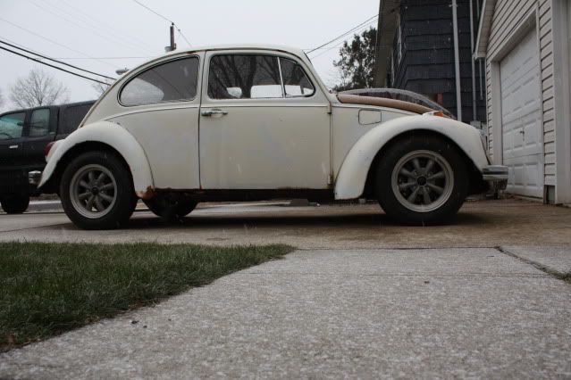

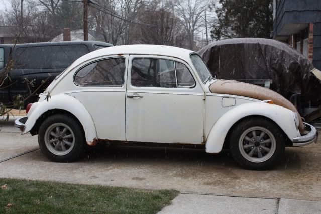

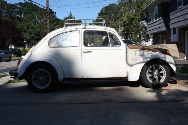

Here are some shots of the car with the 8 spoke rims and the front lowered!

Re: 68 Bug
How low is it?
Re: 68 Bug
Glenn wrote:How low is it?
Where do you measure from?
Re: 68 Bug
Any point as long as it's the same before and after.
Re: 68 Bug
much better
Posts: 1050
Re: 68 Bug
I don't like it , put it back the way it was . :)
Re: 68 Bug
Sweet!

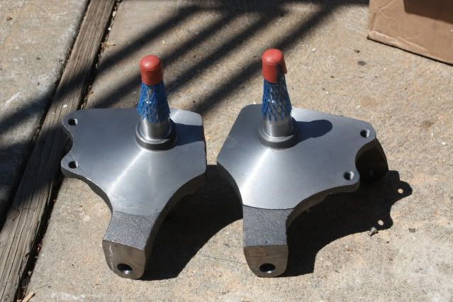

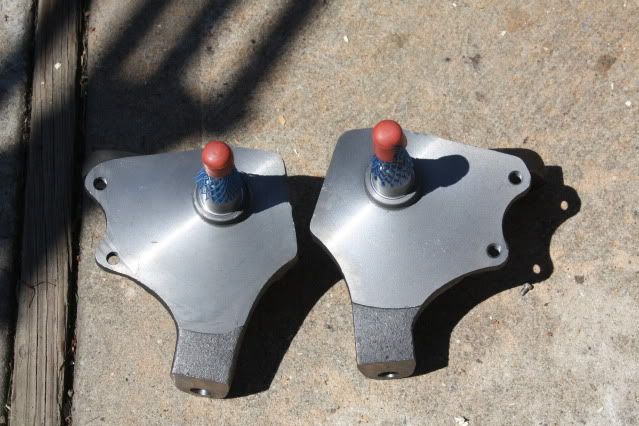

New Parts

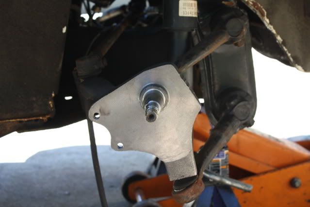

Installed new drop spindles. The spindles did not have holes for the back plates so i left them off. Do they make a back plate for this style spindle?
The other issue i had was after the rims were installed they were rubbing against the brake caliper. The passenger side was rubbing quite a bit so i installed some spacers between the caliper and the spindle. That took care of the rub on the driver side but i had to grind down a little bit of the passenger side rim to get that one to fit.
I didn't get a picture of it yet because i just finished it up and it was pretty dark. I did move it out of the driveway to move it over and it scrapped pretty good. I still want to play with the front a little bit maybe bring the adjustable beam up a little bit and then drop the back of it.

Gotta love aftermarket CRAP.
Re: 68 Bug
Why would you put backing plates on disk brake spindles? Those two holes are for calipers. Looks like you bought the wrong ones. Those cast spindles are are pretty nice compared to the old cut and welded ones.
Re: 68 Bug
Glenn A wrote:Why would you put backing plates on disk brake spindles?
Because it keeps the water and dirt off and they came from the factory with backing plates.
Re: 68 Bug
Glenn A wrote:Why would you put backing plates on disk brake spindles? Those two holes are for calipers. Looks like you bought the wrong ones. Those cast spindles are are pretty nice compared to the old cut and welded ones.
Like Glenn said the old disk brake spindle had the backing plates but when i checked the Samba seemed like alot of people jsut left them off. Why do you say it looks like of bought the worng ones, what do you see?

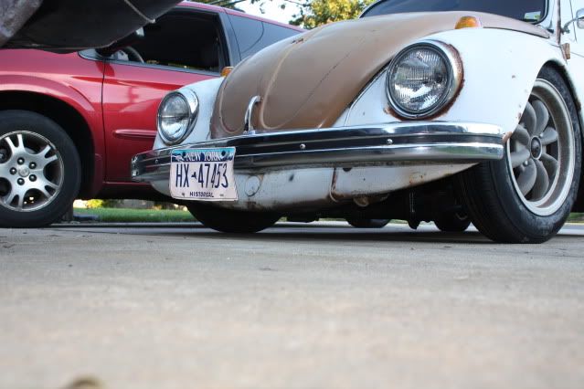

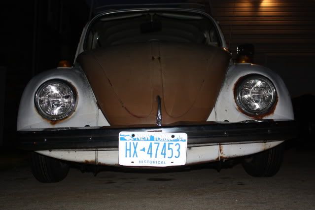

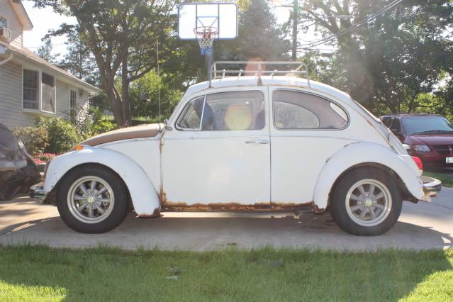

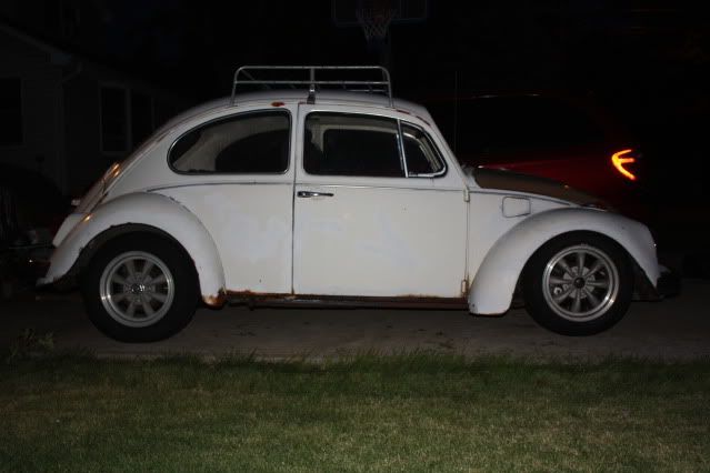

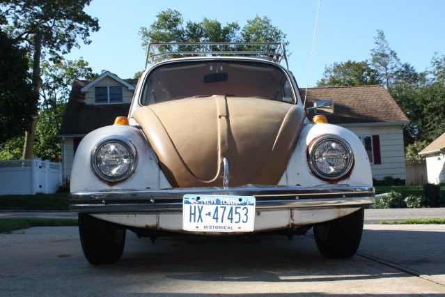

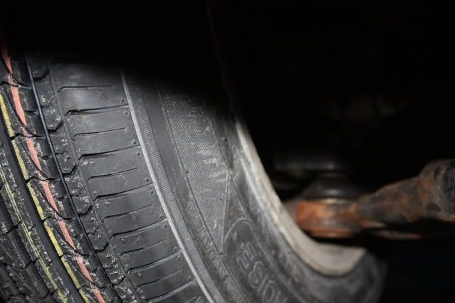

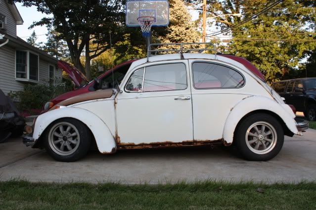

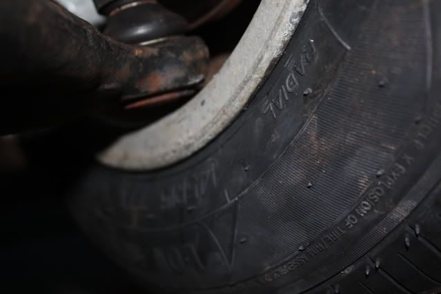

Back out to the car tonight and realized the lower ball joint ont he driver side was scraping against the inside of the rim so i raised the adjustable beam up a little bit which straightend out the ball joint so it is not scraping. It is still very close to the rim and i think it will hit if i go over a bumb, but i will drive it and see. Here are some pcitures before and after the drop spindles were added.
Before i raised the front a little bit
After raising the front
shots of the lower ball joint to the rim
Re: 68 Bug
now thats low!
Re: 68 Bug
B MAN wrote:now thats low!
Now i need to drop the ass a bit!!!
Re: 68 Bug
Don't forget the re-aim the the headlights.
Re: 68 Bug
looks good Ken!
