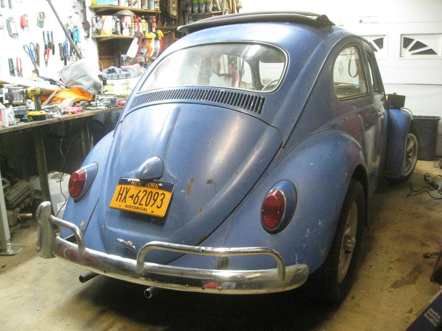

Finally got my brakes line in the mail today..... geez 10 + days of waiting.
Installed the main one tonight after the house went to sleep.

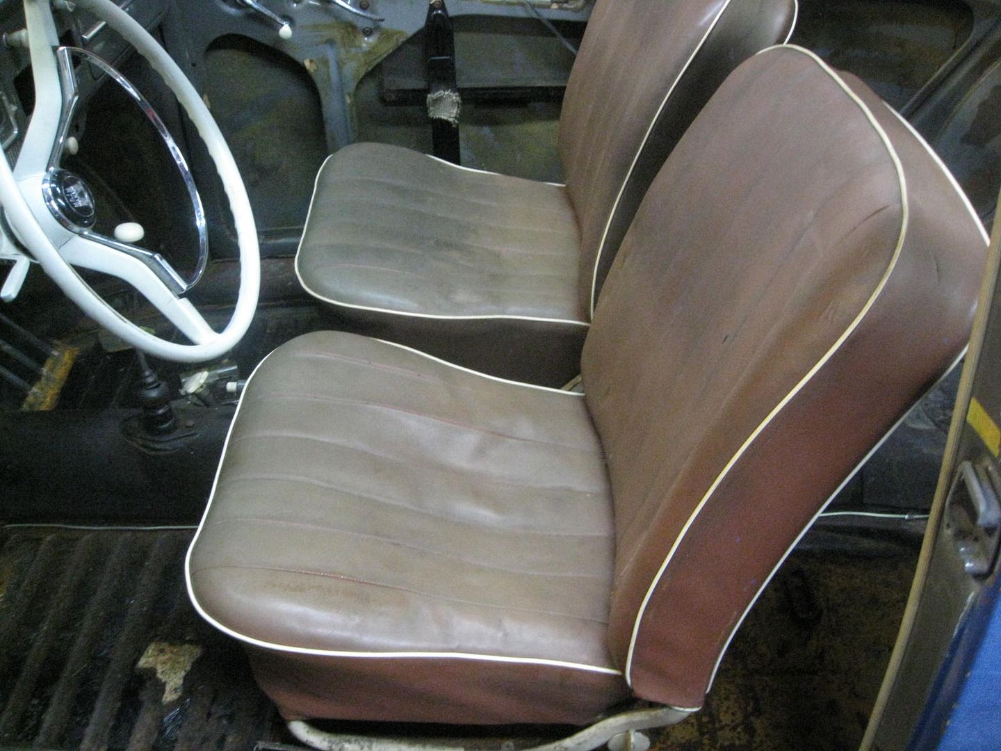

put some seats on from an oval i had sitting around

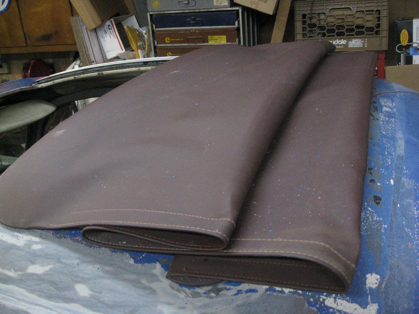

earlier in the week I installed the rag rails I got form Marc in NJ.

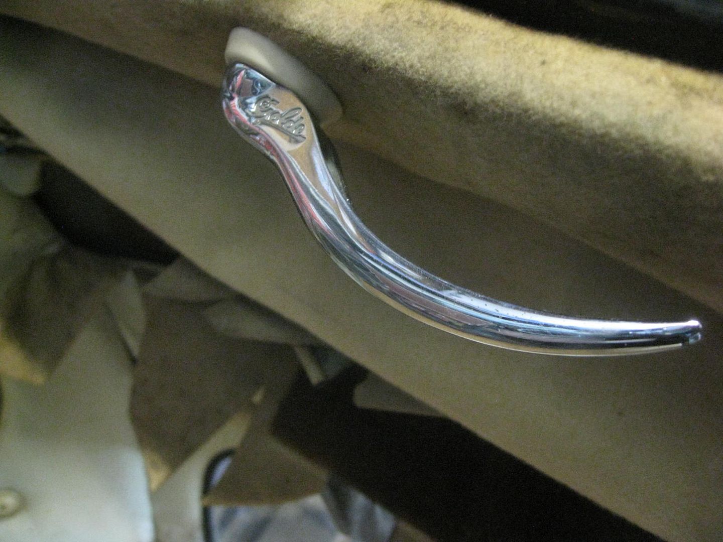

cleaned up the Golde handle

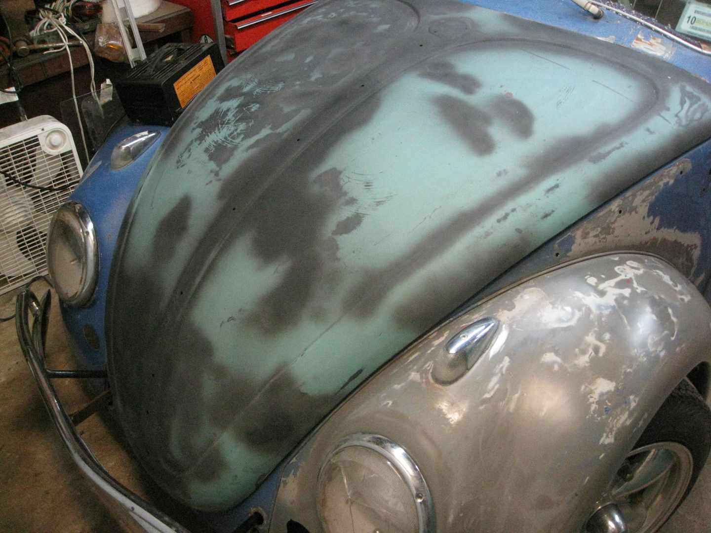

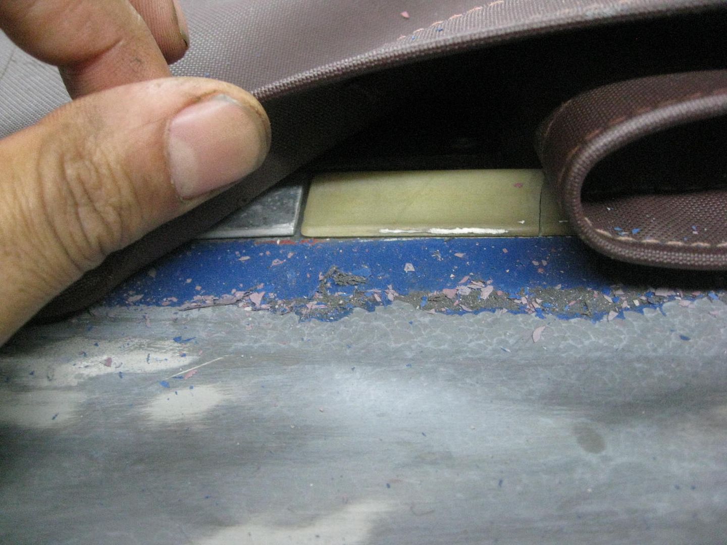

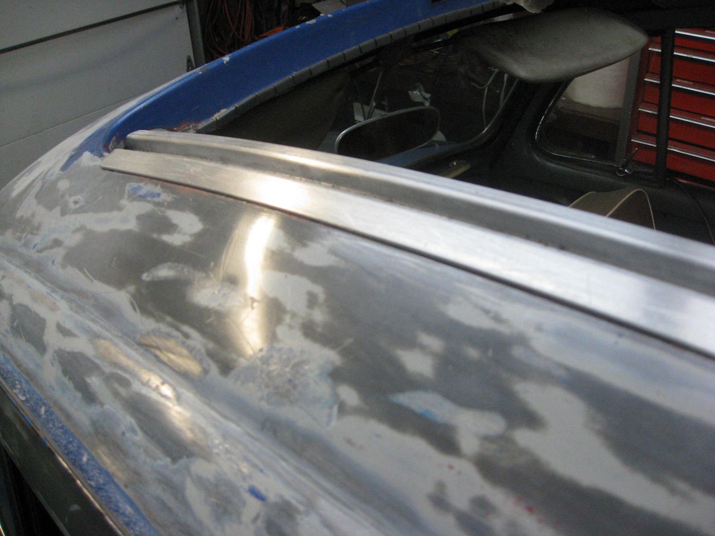

late 63-64 hood in a 9 out od 10 condition. This will work until I find a 61-early 63 hood with no emblem bump but with wolfsburg crest slots

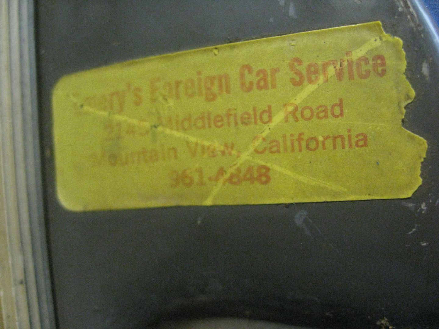

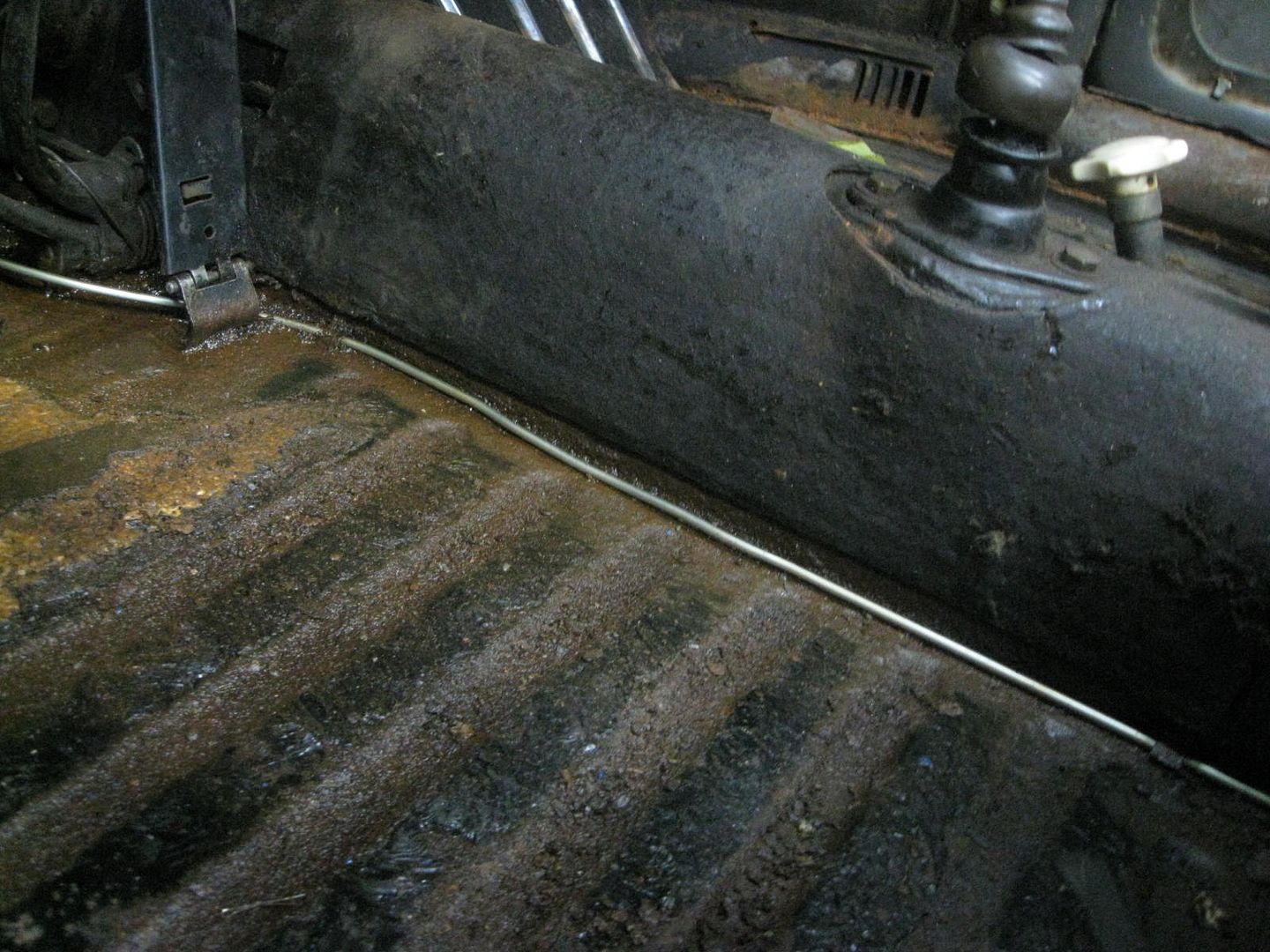

nice tidbid I found.... can this explain the reason for this car being so solid?

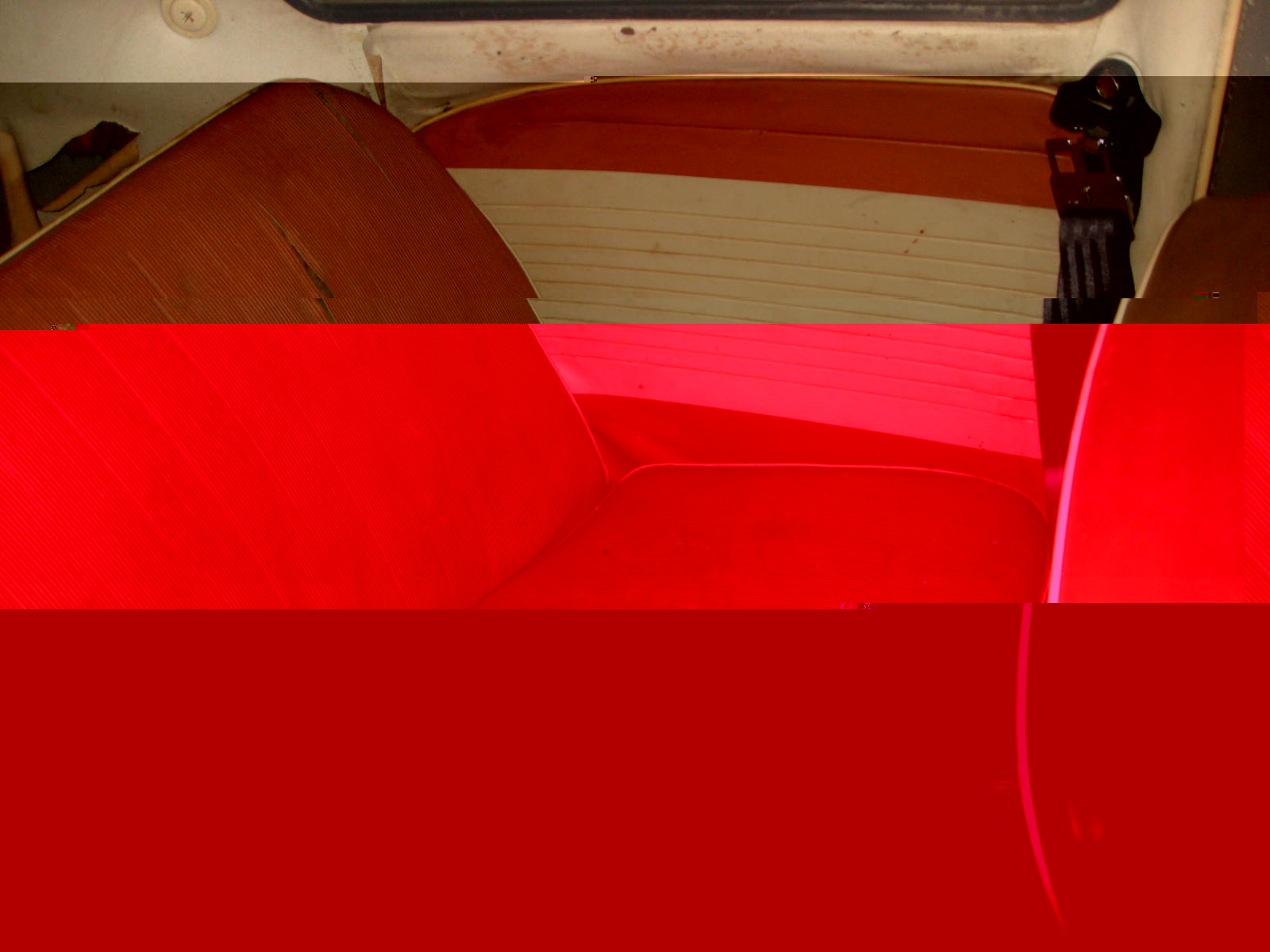

Added the rear ' door' panels, and rear seat. Hope to get liam in here soon. Ordered 3 point seat belts today, and need to decide what radio to run. Had a valve cover leak so chnaged the gasket this morning via flashlight. I also put in the heather tube ( box to body) on the passenger side. I drove her to work today, and it was a chilly 41 outside. Nice and toasty in the car though!

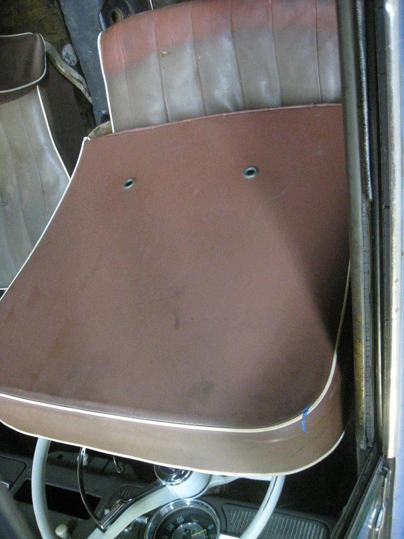

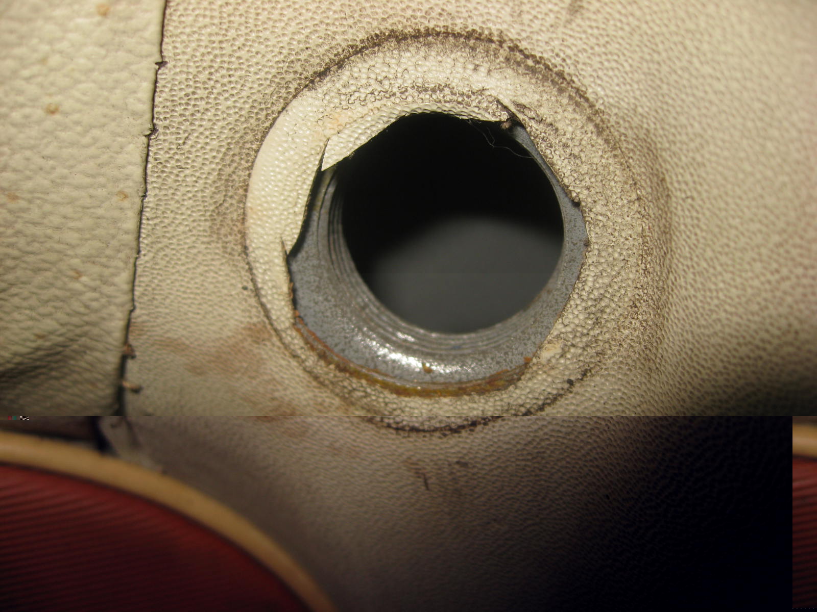

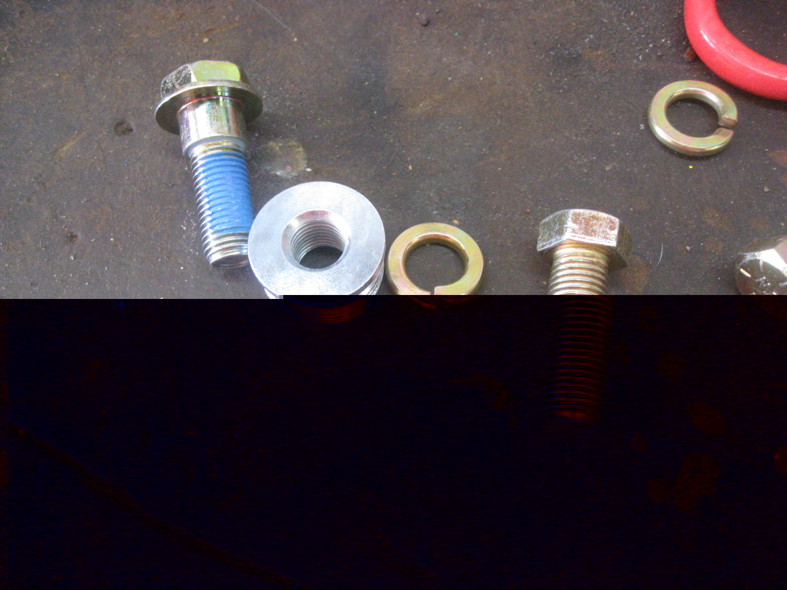

while recovering from having my 4 wisdom teeth pulled last night, I ventured out to the garage for a bit to install my new 3 point seat belts form WW. I ordered the special adapter that reduces the stock 62-65 belt hole down to a std size. It bolts right into the stock ' holes'.

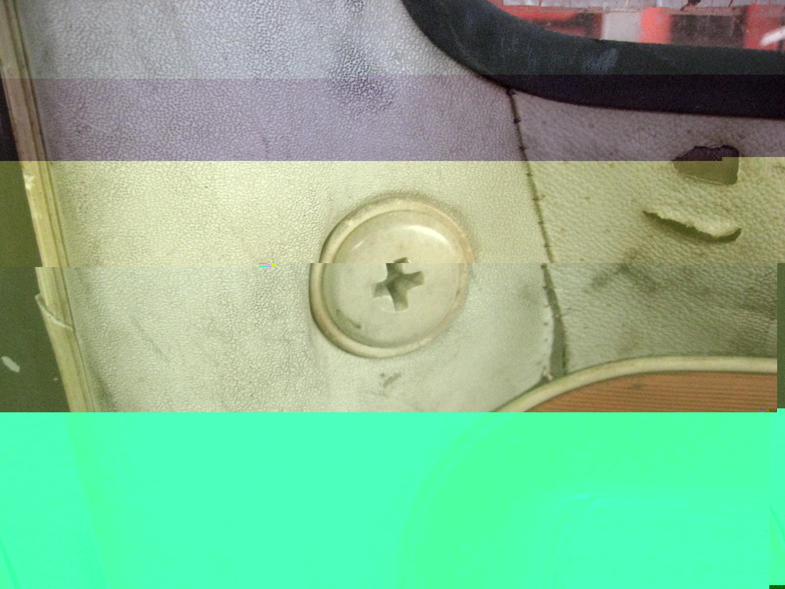

some pics of the 'new' door panels and seats

Careful, creating seat positions by mixing and matching seat belt bungs is a bad idea. This coming from my "EMS" hat. I'm sure you knew that when you posted it...
Re: 63 rag
ObnoxiousBlue wrote:Careful, creating seat positions by mixing and matching seat belt bungs is a bad idea. This coming from my "EMS" hat. I'm sure you knew that when you posted it...
talk to me.... Did I miss something? What is your fear? Im not really mixing and matching, more so, installing the bung reducer that reduces the size of the hole so I can bolt in new seatbelts.
Im going into this knowing that its a vintage VW from the early 60's, 4w drums, non collapsible steering column, steel interior, no pass mirror, 40hp at best, etc. The assumption here is any collision will be not too pretty. Just trying to secure any bodies in the vehicle to the best ability without modifiying it and 'making' it a modern vehicle. Its the exact opposite of the 6k lbs 380 hp truck I drive daily...thats a given.
Posts: 1421
Re: 63 rag
Raj, I dot expect the 63 will ever be safe in comparison to the tundra. And certainly you're right that any collision would be messy. But the goal of belts is "pre-crash positioning" the game is all bout putting Liam in the best position assuming a collision WILL occur. Bung reducers have nothing to do with it. Also, I'm not sure how the stock bolts are secured in the body of a beetle. But, given all modern cars there is a rail under or in the body that connects each side of the lower portions of a seat belt. On three points, this rail runs between the bungs for the lower point of the retractable, and the anchor point of the femal end of the buckle. The purpose of this rail is to prevent the metal around the bung from fatiguing, and shearing when force is applied to it. I believe (recalling Reise) that VW tried to work around this by using larg flange style nuts in the floor.
Also and a big also at that, make sure whatever belt you put on his seat either has a locking clip on it, or has the jambing slide bar in the latch to keep the seat from sliding around.
Is anything better than nothing? Maybe...
Is it worth looking at the floor of your car to see if the middle is really the best position? Yes.
Re: 63 rag

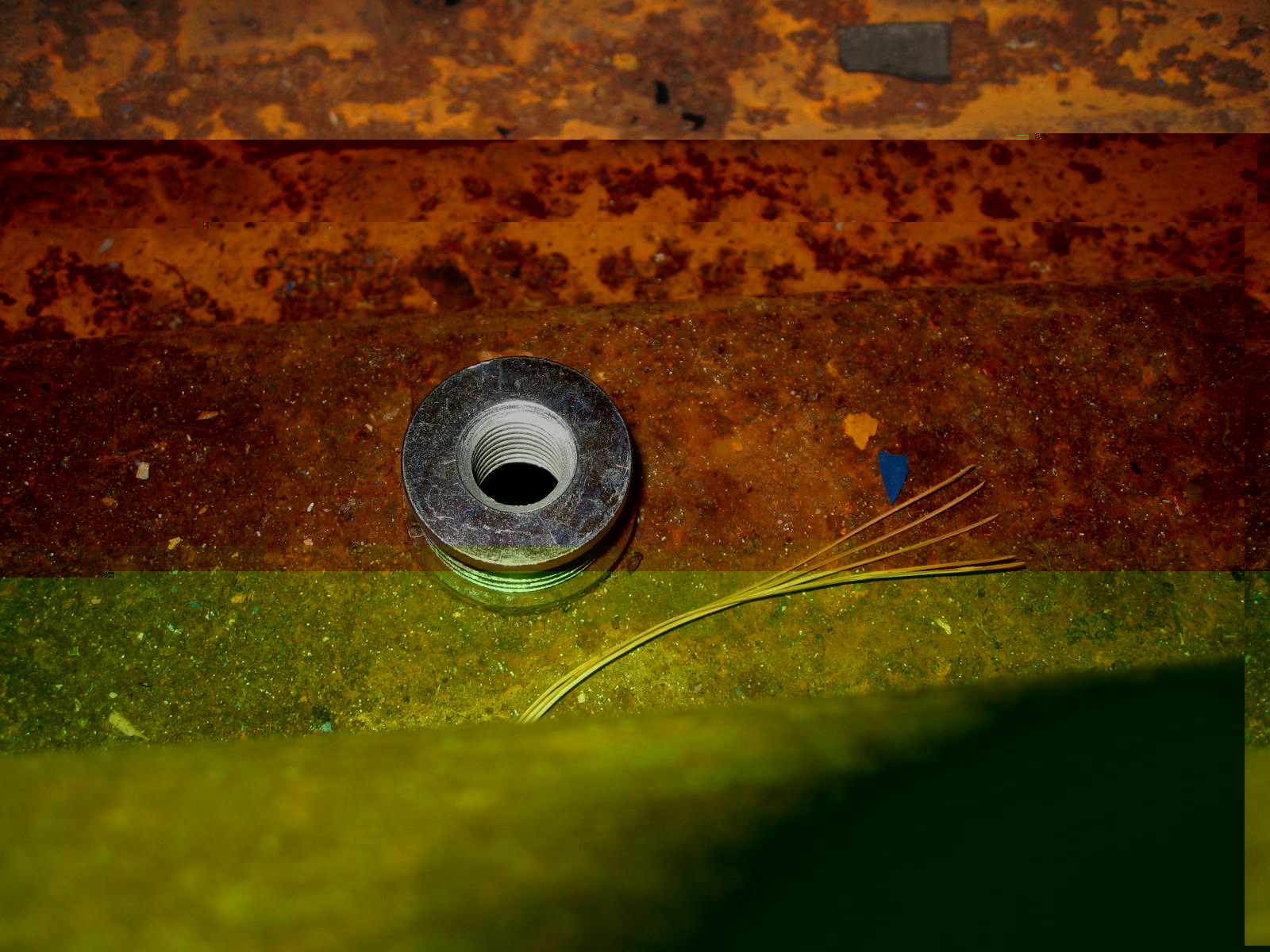

oh I gotcha. Your concerned with a) ideal seat location for him and b) using one belt hole from one seat position with another hole form another.
These old VW dont connect the hole with hole, rather, like you said, they weld a plate to the bottom side to increase the foot print on the hole and hopefully reduce the potential to tear the floor
this is the 62-65 24mm 'hole' , as seen form the bottom. My plan is to replace the one side in the aftermarket pan on the PS of the car
as far as location of the boy. I originally was going to put him behind the pass seat so I can see him good and help him if need be. The other nice part about that location is her would have a 3rd shoulder belt for his car seat. But then I thought he'd be safer in the middle, in case of side impact. I can use the top of the seat strap and a fix it somewhere.... maybe.
I'll check the floor though, like you said.... I wanna see what the other side looks like

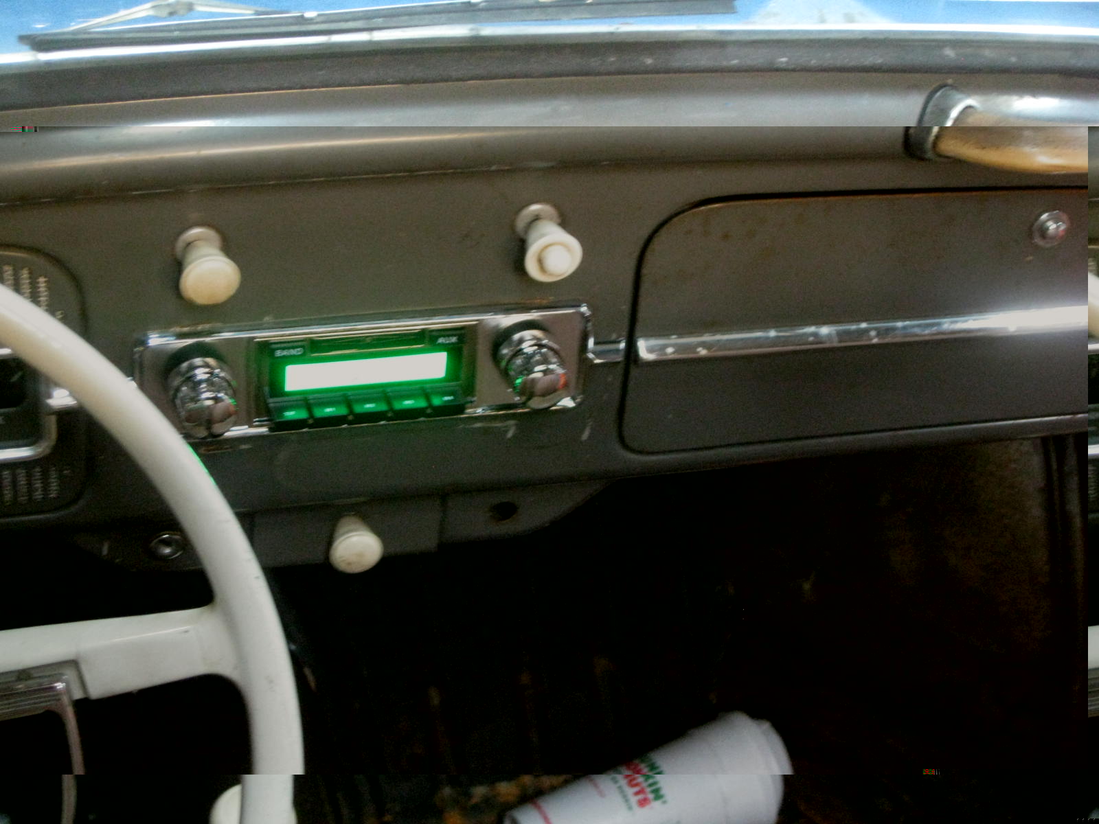

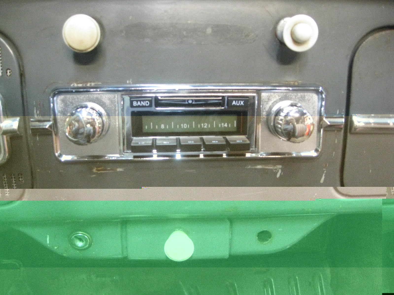

new radio.... fit sin stock location and included a trim plate that mimics the factory trim. No CD, but AUX in..... exactly what I need.

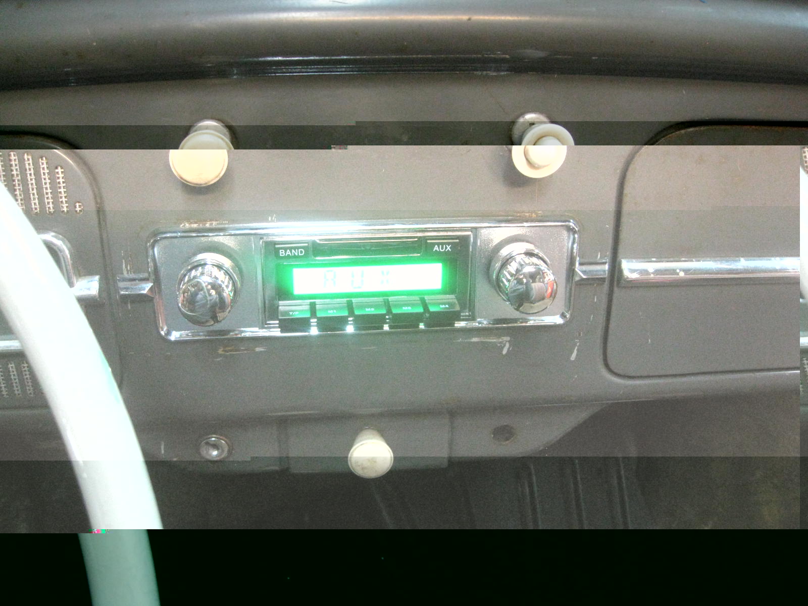

when off, it looks like a dial radio
when on... LED screen lights up behind
Not to keen on the knobs but for $159 shipped, it will work. I just need to iron out the speaker situation now. But she will be good to go for the Christmas Parade!
Re: 63 rag
Slick stereo, but where's the little red station indicator? I like it!

Big_kid wrote:Slick stereo, but where's the little red station indicator? I like it!
Thanks Charlie..... no red indicatior. Also the dead giveway is the markings on the presets for real presets.

Raj, who makes that radio? I remember there was a company someone posted about on here that had retromod radios? Retrosound? They have ivory type knobs...
Re: 63 rag
ObnoxiousBlue wrote:Raj, who makes that radio? I remember there was a company someone posted about on here that had retromod radios? Retrosound? They have ivory type knobs...
retromod was the other radio I was looking at. I didnt want to drop that coin on it, especially considering I dont really listen to CD's ($300 range)
This unit is the concours series form custom autosound
http://www.classiccarstereos.com/produc ... M-230.html

ObnoxiousBlue wrote: Id imagine you could get another knob that looks more correct.
Function over form for now with this one but agreed. I'll keep my eyes open. I might even have some on a few old stock radios I have in the basement. The only issue is that the new radio has a inner and outer knob for bass/ treble etc. Maybe I can rig soemthing.
Now I need to find a used chrome single side post antenna for it. I was surprised to see nada on TS.
