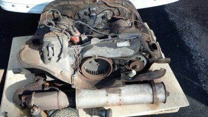

Re: BEN GRIMM 73' WESTY
So...started a little discovery stage see what's what
Removing the Tins...
Tins off...new flywheel, clutch and pressure plate...and a CRUSTY heat exchanger
I CALL THIS THE GLENN RING MONEY SHOT....ISN'T SHE SEXY.....
and if that didn't do it....LOOK at the prize inside !
no a bad day....
no a bad day....
- Posts: 1426
Well... It's an engine. That looks like one of those rev limiting rotors, and that's no Ring Money Shot, it's an aluminum body. He don't fix no stinkin' aluminum! Lol
That heat exchanger is toast. Matter of fact, it's probably trapping and concentrating heat under the head rather than directing it out the ass of the bus.
Speaking of the ass of the bus,how you doing today Dave?
Kidding of course!
But back to the bus. Can the can, ditch the cat. Check the condition of the F pipes off the heads, if the heater boxes are crunchy the F pipes probably are too. Careful removing the boxes, that "U" pipe will probably want to snap in half. Lots of PB blaster...
You don't need to pass emissions, so get yourself the Bus Depot extractor (it's a good, solid, and cheap exhaust set up...) all in you're looking at $120 for the extractor versus $3-400 to try and track down all the 7 or 8 pieces on a factory Federal exhaust like you have now.
I don't have an engine stand, but from waht I can see so far, the F pipes are ok, and both "U" pipes...when your looking at the engine the left heat exchanger is in ok shape, but the right one is toast...I cut the cat and the muffler off in hopes of getting to the bolts on the flanges, and there is no way they will come off easy...I cant even make out the bolts, nuts, there like large globs of rust...besides PB, heat, and/or a hack saw...how else can these be taken apart...anyone w/ a plasma cutter?
In the distributor is electronic ignition....no points to adjust...and cause its a '78 hydraulic lifters...no valves to adjust..
yea, I'm going the extractor set up, quick easy and painless in the walet.
so.. so far..I need one or a pair of heat exchangers...the exhaust, carbs, voltage regulator, and also a fuel pump, now that she is no longer FI, I need an electric pump for fuel delivery...

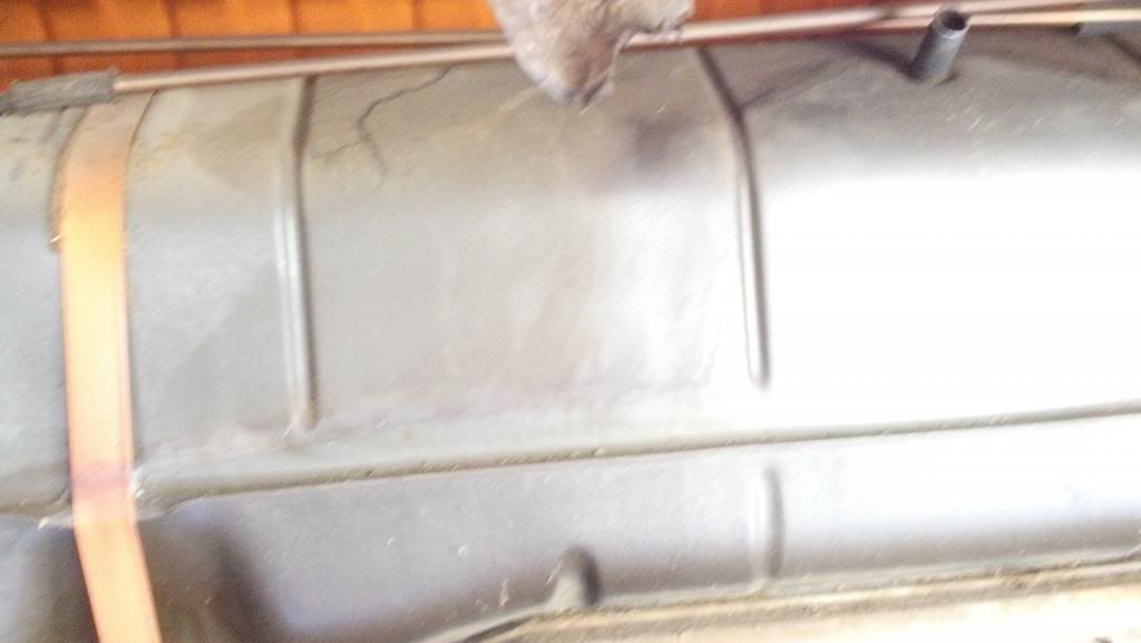

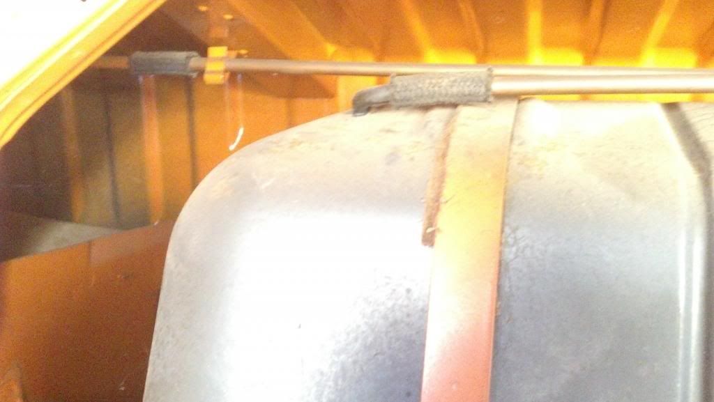

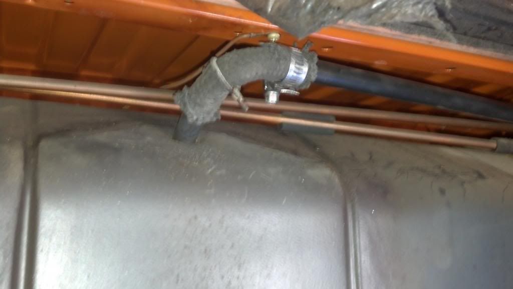

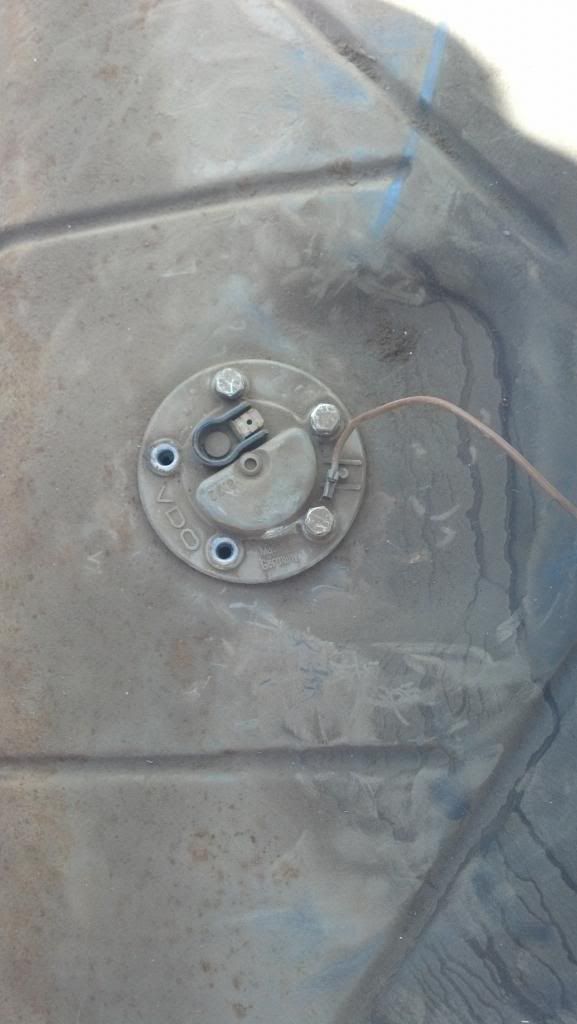

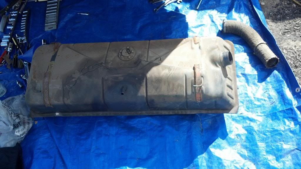

all the vent connecting tube's will need to be replaced.
all out and ready for a good boil and seal ...get the inside ready for some fresh gas
