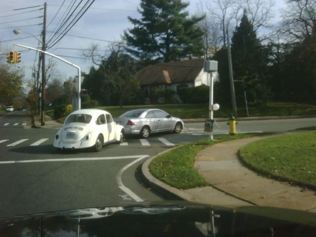

Well... it didn't make it under it's own power.
Audrey called me saying the engine was running rough and the generator light came on. Since she was very close to home I told her to turn around. I grabbed the tow bar and it was just easier to tow it to GT Imports. After I unhooked it I turned the key and it started right up. I drove it two blocks and it ran OK. Tony and Wayne took a look and replaced the points and condenser, never replaced, adjusted the carb and set the timing. It ran 100 times better. Most likely it's crap in the carb from the hardline. I originally figured to change the fuel filter after a few tankfuls, but guess it needed it sooner.
Tony's gonna give it a complete once over and get it inspected. Other things are change the gear lube, adjust the brake pedal freeplay and tighten the clutch cable.

Well the 'wonder' made it's way to Tony's today, but not under its own power. Had it out running this morning on a 15 mile drive. Later I headed to the shop but even before I got it out onto Sunrise Hwy, the bug was bucking like a bronco. Stopped a few times to see what the fuss was about but then the alt light came on and the fuel gauge was swinging like a pendulum. Pulled over and gave GR a call to get his take on this since it has been running without any issues. Made it home with the same senario, and then GR offered to tow it to GT so that what we did.
Early diagnosis is the fuel line/filter. So I left it at the shop for Tony and Wayne to get it purring. Wayne already had it sounding mucho better with a few adjustments and a very well trained ear!! There's a few more things on the list to work out.
