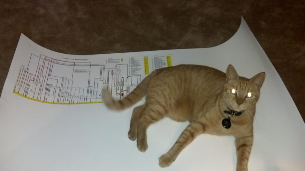

I decided to pack things up and give it a fresh look.
even though the wiring is very basic, I cant read the diagram (because i don't know how)
but confirm if I'm wrong, power to the coil comes via ignition switch, so I'm looking for a wire that goes hot w/ the key in the on position and that goes to the +(15) side ofthe coil....
thats Simba wanting to help figure out the wiring issue
power to the coil...no

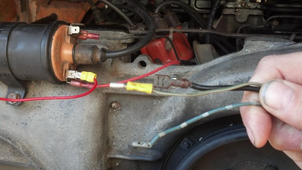

Re: BEN GRIMM 73' WESTY
The great thing about ACVW's is there aren't too many wires...
You can see on the coil I have the elec ignition red on the pos side of the coil along w/ the fuel pump (also red)( In my hand i have a seperate small harness coming from the front of the bus(yet to be traced) The black I assumed was from the ignition (to the coil) andthe others were for warning lights on the dash. Besides the fact that it was the only wire that could reach the location of the coil and other possible sensors.
I turnerd the key in the on position and I don't see any power on the black wire...
sugestions??
sugestions??
