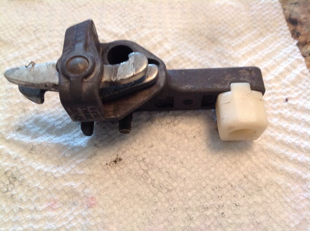

Sliding door has been a bit sluggish, it hasn't been popping out away from the body as energetically as it once had. I've been following the instructions on Itinerant VW, and got stuck today when I didn't have a gear puller. Though, apparently we do have one downin the basement so I'll get back in it tomorrow.
Got the track cover off, that was a project because some a$$hole painted the cover, and the beading on the bus. I'll be fixing that and putting in soft, new beading while its apart. The door is separated from the body at the slider hinge, but the rollers are still on. Hoping to get the mechanism stripped down tomorrow, then want to give it to my friends dad, who owns a metal plating shop. I'll have him acid bath all the parts so they're clean with no debris and chrome the slider's U bolt so I don't have to worry about the paint chipping onit anymore. I've seen early bay's with the chromed slider hook, not so much on the late bays. But it seems like a logical upgrade.
Funny that this has come up, my hinge (the part that bolts into the door) cracked and a piece is missing, I just bought a replacement off The Samba. Mike , did you remove the nylon block ?
- Posts: 1429
No, my block has been missing since I bought the bus, but honestly, it never affected the door. If it weren't for the fact that the door stopped "popping" out, I'd still be rolling without the block.
The block is only $4 from Busdepot, I'm sure they wouldn't have added it to the design if it wasn't necessary.The block stops the hinge from pivoting back and forth.
- Posts: 1429
I have the block, and I know what it does. But in the time I've owned the bus it's been missing. I never opted to put it on because the track cover was painted in place and I didn't want to damage the paint. As the adage goes "if it ain't broke, don't fix it."
Well, now after getting gummed up with paint when the body shop painted the roller arm it was time to give the slider some attention.
I've been following the step by step, and the guys on TS have been very helpful.
I used a gear puller to get the bearing off of the roller body
Then, I released the spring and removed the "door side" of the assembly.
With that off, I used a 13mm to remove the nut that holds the check in place, and slid that, along with the roller body off of the U bracket. I took some pictures so I can orient the check back in the same position.
With the three main pieces broken apart I'm now soaking the parts (minus the roller bearing) in some Purple Power degreaser. I had tried using simple green but that shit was doing NADA. So I'll let the parts soak for an hour or so then try to break the old nasty grease off.
I'm going to give the U arm to my friends dad to chrome, hope to have that back by late week so I can reassemble everything before I forget how it came apart!
Pics later when the parts are all clean.

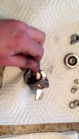

I've got all the parts cleaned. The bearing is soaking in some motor oil and I'm looking at the slider assembly. I've noticed that one of the "spring loaded arms" isn't moving freely like the other.
Here is a video so you can see what I'm saying:
http://i256.photobucket.com/albums/hh18 ... BE7590.mp4
Is this likely the source of my original issue (maybe why the door wasnt popping off the body?)

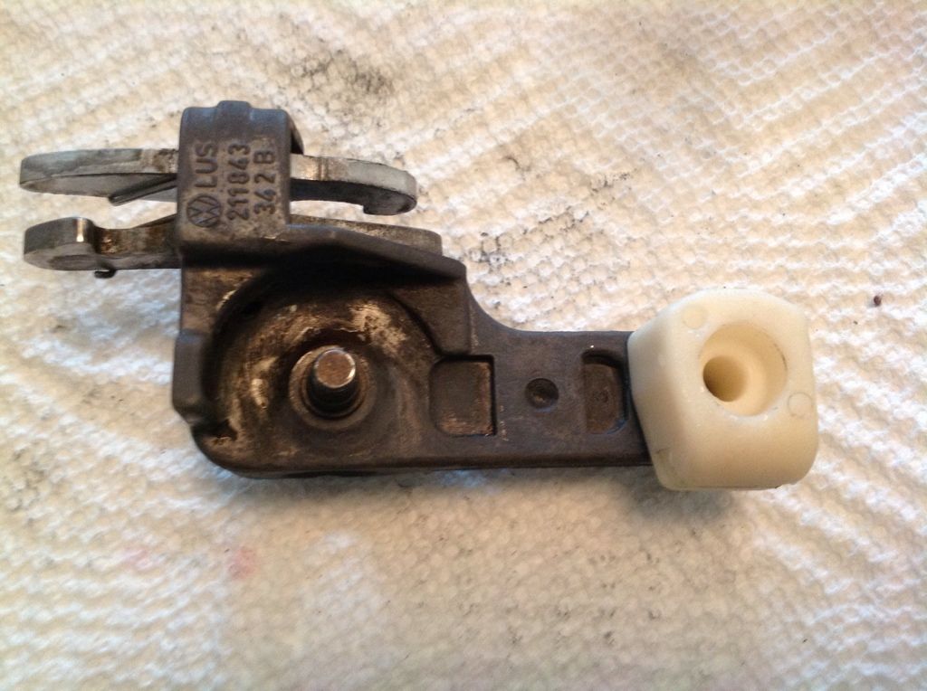

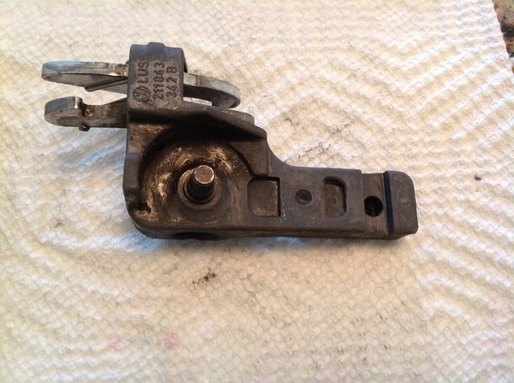

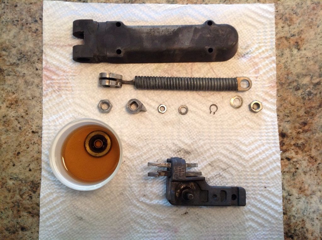

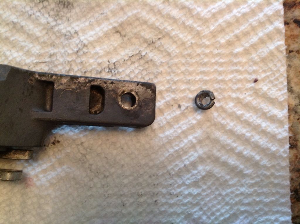

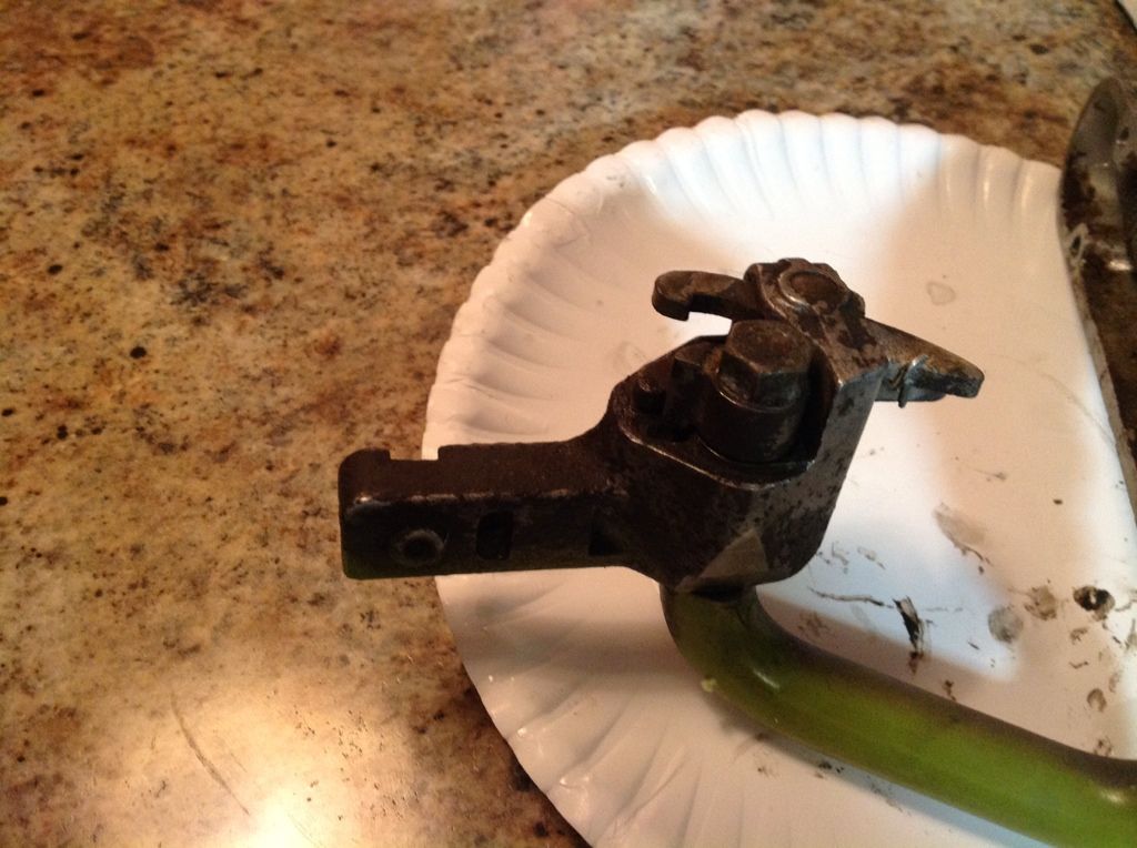

Here's my pile o' parts... Wasn't as hard to get apart as I thought, the bearing and gear puller did test my patience though.
I drilled out the old rivet, and test fit the plastic guide bushing...
I'm going to use some metal polish on the surfaces that are exposed when the door is open.

I have to order new beading tomorrow, I just took everything apart yesterday, and obviously BusDepot is closed lol.
I'm bringing the arm to be chromed tomorrow. That will take a day or two. I'm going to show him the door bracket and the roller assembly too, he thinks he might be able to give them a quick acid dip to at least take the staining off of them. The grease is all off them, but they have some discoloration. It doesn't matter much because no one will ever see them, but I'm not taking this apart again lol.
Then, once I have the pieces all back I'll use some gasoline to clean the track reassemble it all, and send the bus back to have the cover reprinted and the area just behind the rear window from where the dirt and sand from within the beading scratched the body.

Made arrangements today to send the bus to the body shop on Monday. I'll sand the old paint off the track first, they'll be painting under the cover, the cover itself, and touching up the D pillar above the beading and at the end of the track cover. There was apparently dirt which worked its way in between the beading and the body and as gentle as I was in removing the cover it still cracked the paint where the track and beading was painted on the body. That'll be done right this time in case the slider needs service again in the future.
The bottom roller will get cleaned out and regreased after this,mince that won't require any caroming, or paintwork.
Tomorrow, I'll be ordering the beading and a new rear passenger side window seal. Audrey, if you want to swing by we can tackle this one together so you know what to expect with your windscreen. I'm not a pro, but I've done windows on my 69 Bay, and on Reise... This flat window is a good start and its a good size.
Early baywindows had chrome sliders, late bays had painted. But, as I've already seen with my bus the paint takes a beating; especially when it's lathered in grease. Chrome will definitely hold up better. The slider assembly and door assembly will be acid dipped and then dipped in cadmium. I can't do them in chrome because the tripple plating of chrome will add too much thickness and will prohibit the springs from controlling the door, but cadmium is rust resistant and won't really add thickness where it matters.
