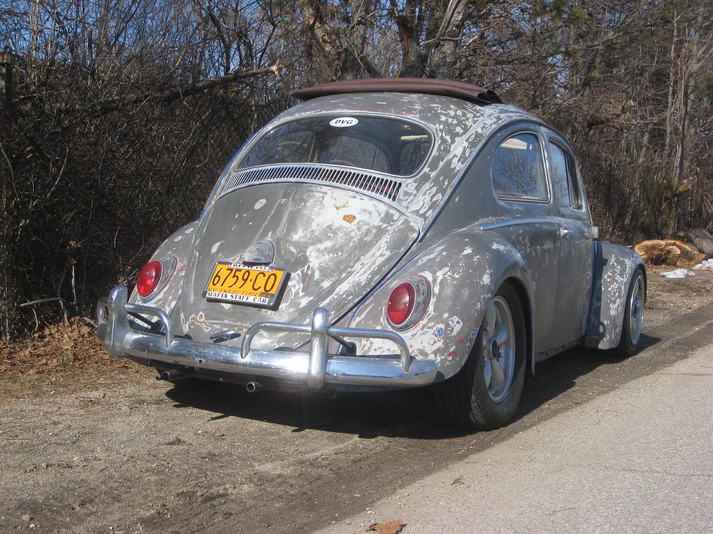

Keep plugging away as you can. Bug's looking good. That plate is like they were when I was a kid. 8-)

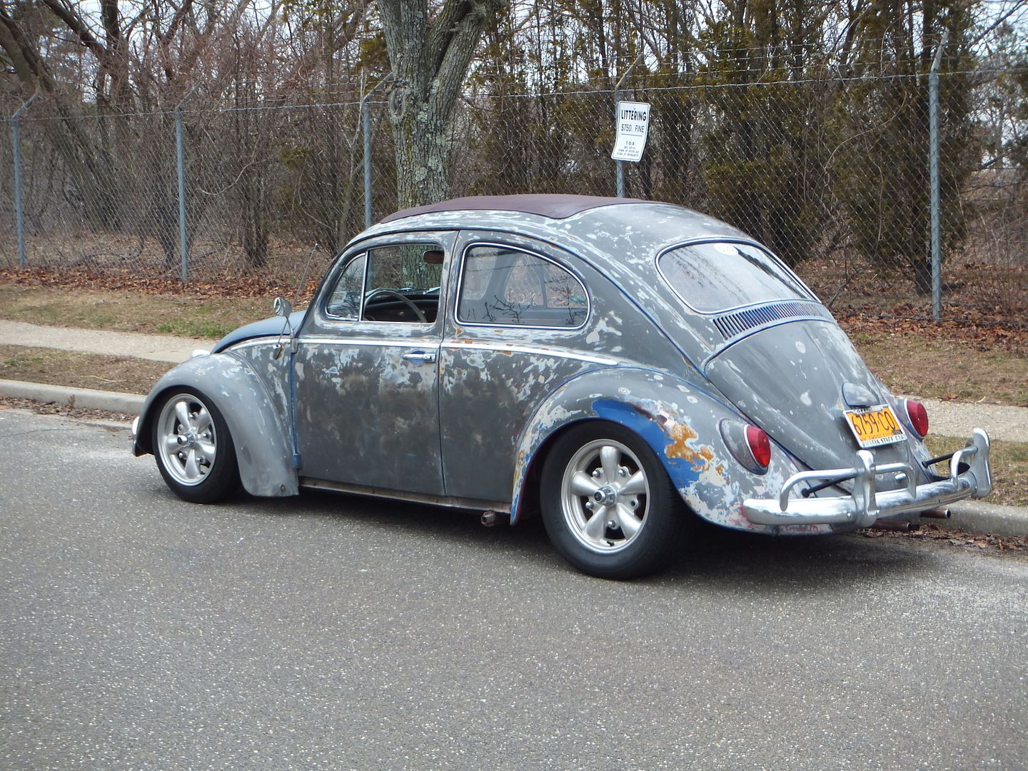

Raj wrote: Image
Another "classic" Raj creation!

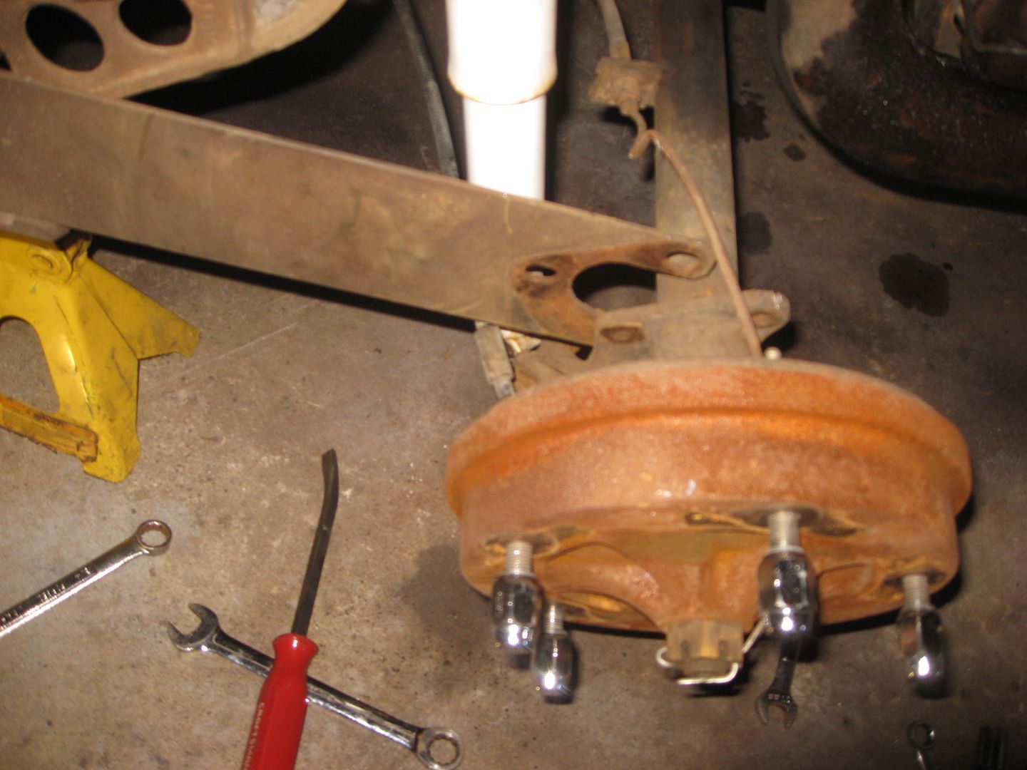

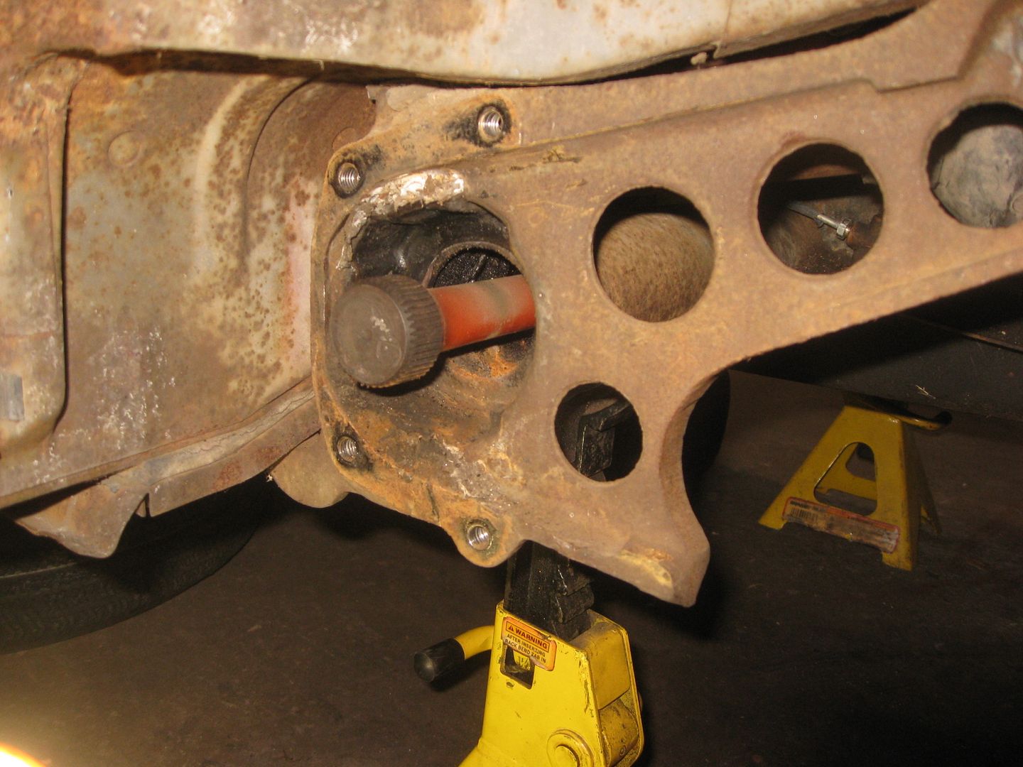

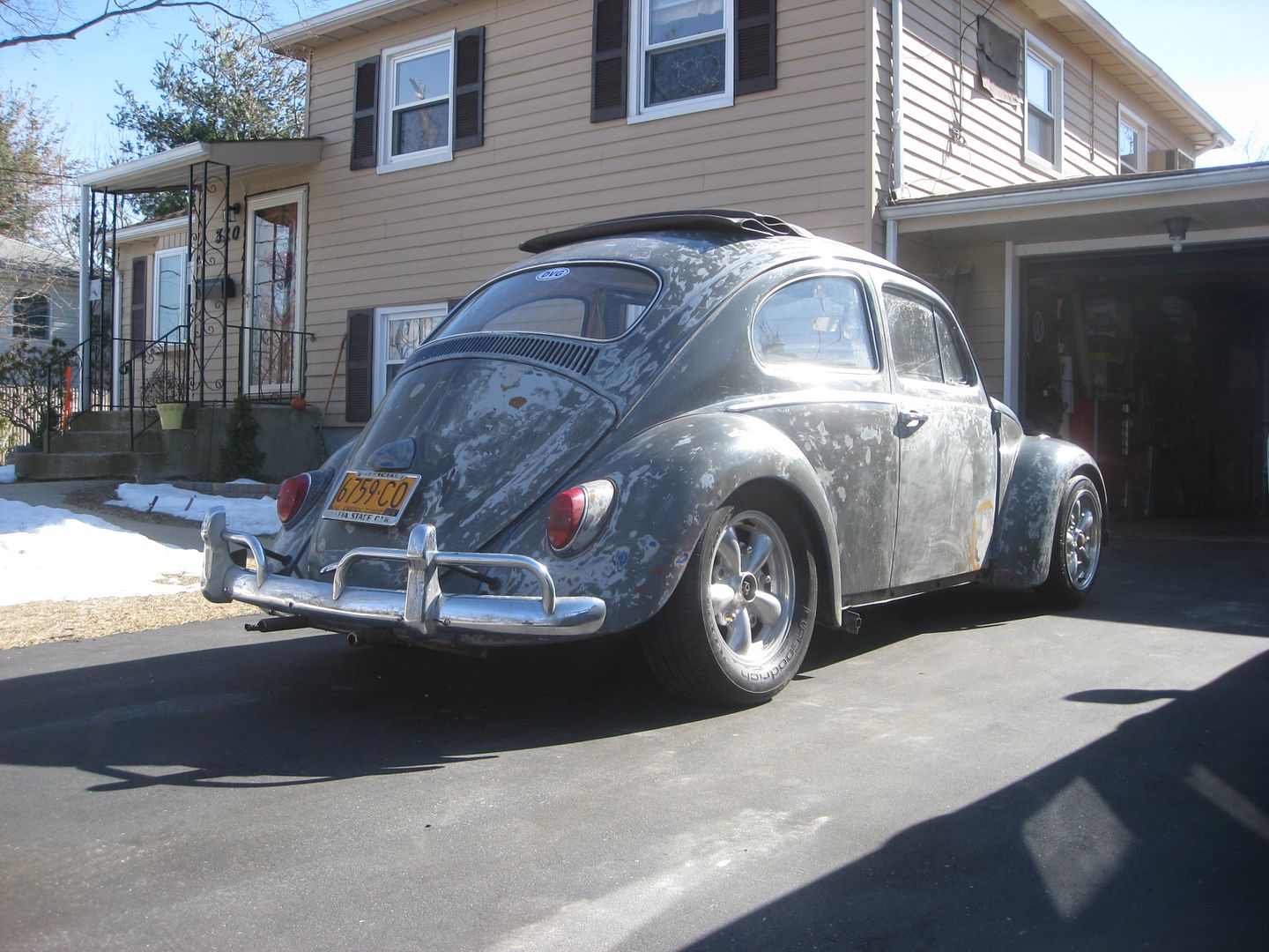

Was super well behaved yesterday, so I got the day 'off' today. Spent the morning addressing the ride height of the 63.

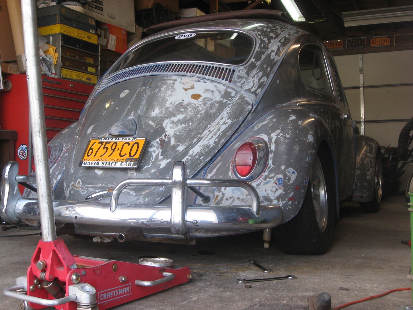

How she started. Bad pic, but scroll back and you can the ass in the air. boooo!
Loosened the ebrake cables, and tossed her on stands. Pooped the torsion cover
Lower shock mount, and the three bolts from swing axle to spring plate
The torsion
The spring plate

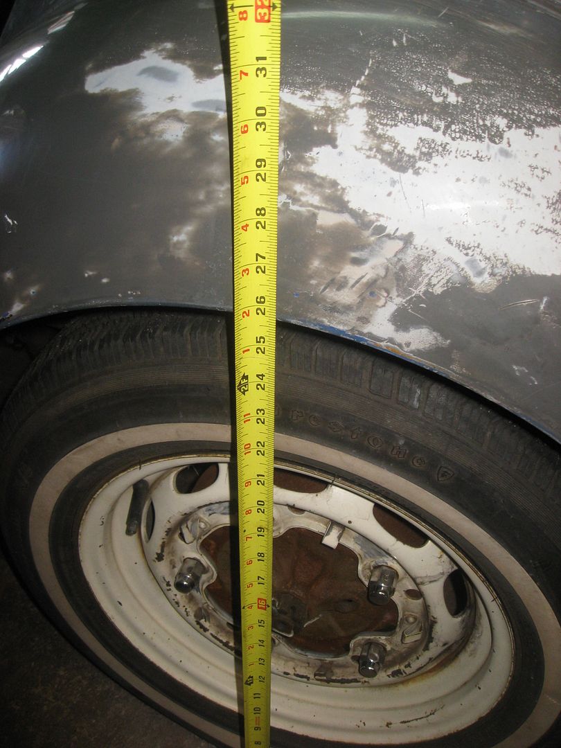

ooops..... 2 clicks. too low....
Back up to one click. that will work until I swap in the 2 inch fromt beam thats coming out of the 65.

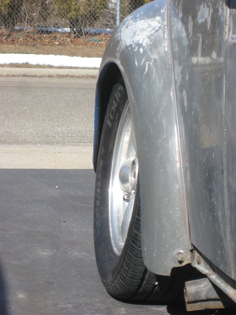

now with 2 inch narrowed CB beam..... formerly in my 65. Going to try to fit the sway bar back on tomorrow
Re: 63 rag
rims and tires are on from the 65, while I sort out some stance mods/ shoes to the 65. Cruised out to bayshore today for the parade..... ran awesome. Much less rubbing with the 2 inch beam

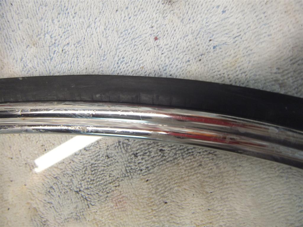

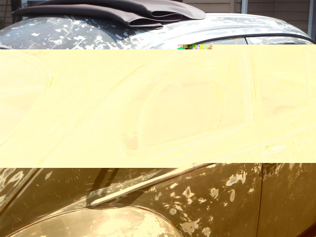

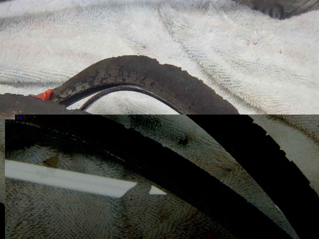

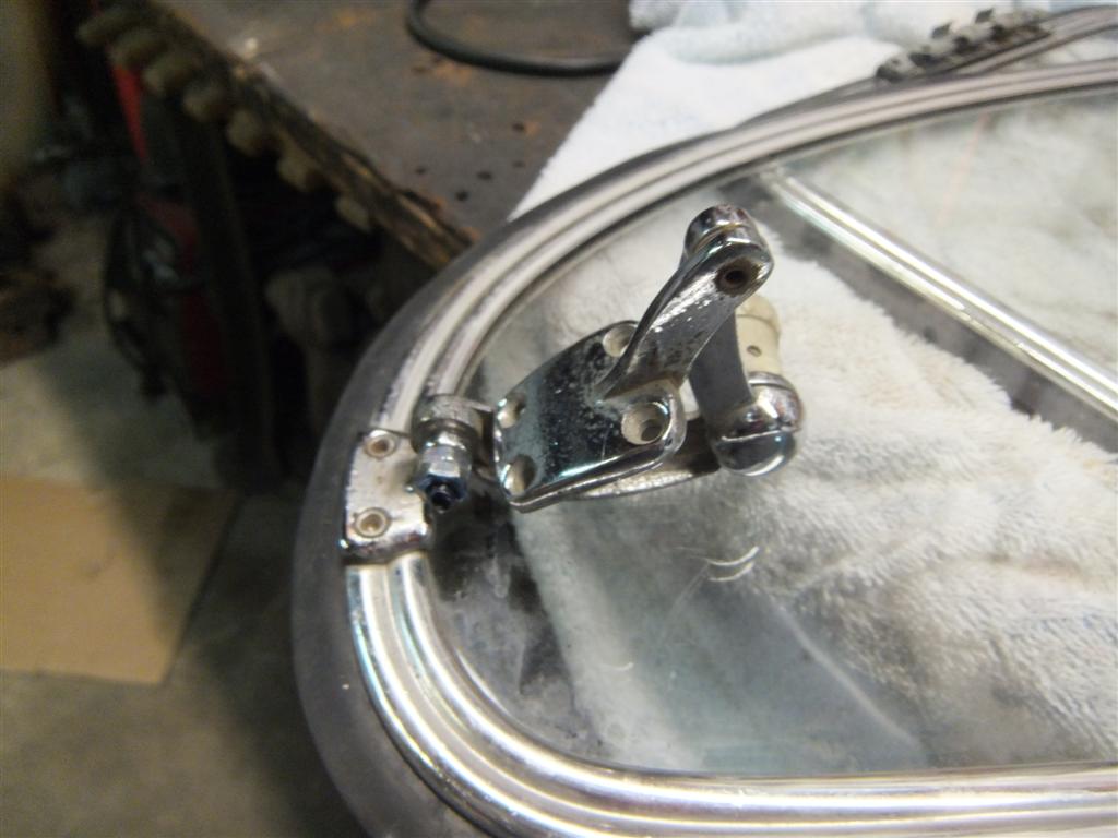

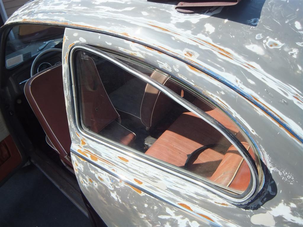

Added some OG pop outs today, along with new rubber seal, pinch welting, covers, harware.
DSCF3832 (Large).JPG (103.13 KiB) Viewed 138266 times
DSCF3833 (Large).JPG (110.86 KiB) Viewed 138266 times
DSCF3834 (Large).JPG (109.22 KiB) Viewed 138266 times
DSCF3836 (Large).JPG (84.14 KiB) Viewed 138266 times
DSCF9695 (Large).JPG (118.89 KiB) Viewed 138266 times
DSCF9696 (Large).JPG (141.8 KiB) Viewed 138266 times
DSCF9697 (Large).JPG (83.74 KiB) Viewed 138266 times
DSCF9706 (Large).JPG (116.13 KiB) Viewed 138266 times
DSCF9707 (Large).JPG (116.91 KiB) Viewed 138266 times
DSCF9711 (Large).JPG (122.47 KiB) Viewed 138266 times
DSCF9713 (Large).JPG (121.88 KiB) Viewed 138266 times
What a pleasure to drive with the sunroof open now. The air noise and turbulence inside are reduced significantly.
