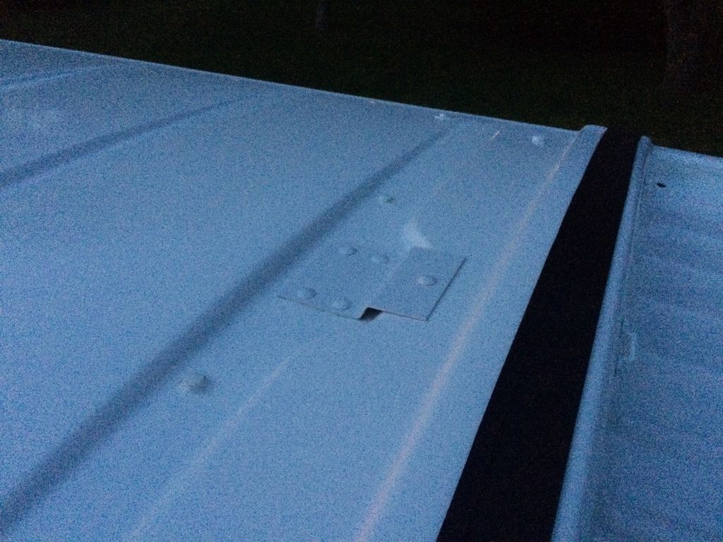

Can I see the paint you used? You really rolled it? How does it look up close? Once I do the rockers and nose on my bus, I wanted to get it painted, and need to address the roof. I was thinking the whole thing needed to come off and get sprayed..... now Im have a bit of relief knowing you took this route.
- Posts: 1421
Raj, I used a foam roller and Interlux Brightside Marine Anti Fouling Topcoat paint. It is meant for boats (read $$$) but unlike the rustoleum alot of guys have used it is meant for fiberglass and if the gel coat on your cap is worn thin you don't want the exposed fibers to "drink" the paint. This stuff is supposedly the best out there. I sanded (80, 100, 120) then rolled on with a closed-cell foam roller. it went on great. There are certainly some high spots but it will need to be sanded anyway.
Going to take it down a bit with some 220, then roll again. For the final coat, they suggest "rolling and tipping" google for videos on how to.
I will probably have plenty left. I bought the gallon and probably needed half.

Looks like new, or what I assume new looked like. Looks like a lot of time and prep envolved, nicely done!

Been fighting with the damn roof. It looks good - not perfect, not great. Just good. Definitely better, but still has some flaws and they show with fresh paint. So, I try to sad it down and then run into or create more until even spots.

Finally got to putting the roof seals on tonight. Still need to adjust the roof hinges in the back and finish mounting the latch mechanism and support bar in the front.

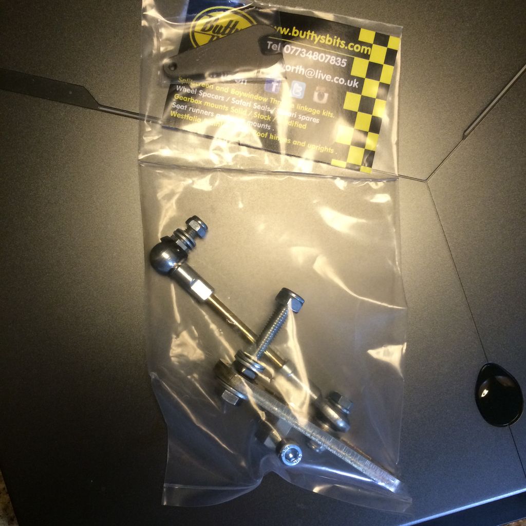

Still waiting for my new linkage to show up from the UK. The new pedal, hinge pin and spring are waiting.

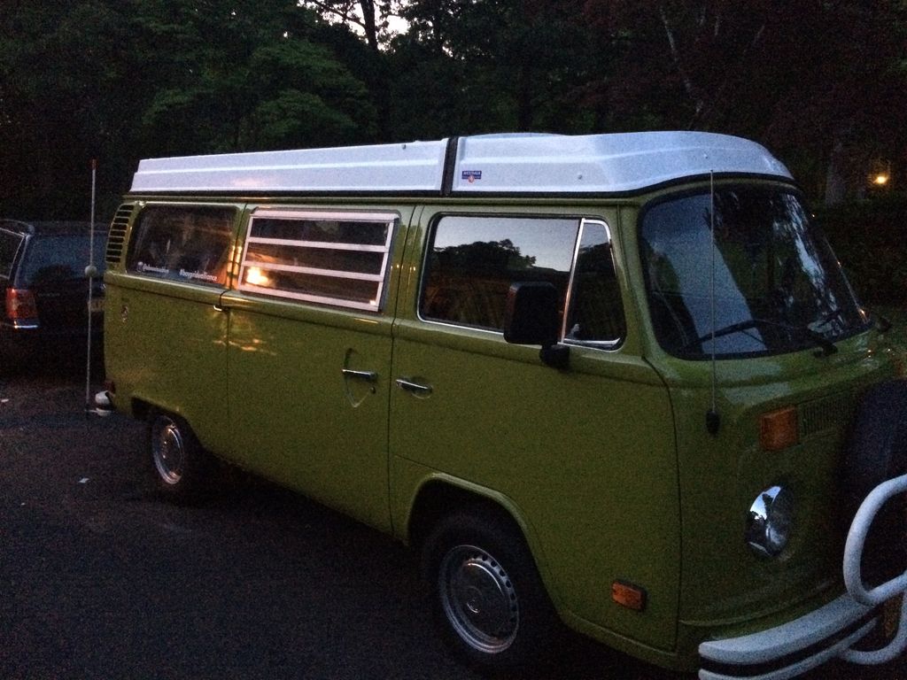

The roof looked really bright when I stopped by today.
- Posts: 1421
Looked good though, right?
All your recent efforts to make Peabody look good have paid off.ObnoxiousBlue wrote:Looked good though, right?
The bus doesn't look like its turning 40 soon, still looks 29!!

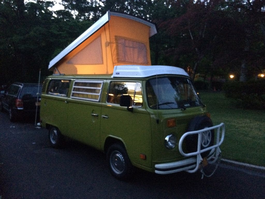

Took the bus to work today, figured I'd stretch its wheels on any easy run after hibernating for so long.
Came home from work and got right back to working on the bus.

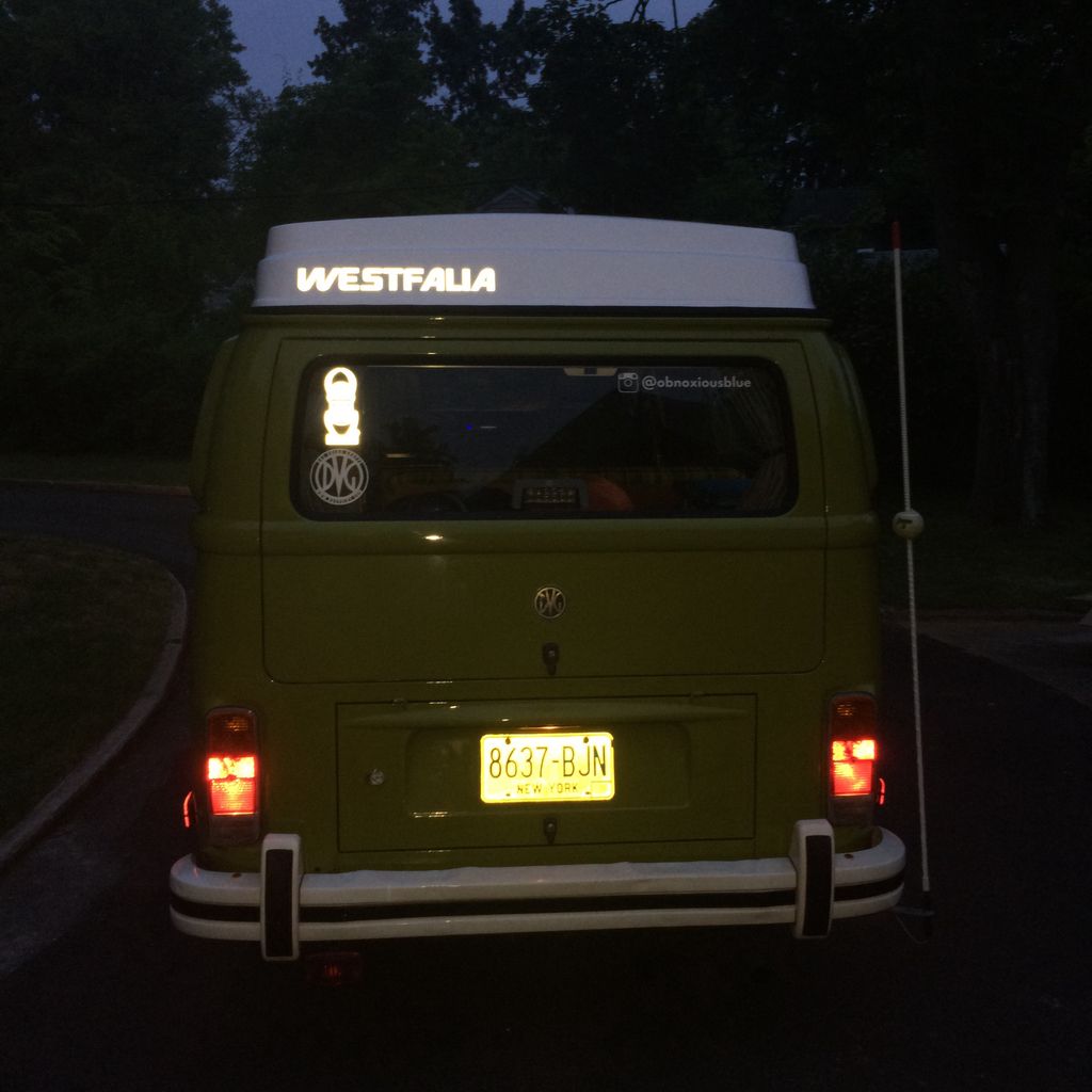

Had already drilled holes in the doors, so I had to button up the marker-flash mod to add signal repeaters to the front door reflectors. Now, where there were once just orange reflectors I now have illuminated side marker lights. Then, I hooked both the new fronts and the factory rears to the turn signal circuits so they flash too.
Installed my new H4 headlights - Bus Depot had a sale for $69 and my old (7 year) headlights were faded and peeling.
Lastly, put on my new Westfalia decal. Technically a 77 wouldn't have decals but I had them before and kinda liked the way they look. I didn't put one back on the front either. Not sure yet if I'm going to...
Check it out, they're reflective!

really nice.... love both these tasteful and practical enhancements.
Shining like a superstar!!

Throttle kit showed up today...
Nice looking joints. Much more better than stock.

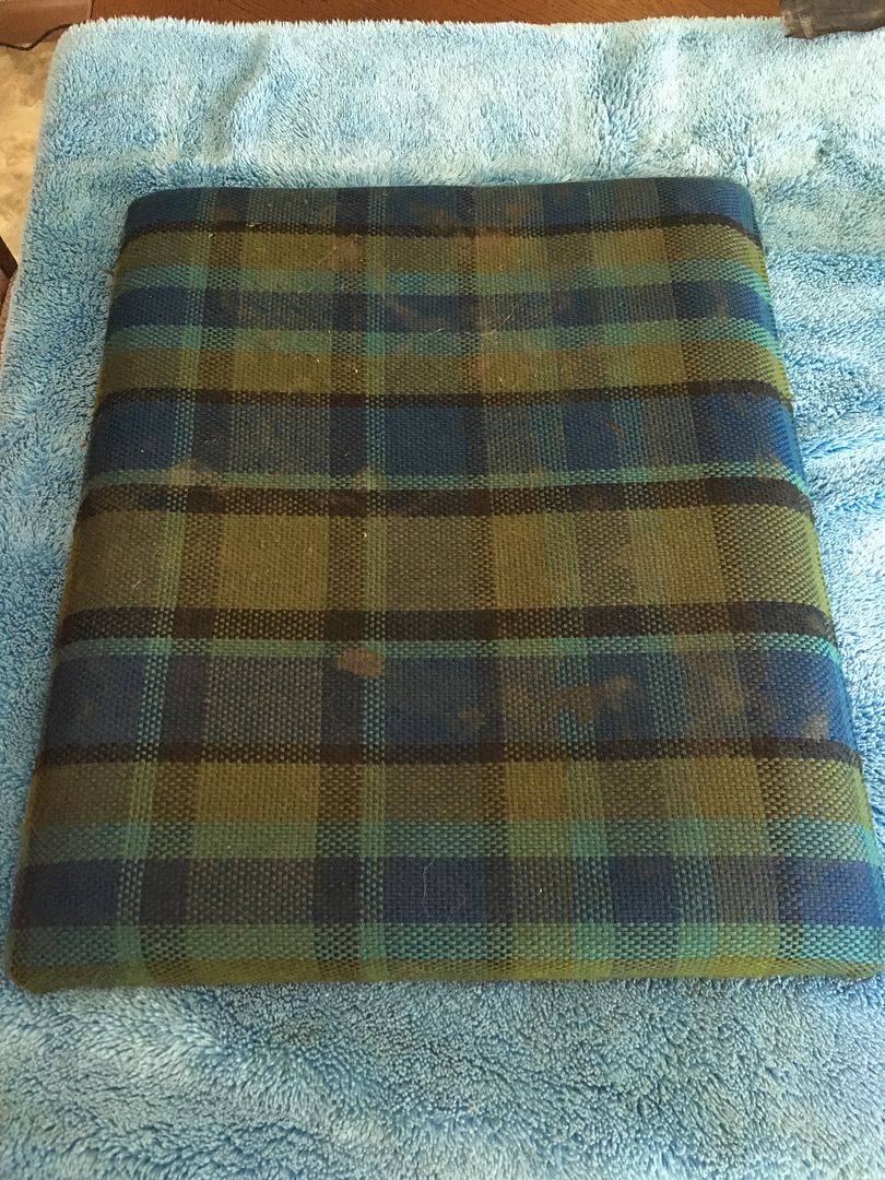

Manny found this stool when he was up at Litchfield and called me about it since he knew I was looking for one. It was in great shape, and has all its bits even thought it is really for a 74 I I'm told and is about an inch shorter from the seats I understand. But, it's practical. If I come across a late box, I'll grab it then. I recovered the seat top today. Not flawless, but it doesn't have to be. Looks good and will work just fine.

Nice work on the seat. A fresh change on the fabric and it looks like new. Your crafting skills are working magic on the bus.
