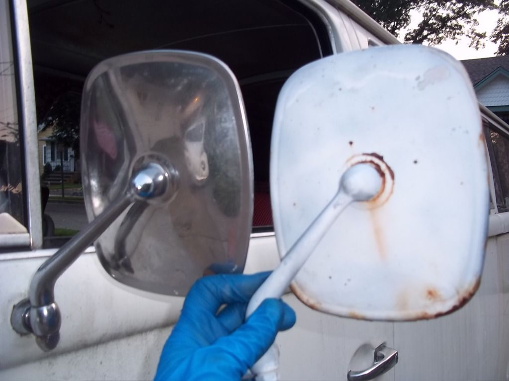

The PO painting also made it way to various items on the exterior so fortunately there was a DS mirror in my box to replace the one was on the bus.
New one is a big improvement. Is that a VW bug in the reflection?? :lol:

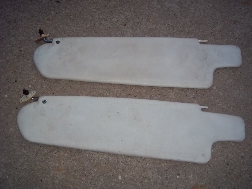

I needed sun visors and the deal at Litchfield was originally 2 for $5, but then the guy thru me his whole inventory for $5 so I picked the best of the bunch and some soft scrub cleaned them up nice. I will use some of my savings from buying new ones for something else.
Getting there! :P
nothing like a little elbow grease on some swap meet finds to make the old into the new again! Good work!

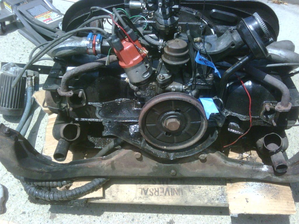

Got the engine out and the muffler off. The dreaded nuts by the heater boxes came off real easy. Spent most of the afternoon cleaning off the oily mess. The oil cooler seals that seemn to be the problem looked somewhat new but the new ones are going in this week anyway. Got the sending unit connected and some of the wires for the oil pressure gauges i redid since lots of bare wire was exposed and just wrapped in plastic. Long hot day but got alot accomplished.
Thanks to Busbbq Bill for his help dropping the engine and know how.

Had good luck getting the engine out and the muffler off. While it is out I am going to get a new external oil filter and mount it outside the engine compartment. The one here (on the left with the nasty blue hoses) is very cumbersome and all the hoses are dry and brittle. And it just collects are the road dirt with the plastic hose coil cover.

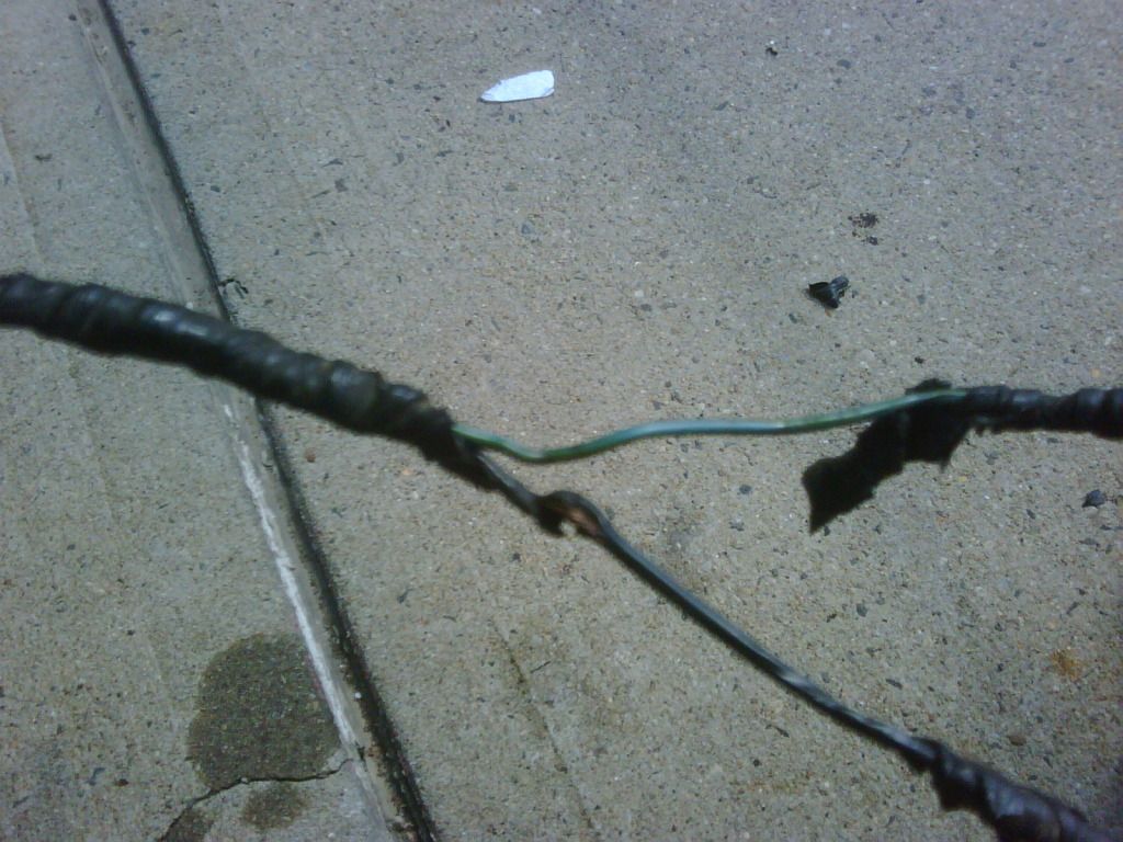

this is the wiring t that I found going to the coil after I removed the hose wrap. I reran new wires.
