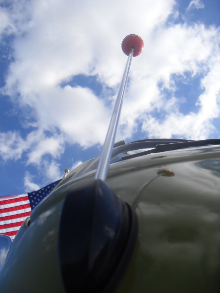

I took a couple of pictures of Mike's bus on sunday
Looks good Manny, I love the one looking up the antenna mast... Very artsy.

I like the antenna shot as well. At first I thought it was your flag pole!!

Theres been some real good shots of the bus this summer... I think they kinda get the aura of what a VW bus stands for... I like how the sky is open and blue, the little antenna ball adds some levity, and the flag poking out in the back is a nice touch
