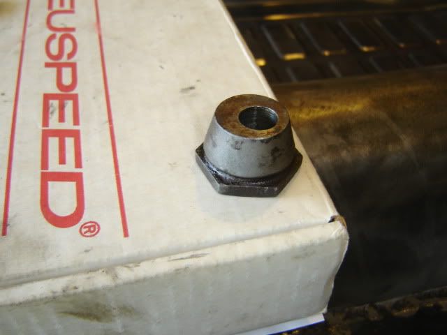

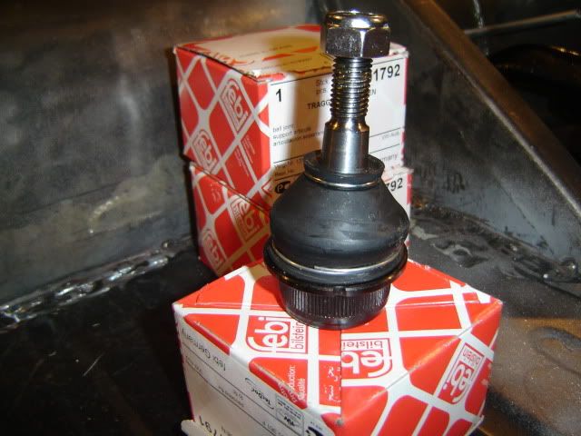

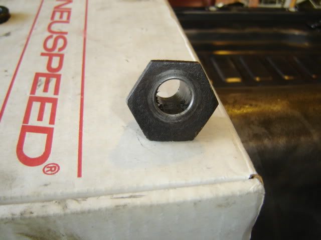

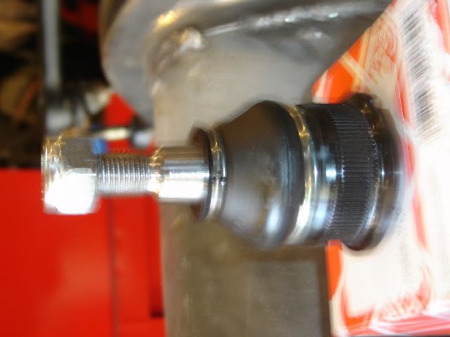

I'm working on a beam and am getting ready to put new ball joints on. The old upper ball joint has some device on it that the new one does not have. Does this come off and I reuse it or do i need to get something else?
Old upper ball joint
New upper ball joint (not installed)
- Posts: 3207
Re: 68 Bug
That's an eccentric for adjusting the camber. They are reused.

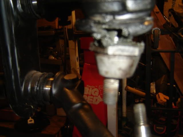

I was able to get the camber adjusters off the upper ball joints using a tie rod end fork. A couple of whacks with the BFM and the popped off.
here's what it looks like on the Ball joint

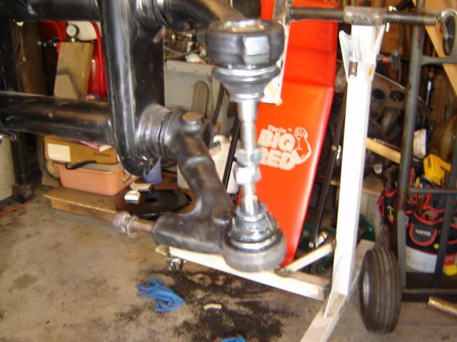

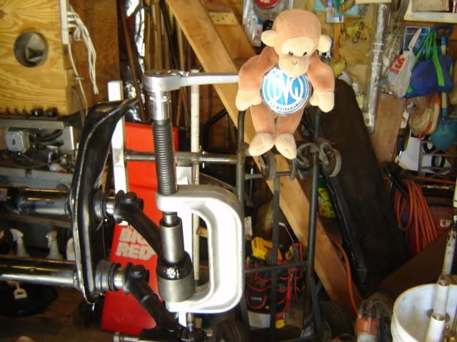

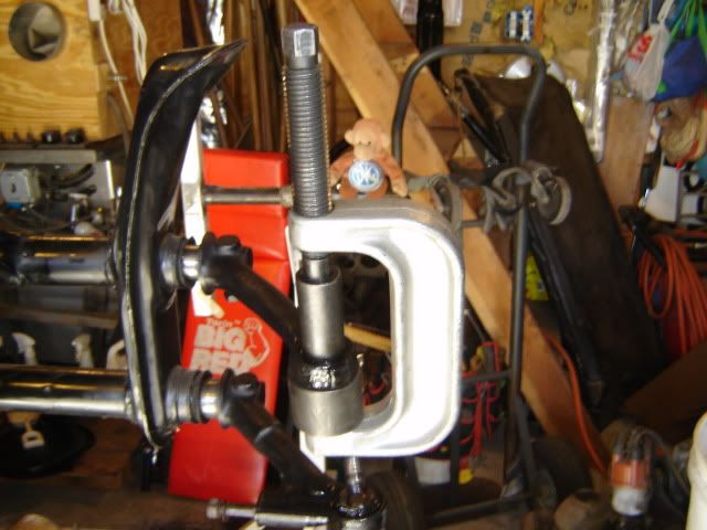

I borrowed a ball joint removal/installation tool from Glenn and was able to get 3 of the 4 ball joints off. One of them i used heat on the but the other two i was able to press out without heat. One of the BJ i just could not get off so i swung over to see Gene and he pulled out a 3/4" 48 ratchet and was able to crank it out.
Here is the tool in action - It's good to have an extra set of hands to help!
New Ball Joints
Here are the two passenger side ball joints installed.
I needed to install new torsion arm seals and for once i got lucky. I seached through my stock of parts and found a set that i had purchased from WW.
New Ball Joints
