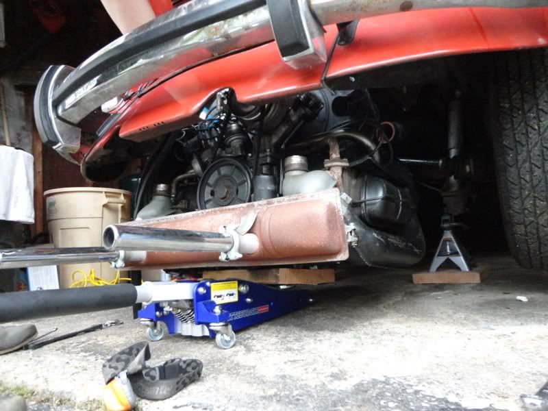

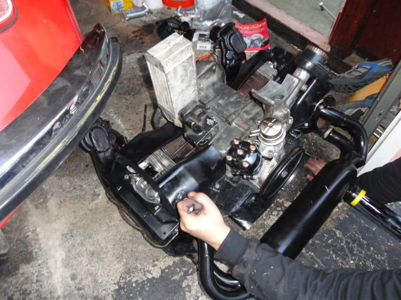

It's been a while since we've posted up in this thread but there's finally some progress to report. Yesterday, we pulled our old engine and started building up a longblock we bought off Raj. Here's some story and some pics for your enjoyment.

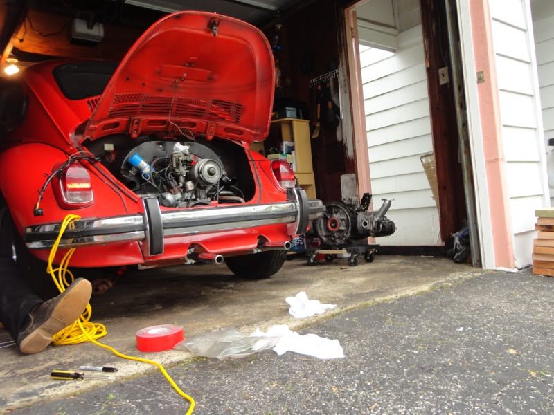

#1: Oil bath gone, tape for labeling engine compartment wires, beer, wire wheel to clean up DP cylinder tin for installation
#2: Me removing heater box cables, longblock in the background

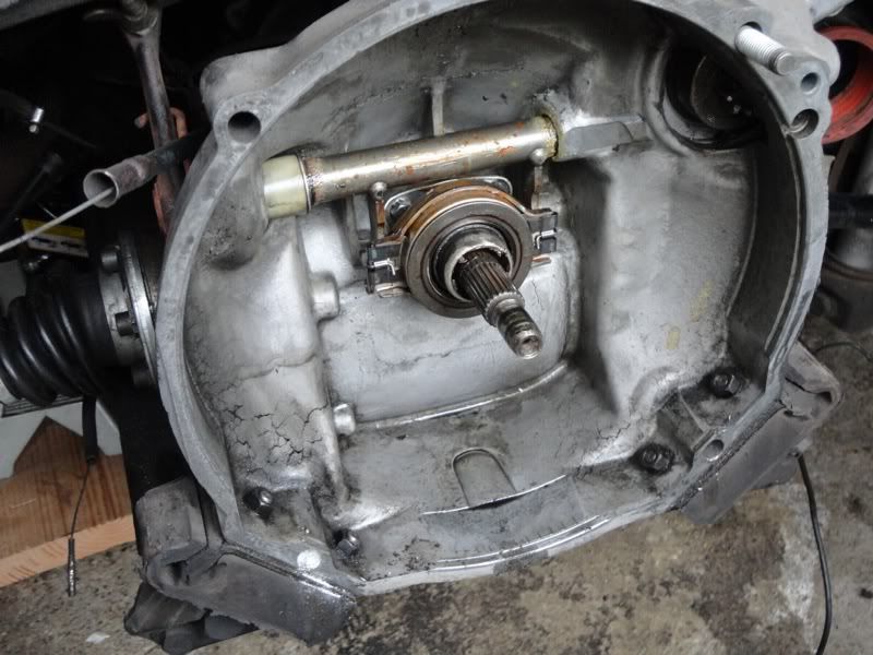

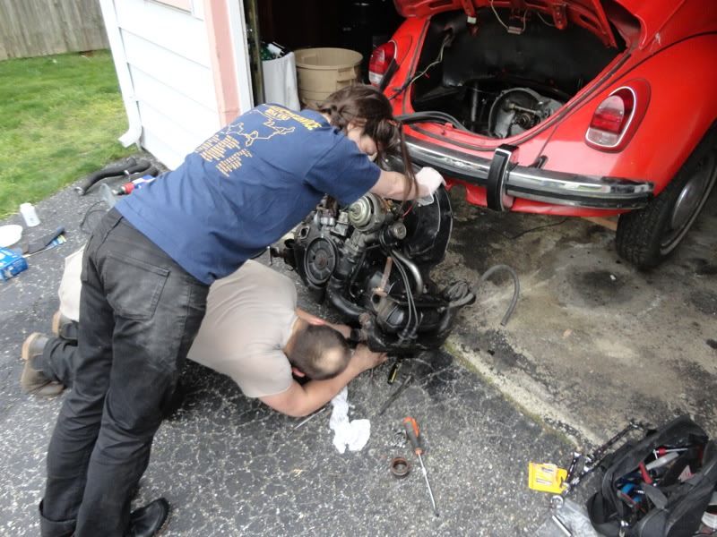

#3: I guess sometimes you lower the engine but don't have the car jacked up enough for the engine to clear the car. Unfortunately no pics of the annoying struggle to get the engine off the jack so we could re-jack the car for the engine to clear it. That headlamp in the foreground comes in extremely handy under the car. Better a lot of the time than a cage light.

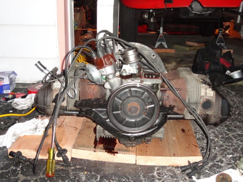

#4: Our compression is a bit on the high side (140) and in our correspondence with the PO, she told us after her rebuild the engine was spitting oil all over the engine compartment. The solution was to vent the valve covers but there's no breather box, just three hoses....the top one goes to the oil bath and the other two go to the valve covers.
Odd thing about this set up is that every 1,000 or so miles, our oil bath would get filled up with way too much oil and start spilling out the horn end so we'd have to drain it. I've read around a bit and can't say I've come across a 1500 rebuilt as a 1600 needing vented valve covers but I guess there's a first time for everything.

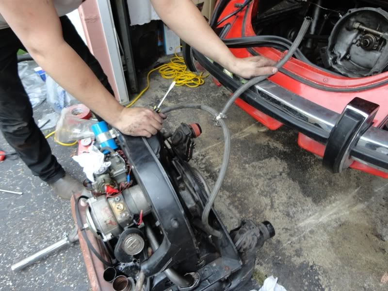

#5: Wasn't too thrilled to see this. The engine was only held in with 3 bolts!!! The top one on the driver's side was nowhere to be found. The logic was what? Why use 4 when you can use 3?
Also wondering what that white powder is in the hole where the lower driver's side bolt goes. It's not metallic...just white powder.

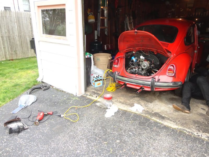

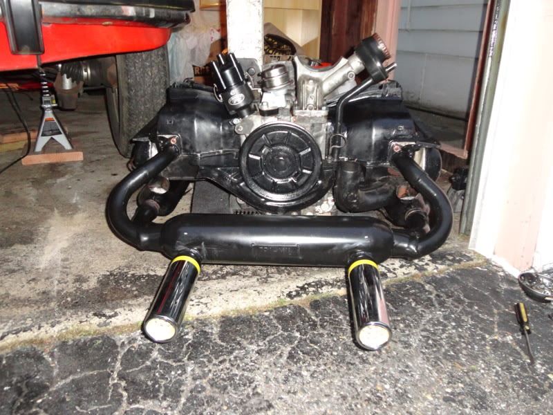

#6: Must remember in the future to remove thermostat before engine is on a cart resting on the heater boxes and related tin. Not fun. Have to tilt back engine, remove tin, then remove thermostat.
#7: There it is....out and stripped down. Don't know what's up with the sudden oil leak and didn't bother to check.

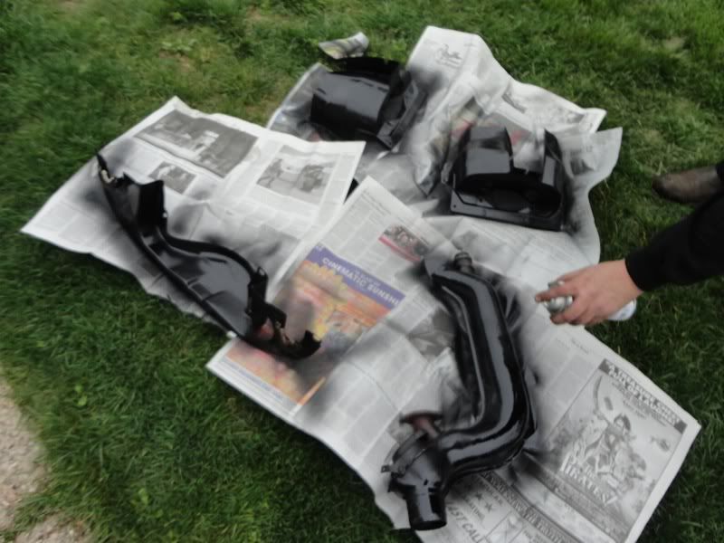

#8: Tin cleaned and painted

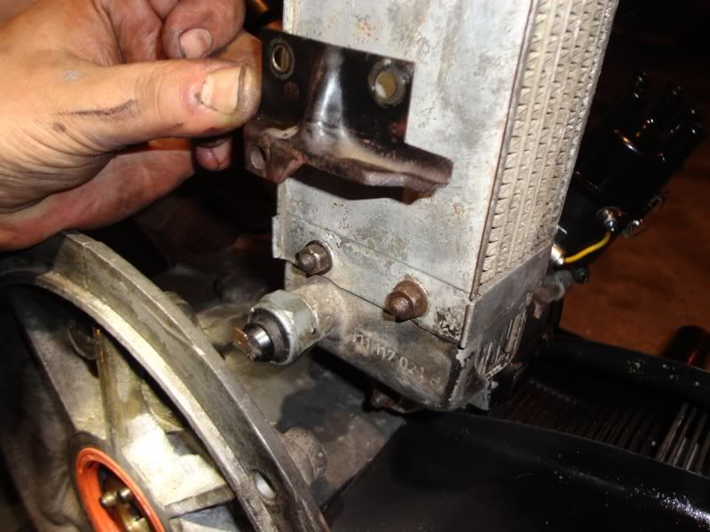

#9: Type 1 Hoover bit doesn't work with Type 3 oil cooler (this is a Type 3 case not tapped for OP sending unit near distributor). Luckily there's a guy on The Samba who makes/mods Hoover bits for just this sort of application.
See how ours won't clear the sending unit. Also, it's missing a part....the one that would wrap around the side. So I guess we only have half a Hoover bit.
#10: I've read horror stories about fitting after market exhausts but this one from Tri-Mil went on as easy as stock
#11: Not bad for a day's work
#12: Now we've got 2 engines and neither of them run just yet. Because of the Hoover bit and the missing engine bolt, we decided to leave the car out there for the week and get back to Brooklyn for other obligations today. I ordered the bit....now just have to find the bolt. Should be up and running by next weekend.
