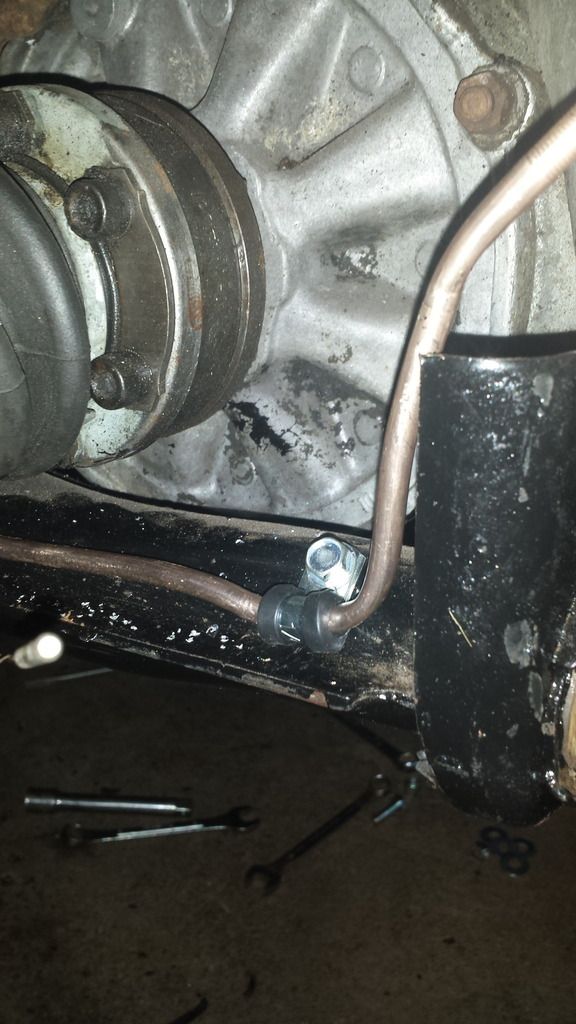

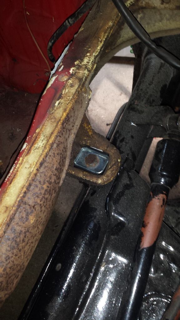

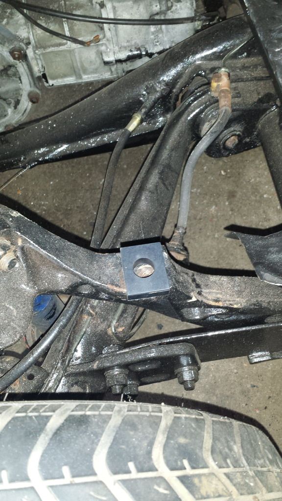

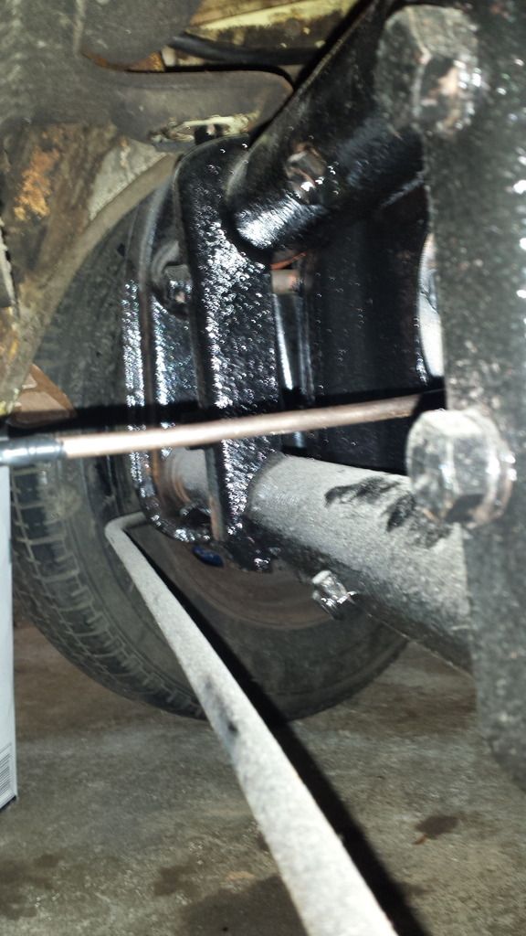

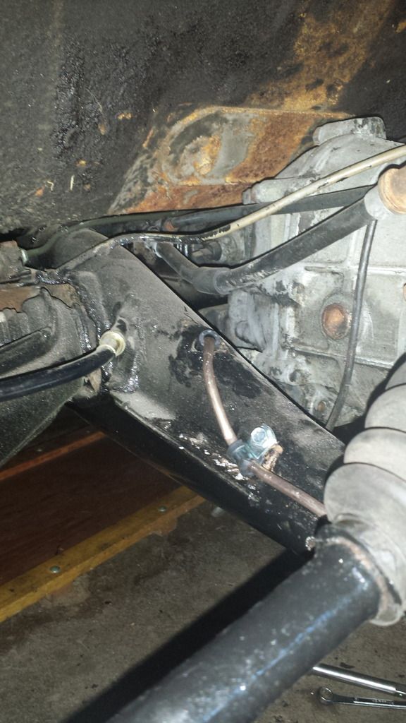

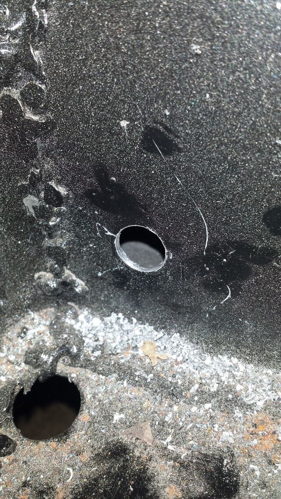

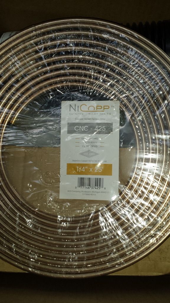

got back in the garage today replaced the fuel line Image with nicopp alloy back to front Image made a hole in the tunnel Image
got the line thru the hole Image does anyone have a picture of how the fuel line ends at the back of the car Image

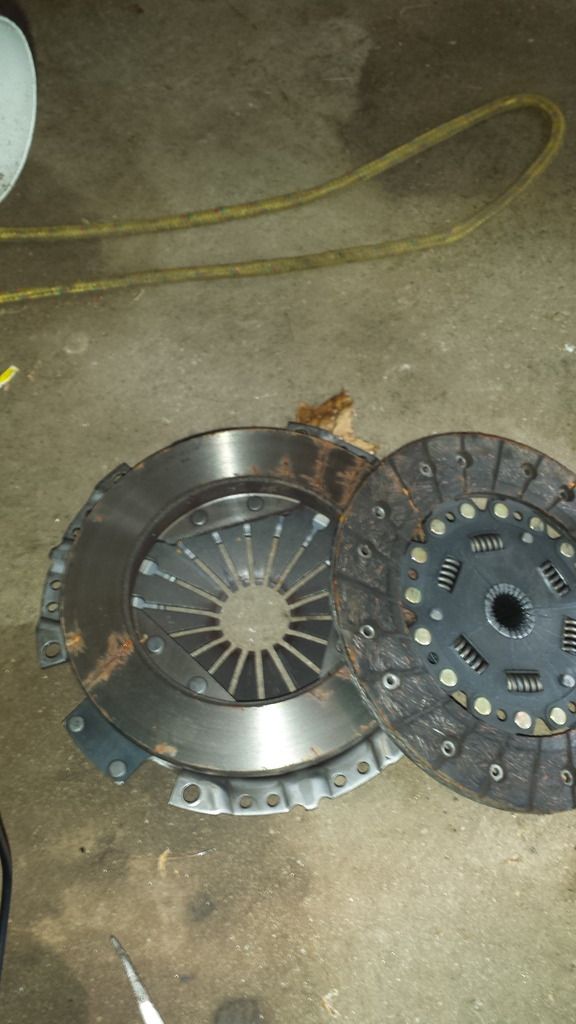

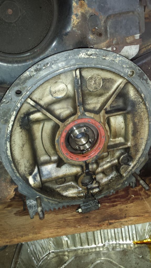

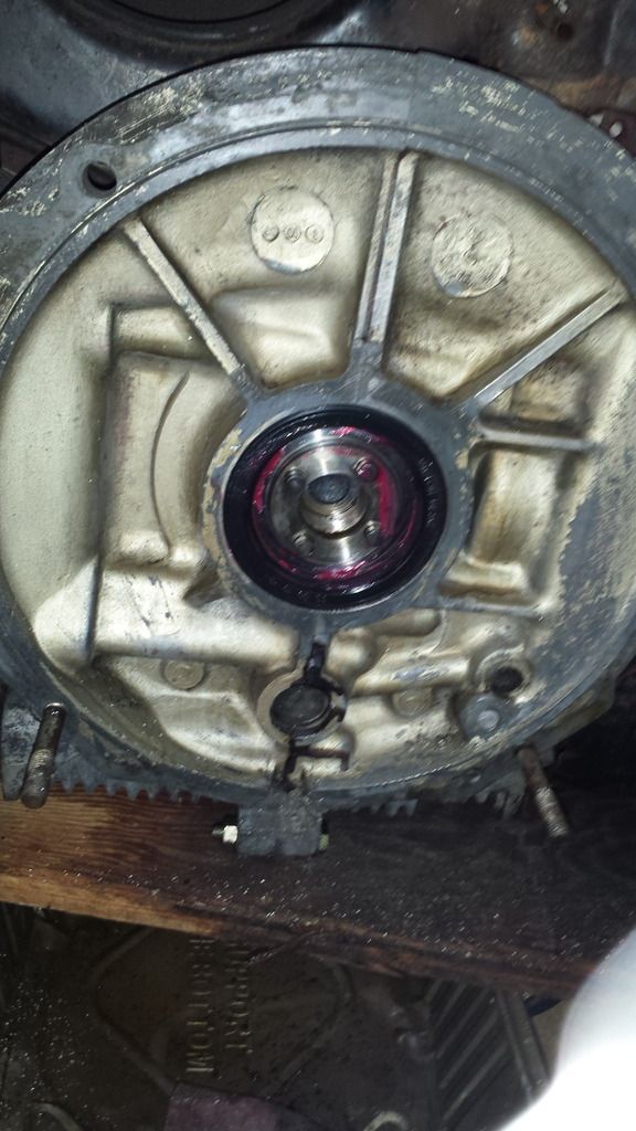

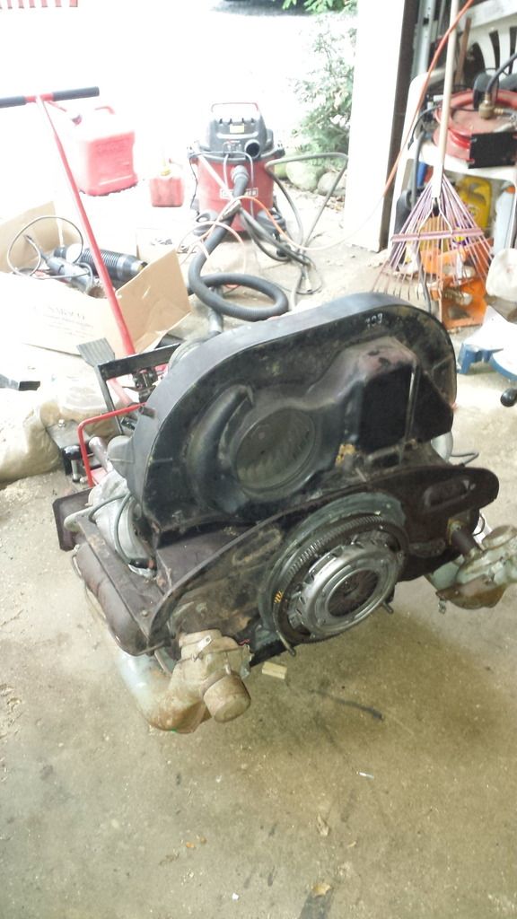

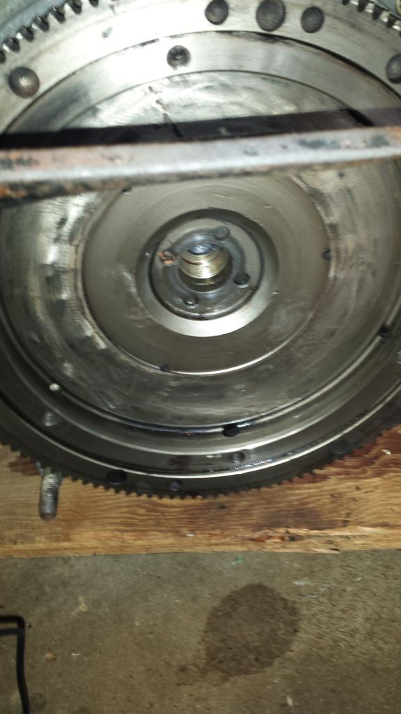

figured i would change the front engine seal while i have it out Image and clean the front of the engine Image the flywheel/clutch/pressure plate look good so i scuffed them up and reinstalled them Image Image

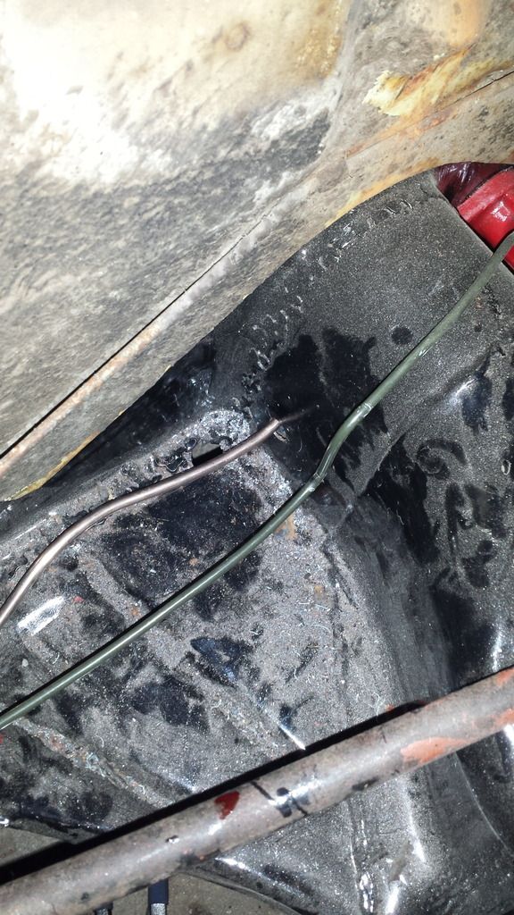

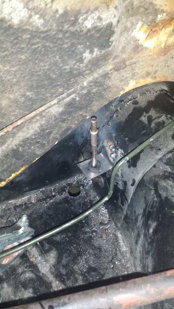

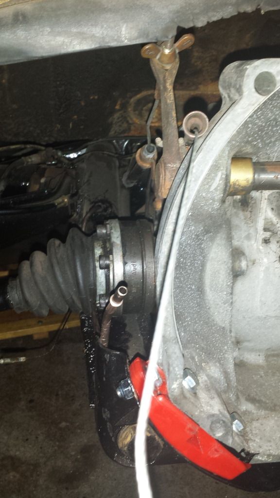

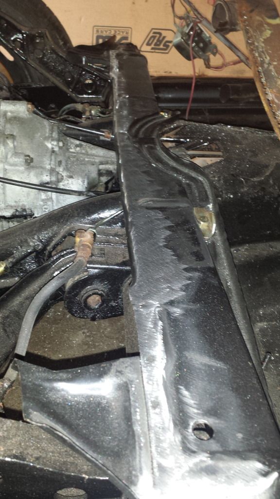

got the fuel line thru the tunnel done today Image Image Image Image
Posts: 1939
Great job on that. I know that wasnt fun.
some new curse words and plan D got it done

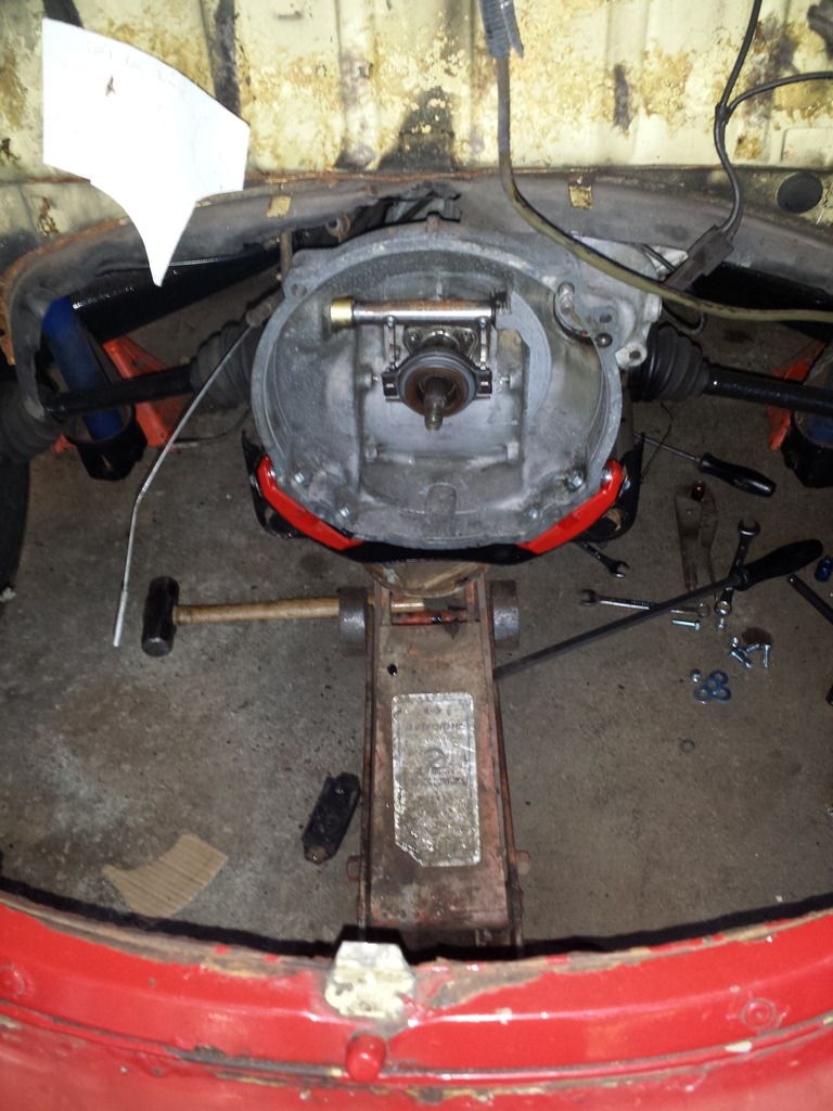

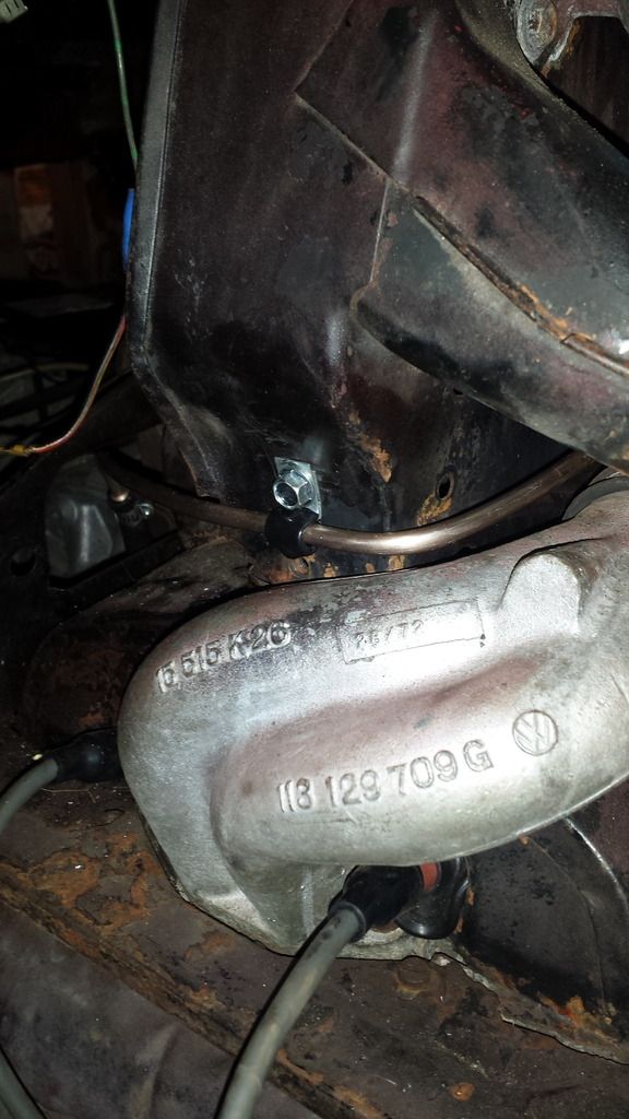

got the engine in today and new fuel line on engine side Image Image

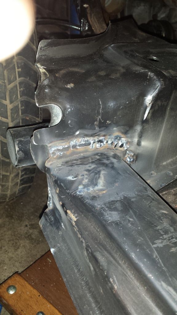

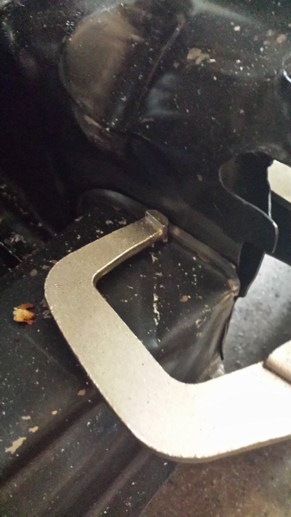

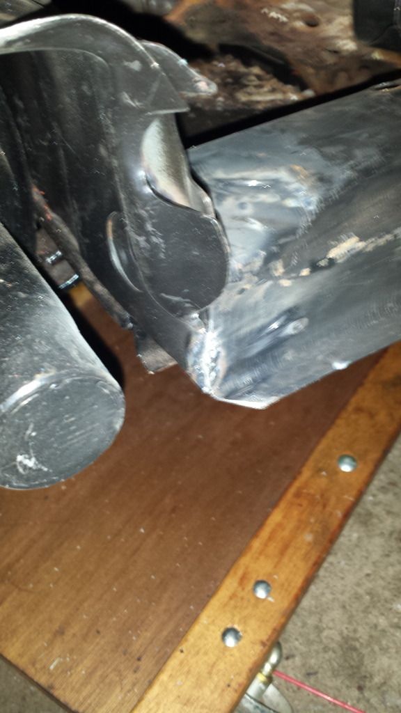

Good day in the garage today i got the heater channels welded to what ever these are Image Image not my best work but moving foward Image sanded the top to spot weld the pakage tray in Image new rubbers front and bImageack

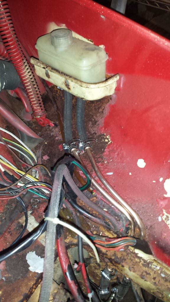

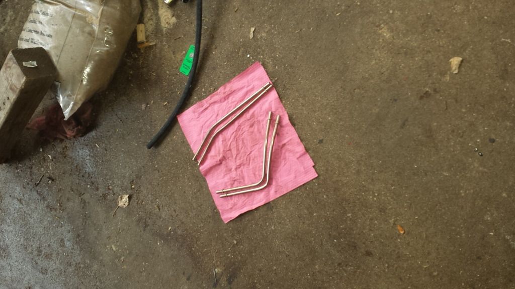

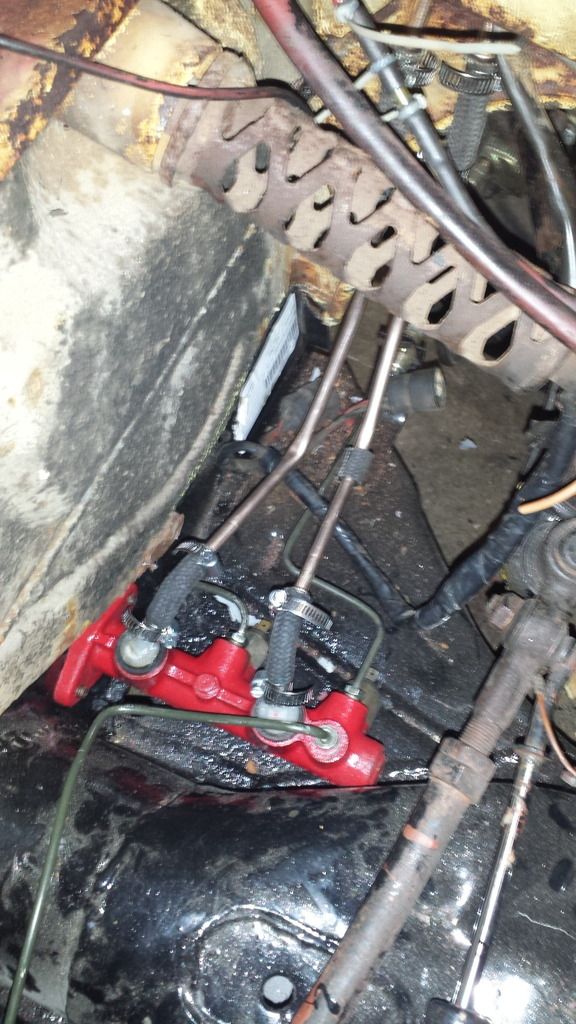

Image newbrake lines from the resevoir to the master cylinder Image Image Image got front brakes bleed but no luck with the rears i have a vacuum bleeder at work ill try that tomorrow

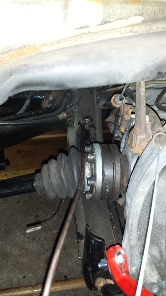

and a newsteering coupler Image
