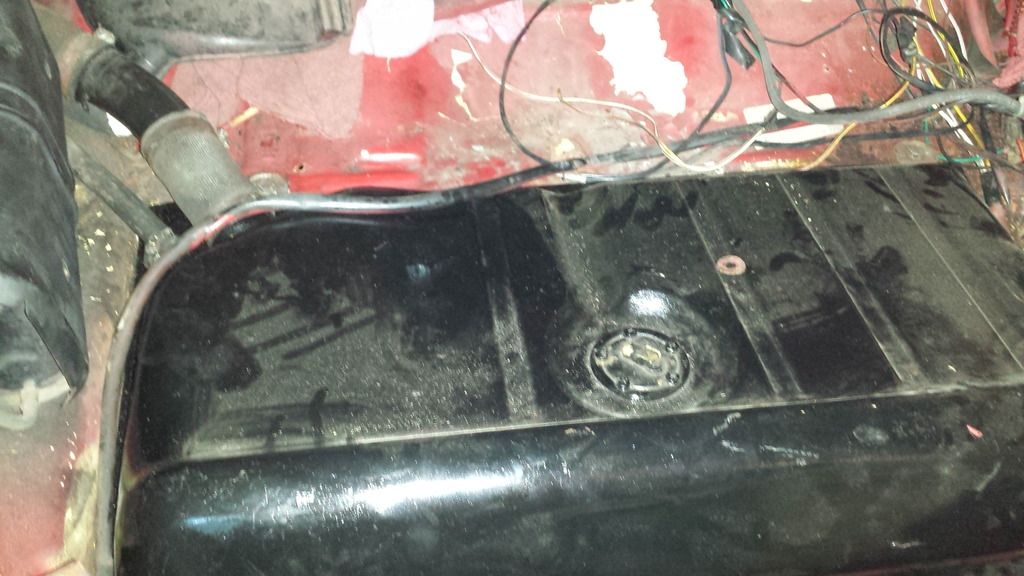

got the brakes bleed today using vacuum bleedertook 10 minutes. got the engine wired and runnining, it wont idle though so i think i need to open up the carb must be some Gak in the idle jet.got the gas Imagetank in and welded the pakage tray to those things Image

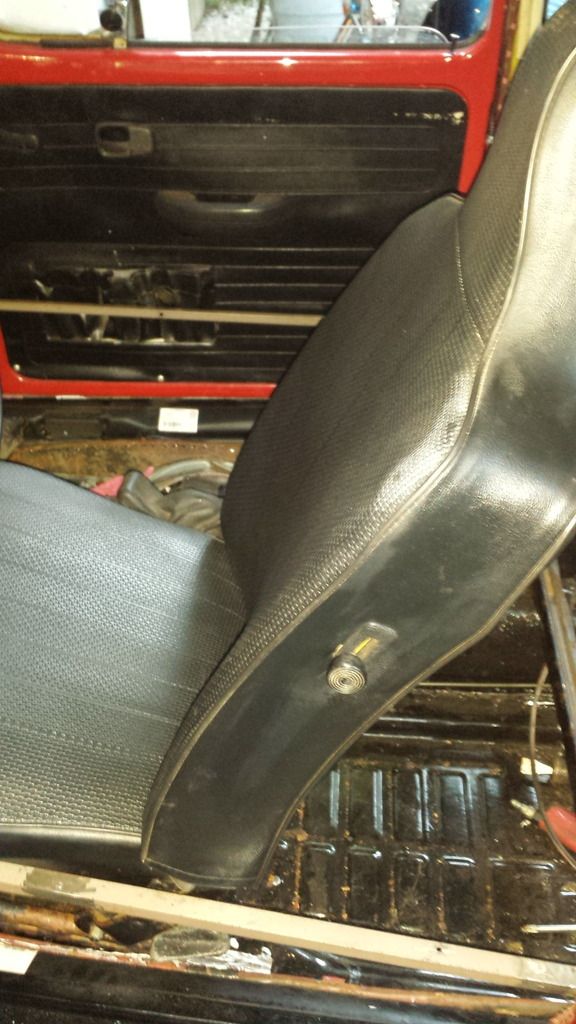

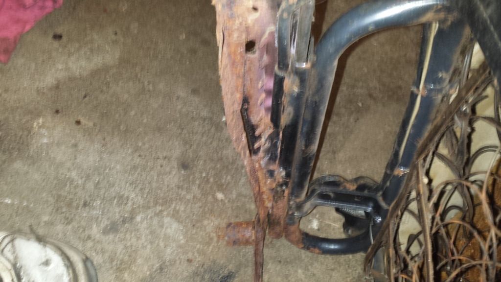

pulled the seat from the loft seems they both have the levers on the right side of the seat,but the tracks welded to the floor both have the teeth on the right track Image so i got the rusted mess off of the seat Image put the slides on Image

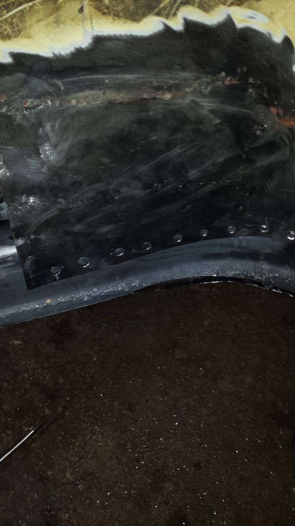

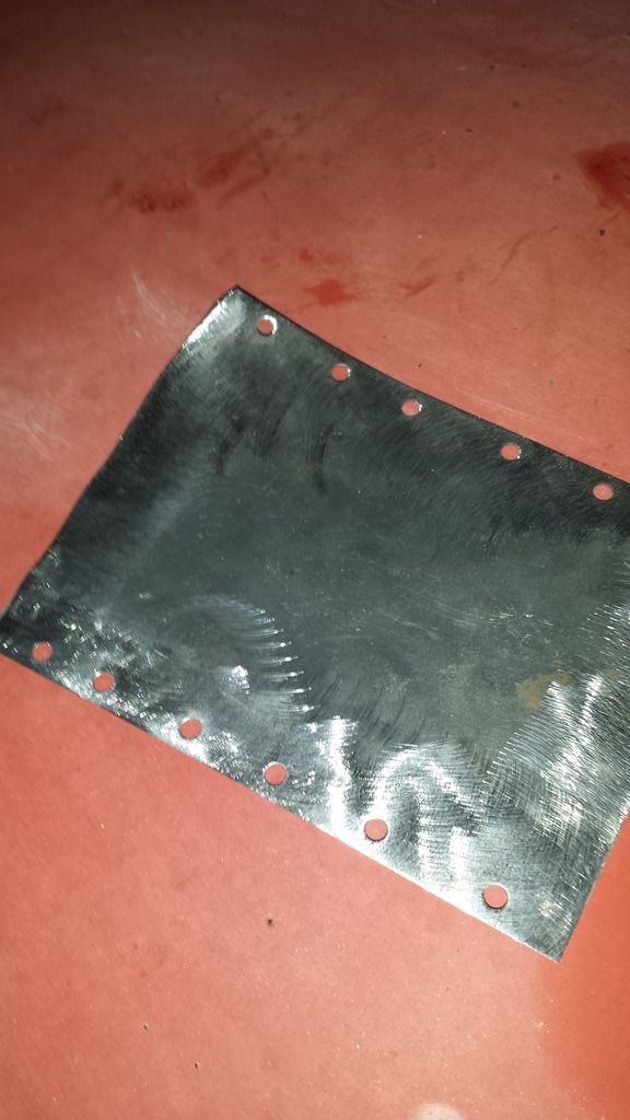

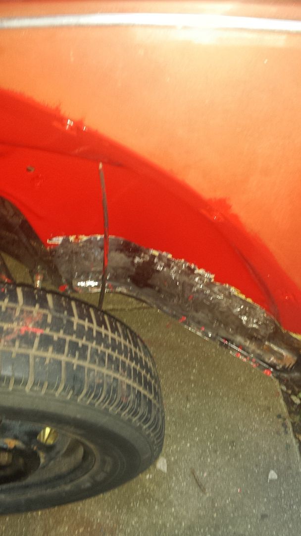

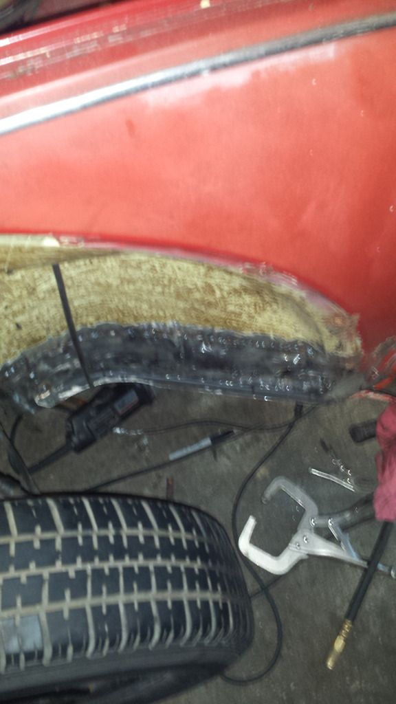

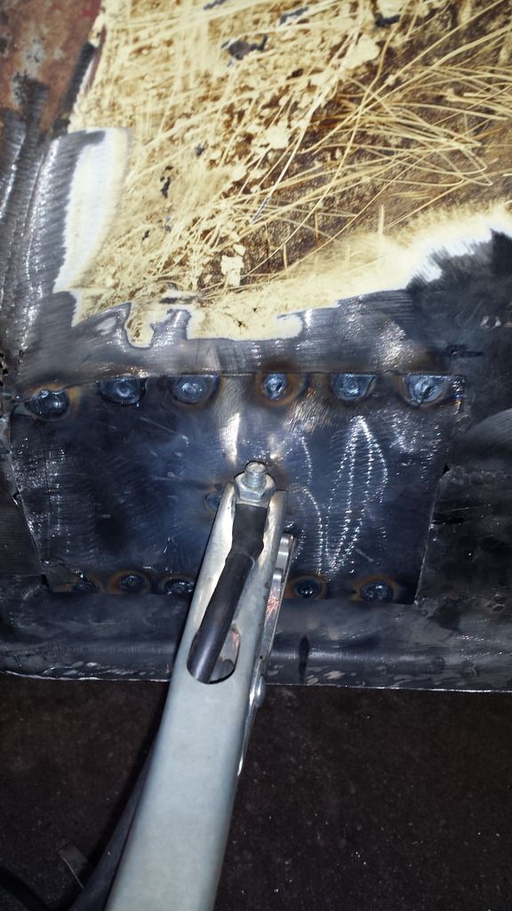

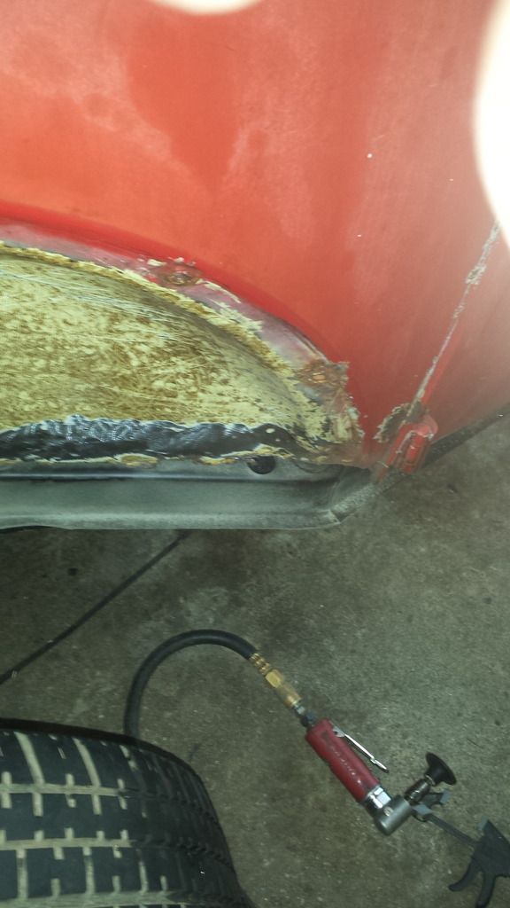

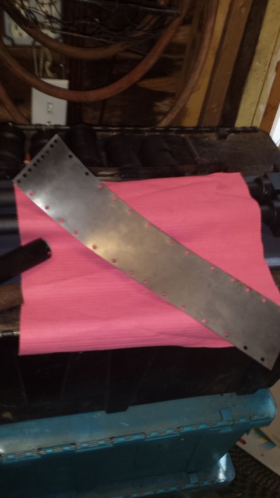

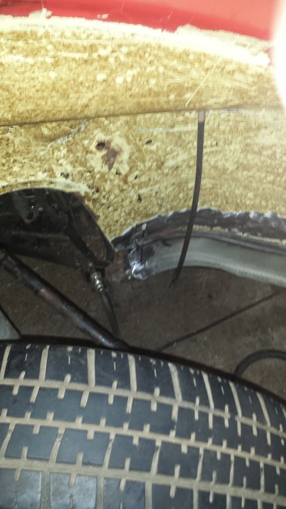

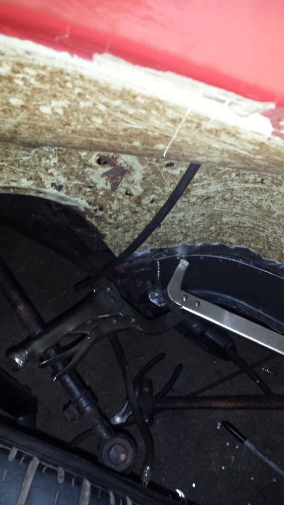

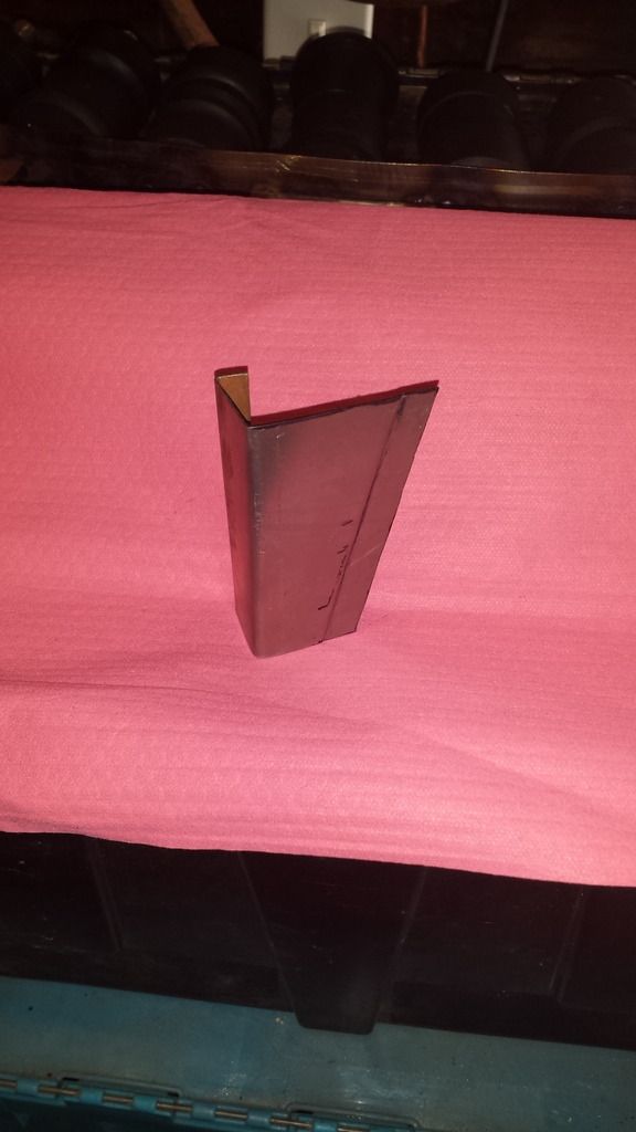

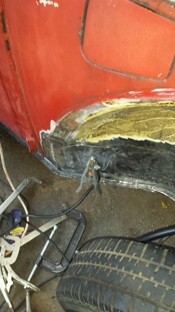

got in the garage today mad hot but i got some work done. made this for the L/F inner fender Image welded in patch panel Image Image after cutting out rust Image going with spot welds then weld the edges
not going topay attention to the A pillar at this time,i have replacements for the future Image Image

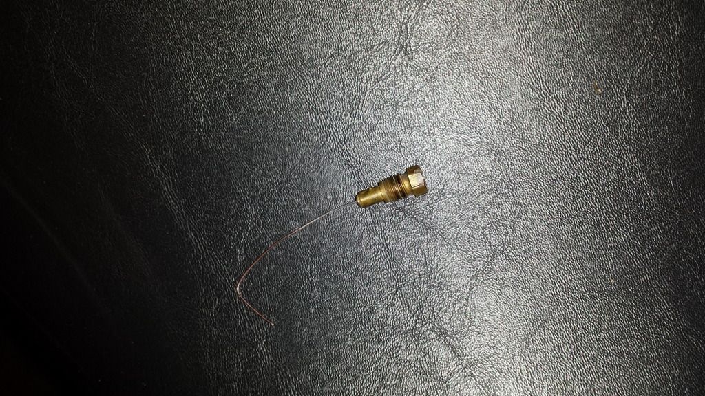

i have a question if anyone knows. the car wont idle it did idle run when i removed it i see there is an idle air adjustment screw on the left side of the carb does anyone know what the starting point for this would be like 2 turns out or more mine was at 6 turns out i put it to 2 but it still wont idle think i might have a air leak at the intake? also my carb has 2 screws on the left a small one which i think is the idle air screw and a large one that i have no idea what it does
What carb are you running? The 34PICT3 has a solenoid on the left side that needs power or it won't idle.
ill check that thanks

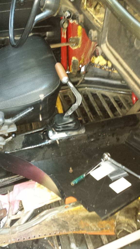

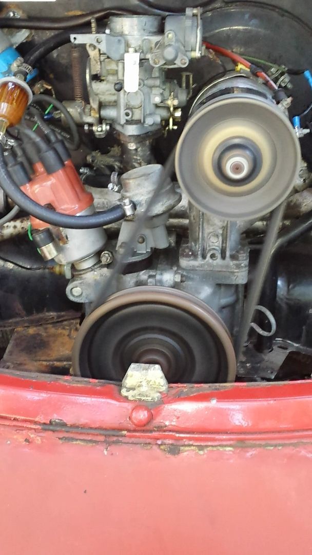

i checked that solenoid its working properly, even took my new endoscope for smart phone and looked inside to see all was clear. i found a video on you tube by VW Darren that said to check the idle jet by the choke adjuster and sure enough it was plugged Image so now shes idling on her own Image installed a new air filter Image and a new shifter Image
i adjusted the carb by ear and tommorow ill bring home my tach and do it correctly by rpm

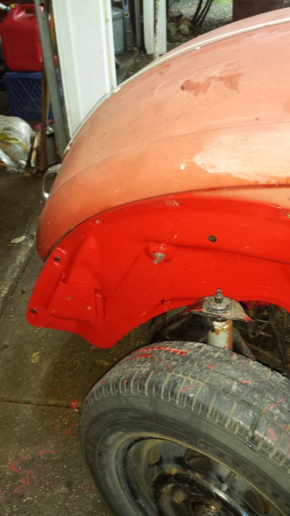

so figured why not paint the inner fenders with some rustolyem Image and maybe get the front fenders backon tomorrow Image

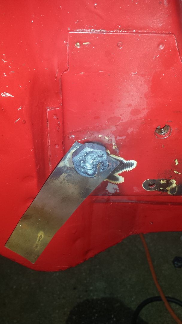

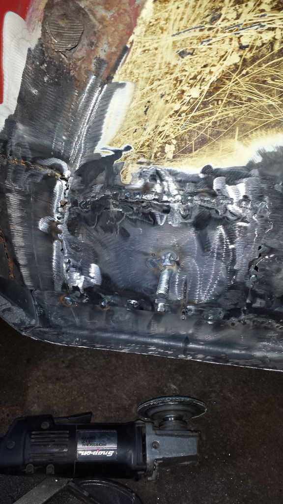

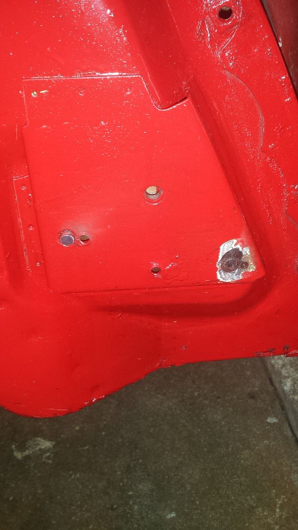

got some time today got 2 broken bumper bolts out Image i tried to weld a big nut to the broken bolt but broken bolt 2 gene 0 Image so i went old school and drilled and tapped them out

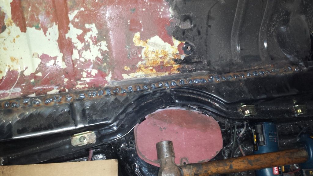

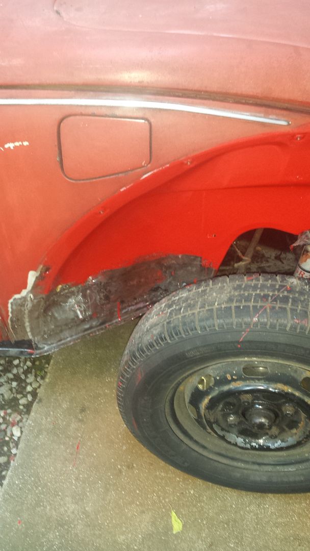

pretty much finished welding the front patch panels in Image Image and put another coat of rustolium on the inner fenders Image
