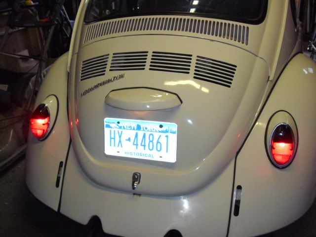

Spent today replacing all the fuses. The PO had 16 amp fuses in 8 amp slots so I replaced all the fuses with the correct amps. Got both rear tail lights back working with both of them burning both filaments (that's for you GA!!) and now getting started on the front headlights. The one that works is very corroded on the connection so now I am going to trouble shoot why the left one is not working. Need this going to get to a DVG meeting!!

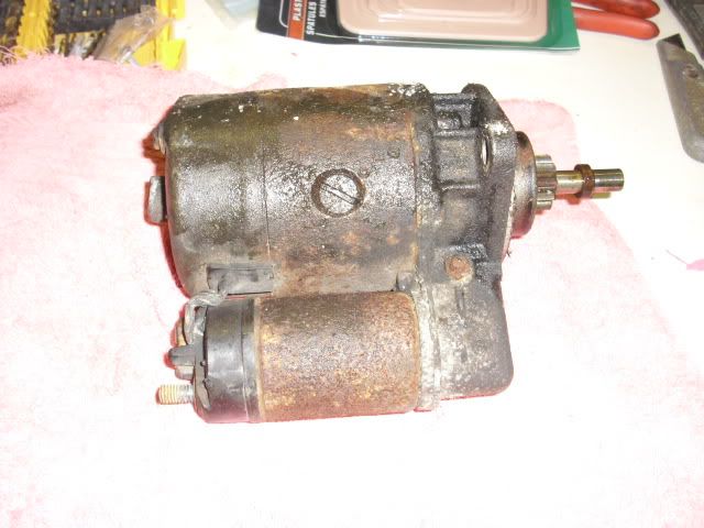

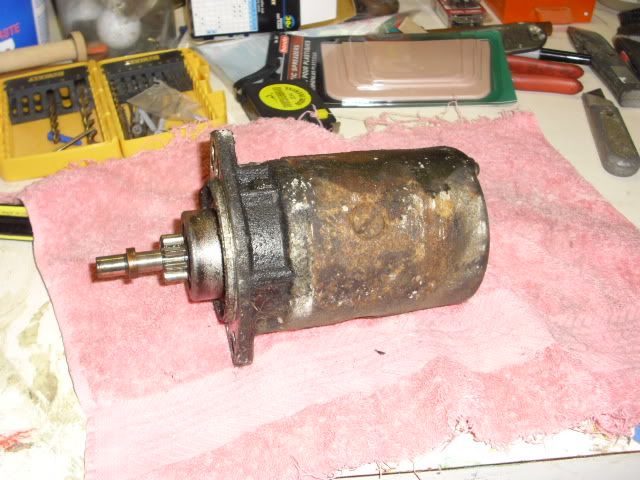

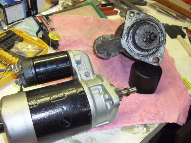

Since I wasn't doing the Polar Bear race today I opted to take a plunge of a different kind and got myself ready to remove the starter. Had all the right tools ready, disconnected the connections to the battery and jacked up the right side of the car. Put the jack stand in place and set up good lighting (bought one of those halogen works lights). Took off the connection to the soleniod and loosened the nut on the D bolt. Got the lower connection on the starter off and had my Meg hold the nut on the D bolt while I worked it back and got it done. Will try to get the new one in tomorrow, but needed to get off the cold concrete for today.
This is what greeted me when got it out from under.
Out with the old
In with the new
Any suggestions or words of advice before I try the return trip?
Out with the old
In with the new
- Posts: 3216
Wow...
No tricks other than getting the nut stated on the D bolt.

Yes.its official, I have successfully removed and replaced the starter start to finish. I put the new one in today, got all the bolts tightened (Thanks GR for the duct tape suggestion, it did the trick, got the D bolt on the first tickle) and on the first crank it turned right over. SWEET!! Took it for a spin around the neighborhood to give the battery some juice but didn't venture to far since it was missing a headlight and did not want NCPD to have a field day issuing tickets.

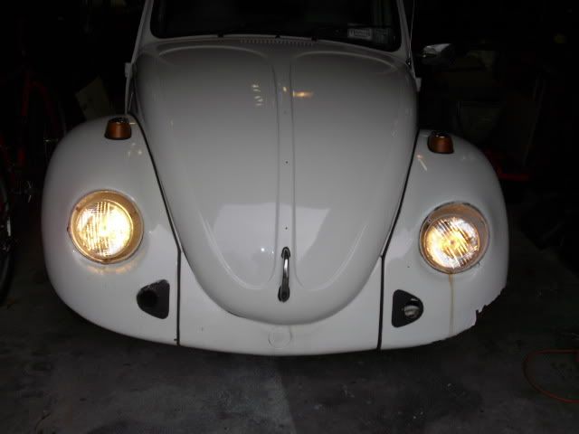

Went I got back I put the newly purchased halogen headlights in place to be sure the connections are good. They're working. Brought the mounting brackets inside to work on getting them cleaned up a bit and then I'll put the headlamps in place.
My stars are brighly shining...
Rear light are in sync..
As GR will atest, the wonder is purrring again!!

Your headlights sure are Perky.
Got to keep them in the family!!Glenn wrote:Your headlights sure are Perky.
- Posts: 1426
Aud, Its tough to tell from the pics, but it looks like they might be in on an angle. I believe the focusing of the sealed beams is dependant on them being in 'upright' check the pattern on the front of the lense, or on the back of the bulb there would be a nipple (hehe) that Ive always understood meant 'up' you might tell easier, (that is if they are in on an angle) as the light may point off in a sideways direction. The adjuster buckets can help too...

Mike, they're just laying there. She took the retaining rings inside to clean them up.
AoT wrote:Brought the mounting brackets inside to work on getting them cleaned up a bit and then I'll put the headlamps in place.
