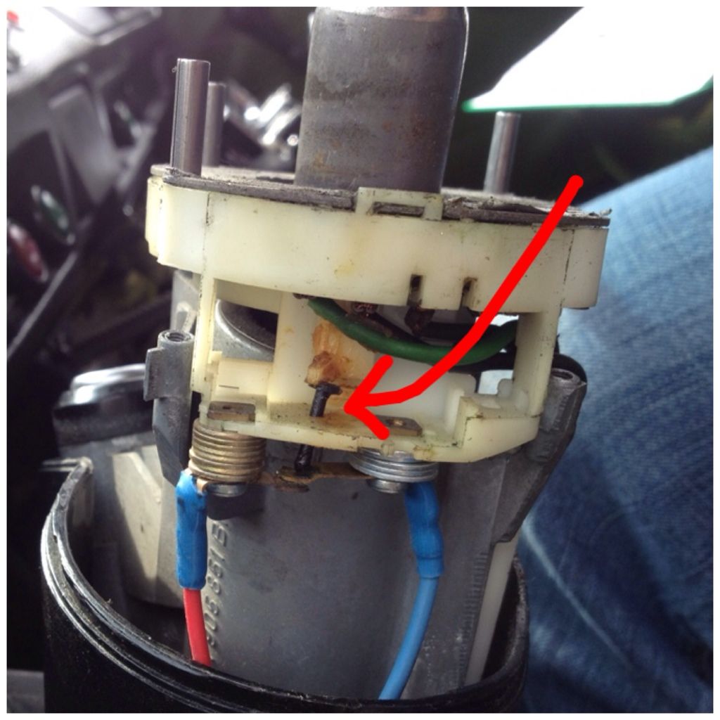

Sorted through my washer switch's "sticking" issues. Recently, had to rewire from the switch to the pump, and found that occasionally the switch would get stuck leaving the new pump running.
Took it apart today, and found that in addition to the "lever" that closes the pump circuit sticking, that the springs which should be in the lever were missing.
I removed the whole switch, and did the "electric conversion" from scratch. Kinda had to reengineer it a bit, as the switch wasnt intended to hande electric washers, and the PO's original mod had worn to the point of failure.
I also added a spring here:
(Sorry, no after pics)
There's also a couple springs, one which holds pressure on the slider that makes contact across the inside of the switches, and two that hold pressure "upward" to help return the lever to the "off" position.
I had difficulty holding the four springs in place while assembling the switch. I used a TINY bit of hot glue to seat the base of each spring just so I could assemble it all.
Now, it's all working great. Wipers, both speeds, with the off position, and washer which turns on when it's called for, and returns to off when it should.

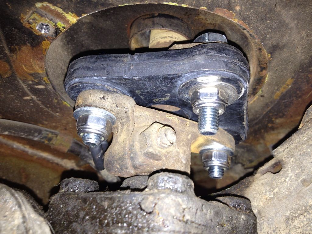

Great work mike. Did you say your steering coupler was cracked?
- Posts: 1426
Yeah, it's been chipped. One of the corners cracked, but the metal pressing was holding it in place. Well, that and the thre other bolts. Thing is, the coupler is there to isolate the steering column from the body/steering box. So, two bolts go through the steering column, to the coupler. Then, 90* off that, there are two bolts that go from the coupler to the steering box.
I replaced the grounding wire for the horn, and used all new hardware.
You'll see in the pic, that in missing a screw for the access plate cover.
One of the screws was stripped/seized. Looked like someone from the bus's previous life had tried to get here before. I drilled out the hole, and will put a new bolt through the floor where there used to be a captive nut. I'll probably drill out the other side too, just so they match.

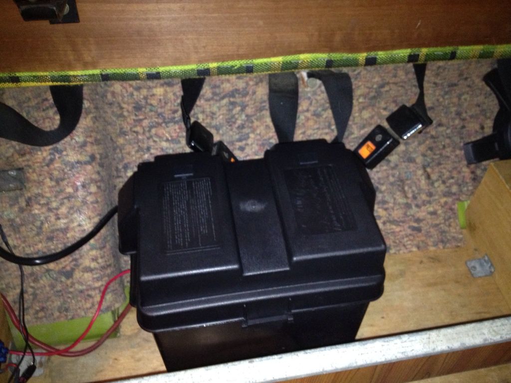

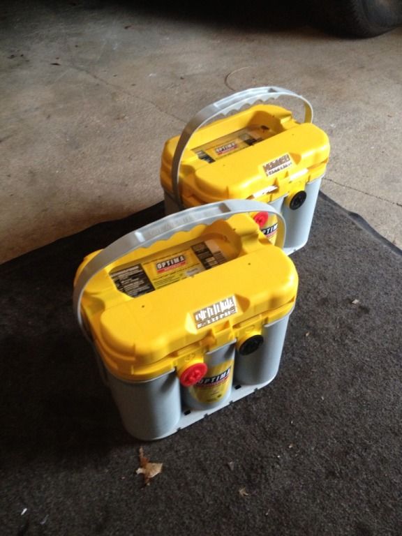

Finally broke down and bought new batteries. It wasn't easy to part with that much coin, for something that is never seen, but always used.
Bought two Optima Yellow Tops.

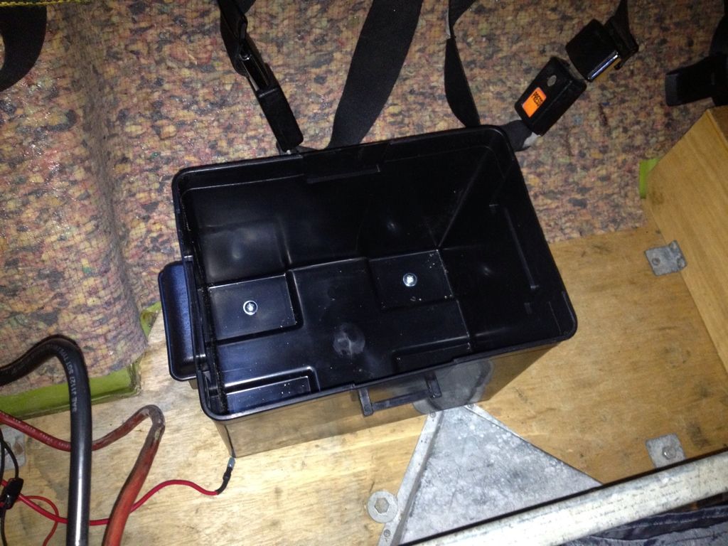

Also, had to replace the ground strap under the rear bench for the leisure battery. Not thrilled with the condition of the connectors on the starting battery but I'll deal with that after Englishtown this weekend.
My old battery was held down only with a bungee, and had the lid of a battery box over the top to protect it.
I replaced that with a new battery box. I fastened the box to the wood floor of the under-bench compartment, put the battery in, and made the connections.

You have sidepost cables on the bus ?
- Posts: 1426
No, certain series Optimas only come in a universal configuration. I was told to pick a battery that closest matched the physical size, and CCA that I needed. Of the Optima Yellows, this was the best physical fit. But it only comes in dual post set up. It has top and side posts. I kept the seals on the side posts, and used the top posts.
They also come with base adapters to the factory battery clamp still worked.
Having dual posts is always handy, I buy those whenever I can.
