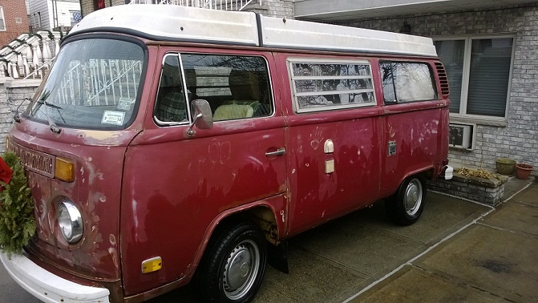

Dan, did i see you on the BQE in queens about a month ago in the snow? I passed you on the right, honked and waved in this:
anyway, cool beetle! What part of brooklyn are you in? I spend much of my time north (WB, GP) I used to have a music studio there.

I used to live on Java and Mcguinness. small world.
Bus work....not much to get running as I drove it home from Louisville after I bought it. I broke down twice on the way tho. The 2nd day of the trip I stupidly tried to do about 500 miles over mountains and shot out a plug in PA. It could have been loose or I could have stressed the engine. After that the breather hose got cracked/disconnected on the jersey T pike. Obv an easy fix but it I didnt realize it til after a tow.
When i finally got home, I did a tune up a bunch of odds and ends and it was ok until November when I had battery issues. That turned out to be the voltage regulator. Easy fix again. Its in a good place right now though I think there is a compression leak somewhere. Runs fine and starts right up on the coldest of mornings. Been getting me to work on time every morning. Does ok in the snow. I have a box of parts to be installed in the spring:
