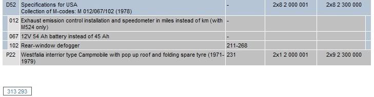

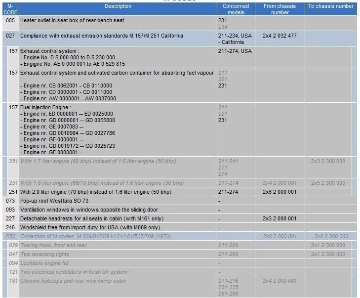

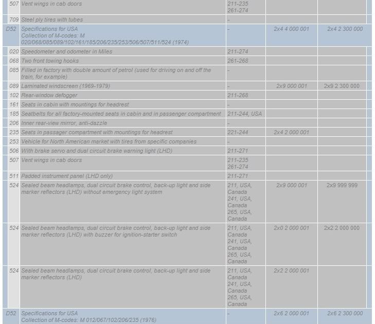

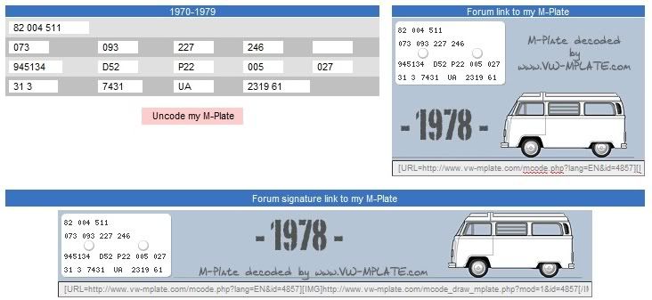

Managed to find the build plate on my bus today, entirely by accident. It wasnt anywhere that I thought it would have been, and wasnt near where everyone said it should have been. But definitely isnt in a spot someone would have taken the time to move it to, and appears to have been painted when the car was painted. I guess on the campers they didnt put it on the dogleg with the other badges?
In any case, I hobbled over to http://www.vw-mplate.com and decoded it, it was pretty cool to get a little glimpse back into my buses history. Now Im a bit inspired to call the previous owners, Brett and Martha McKillop in Colorado!
