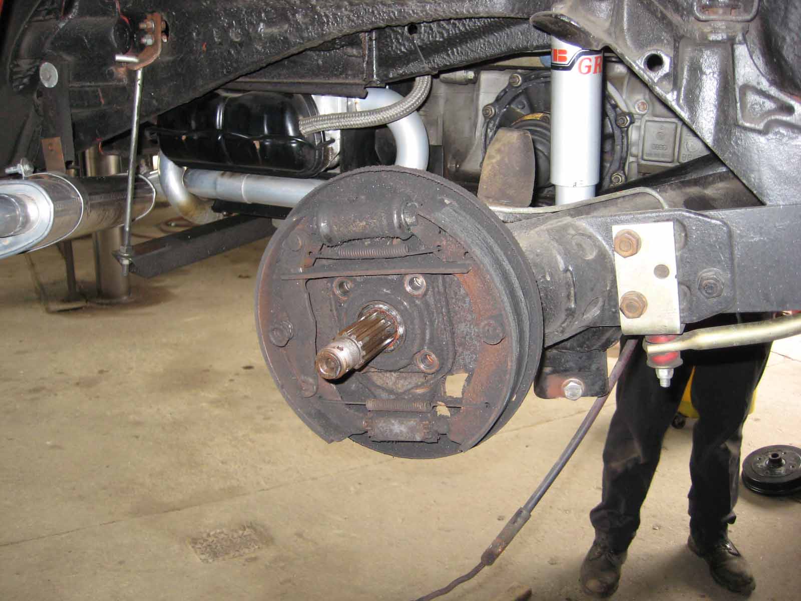

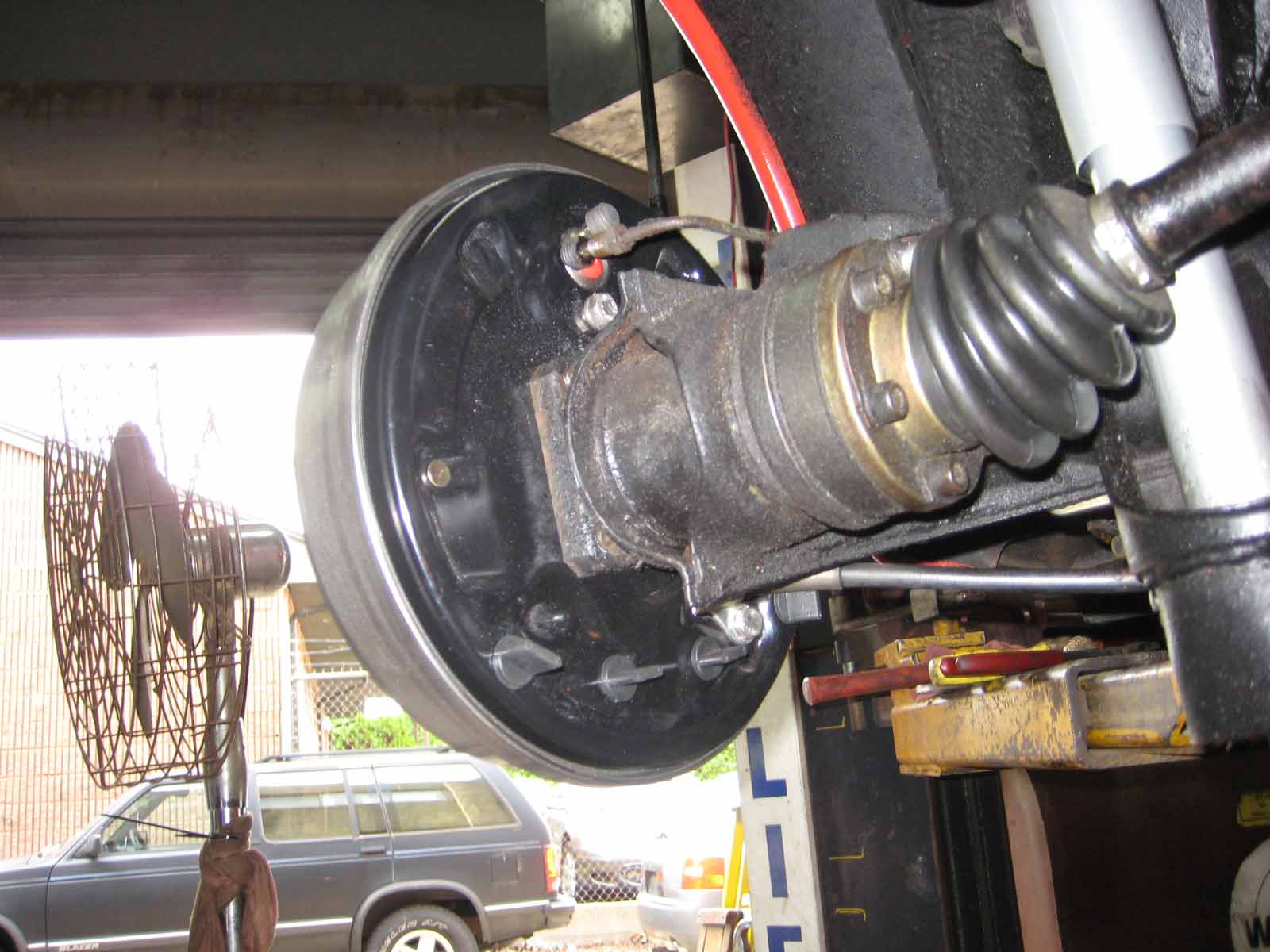

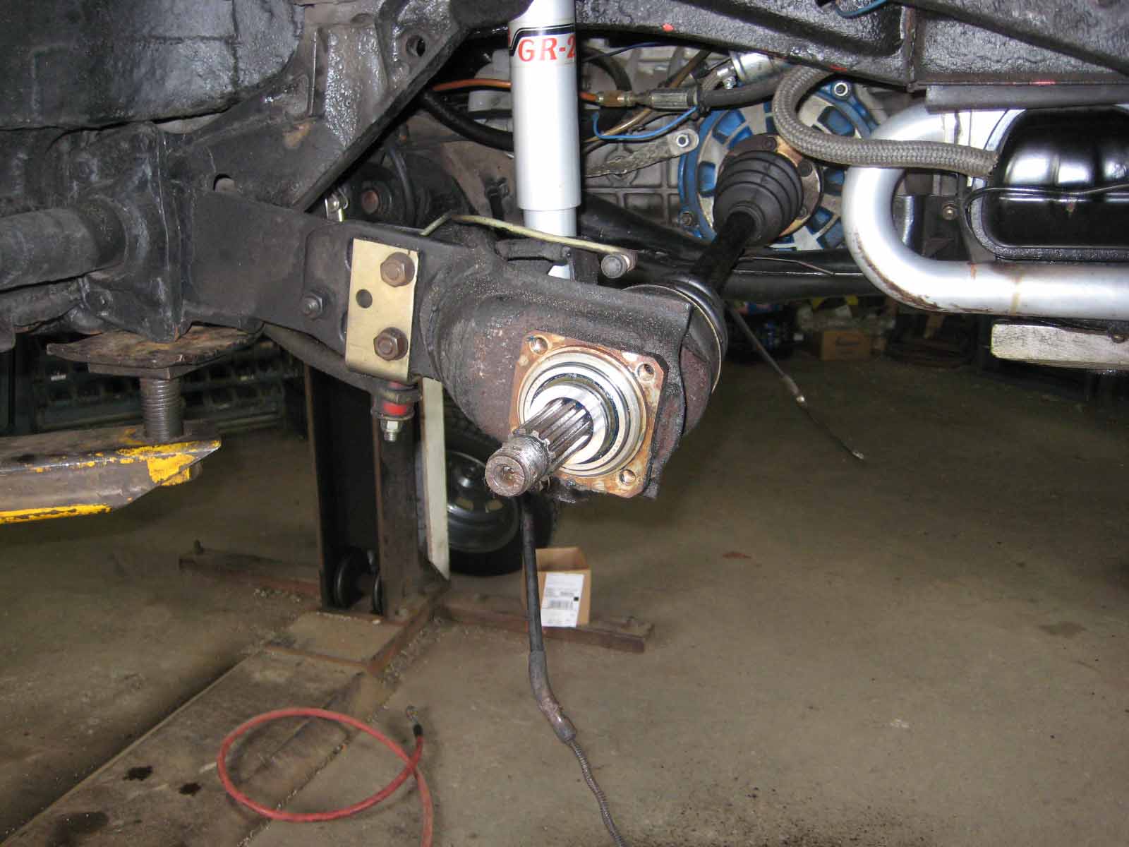

Time for rear brakes. I never did them when I rebuilt the car back in 1998 so the time has finally come. I replaced everything in the rear, backing plates, drums, shoes, wheel cylinders, hardware and hoses.

Nasty brakes.

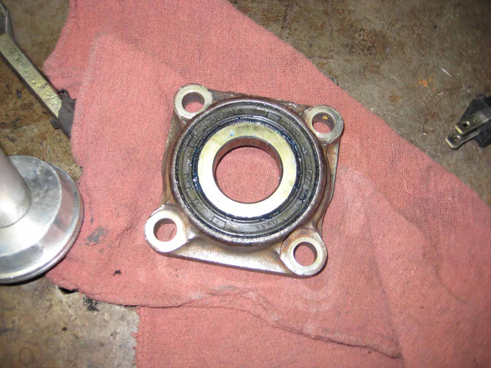

Repacked the stub axle bearings.

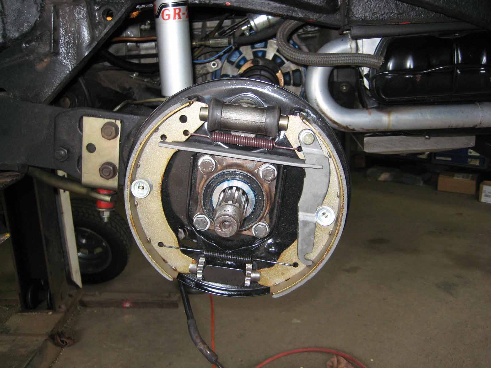

Nice... powder painted backing plates, new wheel cylinders and new hardware.

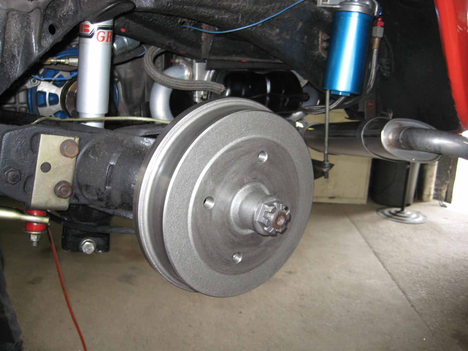

Ate drums
Ate drums

So I guess your good till about 1,000,000 miles now.
- Posts: 3205
Re: 74 Beetle
I doubt it, but 500,000 should not be a problem.Glenn A wrote:So I guess your good till about 1,000,000 miles now.
