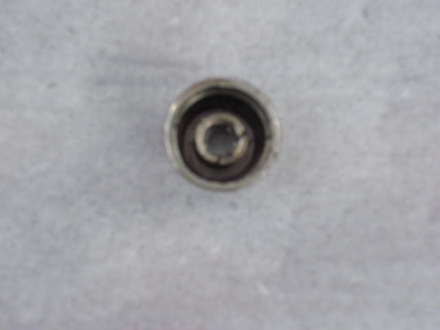

Want to make the push to get the fenders done. Spent some time trying to get the spray gun ready for round 2, but found out the nut to adjust the spray pattern was shot. The flange is cracked and rather than waste time I went back to what I know.

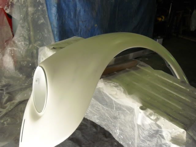

Got the paint from last weekend sanded down.
use white primer and gave it a coat and then saneded it smooth.

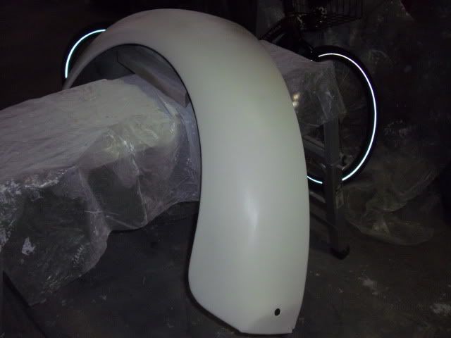

After two coats of primer went with the color I have been using. Lots of surface to cover on the front fenders. Was able to straddle the bench with some wood to elavate it to get the sides covered.
Need some more paint for the high spots and then a light sand and maybe some clear coat.
Was full day project "wating for the paint to dry" but it should make the wonder look sharp when done and installed.

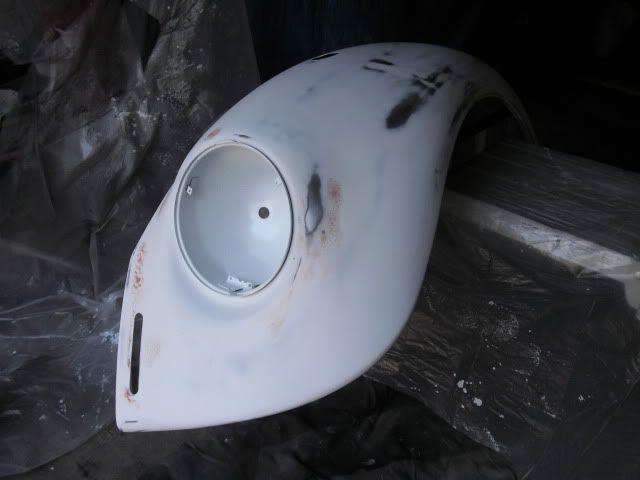

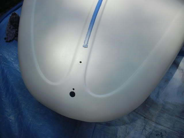

Coming down to the wire getting the fenders painted. Lots of lights coats and plenty of light sanding trying to keep a smooth finish. Love that feeling of running your hands down and feeling the smooth metal!!

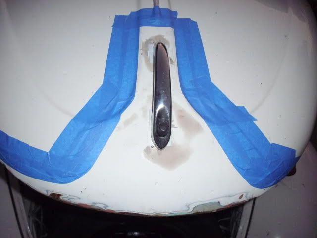

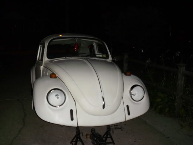

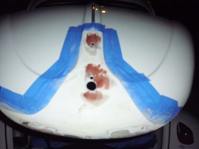

Anyway, realized that the wonder needs a nose job. When I had to cut the front lid handle off I never finished the body work. Now that it will be saddled next to the fenders, thought it was the best time to get it sanded and painted while the fenders are off.
Only got this done after dark so tomorrow will be painted.

GA would know more than me, but should you avoid the tape there, and try to blend/feather the new paint to the old? I think it will be less noticeable, and you definitely wont get that sharp tape line where old meets new.
It would be ok to protect the surounding area while sanding. But it should be removed before prime and paint.
Bingo!! You win the "will AoT do the right thing" award!! Since this area has an uneven surface put the tape down to give me some wiggle room on the sanding, but thanks for keeping me on task!!Glenn A wrote:It would be ok to protect the surounding area while sanding. But it should be removed before prime and paint.

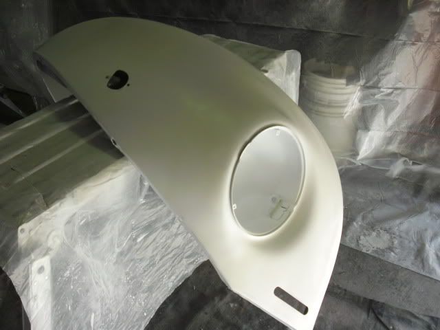

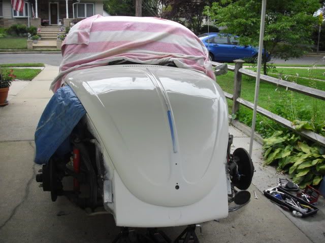

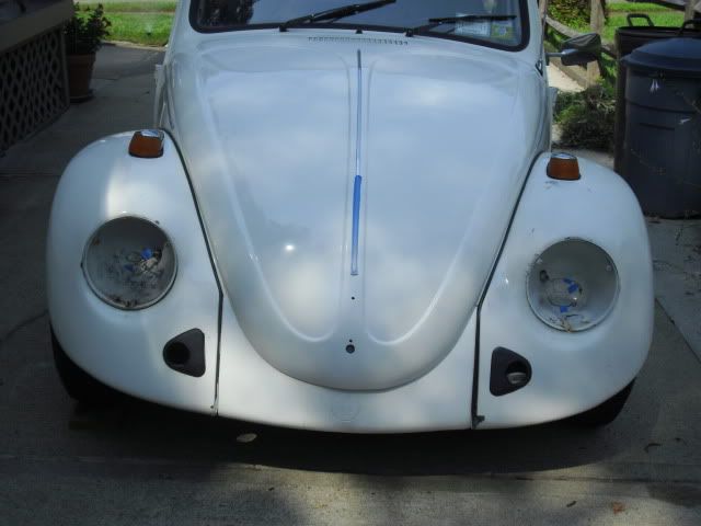

Well today was a big push day and had some success and some things that still need to be worked on.
Got the front hood painted up and the nose clip. Hardware is back on and looks better.

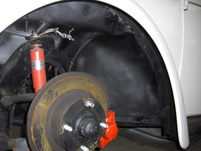

Finished getting the new fenders sanded, painted and top coated, plus the under coating.

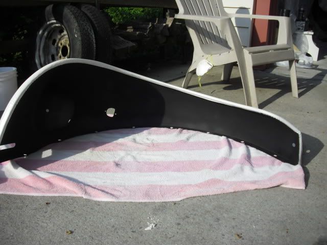

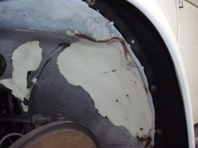

This was the DS wheel well after "whipping" with lacquer thinner.
Post under coating.
Post under coating.

Nice job Aot. The car looked great today.
Hearing that from you makes it worth it!!Glenn A wrote:Nice job Aot. The car looked great today.
I Know it needs more work on the finish but just getting the fenders on was the goal for the weekend!
I quietly pointed out you and your car to "new Bob" and mentioned all the work you have done to it!AoT wrote:Hearing that from you makes it worth it!!Glenn A wrote:Nice job Aot. The car looked great today.![]()
Seeing it in the lot with no headlight bulbs made my day! I haven't driven a car around with missing parts for a long time. I could just picture you getting pulled over and being like " What?" "little old Me!?" "What'd I do?"

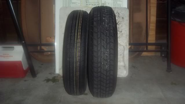

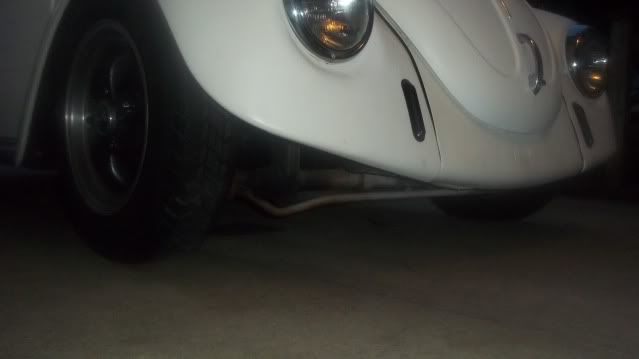

Got the wonder jacked up last night and did some tire rotation so I can get the 145's on. Keeping the tires that hold pressure the best. I stopped at the service station to have them put on the rims and they only got power back today so no go until Friday.
Wondering how much clearance I'll have with the lower profile tires since the sway bar is already low. I have to put the tire on a block of wood to get the jack under it.
Figure the new tires should bring it down maybe 2 inches.
