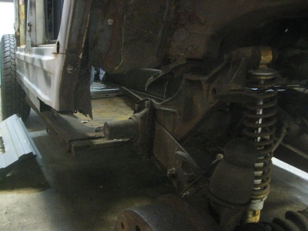

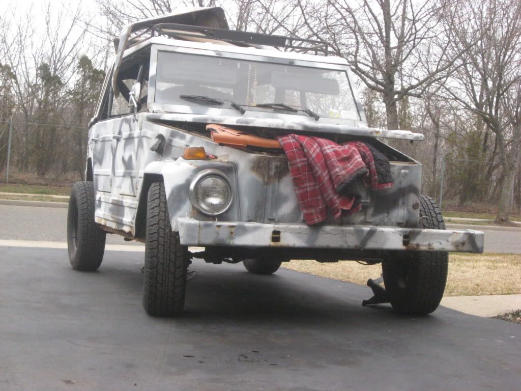

After all the musical cars, I unbolted the body from the pan. She has only been on there for about 5-6 years so its came over very easily.... all but one that started spinning. Sliced up the DS front and see what I had to deal with, l;luckily that was the loose nut. A 12 mm wrench fit perfect.
lifted up the body

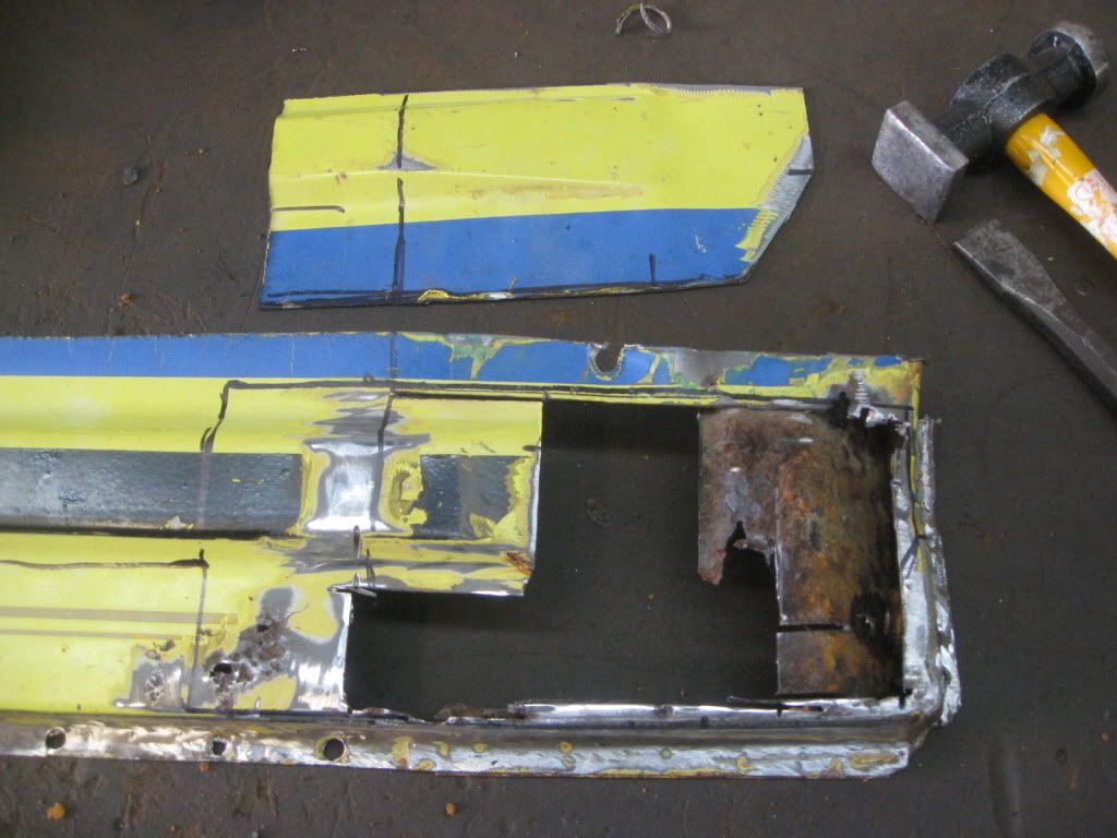

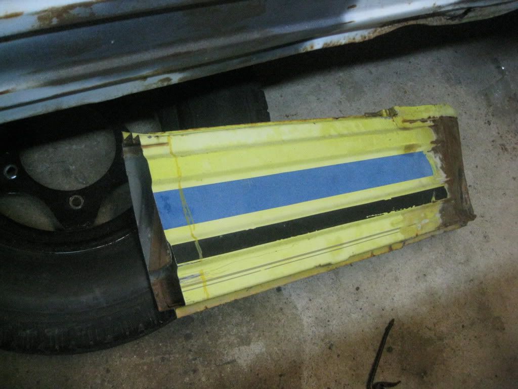

NOS mexican section awaits

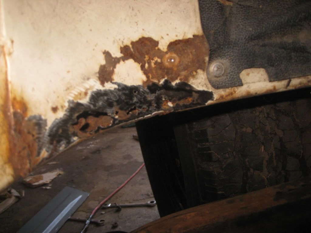

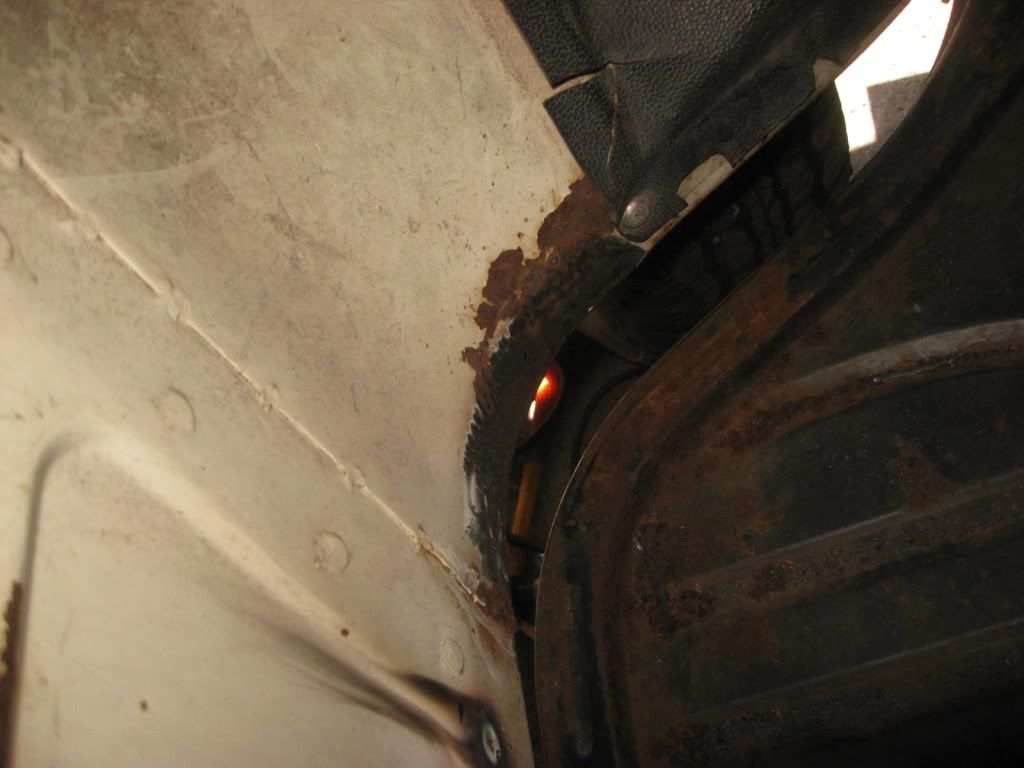

I cute the old panel off with cut off wheel, but just then the wifer got back home. I helped per with the grocerys and liam, and had a quick chat. I returned back to the garage..... smelt and saw smoke. I nearly $hit myself bc her car was now in the driveway, and this thing was up in the air. I quickly ripped out all the fenders and stuff inside the car and saw this. ( naturally took a picture first)

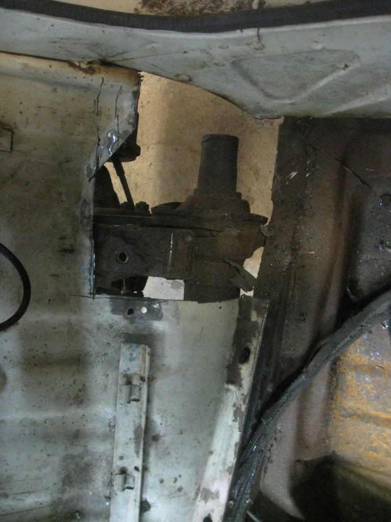

I guess the sparks form the cut off wheel ignited the horse hair from the the seat. Wow. I sometime play with the car for 30 minutes in the AM before work. Not anymore!
needless to car, tonite was ' clean out the interior' work

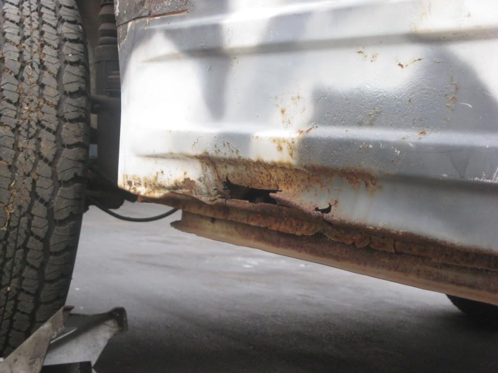

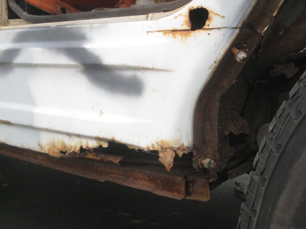

nice rot!

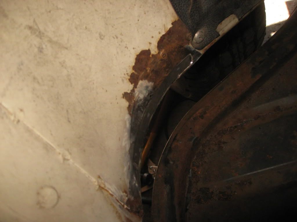

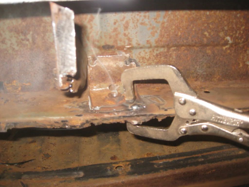

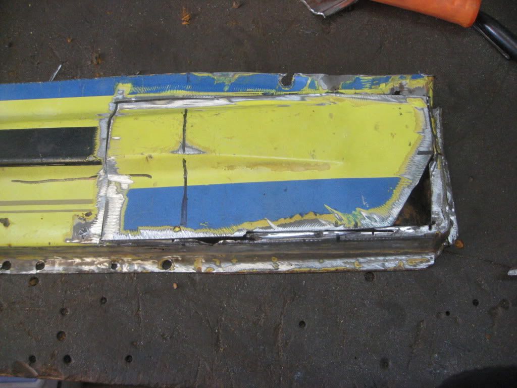

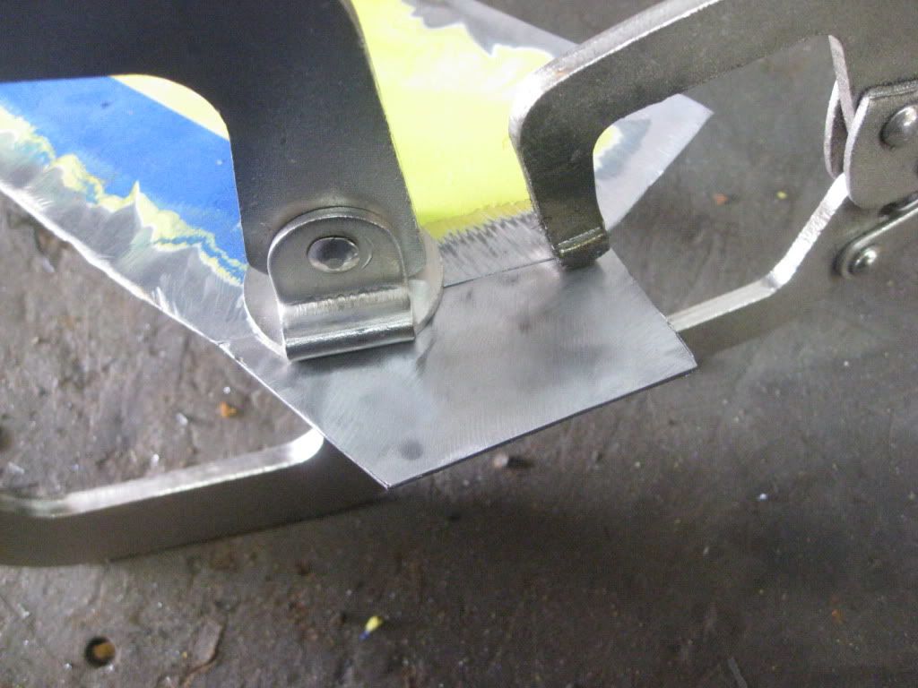

I lost one mount that connects the rocker to the pan, so first clean up the metal, then I yanked one out of a donor section. I ran a tap through it and welded it in.

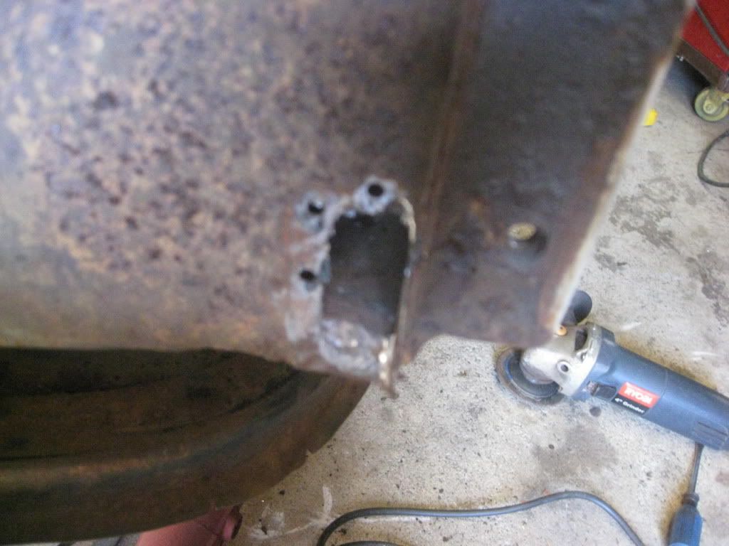

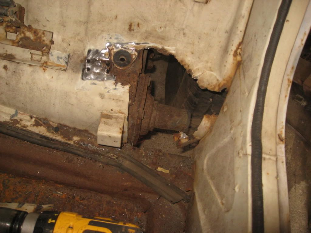

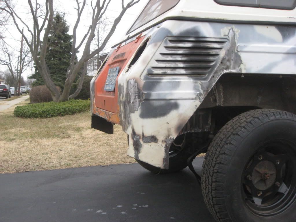

Addressed the hole behind the DS front tire .

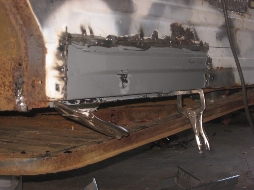

Since the rocker was open I was able to weld a plate from behind
then I welded another panel flush on top, then grinded her down.

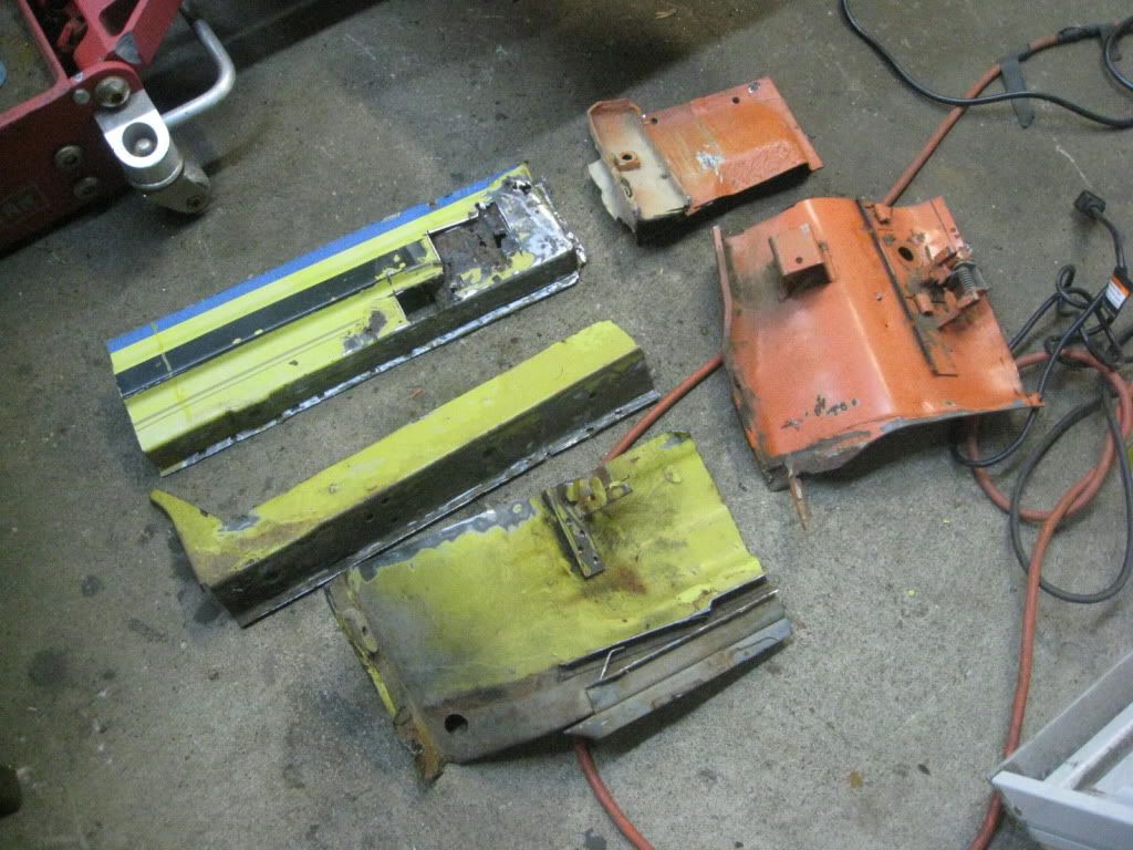

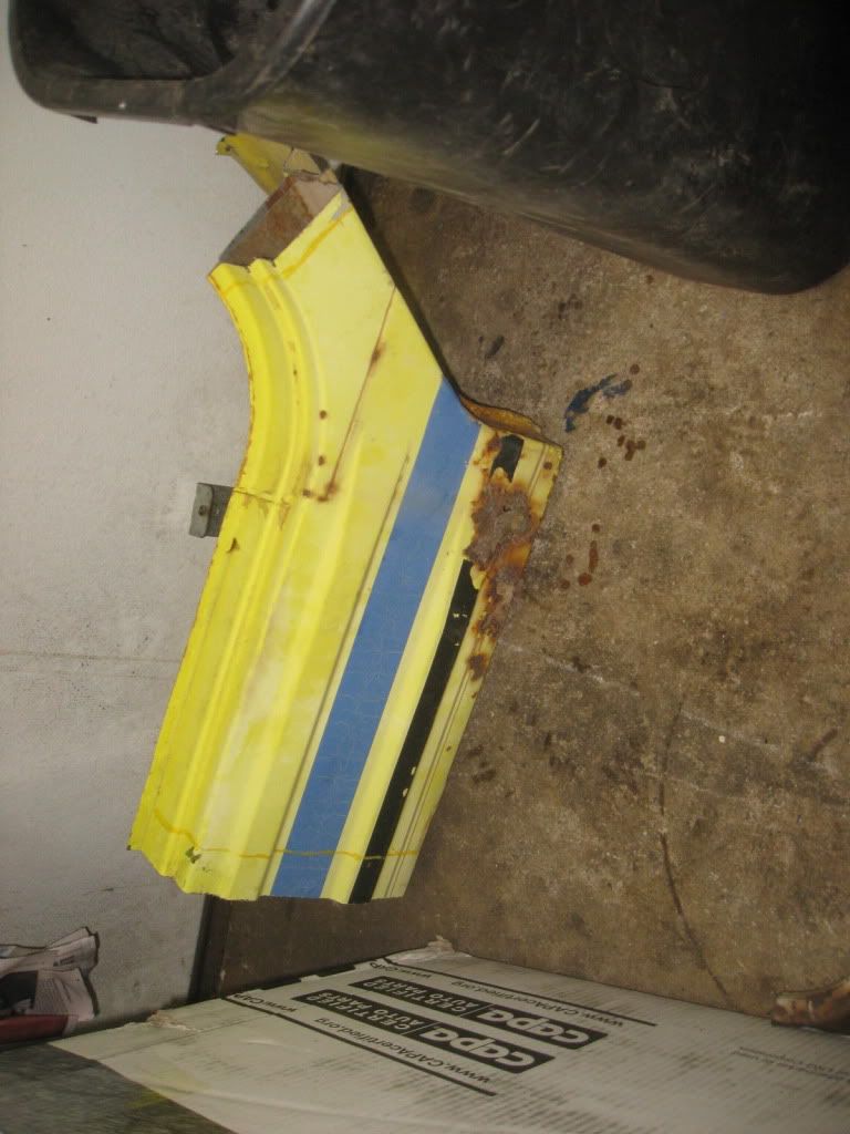

Its actually 5 sections of metal. so Its interested as figure out how I'll peice thins thing back together
this is the hurdle right now. Take apart the donor metal, repair it, then replace the old.
Its really 3 jobs, inner rocker, outer rocker, and then the splash panel.
