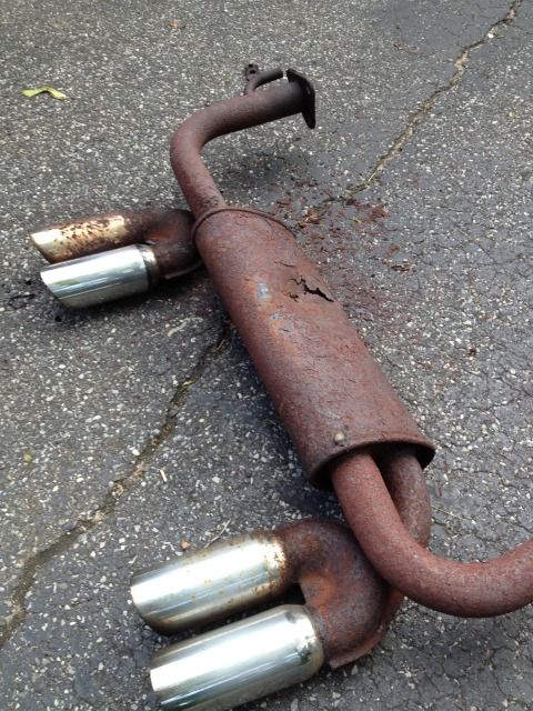

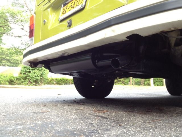

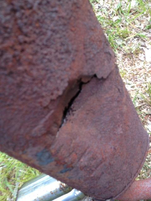

I finally got around to addressing my exhaust issues. The bus had been popping alot lately, and sounded like crud at idle, so I order a fresh new extractor exhaust from bus depot. It arrived this morning, and I decided to hop right on the task.
Knowing that it was due to be delivered this morning, I had been going out and spraying the old bolts with PB blaster last night and early this morning. It really helped on all 6 bolts around the exhaust flanges from the heater boxes to the old rusted through EMPI 4 tip that had been on there. It didn't do a thing for the bolts on the EGR line though.

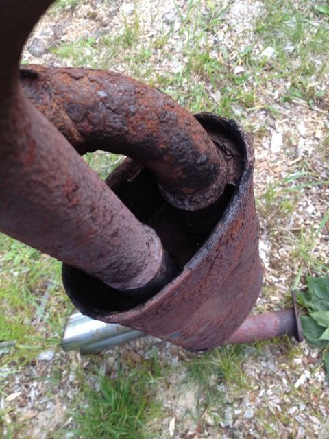

Once all the bolts were off, the muffler started to come down, and the line from the EGR just cracked. I figured, since it wasnt connected anyway, this was as good a time as any to fab a block off plate. I made a nice block off, and secured it in place with bolts to the holes that lined right up with the holes on the extractor muffler. I put some hi temp permatex in between and tightend down. Then, hit the whole muffler with some exhuast paint (which later proved to be a waste, as it still burned off when it got to hot lol)
I removed the hard lines from the block, and made a block off for the intake manifold too; using regular RTV silicone here to make a good seal.

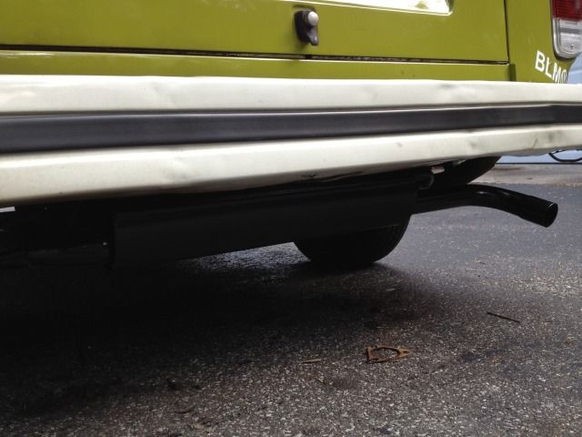

I went to hang the muffler up in place, and realized the bus depot had shorted me one of the triangular gaskets. I called down to GT Imports, and Tony had one on a rack, so he left it outside for me, and I took a cruise south to grab it in the Fusion. Once I got home, I lined up the new hardware, and got the whole thing buttoned up.
I chose a more stock look, 1) because I like the stock look, and 2) because I was tired of cutting my shins every time I approached the back of the bus either to put stuff in the trunk area, or when camping. This new set up tucks away nicely under the bumper, and looks clean. I did find that I have a hairline crack in the neck from the drivers side heater box, to the flange. Its small, so Im gonna try to patch it tomorrow with some JB weld for now. If I can get another 2 years out of it (to hold me over to my next muffler install) Ill be happy, and by then might make the swap to the more desireable later style heater boxes.
The old one... May it R.I.P. (Rust In Peace)

Looks like you got your money's worth out of that one. It reminds me of a muffler I took off my old Impala, I still have a piece of rust/carbon embedded in my finger from it.
It served me well!

Wow, that was one nasty muffler. I'm sure the new one is making the ride much sweeter!

Nice hunk of rust ya pulled out. New exhaust looks much nicer!

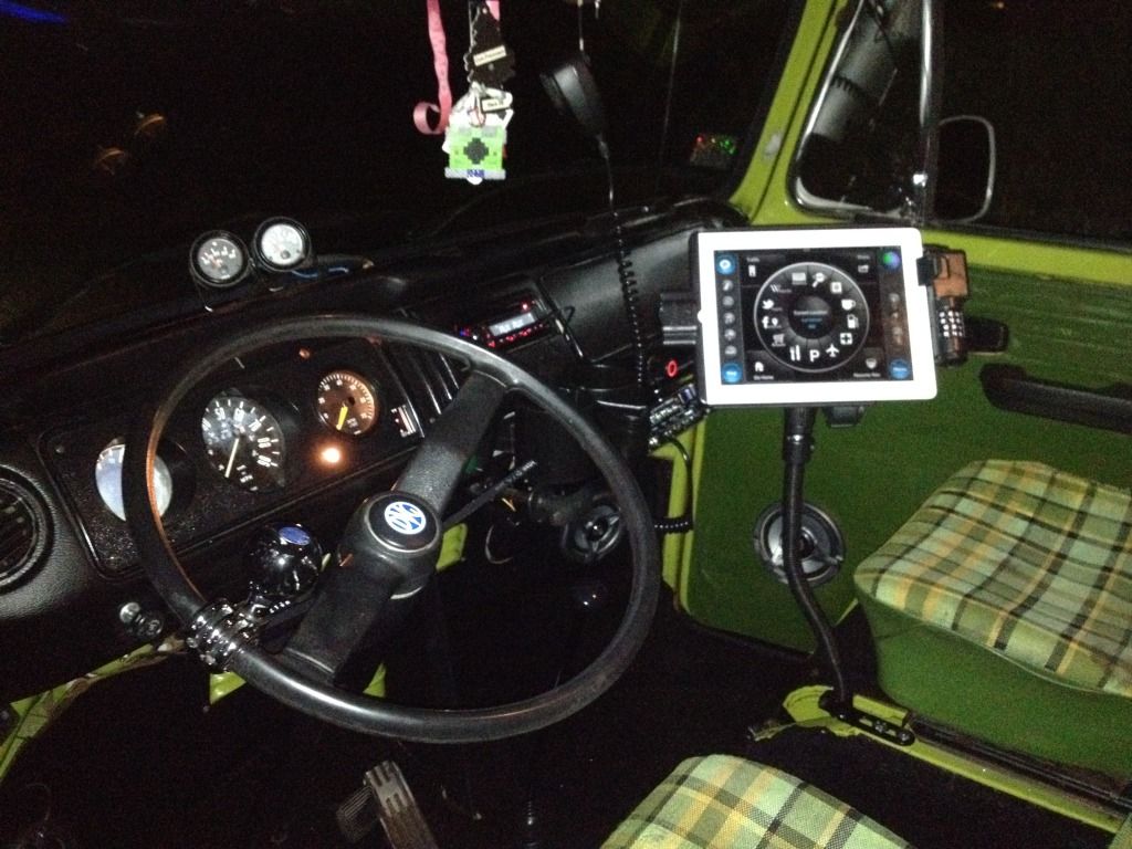

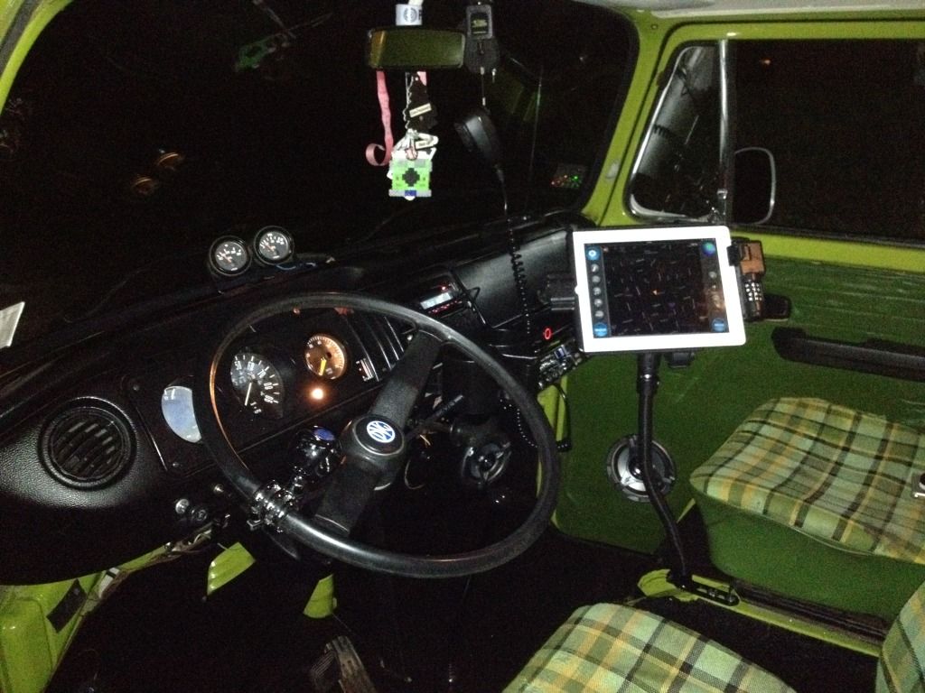

Installed the RAM mount today, here's a short review.
This is not something to stay in the car for daily use, it just takes up too much valuable real estate even with this being one of their smaller docking units. I like it because it brings the iPad within range to function as a GPS (as the iPad is a much more accurate and versatile GPS in comparison to my TomTom) also, it brings more music plus pandora to my travel tunes collection. Pandora is certainly just as good IMO as Sirus, and costs nil. The quality is nice, I questioned the plastic cradle at first but after seeing the unit assembled I'm glad it's not metal, else it would be fat too top heavy and thus wobbly when in motion.
That said, there is a degree of movement when the bus is in motion. It's not so bad as to limit the view ability of the screen but it's more than would be desired ideally. The "arm" is a 1/2" diameter aluminum rod that you bend to suit your needs. That's great in terms of adaptability, but not so much in terms of rigidity. The locking mechanisms are nice, they're obvious when looking at the device in the car so while I don't plan on leaving it in the bus when I'm not around I'm not panicked about just wandering a short distance or stopping to take a leak.
The GPS ap, GPS Drive HD (Motion X) is VERY good, well planned, powerful, and has lots of packed in features. Worth a look even for your iPhone.
Placement in the walk through is decent, it only blocks the calibration controls on the CB, but doesn't come so high as to limit view out the front or sides, nor blocks the mirror or stereo. The bracket is suspended through the walk through, and thus doesn't impede leg space on the passenger side, nor hinder the ability for the seat to spin around.
Biggest forseable pitfal? That nuance of "shaking" that is generated through the bus and up the bracket that creates an ever so minimal, yet noticeable movement of the screen.

Looks great mike. Nice work and review
