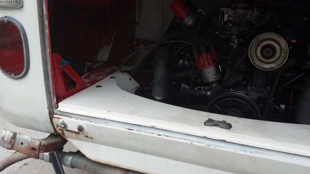

AoT wrote: I did not put the hose clamp on the rear side of the shroud.
you mean front...right?
The only thing you can do now is lower the motor slightly...just enough to squeeze your arm or body in there to fix the cable routing. Its a PITA nd I have done this way more many times than I wish to admit. grrrrrr.
From what I understand there are no rear tranny mounts on a type 1 bus so I think all you need to do is unbolt the mustache bar and lower the engine and do what you need to do and jack it back up and put the bolts back in.
Kudos for the suggestion to try using a cable tie to secure the accelerator tube to the shroud. (front). It worked to keep it from wiggling up to the carb. Much easier than dropping the engine.
Checked the dizzy this morning when I went out to get the paper and the center wire is off the coil so that explains a lot. Will give it a crank after work. Can't forget the basics. Thanks to the team for all the feedback!
Dizzy wire connected and turned over on the first try!
Took it for a fill up and it runs so quiet. Got to get the inspection done to get it road ready
Some oil around the gen stand so will have to check on that

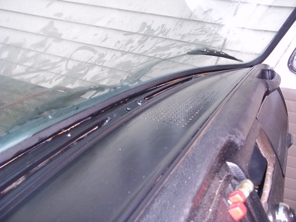

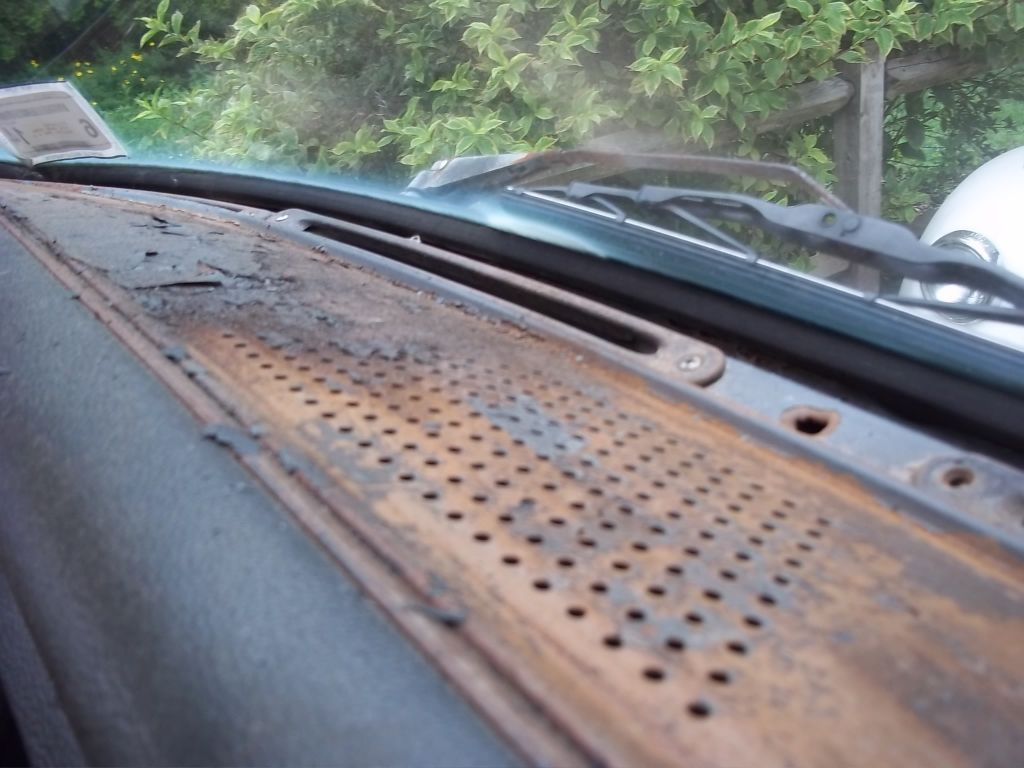

Took the brush to the metal yesterday and worked on the dashboard. Wire brushed it and got off all the flaking paint and gave it a few coats of black satin.
Cleaned up nice!

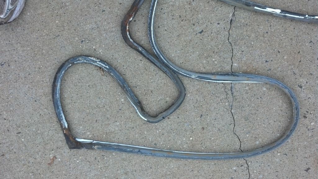

Getting it washed shows the need to replace the window seals. Tthe rubber is so dry and water on the inside glass. Whose got the secret on this?
AoT wrote:Inspection is done and good to go. Got the bus washed and ready for Sunday.
I did the windshield seal on the bug, there is a trick. I'll tell you about it tomorrow.
Aud I did the one on the front of my bus when I first got because they put in a new windscreen, but used a seal that didnt completely fill the opening in the curves of the body and I didnt want to let water get in. Ive done flat windows on beetles too, which are totally different beasts just due to the sheer size, added by the compound curves in the window. Its a bit tricky, but only in the detail, but easy in comparison to what youve done. We can talk, and when youre ready Ill swing by to give you a hand.
Make sure to buy the seal with the larger "bottom" some seals fall short, but they make a bus seal that has about 3/8" extra material at the bottom that overlaps the sheetmetal below the windscreen to keep water from getting in under the window... a trouble spot in baywindows.

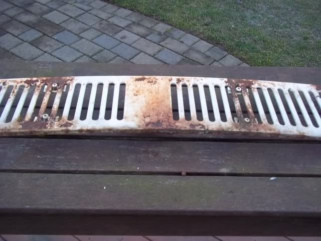

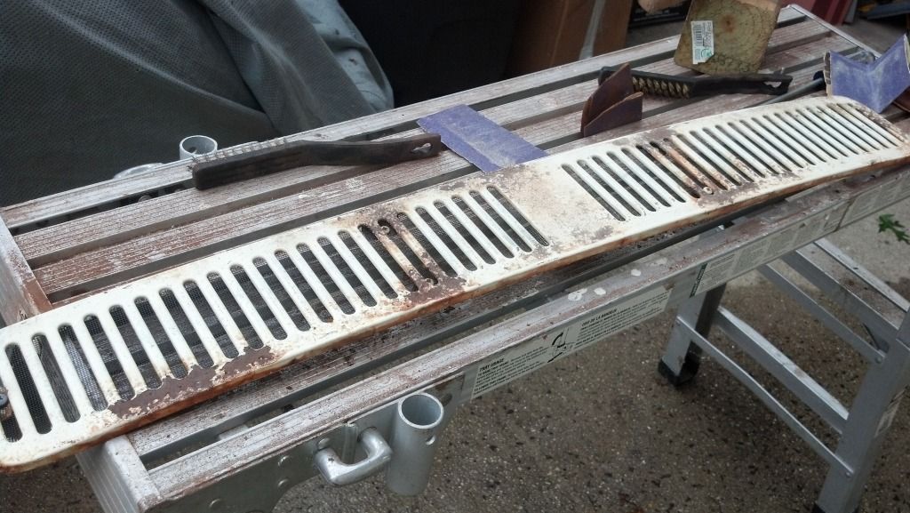

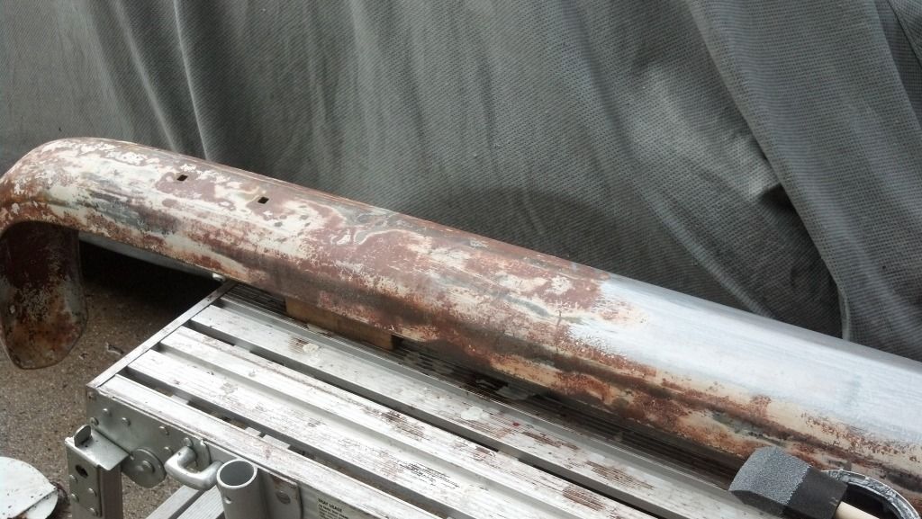

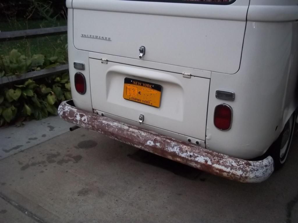

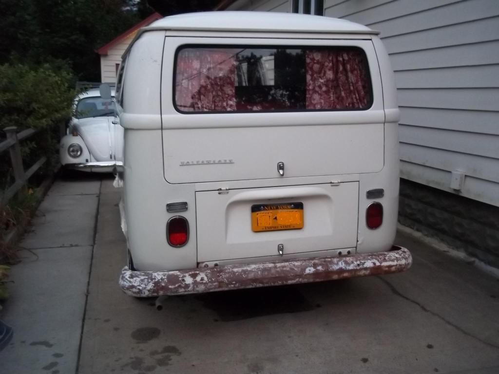

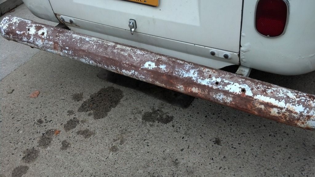

Took off the rear bumper and got it cleaned up and ready to paint. The patina look was not working. Sanded it down and cleaned it up with marine clean. Also am doing the same thing to the front grill.
Sanded down and putting on a coat of POR15. I bought the silver by accident but I like it since alot of want I paint is black and this lets me see what spots I missed. Plus with the cream color it is easier to cover.

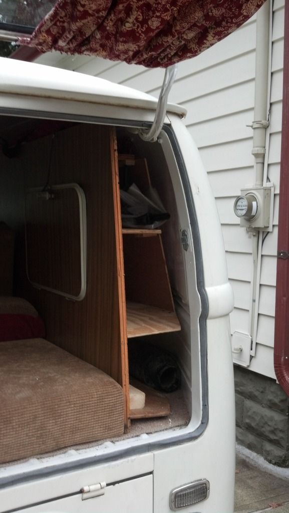

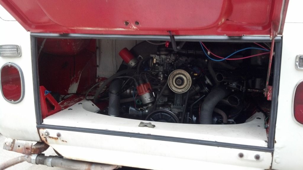

The new seals got delivered so I got the ones on the engine compartment and rear hatch replaced. The engine compartment is a tight fit and the door does not lay flush by it gives it a tight seal. I adjusted the locking latch to the closest point but didn;t make much difference.
the rear hatch was nasty so I was glad to see that one go.

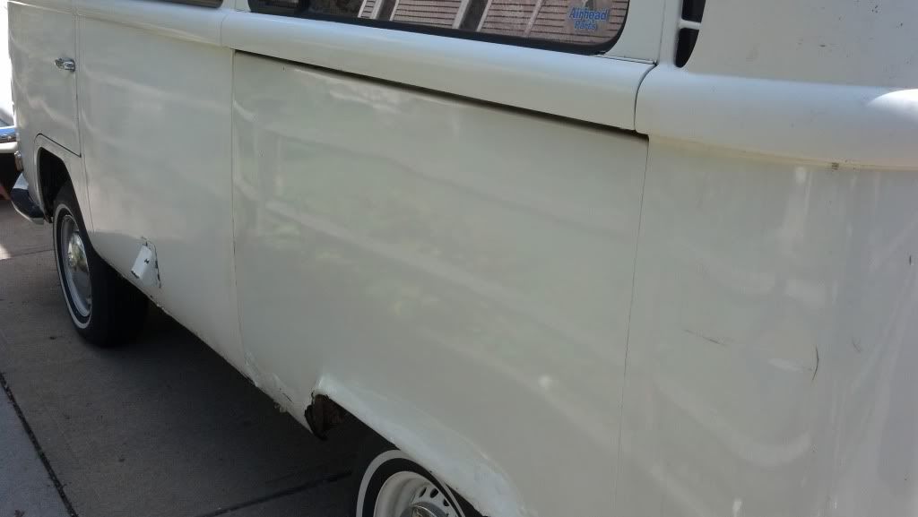

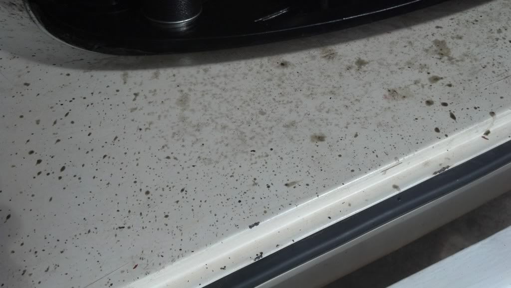

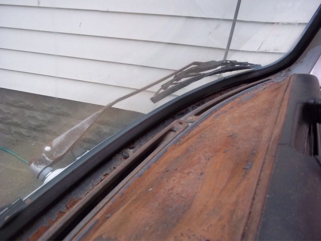

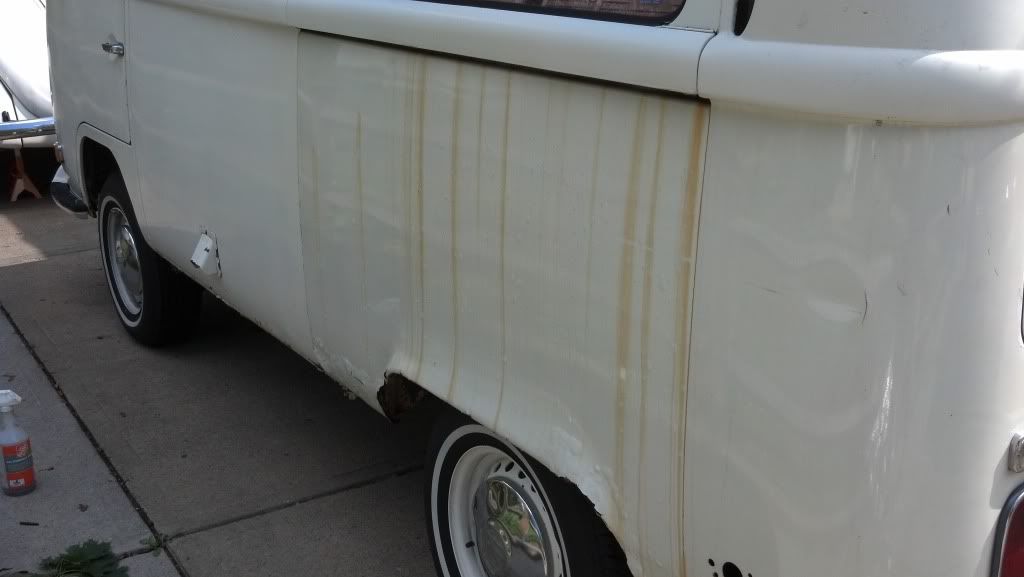

I had asked around about getting the rust streaks off the rear DS panel. Was told CLR was a good product so i bought some. I decided to give the panel a wipe down with the "purple"stuff before i used the clr. Was wowed shen i saw the purple stuff took off the stains. Easy solution.
To avoid this repeating i wire brushed the track under the track cap and gave it a coat of por-15.
Finished getting the bumper and grill painted to re-install this week. Then i went out for a run and passed the scene of the injury. The concrete flag was raised about 3 inches. Think i'll spray it with pink flouro paint to glow in the dark. :P

Gave the bus a little face lift!! :D
Grille makeover....... 'oh yeah!'

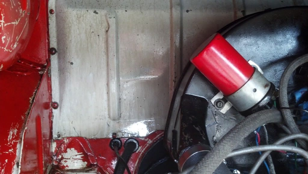

Bus ran great for the trip to Flanders but it looks like its time to change the oil cooler. Its starting to look like an oil slick.

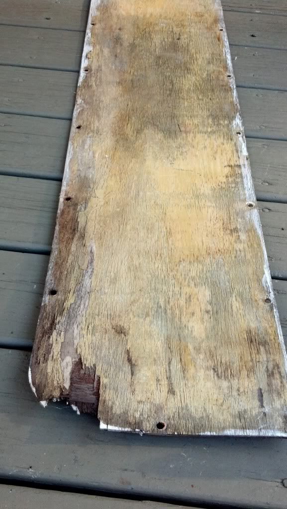

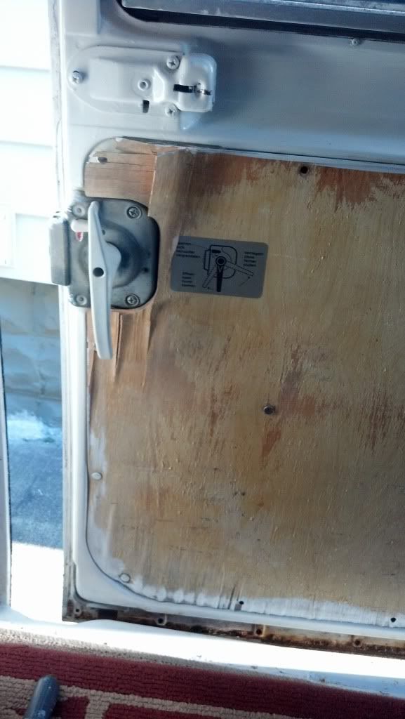

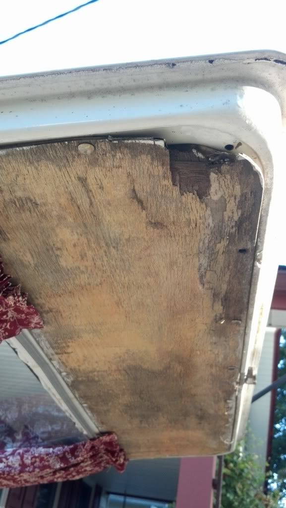

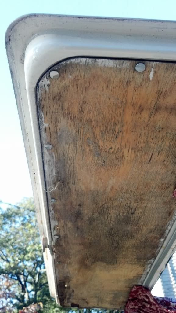

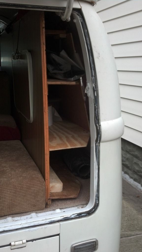

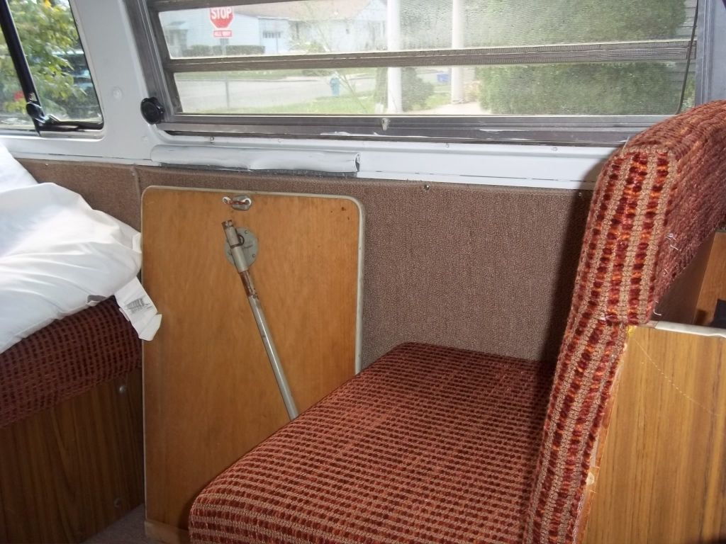

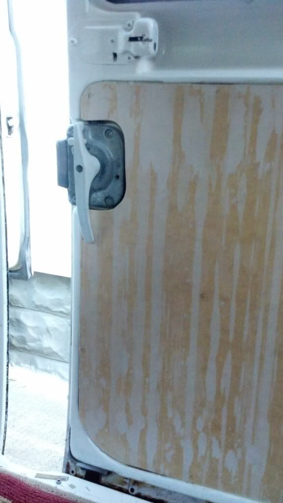

Decided to try and get some of the interior issues done so that i can get a stereo and speakers installed. All of the door panels are shot. The current ones were picked off a bus and the lower edges are shot. I bought a sheet of paneling and some vinyl to recreate the look. Thats tomorrows project but after work i took on the rear and slider panels.
Both had lots of water damage and all the veneer layers had lifted.
The PO had a heavy hand on painting the inside.
Slider panel cut and fitted. I am going to cover with the door panel vinyl and same with the rear hatch. Need to get a few more flat head panel studs that hold the panels to the door. Door panels and glueing the panels up is the plan for tommow. I ordered some speakers so i can get them installed on the doors while everything is open.
Nice. What color vinyl or fabrics will you use to cover them. The interior of the bus is really looking awesome!
