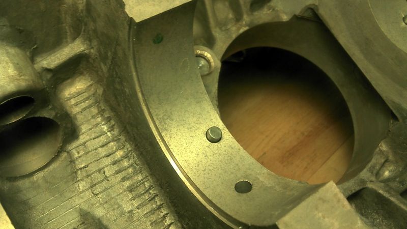

Also, I tried out the main bearings for size. I also tried to "index" the oil holes in the bearings relative to the oil holes in the case. Here's what I've got for #2....the green dot is the hole in the bearing. Seems in line with the case hole
On #3, it looks a little off.....much more than this picture suggests. Don't want to "cook" a bearing. What do you think?
Is that oxidation on the bearing saddles okay? Looks the same on the cam bearing saddles. It's a new case so it was never all shiny like a freshly align bored case was but I just want to be sure.

Re: '73/1500
It depends if your building a stock or a race engine.
I generally ensure that the oil holes line up with the bearings and the oil pump. On a rebuild I let the machine shop check the case, crank and rods to ensure they are OK. For a new engine I buy my parts from a engine builder and have them ensure the parts are ready to be used. It's more efficient to have a "pro" check them out than to stress myself by trying to save a few bucks.
So far this has worked for me, over 2 dozen engines built and not a single premature failure.
