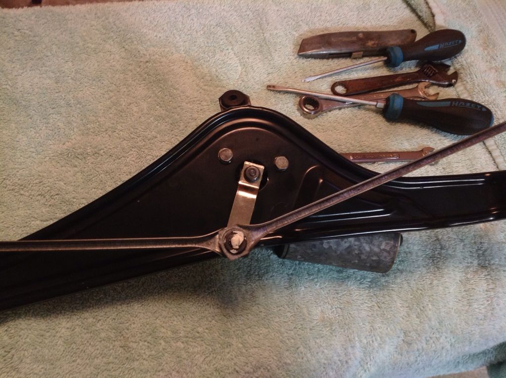

Today, I took the old ones to work and polished them up. Never mind asking why we have a polishing wheel at a funeral home ;-)
Needless to say they really won't be seen anyway but I wanted to get off the crud that had coated the flat surfaces of it.

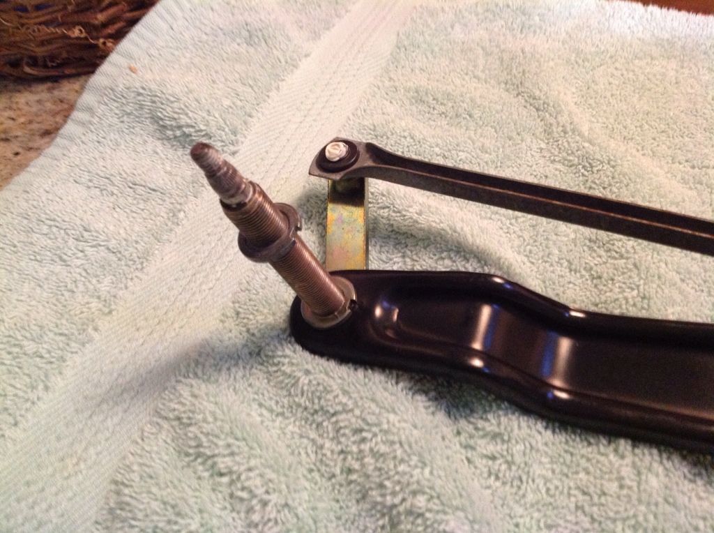

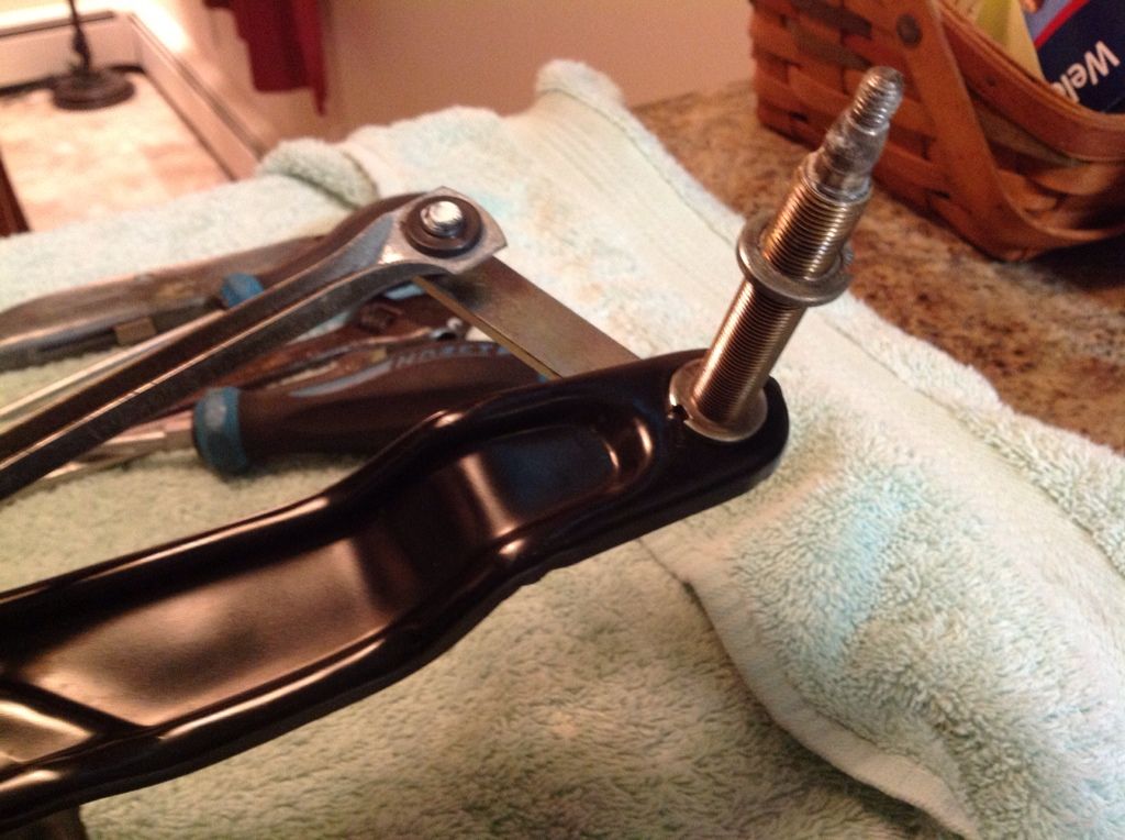

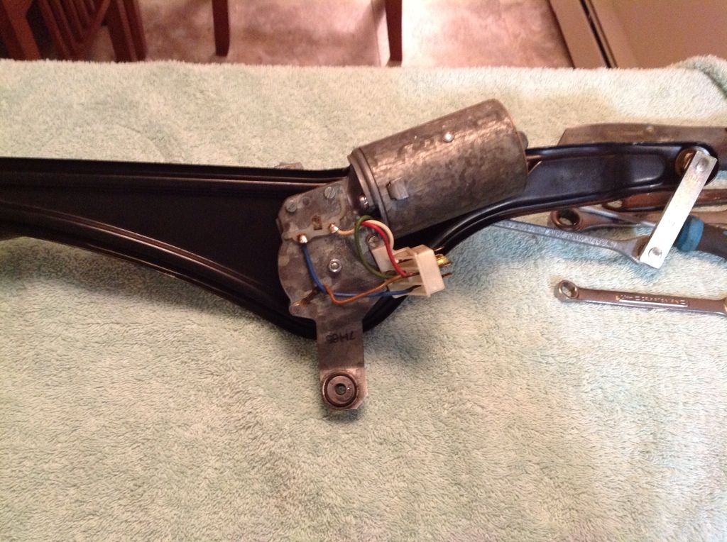

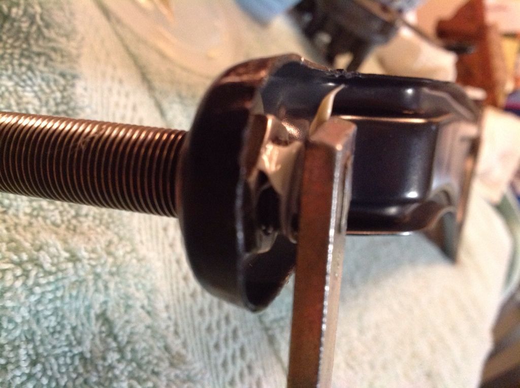

So, I reassembled the wiper unit while having dinner. As suggested, I used the "run off" oil from the tub of white lithium grease. After the working surfaces were wiped with the oil I put a finger-tip worth of grease on the shafts, and the joints of the connecting rods and bushings. Before mounting the motor back to the rack, I worked the wipers back and forth a bit and it became very clear how these things work! I may be simple, but it was nifty.
Then, I mounted the motor, connected the drive lever and voila!
Drivers side shaft
Here is one of the spring washers, they act like mini shock absorbers!
The drive lever
Passenger side shaft
Motor
My rubber mounting bushing on the bottom was very pliable, I replaced all the others and this will all go into the bus in a few days.
I am a bit nervous about the motor. This was my first attempt at cleaning and adjusting things. My biggest fear again is that the silly little "Apollo 13" shaped thing is in the wrong place, or should have been lubricated. We'll see! I'll be sure to plug the motor in and let it run a few times as well as let it "park" before I reinstall the dash and close everything up.

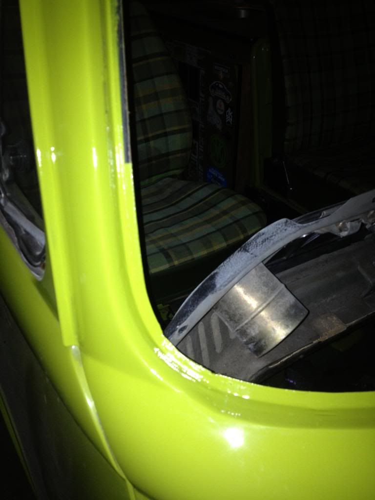

Here's a few pics, bear in mind it was dark. I'll take a few more in the daylight.
Once it was settled in the garage, I brought out the wiper motor I just rehabbed. I plugged it in, turned the wipers on and it started up! I was happy as I thought I fudged it up reassembling the brushes and the armature inside.

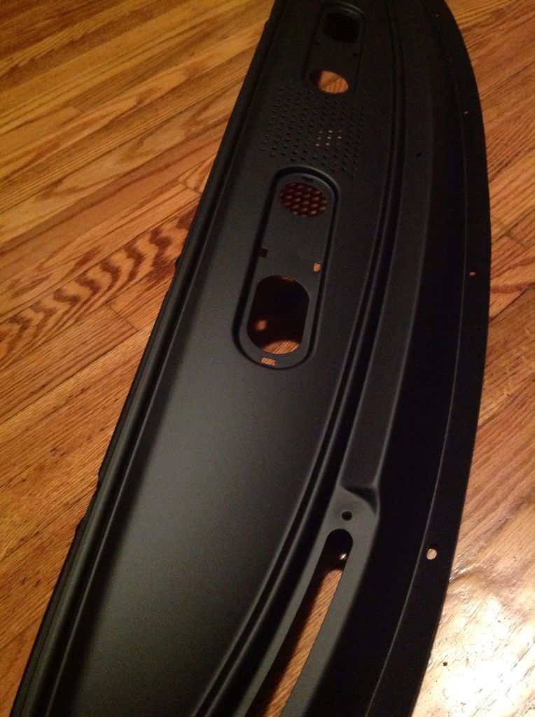

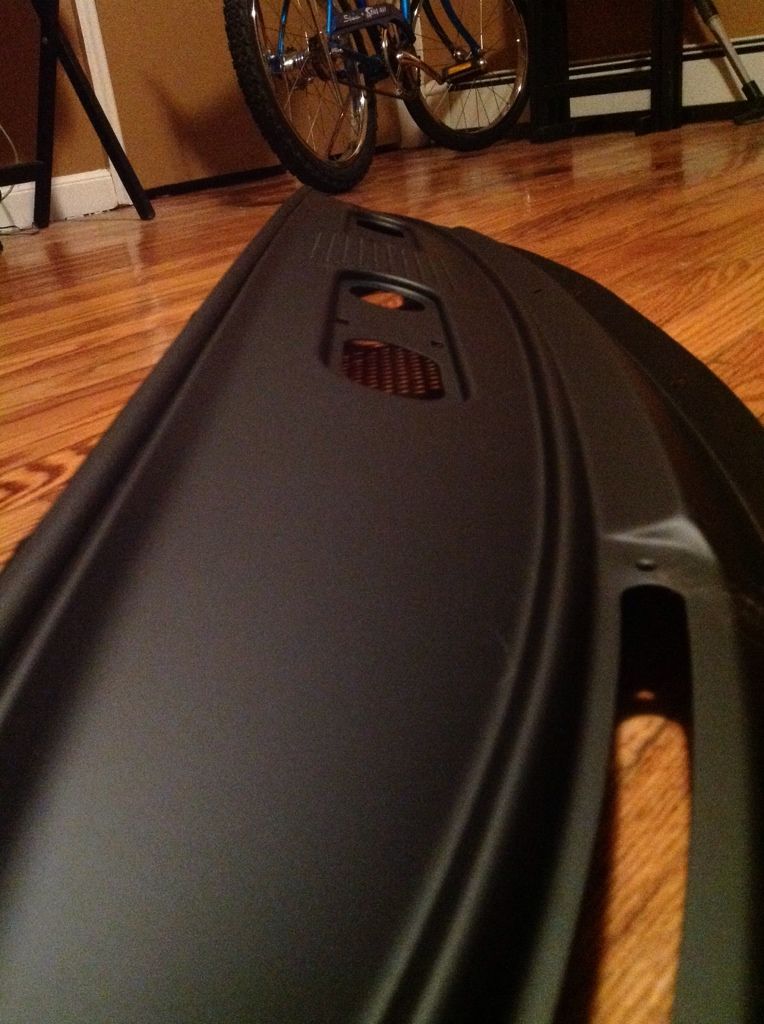

Dashboard is back, while I'm mostly happy. I am a bit peeved that he missed a small (pin-head-sized) spot when he sandblasted. It's along the edge under the window and I doubt anyone will notice because of where it is, but it tweeked my OCD. On the while, I'm happy. Wasn't the cleanest job underneath either but no one will see that.
I will concede however, that I probably will go to Action next time.

wow. that dash looks gorgeous!
ps.... I hope you voiced your opinion on the blem.

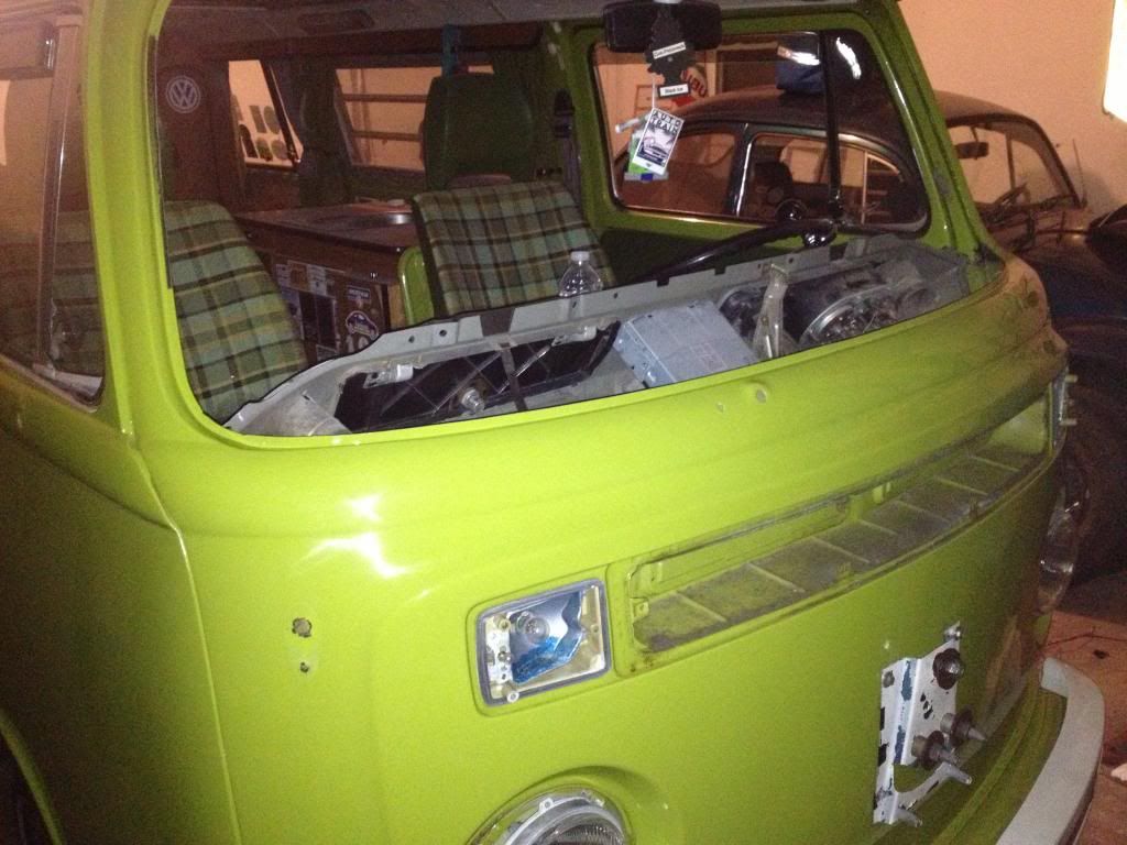

Made it into the garage today to start putting the nose back together.

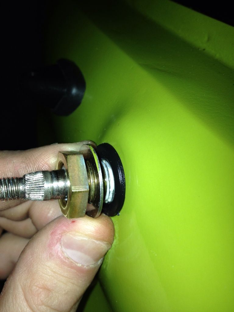

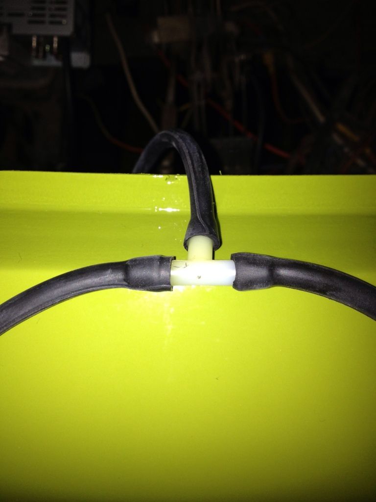

New windshield washer hoses... I'll sort through the washer bottle and aftermarket pump later.
I connected the T first, then fed the lengths of hose through the retaining clips on the inside of the nose, then out the front skin before I cut them to length. I left 2" for working space and used a bit of simple green as a lubricant to help slide the hose over the new washer nozzles. Then, I pressed them into place.

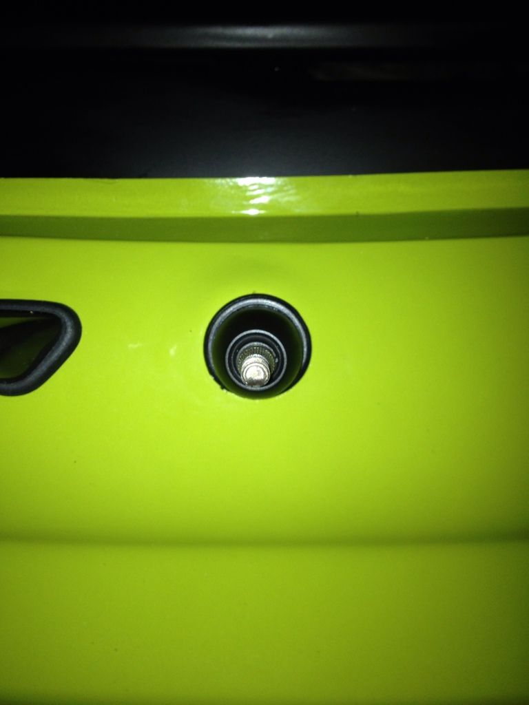

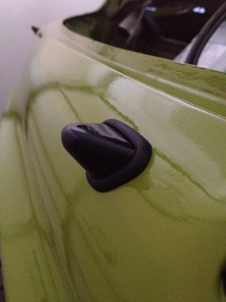

I put the new wiper shaft grommets in too
With the grommet in place, I placed the wiper rack, put a bit of grease to help the shafts through grommet and installed the washers and shaft nut. What's cool about these, that I didn't notice; the washer is absolutely a must have because even with the shaft in place, there is still a bit of wiggle room. The grommet crushes as the nut forces down the washer thus sealing the opening.

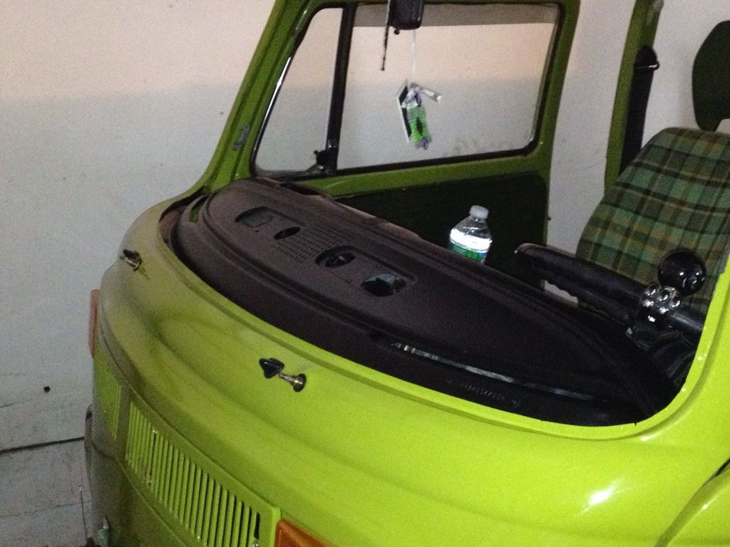

So I installed the turn signal lenses, and new seals as well as a new plastic screen behind the front grill. I used a bit of compound and wax to clean off some old stains from the tire and used new stainless steel screws. I kind of wanted to paint them green to match. But I don't think I can paint on stainless.
Next up, I installed the plastic ducting, and cleaned up the dash, installed the top padding to the metal plate, then both of those to the dash and screwed it all down with fresh new hardware.

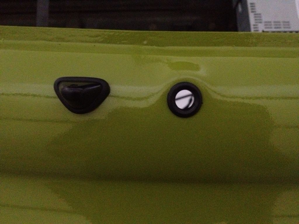

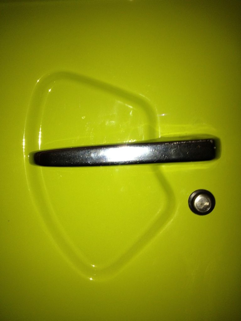

Also, put on my long-missing door lock seal, and a new plastic sleeve for the handle.

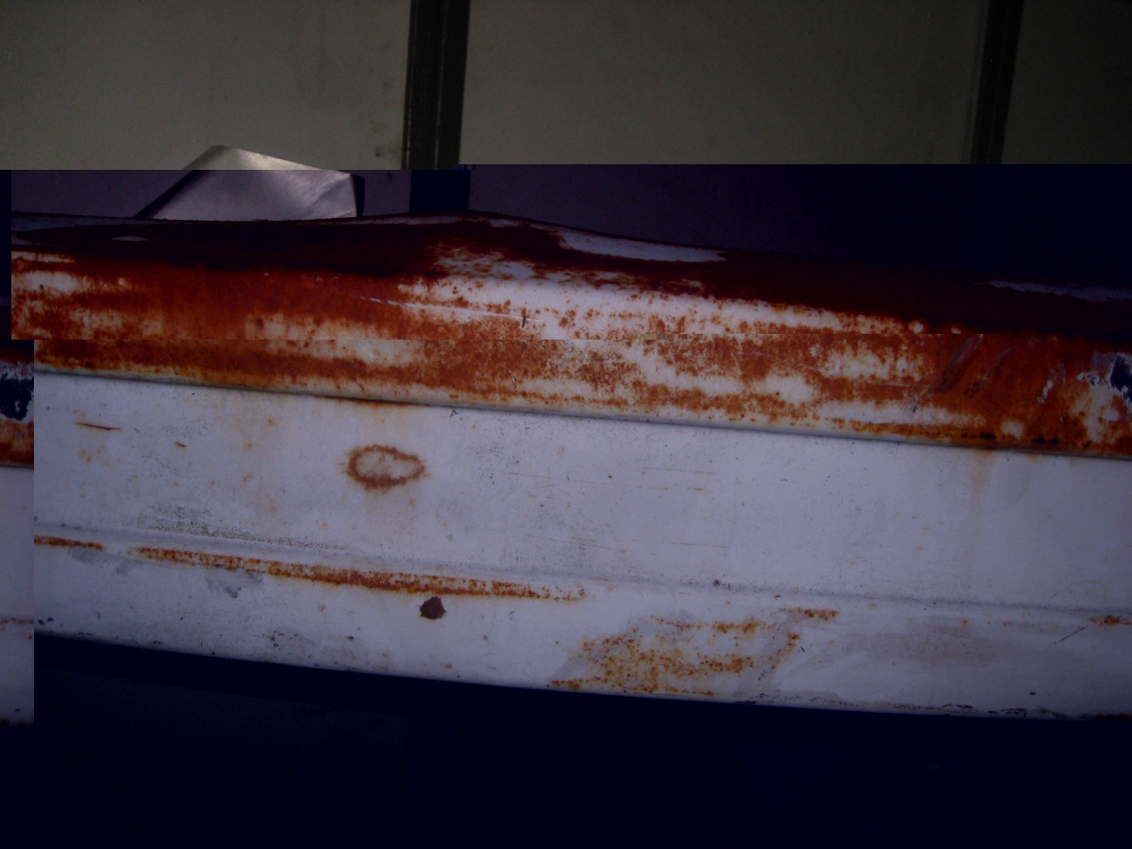

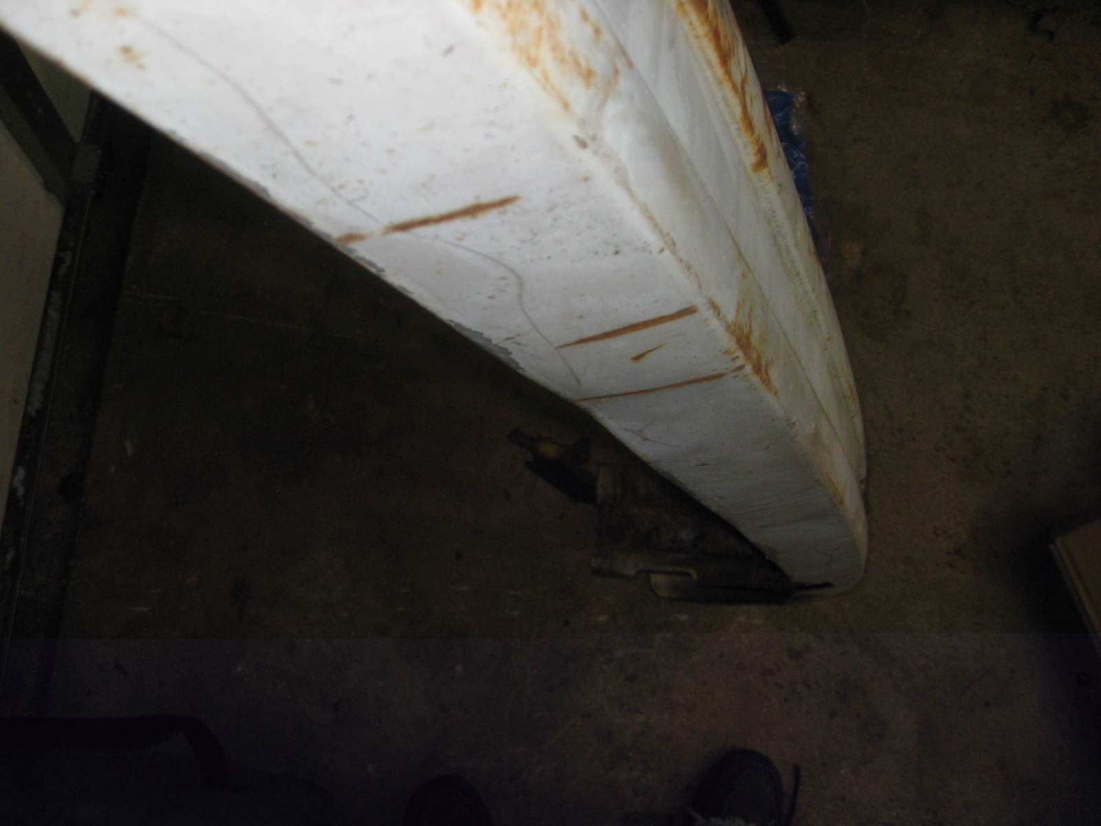

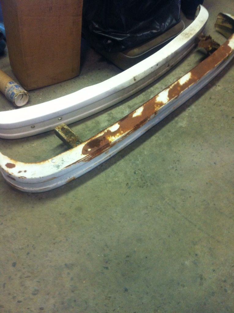

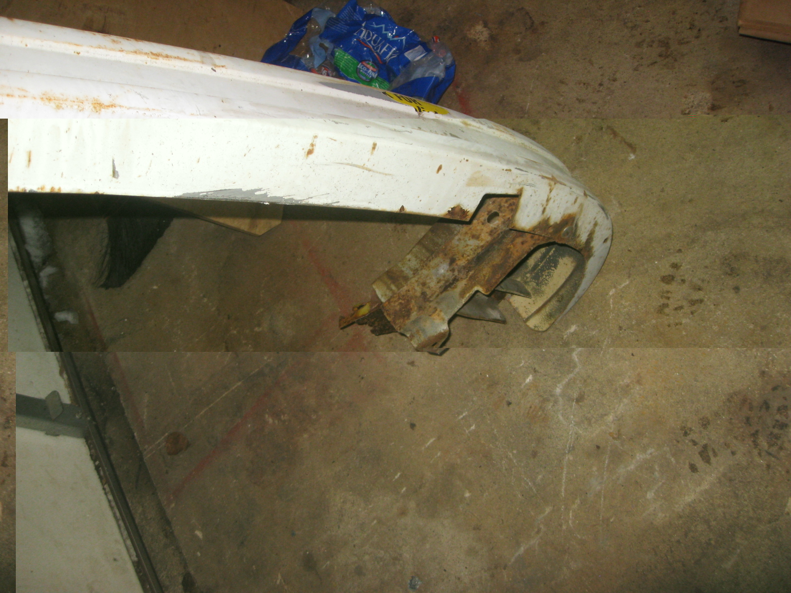

A new bumper for the back of the bus.
Yes it has a small wave but it looks far less creased than my current bumper.
Going to blast it and powder it with the rest of the bumpers.

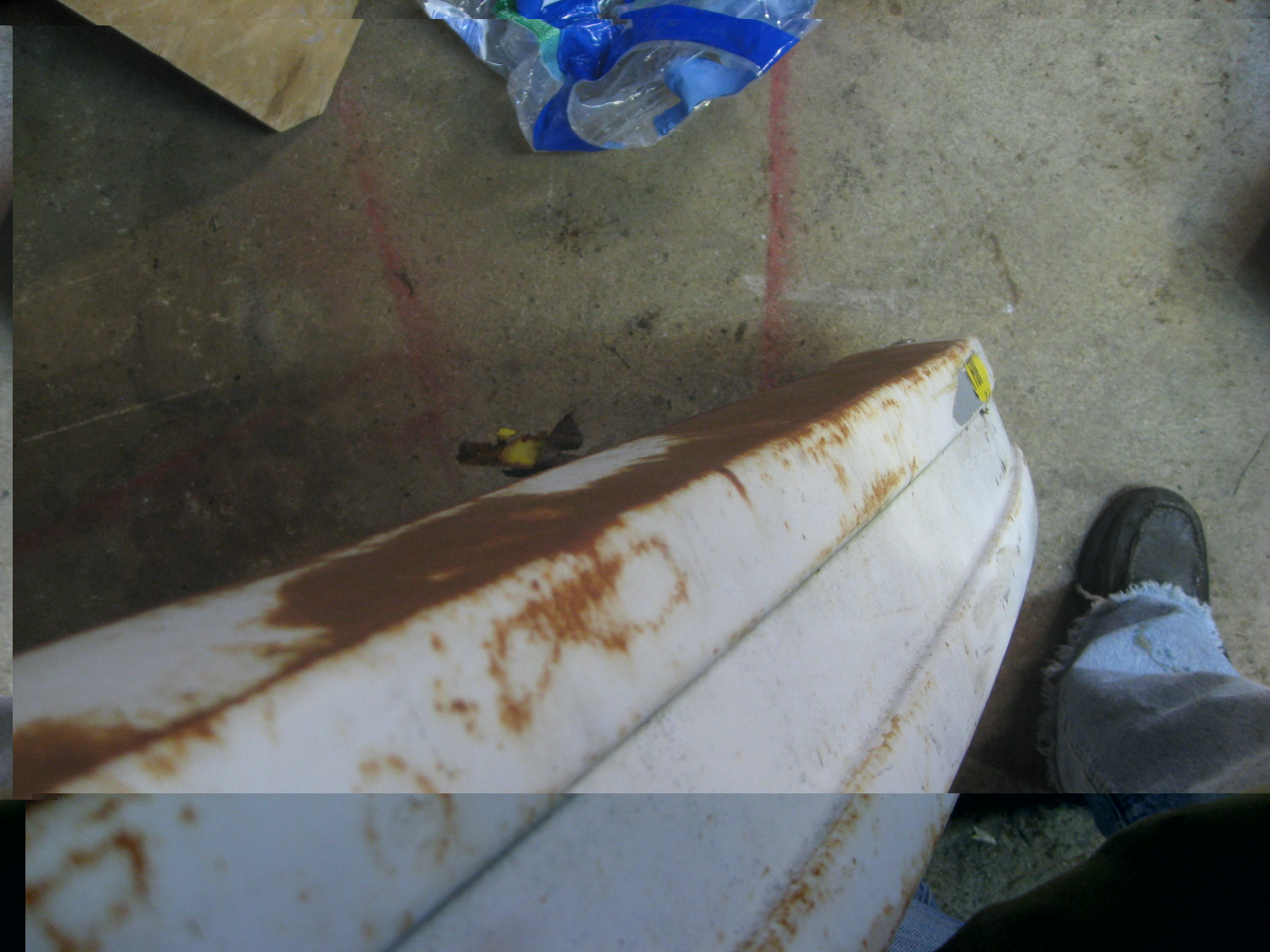

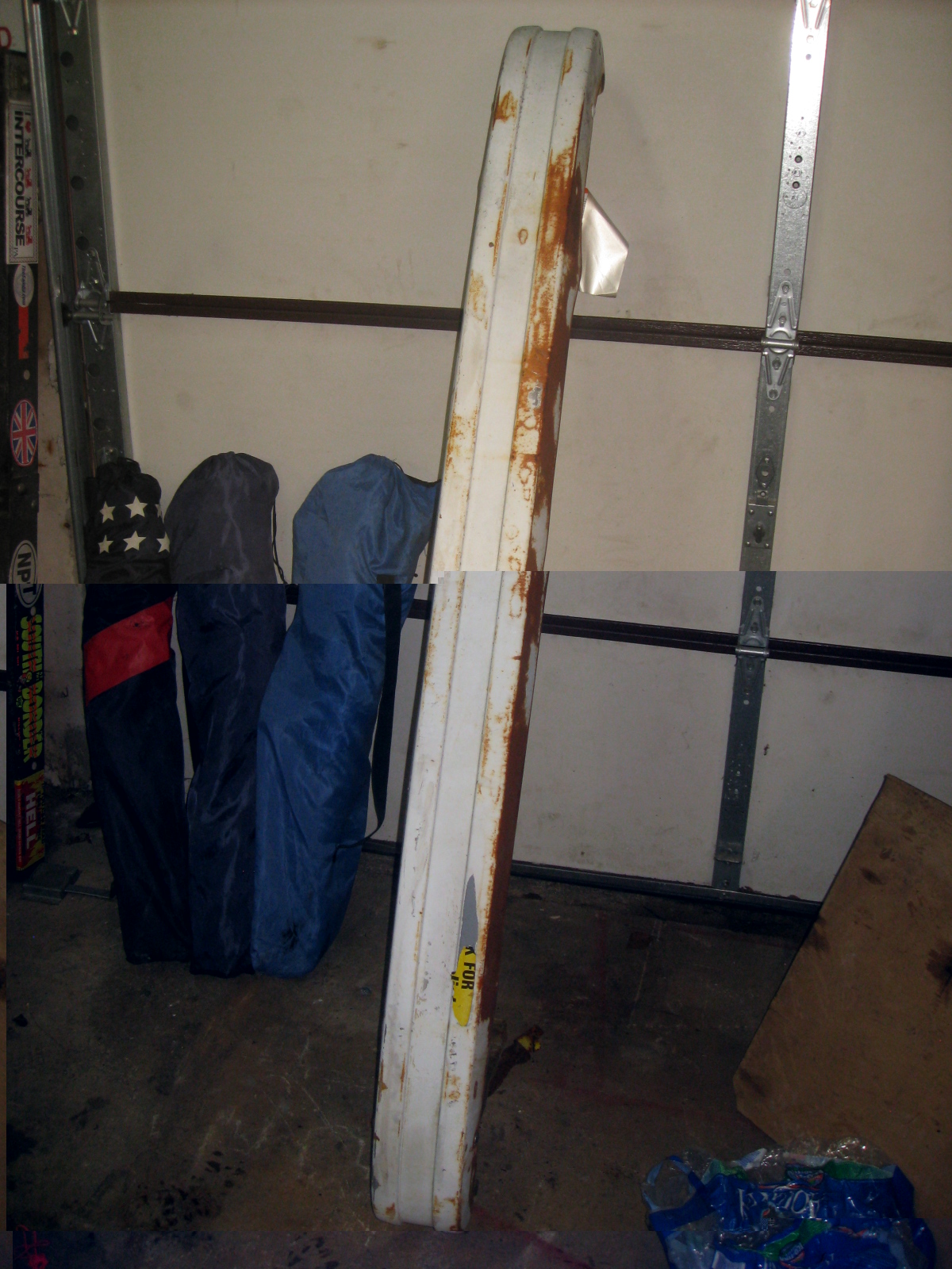

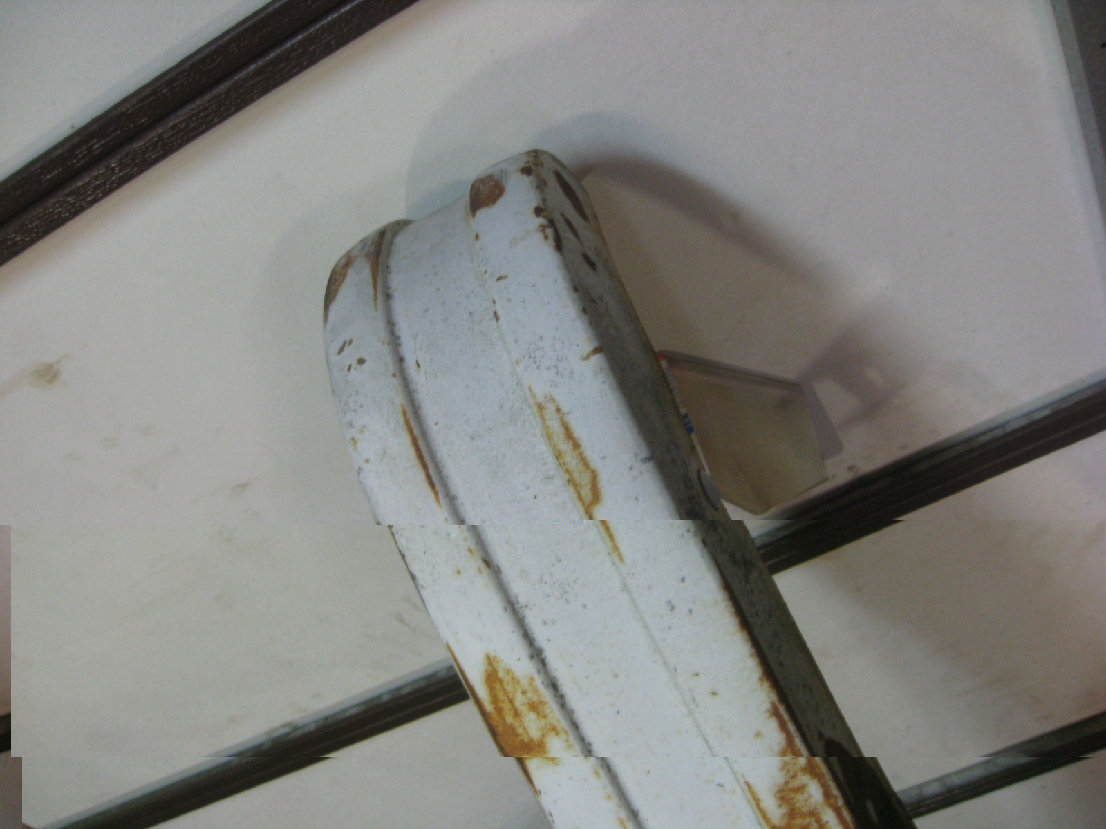

very nice bumper.... courtesy of Frostfest
Picture 089.jpg (772.73 KiB) Viewed 24121 times
Picture 092.jpg (848.17 KiB) Viewed 24121 times
Picture 097.jpg (782.57 KiB) Viewed 24121 times
Picture 098.jpg (671.67 KiB) Viewed 24121 times
blem 1
Picture 090.jpg (712.46 KiB) Viewed 24121 times
blem 2
Picture 093.jpg (584.34 KiB) Viewed 24121 times
Thanks Raj! I think it's a much better start than trying to use my current bumper.
I'll bring it by Masterweld. Garry was planning on making a relief cut heating, stretching, and welding my waves shut. It'll be much easier to work one wave instead of all mine.
I think you will be pleasantly surprised with this one Mike.

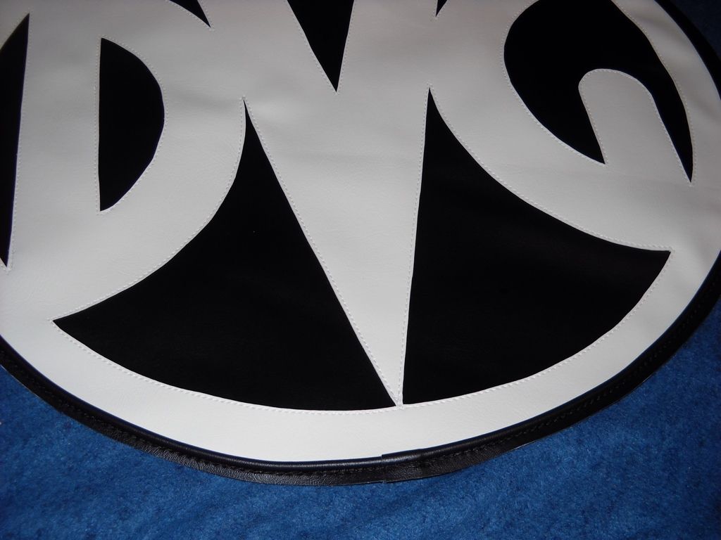

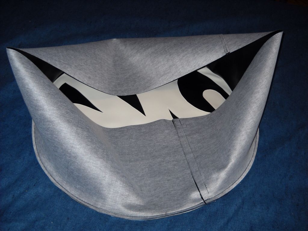

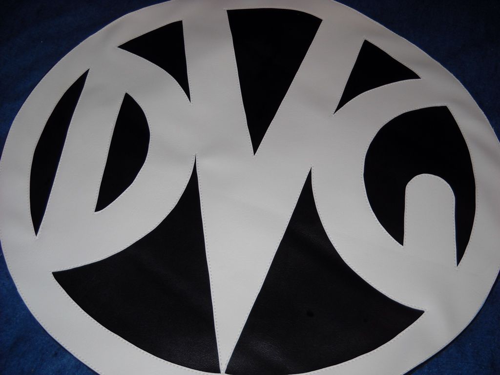

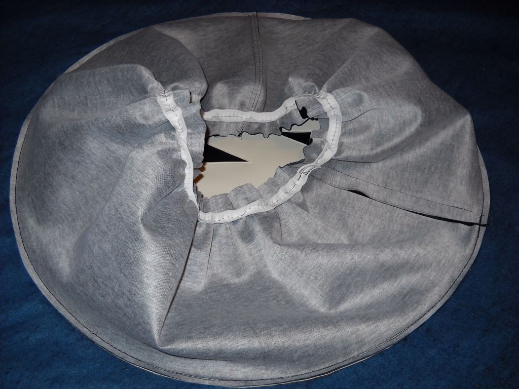

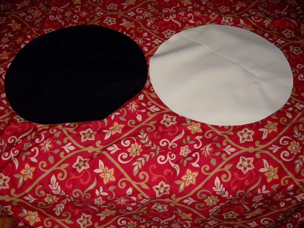

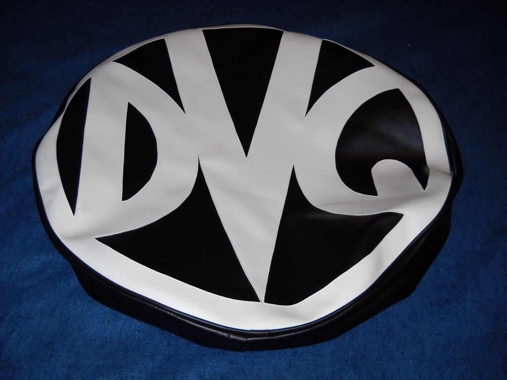

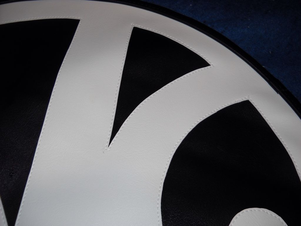

New tire cover... for a steal might I add... from a shop on ETSY.
The black will be the background for the white DVG logo.
The white logo, overlayed on the black. Stiched in place on all edges.
Black piping around the edging.
Detail of the stitching
The "treads"
The face
Elastics on the rear

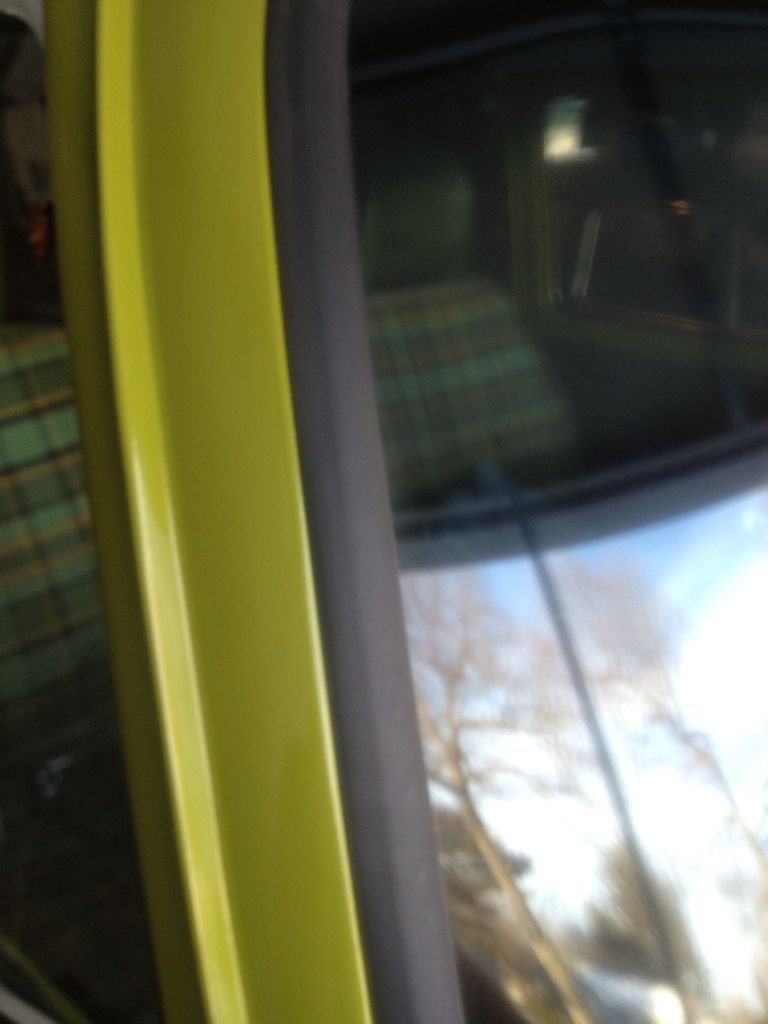

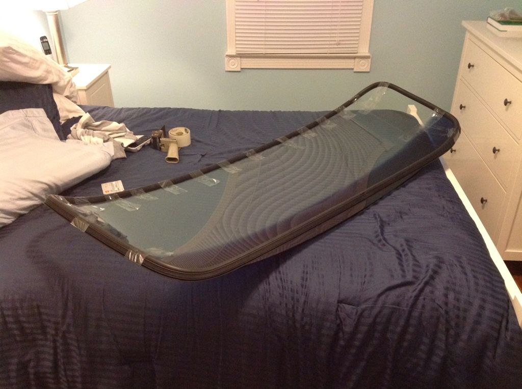

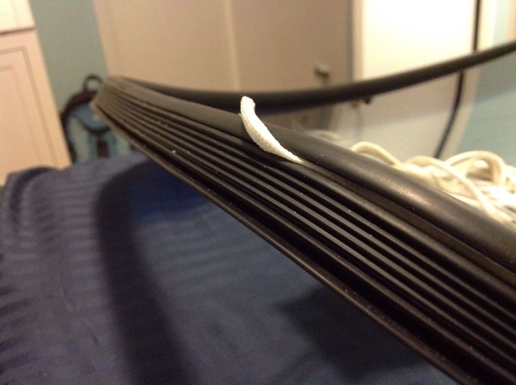

Also, picked up the new windscreen. Came home yesterday, and got the seal installed around it, and the roping in the seal. Hoping to get the window in over the next day or so.
The new windshield is in. Use some simple green as a lubricant and pulled the rope through.
We found the trick to getting it seated, especially on a big window like this; is to use gentle pressure from the palm of your hand to "smack" the window into it's seat as the person on the inside slowly pulls the rope. The second "pass" with the rope helps the inside to seat well, in any spots where the rubber may have rolled under itself.

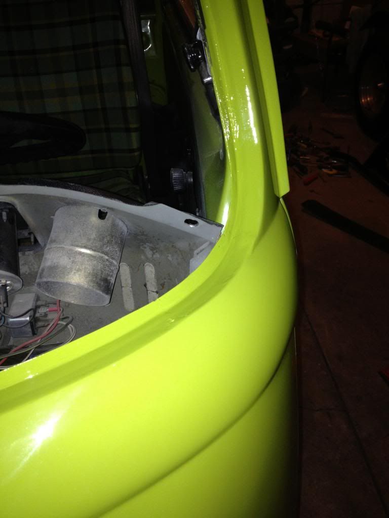

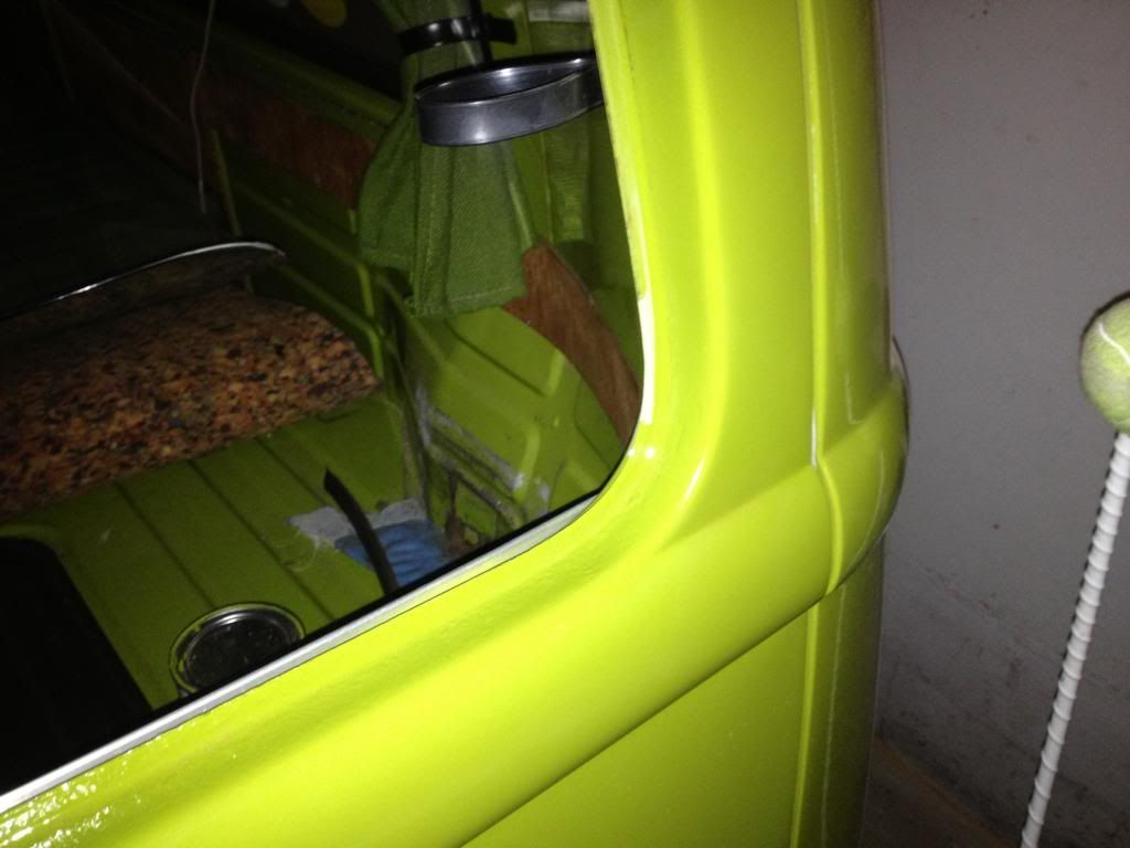

Looks great Mike, I may use your shop next winter as I have the same paint bubbles and a leak on the drivers side corner. Looks like they nailed it with the color match.
He was dead on with the color Tom. You wouldn't know if I didn't tell you... But the whole nose was actually not repainted. It's a feather job. I can't even tell where the new meets old. The metal work was done by Gary at MasterWeld 2662140 he's around the corner from me. The paint work was done by Jim Busterna. I'll bring his card next time I see you.
