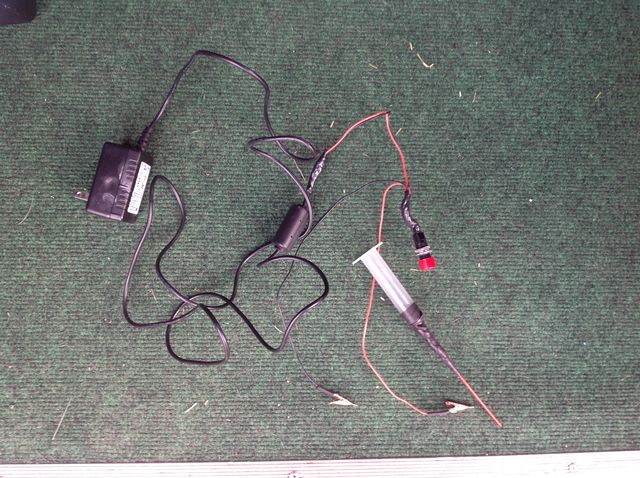

Do you have a picture of Jim's homemade injector cleaner setup ?
See above.
The syringe fits over the fuel hose which is already attached to a fuel injector, the red straw is from a can of carb cleaner which is used to provide pressurized cleaner into the injector. The transistor plug is from an old stereo, and has a reducer to ~3.5V (I think) the reducer is wired to a momentary switch. Which has two alligator clips on the far end. By tapping the momentary switch the injector pulses and sprays carb cleaner.it was great to see how poor the spray pattern was at the beginning, compared to how perfect the spray pattern was after cleaning the injectors. It was super easy, the hardest part was having the extra hands to hold. The syringe over the fuel line.

I wonder if Glenn could use it to get "spraying nice again"
wow.... nice save Jimbo! kudos to you both for getting this done with your own blood sweat and tears. makes it feel that mush better... doesnt it?
Kudos on Jim's masterpiece. Scary looking but got the job done. How does one think of these things?
ObnoxiousBlue wrote:See above.
Sorry, when I am at work I can't see pictures, they are blocked.

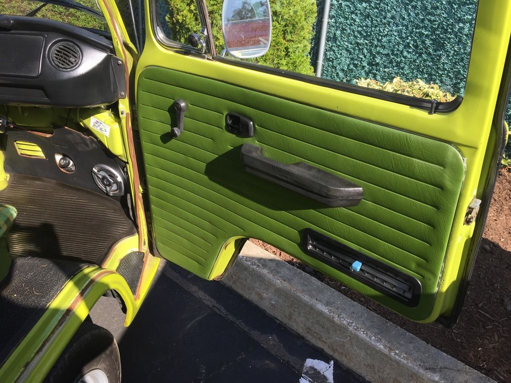

Drivers door panel

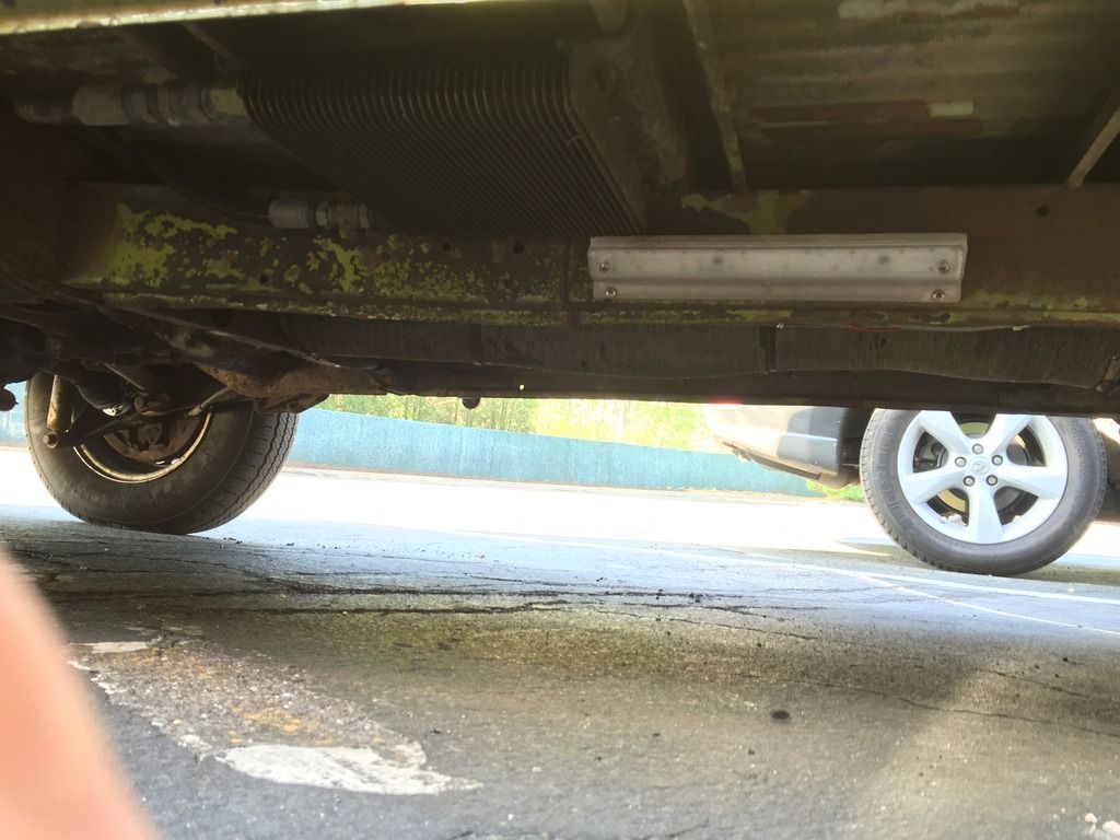

The underbody of the bus. You can see the accessory oil cooler, and the LED step light. A switch inside the bus, mounted on the bed frame activates the light which is handy for those late night runs to the bathroom when in a dark camp ground.

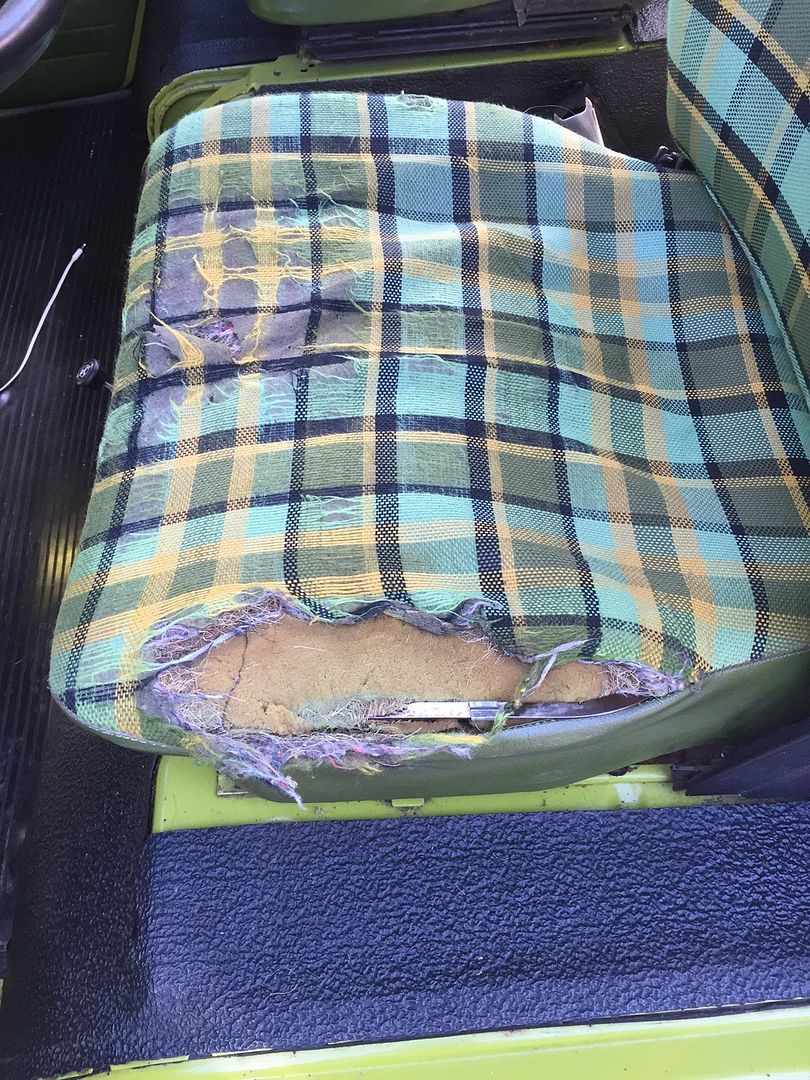

Both the drivers and passenger seats are due to be reupholsered - maybe overdue. I had withheld the repairs because as of last fall I was debating the upgrade to Vanagon seats (or the Go Westy plaid upgrades) IF the bus doesn't sell, these are the next project.

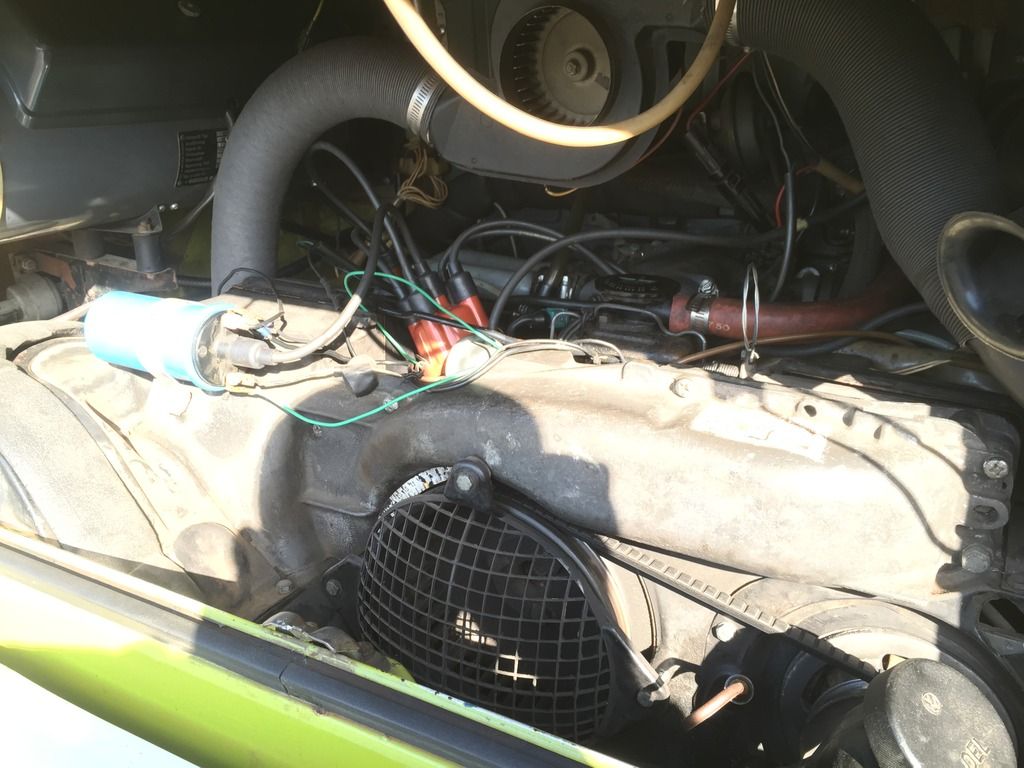

2.0 FI engine. Factory heat works. One of the jackets on the F pipe is loose, and rattles a little But doesn't effect the engine. It is a pitfall of not being able to get new F pipes.

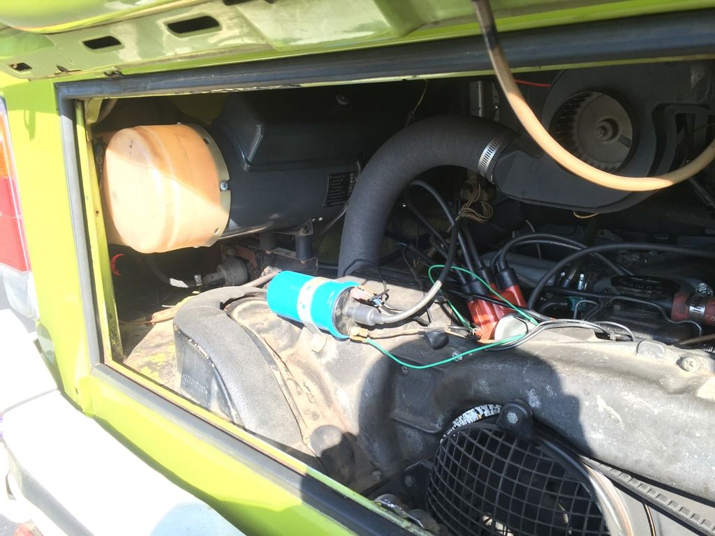

BN4 gasoline heater. It was restored two winters ago, and just got new fuel lines.
It works great, and puts out some fantastic heat. Details on the restoration are further back in this same thread.

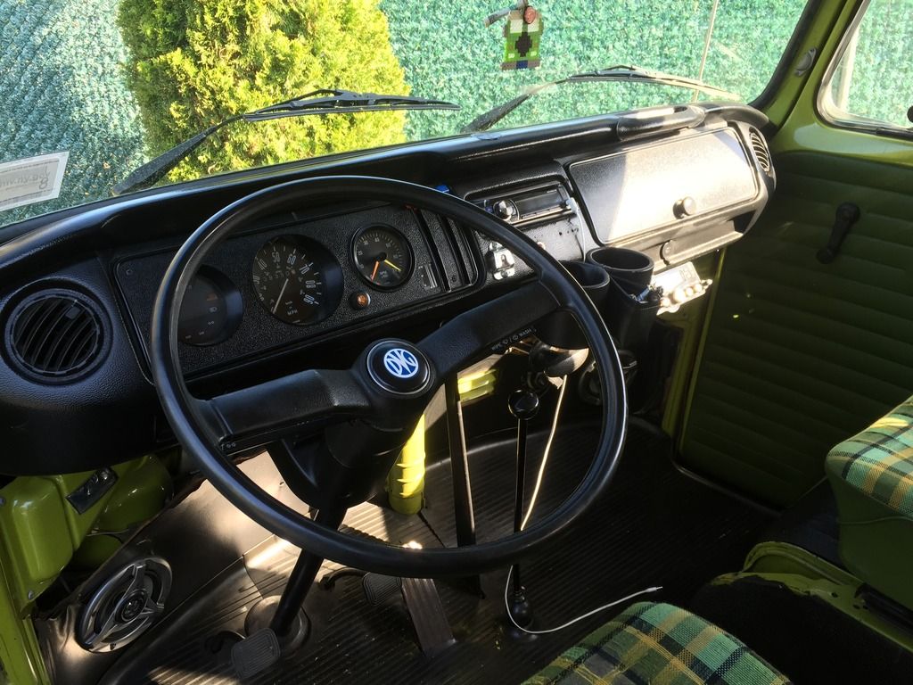

Dashboard. The tach is currently disconnected. The stereo is a CD set up with two 6.6" speakers in the kick panels. The white cable is just my AUX in cable for my ipod. The only flaws in the dash are a 2" disk that a previous owner glued to the padded dash top for a hula girl, and some screw holes that were put in the dash face under the radio. I used two of the holes for a CB Mic clip, the others to the right (above the cup holder) seem to be for a light that had previously been connected to the under-body light. (Like a warning light that it was still on) and the ones to the right look like they were for a GPS holder.
Drivers door panel
