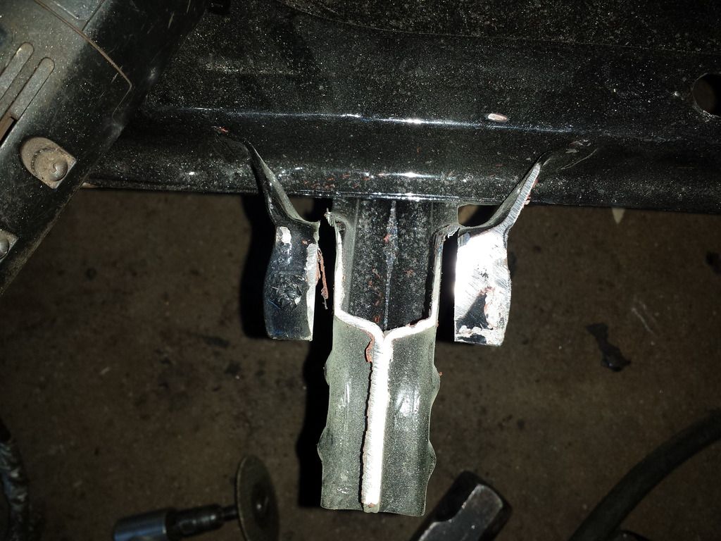

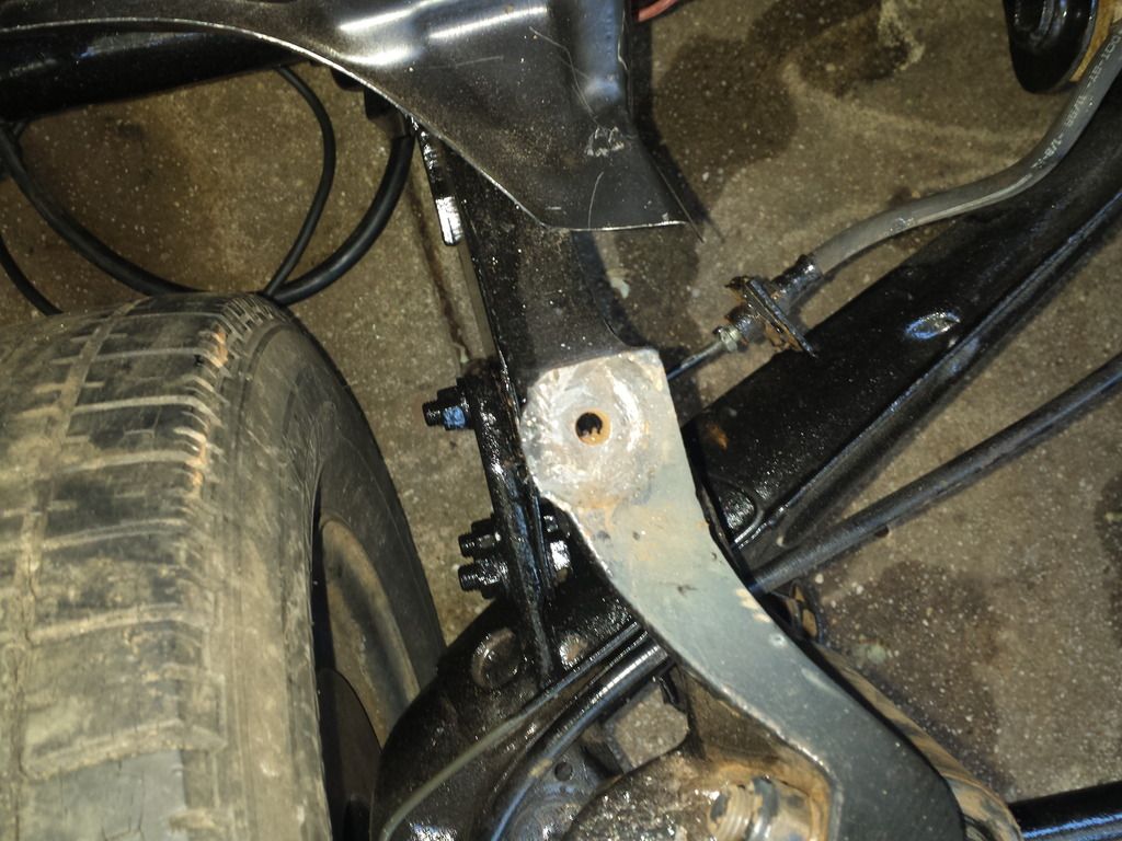

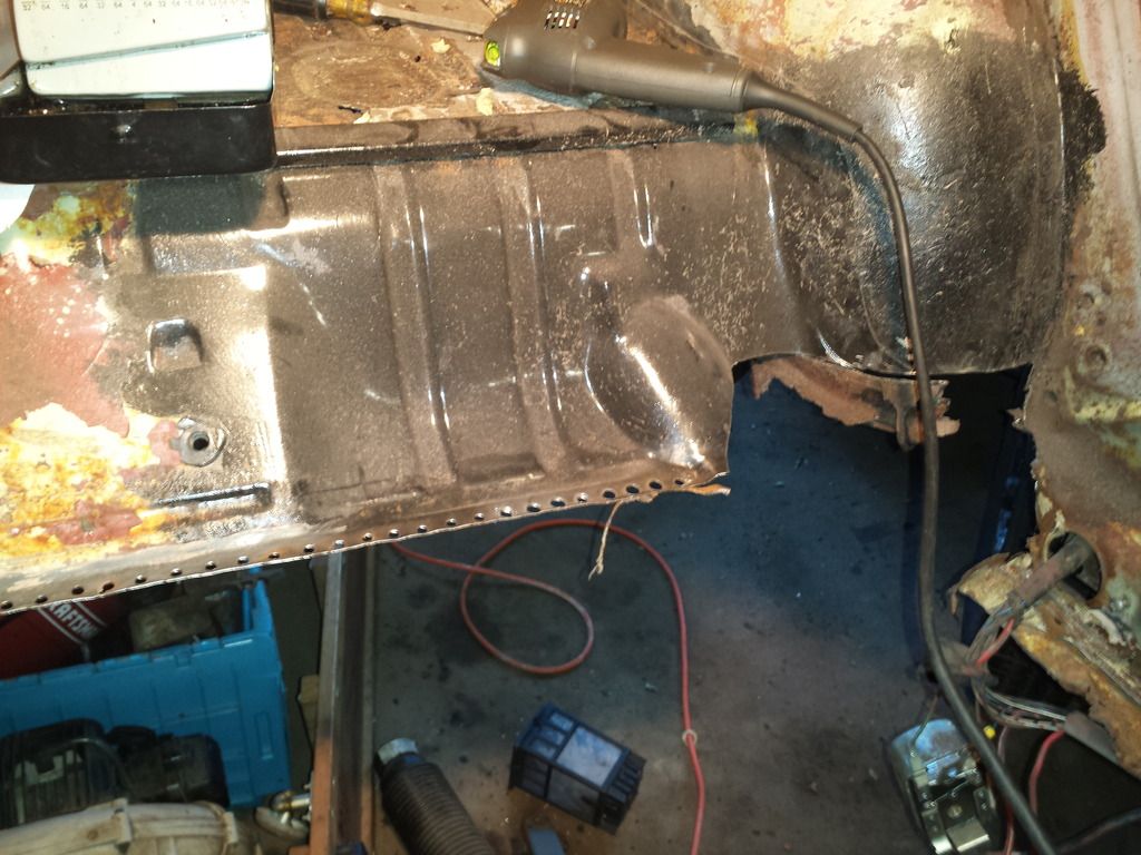

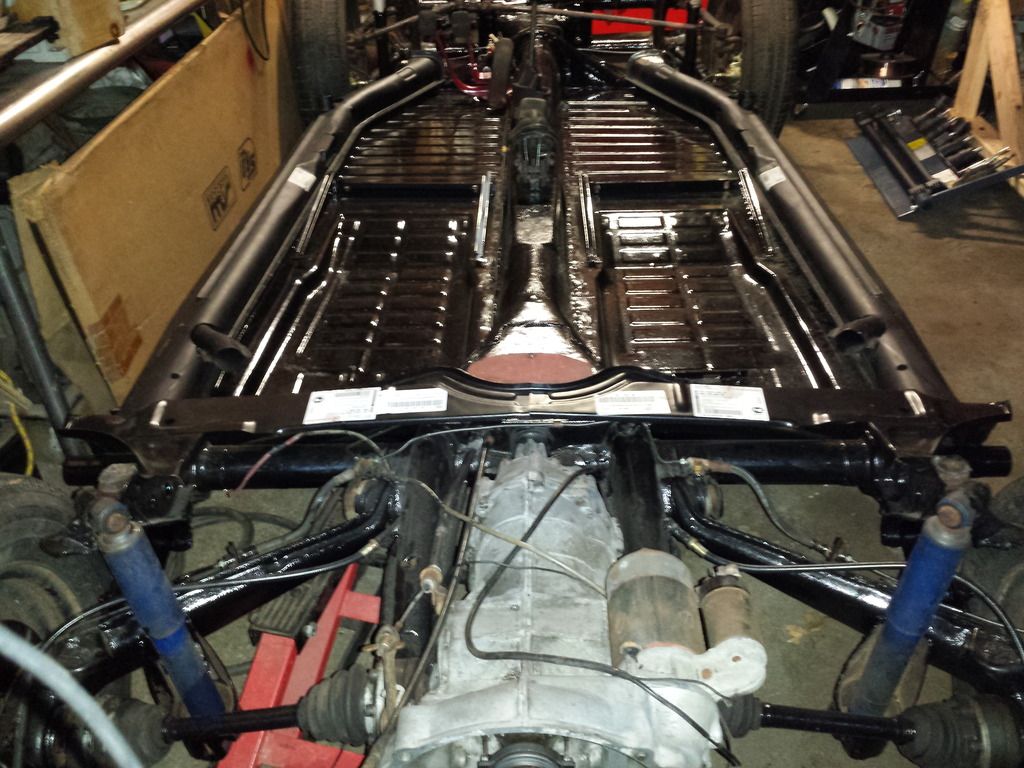

tonight i got the passenger side jack bracket cut/grinded/and beaten down to clear the heater channel Image and got the channel bolted down legit with all but 1 bolt the pan will need some grinding Image gonna leave the jack bracket as is till i get the channels welded to the body then weld it up nice and clean.

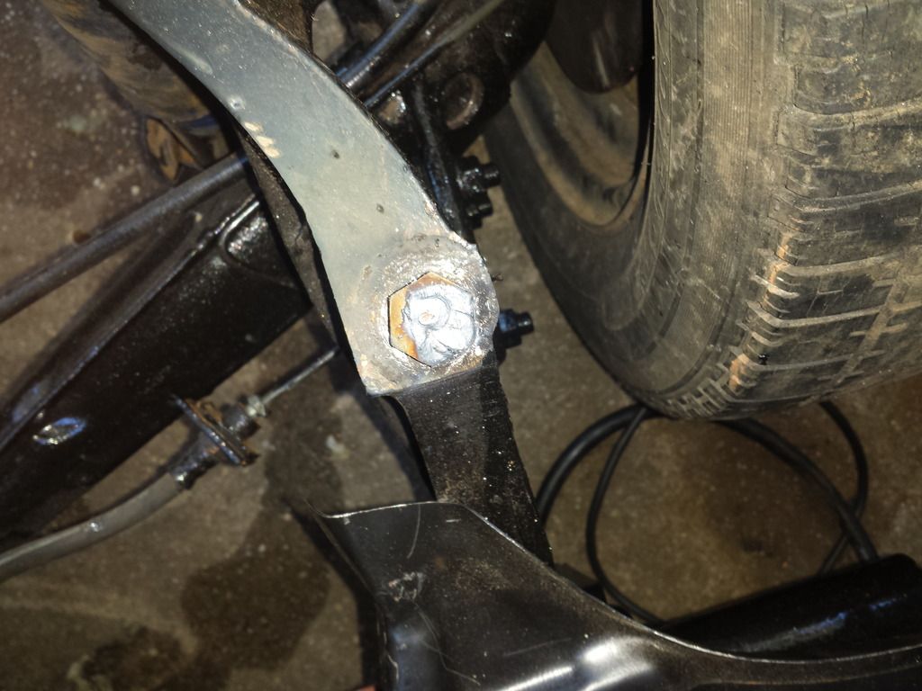

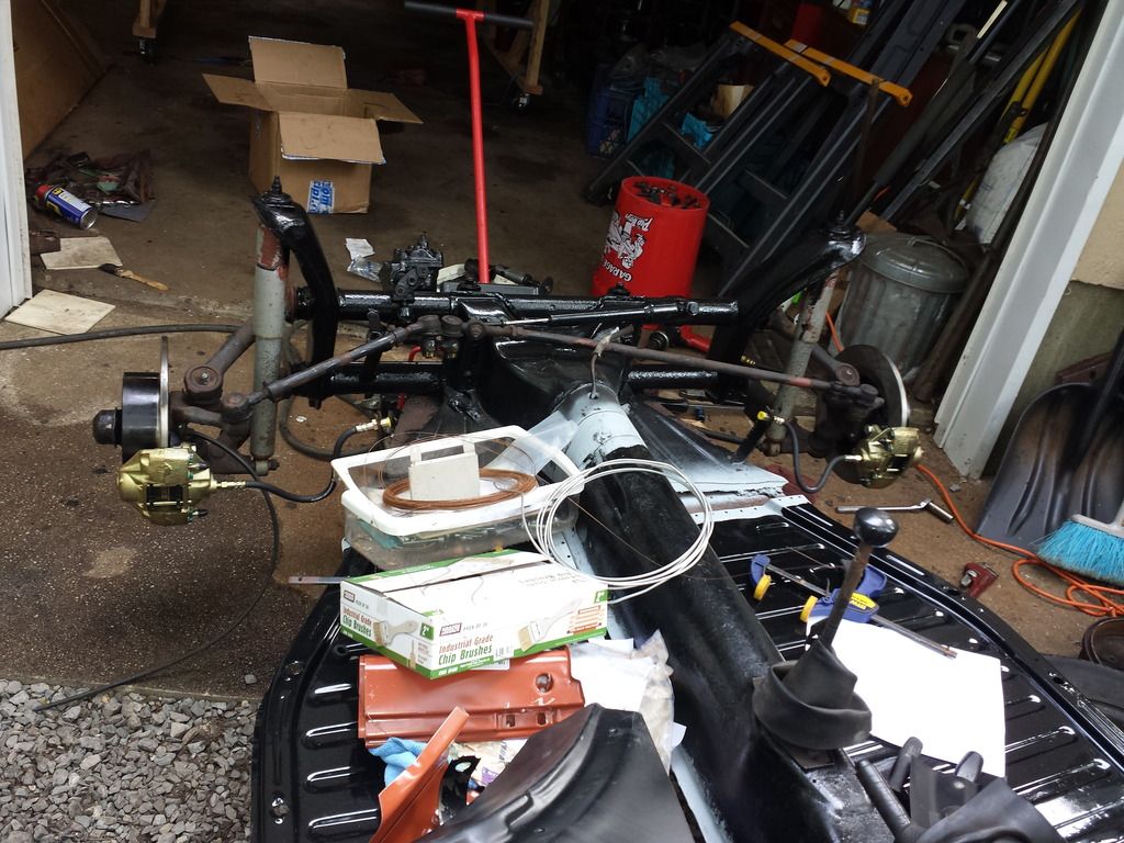

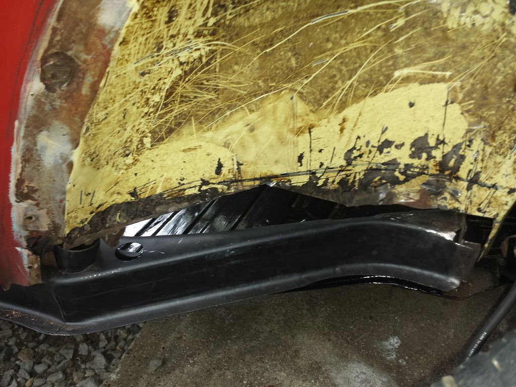

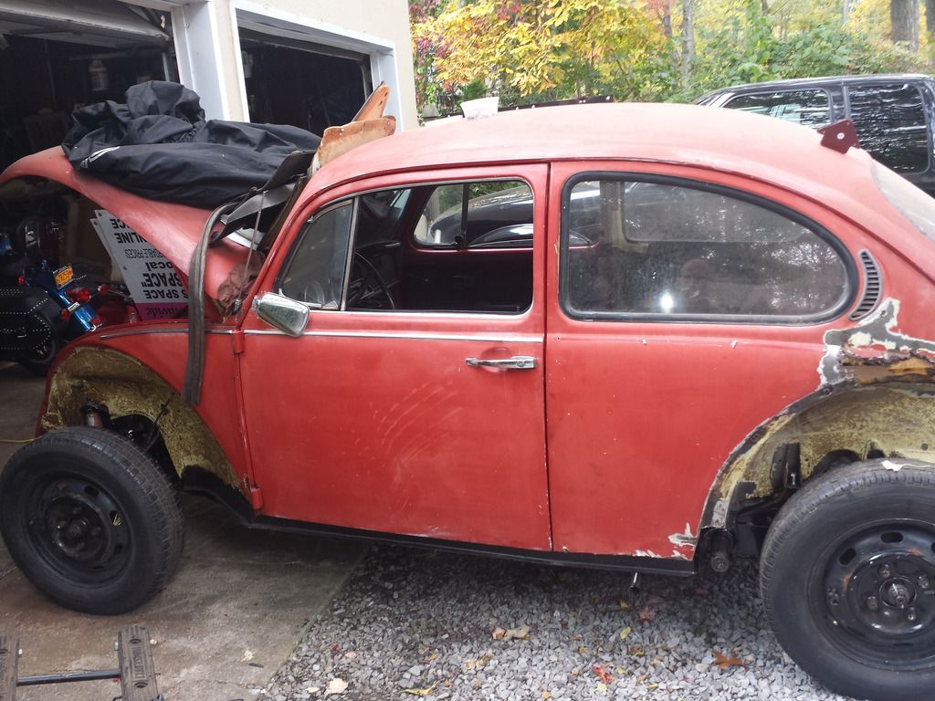

i got the drivers heater channel bolted down after a lot of Oblonging the pan because the the channel bolt holes were off center, it was a pain in the a#$ because they were off in a different direction. Image Image so short of running a new fuel line its time cut whats left of the old heater channels out trim some rusted metel and hang the body back on . im gonna mount it on the 2 pads under the gas tank and each pad in the rear fender area and fill in the voids with 20 gauge sheet metal. i have both side new lower A pillars and a new Right side quarter panel to patch in Image

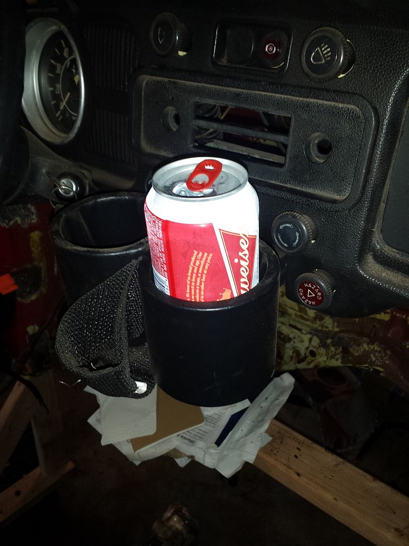

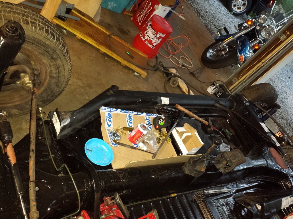

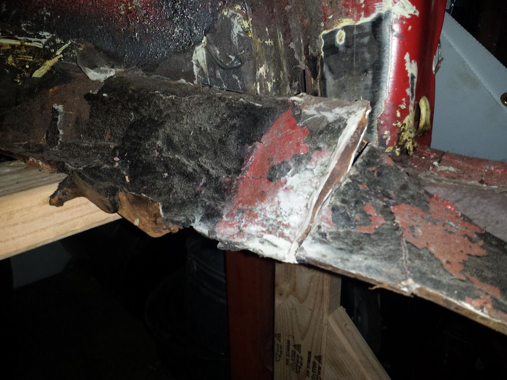

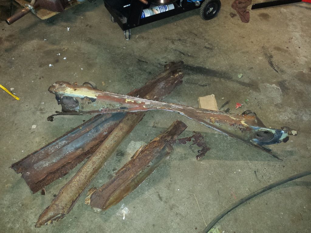

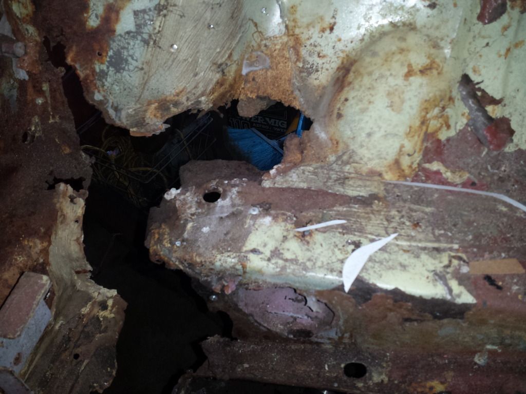

got the other rear broken bolt out today Image Image then started cutting the rusted mess off the body Image Image Image ahh beer holder Image cut out rotted crossmember Image Image i think ill wait till next weekend to
wait till next weekend to put the body on the chassis because ill need to hoist it off the stand to remove the rest of the rusted parts
Love the beer pic. Always a must have when in the garage! Great progress on this.

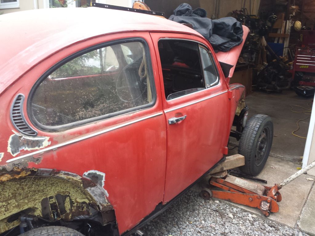

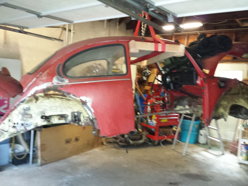

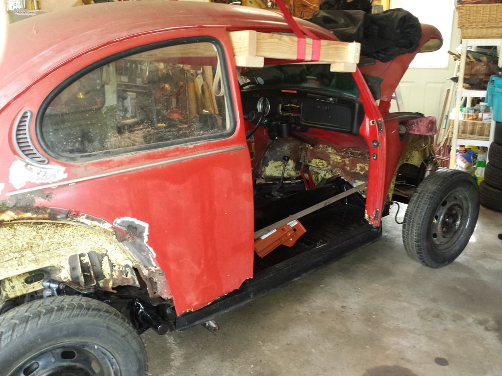

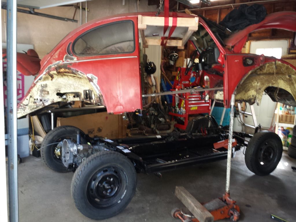

so i got the rest of the rusted body parts cut out and got the body back on the chassis today Image Image Image Image probably gonna be on and off a few times to blend the new with the old but all in all its pretty spot on. then i find this Image sparks started a foam fire glad that it started while still working in the garage
Project is really taking shape. Should be nice and solid when you're done!
That's some really interesting rigging your using there ! Moving along nicely, what are you going to do when the winter comes ?

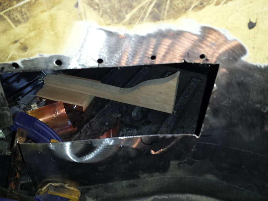

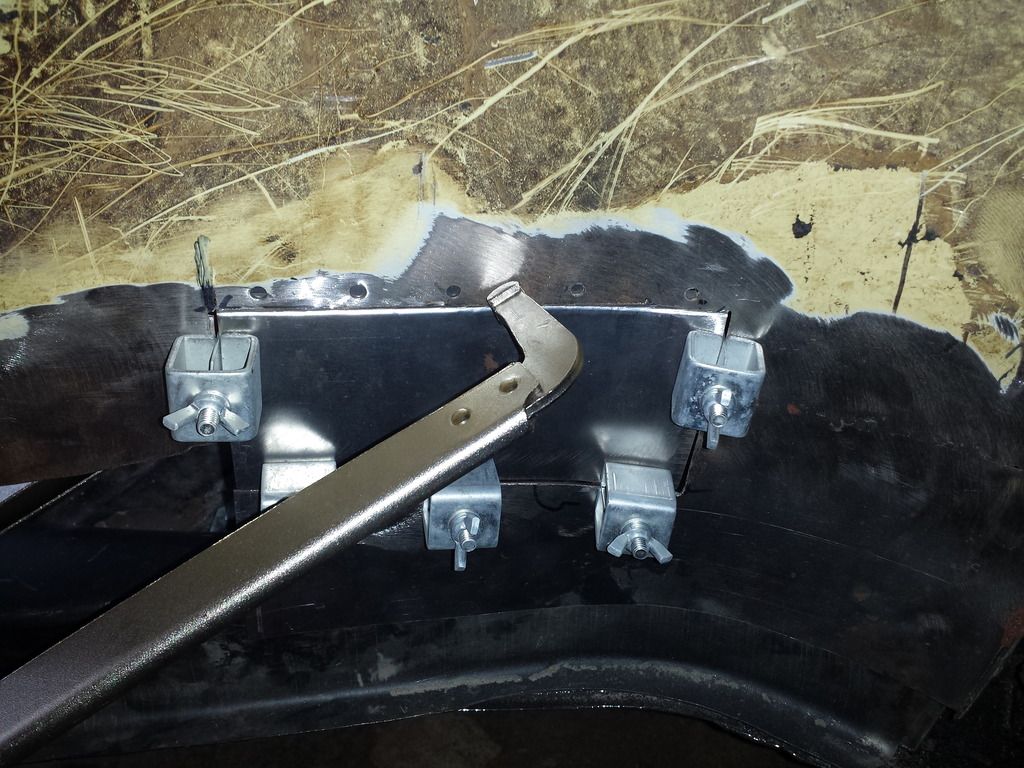

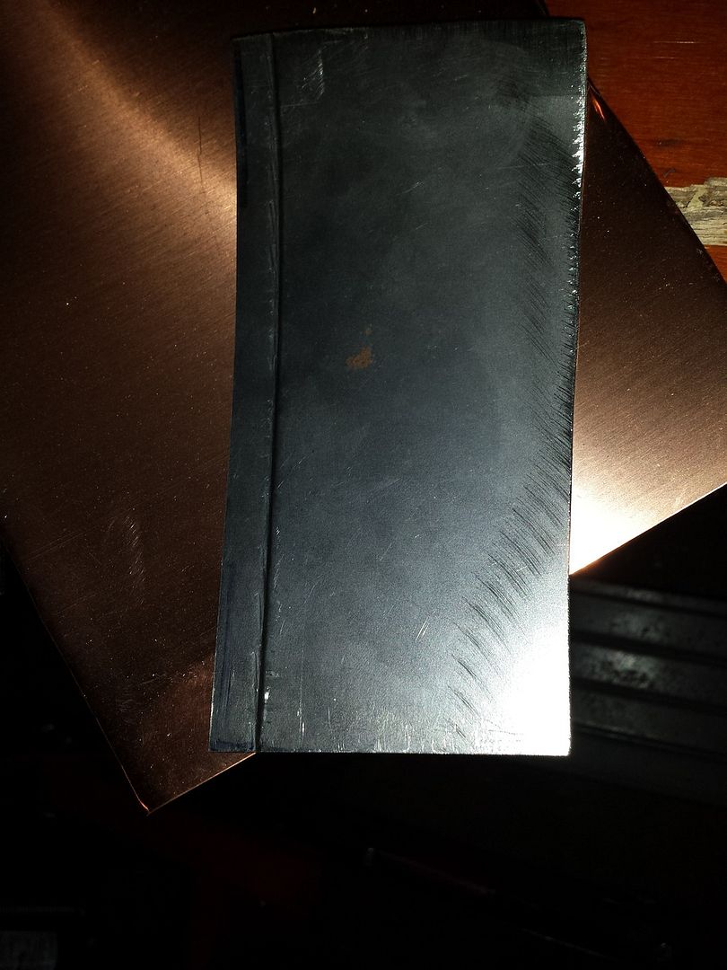

i got my doors back on the car today Image Image and started cutting out the rust and filling in the gaps/voids with some home made 20 gauge patch panels Image Image got the right front started but ran out of daylight so i hope to finish it tomorrow and maybe then the left front

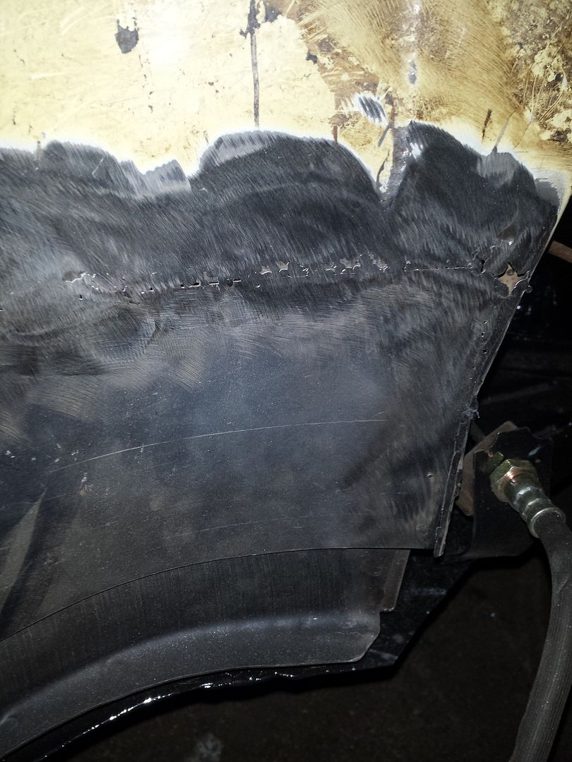

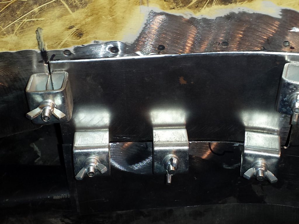

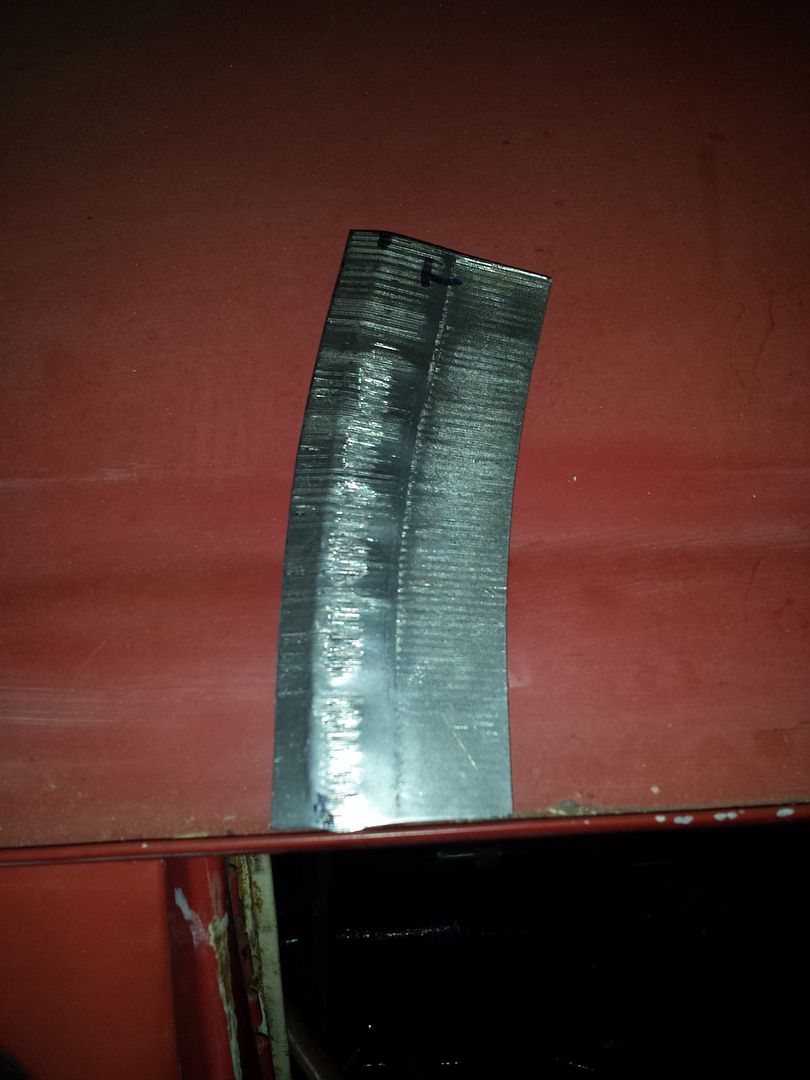

I got back in the garage today and started to fill pin holes in the patch I made but just made a mess of it .so I cut out the mess and made another patch panel this time I flanged the patch wear it meets the original metal so I wont burn thru so easy Image and punch holes in the body for some spot welds Image got it clamped into place and will weld it in tomorrow Image the left side quarter panel finally came in so hope fully I start hitting it again Image

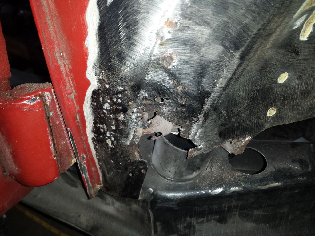

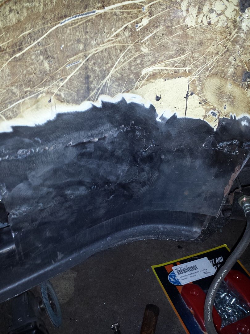

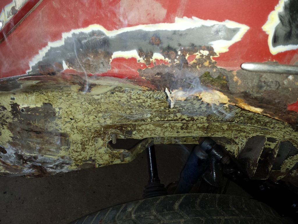

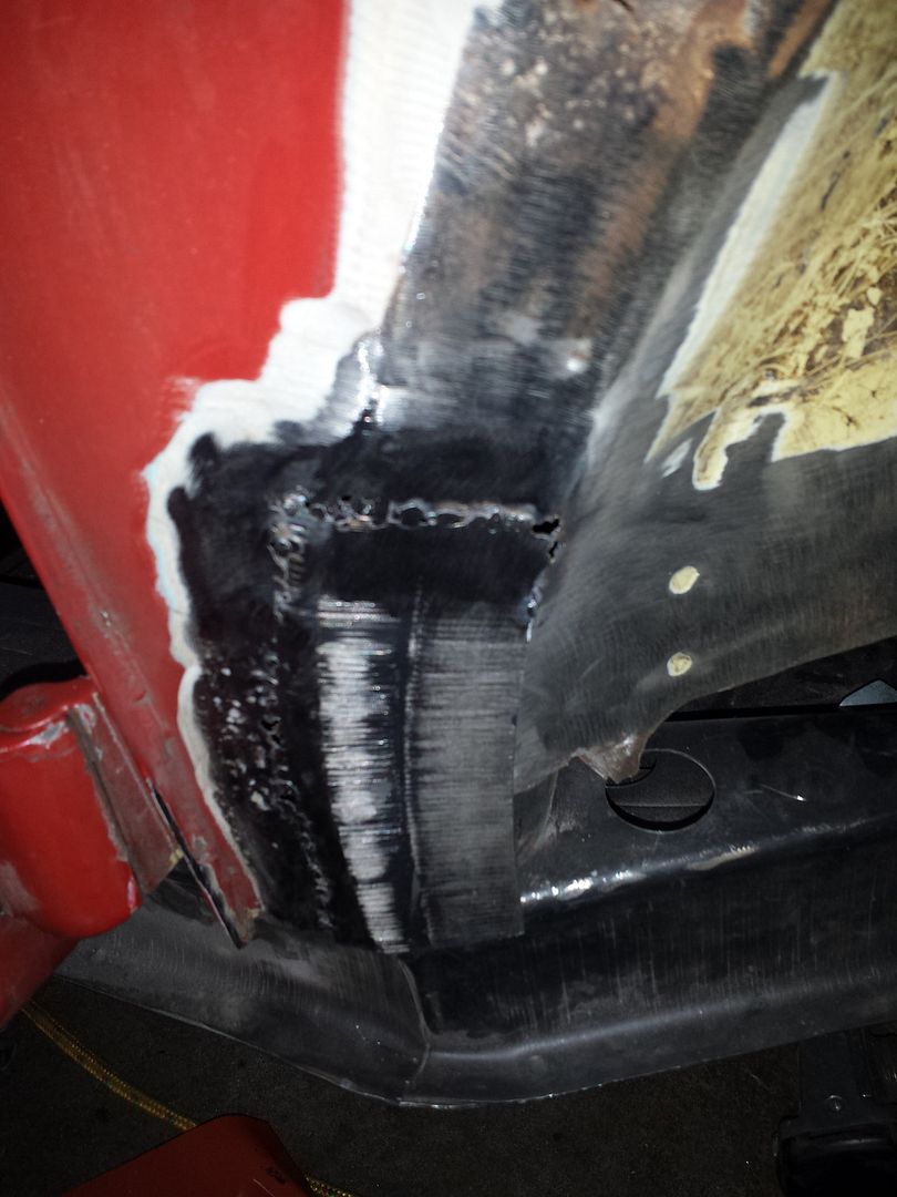

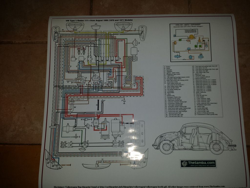

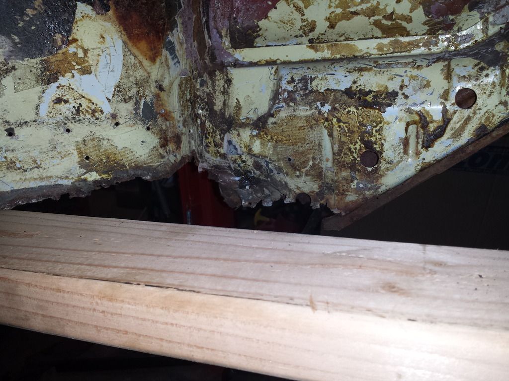

got back in the garage today and worked on the right front rust Image got this welded in Image then cut out this mess Image and made a new patch piece from some 20 gauge Image got it tacked in Image i will have make the piece to fill in whats left next time i get in the garage.my wife got me an enlarged wiring diagram from staples Image from a Samba pic. and 1 last big upgrade to the bug Image
As always, beautiful fork. That blown up wiring diagram will be invaluable when the time comes. Keep at it!

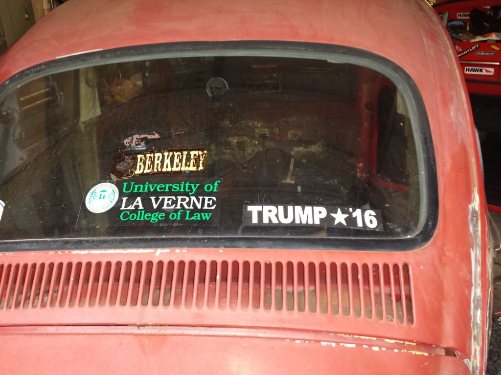

elrockk wrote:Image
I hope you got one of these...
Posts: 310
:lol: :lol: :lol: :lol: :lol:
Glenn wrote:
elrockk wrote:Image
That's a Good One!!
Yeah that Berkeley sticker has got to go.
